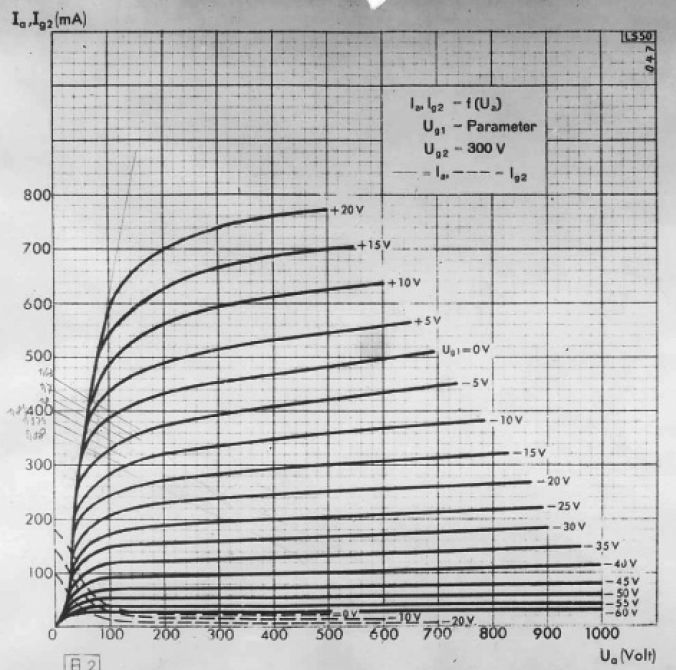

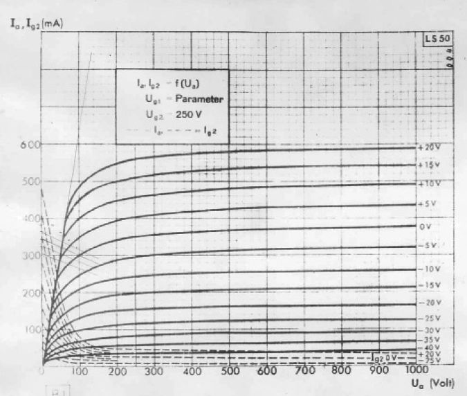

Yes, design in Germany and production in Poland: Ringkerntransformator, Transformatoren, Ringkerntransformatoren | Ringkern, Ringkern-Transformator, 100V-Übertrager - BADEL Elektronik GmbHHe also gave valuable hints to another toroid winding shop in Poland, this one even with a German Department located at Munich (Badel).
PS
in attachment GU50 curves with g2 at 250 and 300 V.
