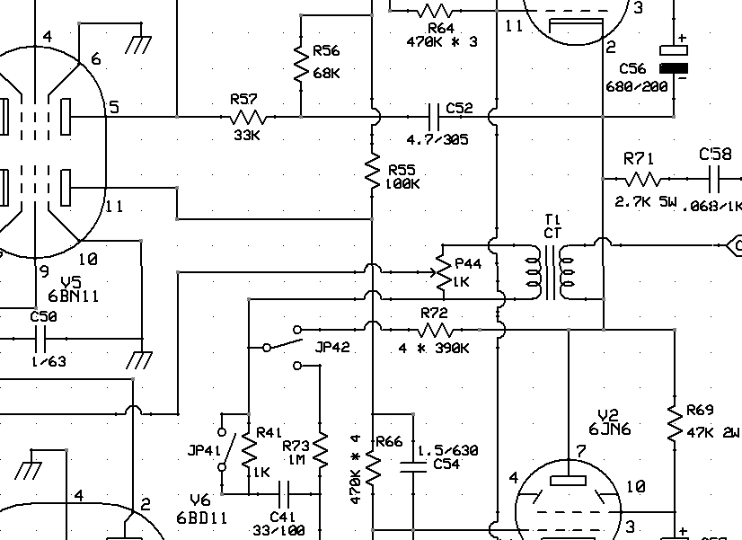

Ciao baudoin0,Now the penny has dropped.
can I ask you why you posted a schematic that you have found here: Bass Power Amp with GU50 - Page 2
that is part of the sources I've cited in my first post of the thread (third from the bottom) as starting points for this new project?
This is Hans-Georgs aka es345's design, isn't it?
As said before, he's an EE, hence well aware what he's doing.
It is exactly, that's why I included in the first post as a source from where start designing the new amp including the improvements developed for the Baby Huey and Crowhurst's articles.
The differences from that design are:
- the inclusion of an improved CCS and different tubes for the PI;
- the inclusion of a CCS for the mosfet drivers;
- the inclusion of the shunt feedback;
- the inclusion of the current feedback;
- the exclusion of the soft clipper before the driver (the resistor + zener +diode between PI's outputs and ground);
- the exclusion (if possible) of the global NFB as shown in that amp;
- a different power amp;
- the possibility to supply B+ through SMPS while using a small toroidal for other small power voltages.
It's quite a different penny.
