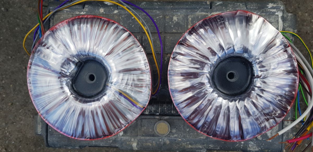

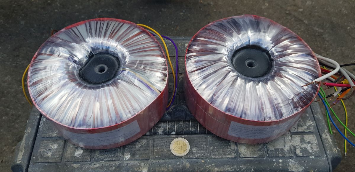

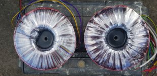

They are huge as expected. Apparently the contact I have for the SMPS I bought, can go up to 240 Vdc and 3 kW, no more than that.These are my Badel toroids, made in Poland.

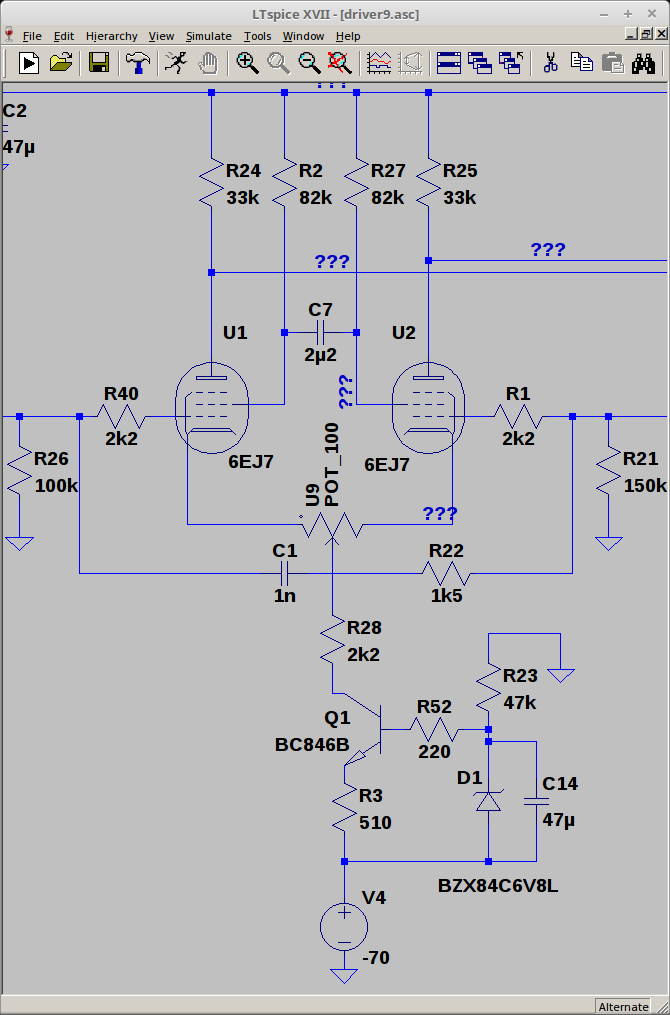

Clear, thanks. This evening I had other things to do and I haven't sketched the new schematic, I will in the following days.

I am not suggesting removing the mosfet's that is a necessary thing just the 6xCCS that go with it. I like your idea of being able to adjust the bias on each valve individually to the correct value. You could even replace them with emitter followers although there will then be some base current taken from the first stage. They would have a more constant Vbe drop without the CCS.
Just be aware that if you go for a pentode splitter in the first stage the screens may take different currents if the valves are not matched. This will effect the DC and AC balance - and you may need a balance pot.
baudouin0, two remarks to your schematics:
1st: I suspect V4 as a negative (-70 Vdc) voltage source is drawn upside down.
2nd: Assuming you're feeding the LTP tail with -70 Vdc, are you sure that a BC846 will stand it? What's the expected cathode voltage of both pentodes?
