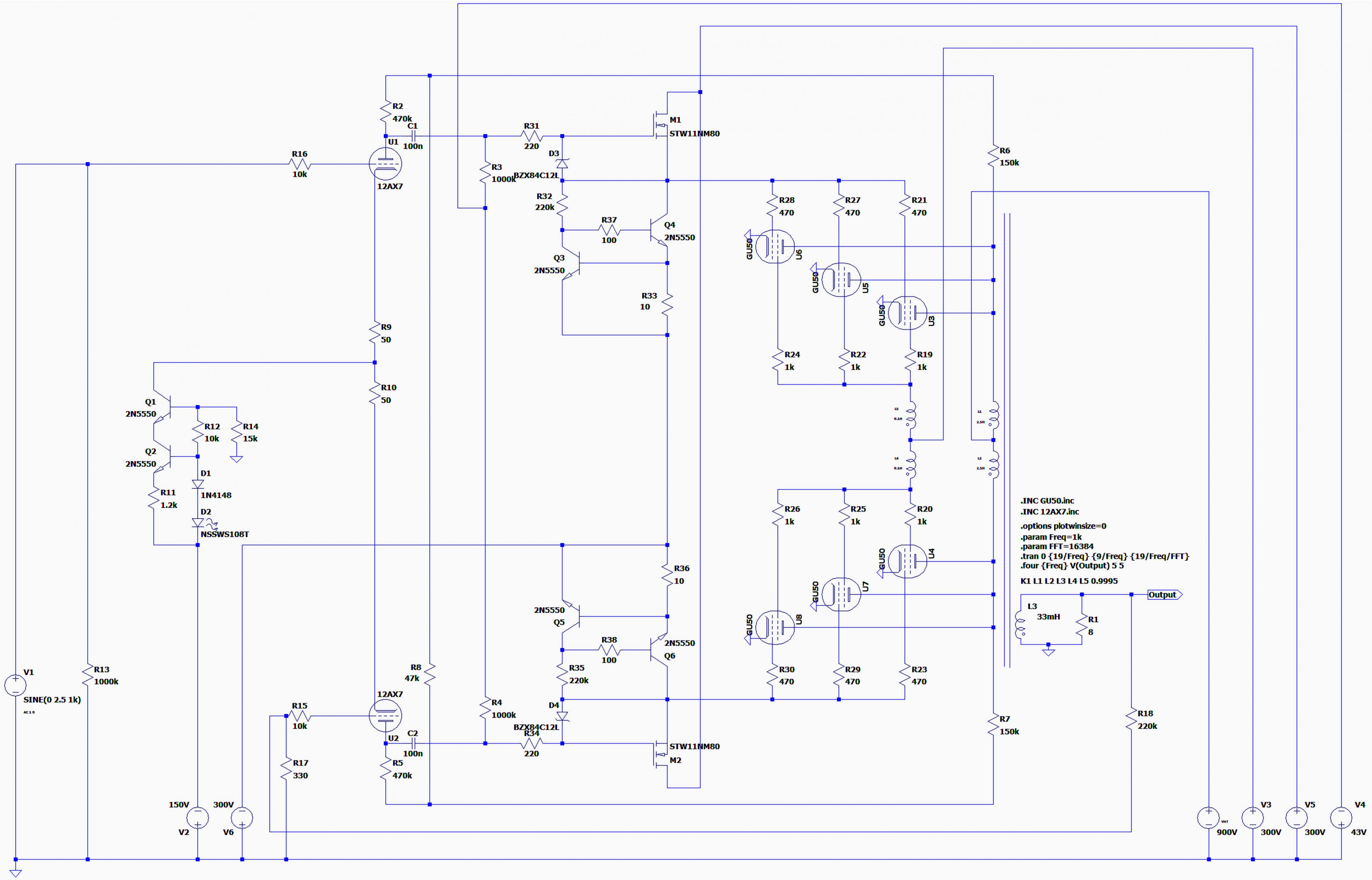

This is the amp with the 12ax7, and the harmonic content with 2,5 Vp at its input:
Not bad for a bass amp, and probably it can be improved by finding the right working point for the PI. 12ax7's plates have a dc point at 270V and swing from 195 to 345 V.

Fixed some more details, with 2,5 Vp on the input I've got 90 Vp on 8 Ohm, that's 600 Wrms at THD 1,5%.
OT has 2k4 Raa and 20%UL.

Roberto, remark that the 3rd and 5th harmonics are nearly of opposite phase, that are those that reduce the distortion of the loudspeaker. I think your precedent current feedback is more useful for a musician .The amp distortion makes part of the sound character along with the speaker's which at 50hz can be 20% at 10w. I am not a conesseur about the subject , but what is the natural sound of bass guitar is unknown .
Thanks, can I ask you some links where to read more about this? What is the expected result depending on the phase of the distortion, and what is the accuracy for this based on available models?Roberto, remark that the 3rd and 5th harmonics are nearly of opposite phase, that are those that reduce the distortion of the loudspeaker.

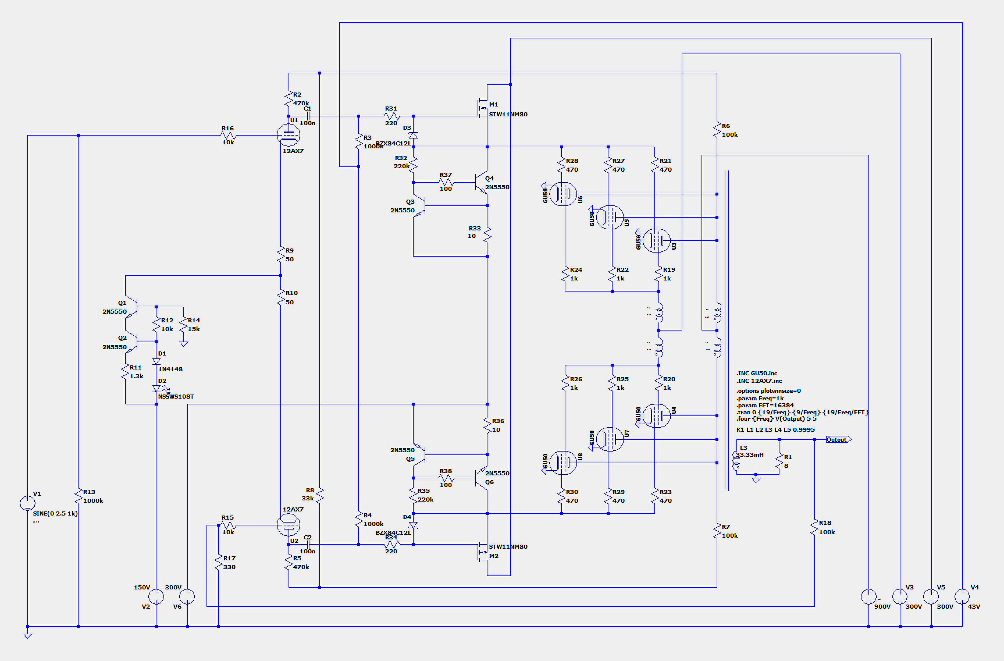

Based on this post by gingertube: EL34 Baby Huey Amplifier
So here as well we have 100 Vpp more reasonably at 50 kHz slewrate will be:
2 x pi x f x V = 2 x 3,14 x 50 kHz x 100 = 31,4 V/us
Three GU50s in parallel will have around 45 pF input capacitance.
C = i x dt / V
dV/dt = 31,4 V/us
then
45 pF = i / slewrate
so
i = 45 pF x 31,4 V/us = 1,41 mA
So it can be enough to have 470 Ohm on the CCS.
I will keep 390 Ohm and 1,7 mA.

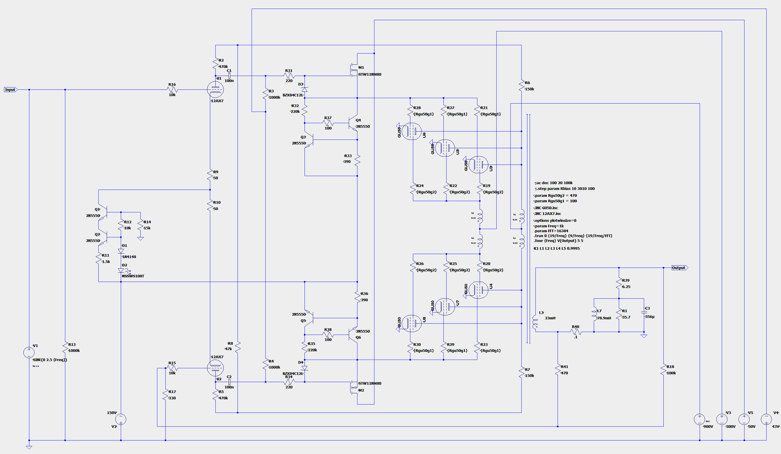

An update with current feedback.

I was reading about Wolcott amps and their use of local shunt voltage feedback and positive current feedback here:
HiFiForum.nu - Henry Wolcott and the secrets behind his amplifier
and I've discovered I'm spinning a 60 years old weel:
