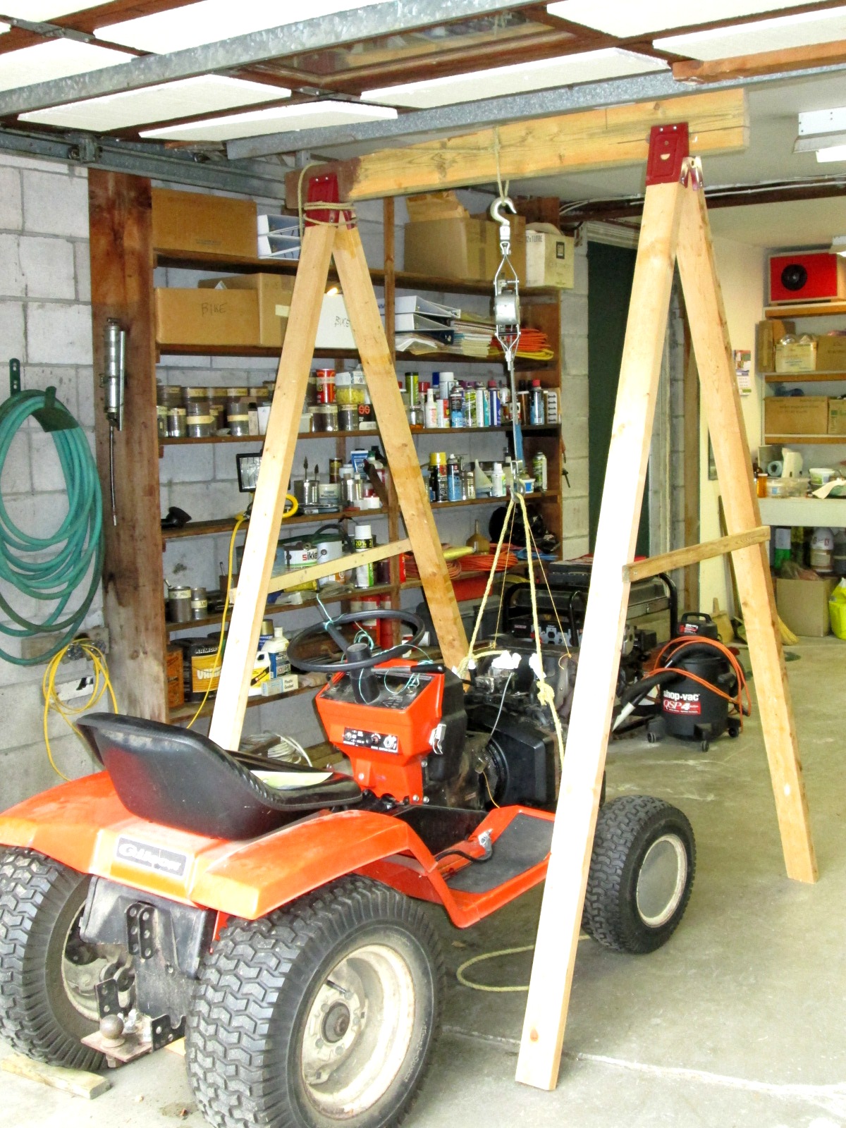

I've been on the run this spring & summer, there is a lot to do here on the 4.4 Acres (2 hect). One of the recent projects was changing the starter on an oversized Gilson garden tractor. The only way I could make the swap was by lifting the engine out.
The engine is a 2-cylinder opposed Briggs & Stratton with a difference, the crank is horizontal, not vertical as you see on most garden tractors. the electric PTO clutch is on the front & drive shaft to Eaton hydraulics & transmission to the rear.
Also have a Kubota Diesel, 3-cylinder. The crank is 240 degrees, so even firing.

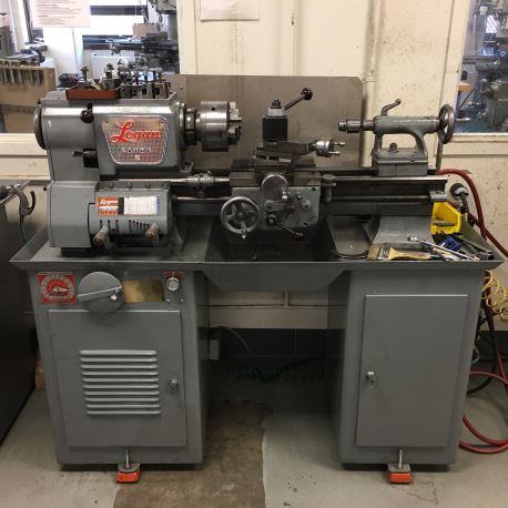

Working on restoring a Logan/Montgomery Wards lathe here, my father had it. Still missing a few small pieces, Ebay has been quite helpful. I think it dates from the 50s, just like tubes. The bed weighs around 150 lbs alone, 400 lbs all put together. The bed was stored on end in the kitchen of the apartment I was in before, and the floor started sinking. When the landlord started raising the rent, I decided it was time to buy a house with a big basement.

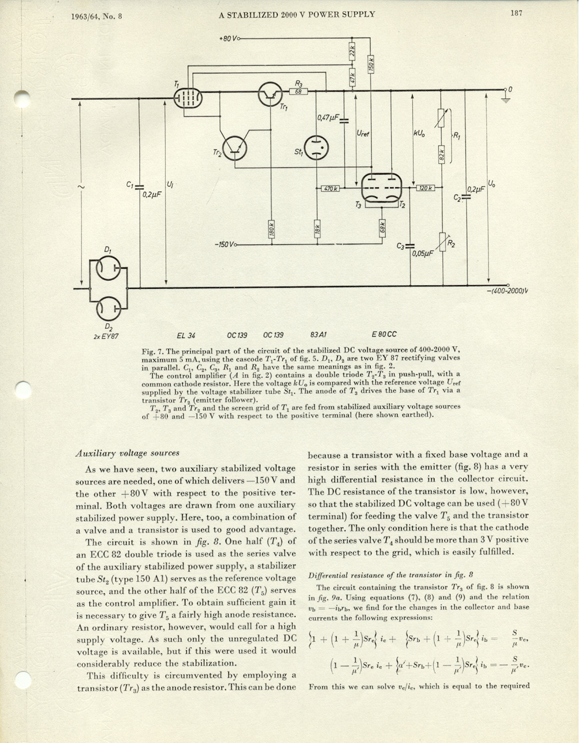

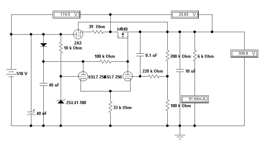

Here is one solution, there are most likely many others. This has as its origin in an article in the Philips Journal of around 1960 on improving a photo multiplier HV PS. The Stabilization Factor of a vacuum tube PS is given by
S = uAK, where u is the passer tube mu, A is the gain of the error amplifier & K is the portion of the output sampled referred to the error amp. The value of K would be small, high stability standards such as the 85A2 were common. So 85 Volts was compared to perhaps 1.5 KV.
The paper covered how an NPN transistor could be used to greatly increase the apparent u of the passer tube. That way S could have a reasonable value.
Much later I tried simulated various versions of regulated PSs using an IRF 840 in the cathode of various power tubes. A regulated PS circuit is a SE amplifier, it follows its standard voltage as an input. So the circuit posted was developed from one of those PS circuits.
Don't see any advantage, others might.🙂

Regulated PS, The Starting Point
For the curious & others this DC PS Regulating circuit was the starting point for that FET driving the cathode of a power amp. All based on the circuit published by Philips in 1964. I did several simulations in 2004 looking at the practicality of such an arrangement for a lab supply. But never built, I already had something that was more than adequate for what I was doing. Still is!🙂
