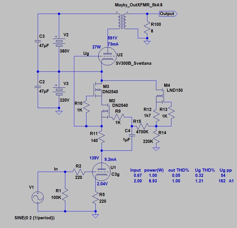

This is just a simulation in LTspice, quite reliable from euro21.
For some DIYers THD in simulation does not mean anything. But for me a good simulation gives good and valuable information.
In this case we have 5.1% THD @ 1.5Wrms output power and 1.68% Ug THD.
That's a lot really!
D3a is an extraordinary tube. But this big THD (especially Ug THD) indicates that the topology of this amplifier is not good and I would look for another tube for the driver stage.
Just IMO
So what?
With SE amplifier w/o feedback (DC or not) it is very easy to get about 2-2.5% THD at full output power. It is classic.
Even 1% for 9Wrms output power.

IMHO, the amp's schematic is good
Sample schematic attached.

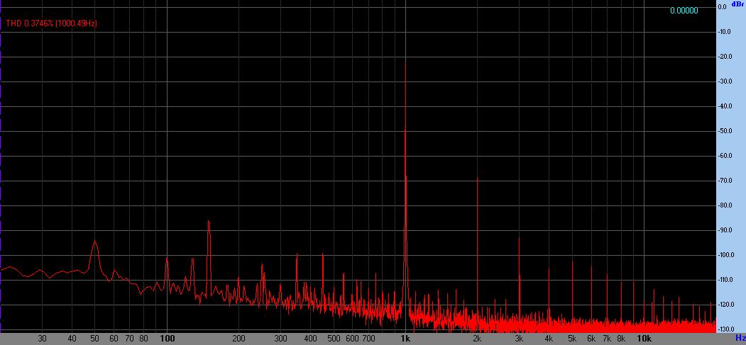

just one example

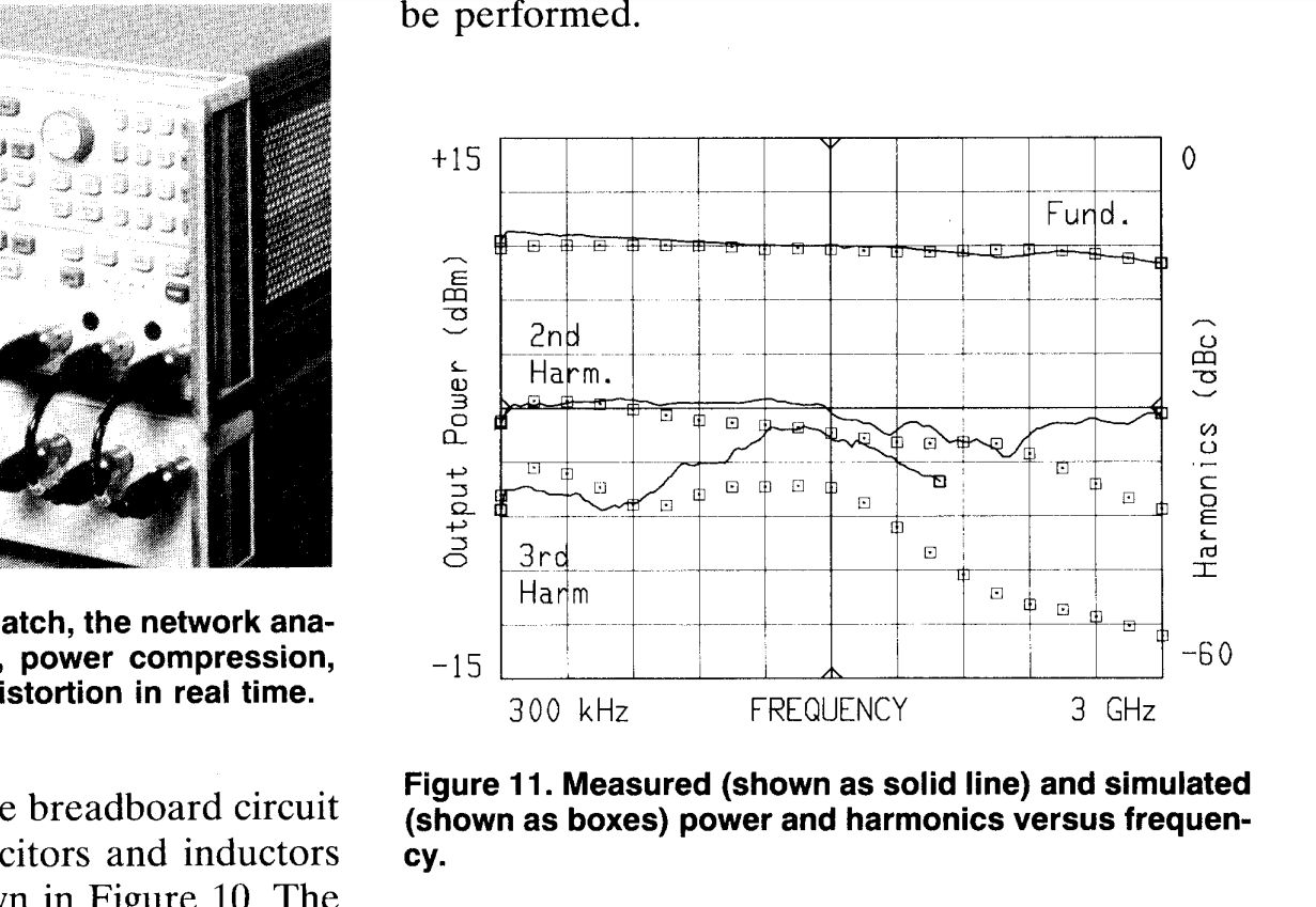

Hi RajkoM
Simulations are ok for many things, but nothing can replace a measurement. I can't say much for the black and white image you post, since it is not in context and says nothing. We can only assume it was test bed for a simple small signal transistor circuit. No offence intended though.
If you investigate much spice software source code, what you often get is Fast Fourier Transform (FFT) implemented for universal small signal methods (only), in many instances with as little as 8 bit limitation (somewhere in the code), questionable bin dimensions, using the very best imperfect models we do our best to create...
For simulation of THD, I would be much more satisfied with a full monte carlo simulation using a circuit with perfect models. Maybe you have this? Very nice if you do.

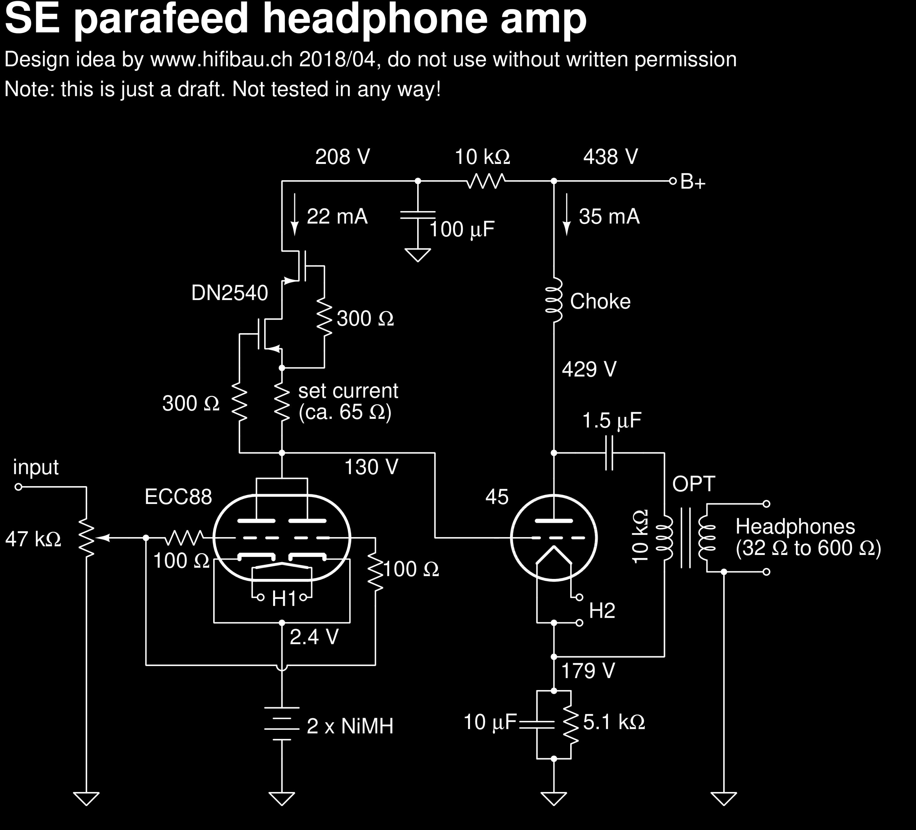

Ok, here's my draft for a headphone version.
I used a 10k load, which will still give plenty of power for headphones, but with better linearity. Brian Sowter confirmed that he could make a suitable transformer (similar to the Sowter 8665, but with a higher winding ratio). The 1.5 uF parafeed coupling cap with the 10k load will give a cut-off frequency of about 10 Hz.
For normal speakers, a 5k:8 transformer or so may be better to achieve higher power.
The ECC88 driver tube may not be very exciting, but it's quite linear and allows biasing the driver stage at a relatively low voltage, so the whole amp ends up at a B+ well below 500 VDC. And I have a bunch of good ECC88 tubes in the basement.
I kept the autobias for the 45 output stage because that will gracefully adjust the bias if the tube characteristics drift away from their textbook values.
Comments, suggestions, ideas?
