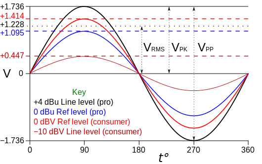

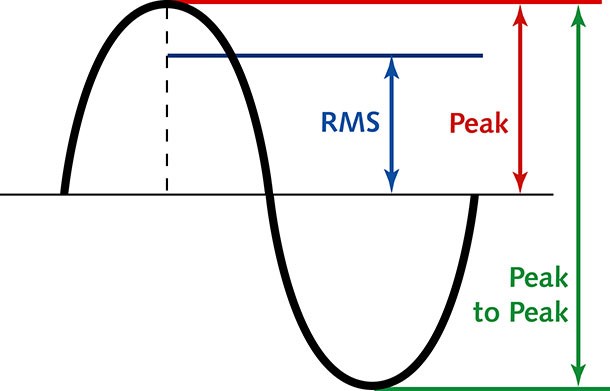

So for commercial audio sources:
Vrms at 0db has a Vpk of 1.414V
This suggests a Vrms of 1.414/sqrt2 =1V
There. I feel better. 🙂

I don't care about RMS. All that matters here is the max. amplitude of the signal coming from the source. Modern audio sources will often go quite a bit higher than the "consumer level". My DAC will do +/- 3 V easily, and other sources may even give more output. It is important that the DC bias point accommodates enough headroom to allow the full signal swing without the grid swinging close to where grid current starts. Note I am not referring to grid leakage (that's something else).
Your DAC has Vpk of 3V at 0db? This suggests Vpp of 6V and 0db Vrms of 2.1v... It is indeed greater than standard line level.
Is it a commercial product? Maybe I am just a dinosaur... In any case, if I used your DAC, I would need to keep the volume lower, as to not bother my swiss neighbors any more than I currently do. 😀
The attenuated input signal from your DAC would not cause increased distortion with my amplifier. Maybe it would sound very nice though. 😉
