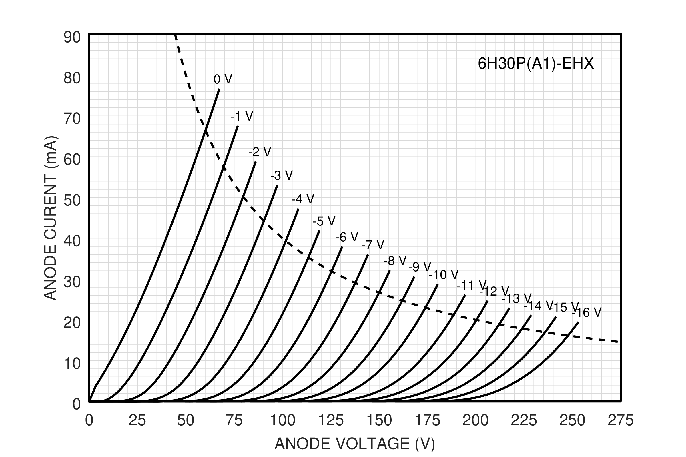

Ok, parts start coming in. I put the 6H30P (Electroharmonix) tubes in my brand-new tube tracer and got the attached curves. Something is not right going from the -10V to -11V trace. This is the same for both triode units, and also with a second 6H30P. I don't think I'd push the signal to -10V very often, but still... does anyone have an idea what's going on with these tubes?
Argh, I forgot the attachment. Here it is.
Take a look at the large gap between the -10V and -11V traces.

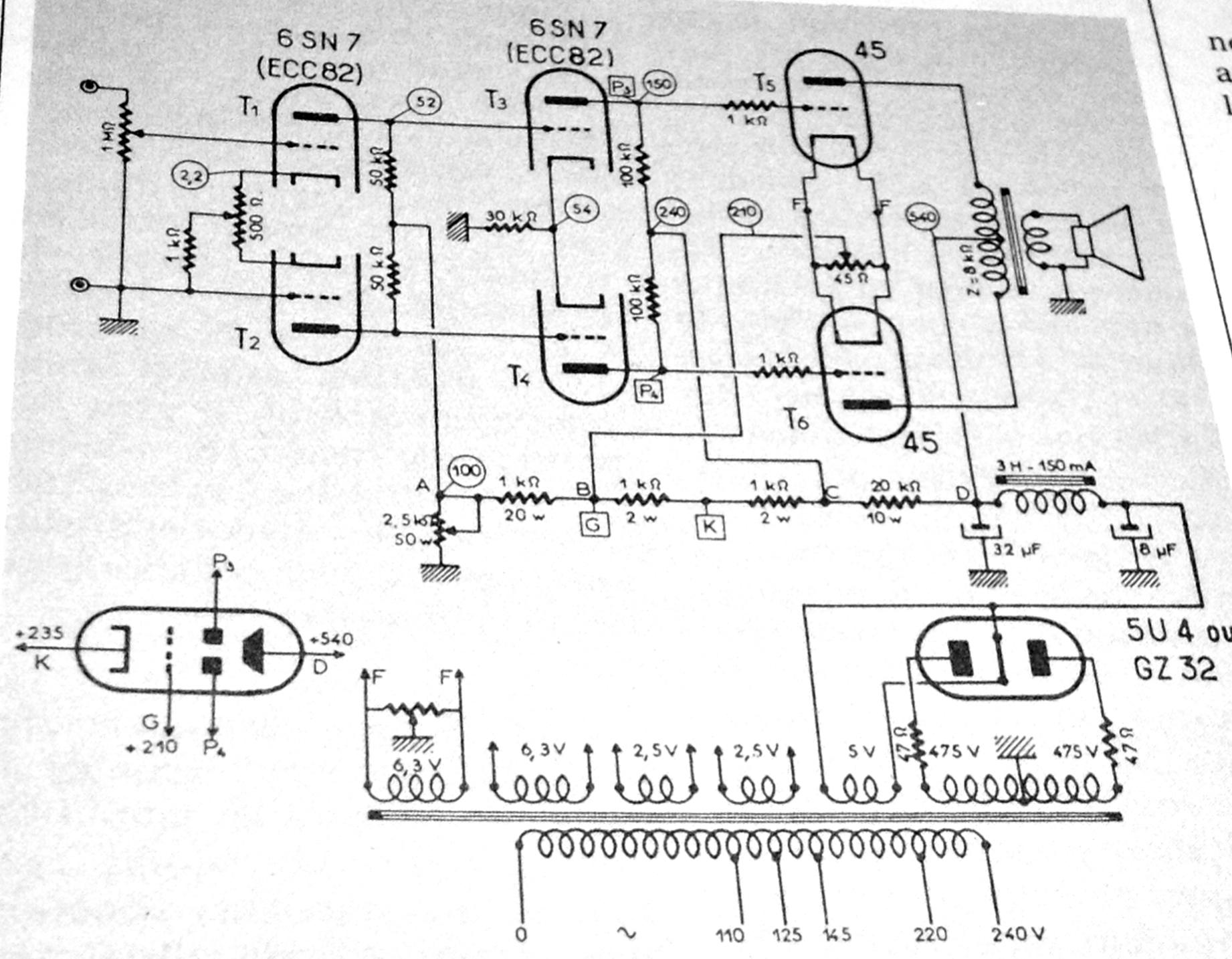

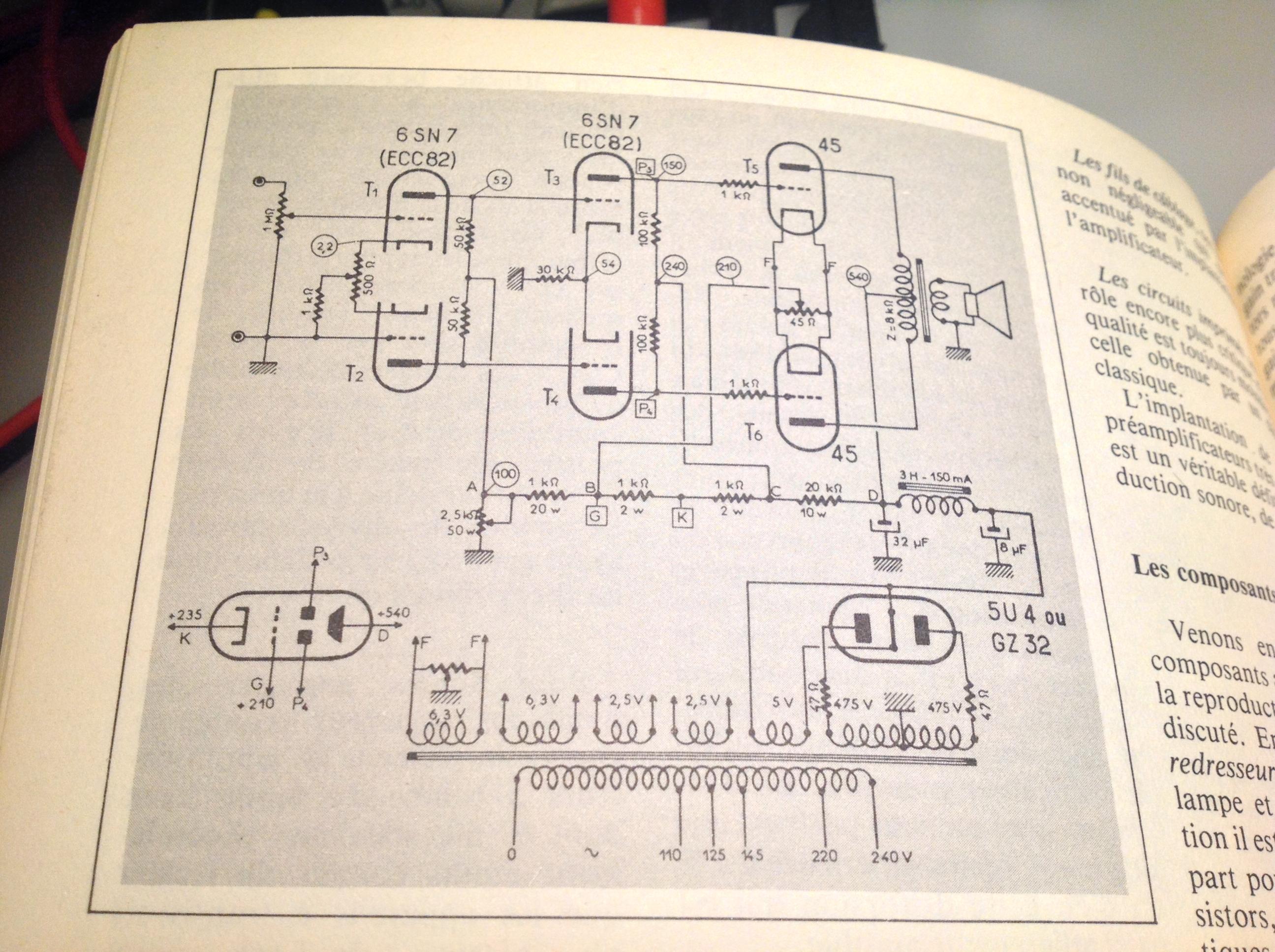

Find this directly coupled " Lafon " 45 amplifier
in my old paper " L'Audiophile" collection :)

Hi Soundhappy
Push-Pull 45 is a nice idea. These days though, 45‘s are getting more expensive to source. Pity that.
The Cascaded 6sn7 brings almost too much gain for the little 45 tube. Indeed, it would be a lot for 2a3 as well. Also, output impedance is really still high on the 45 grid. Last part that I don‘t like with these designs is that the whole thing works like a house of cards - it assumes all valves/tubes are in like-new condition running like in the specs sheet.
Also, that variable 2.5K Ohm 50 watt cathode resistor... Pretty big. And no cathode by-pass cap from point G to ground? I have a hunch that bass response might suffer. Did you ever hear this amplifier?
Ian
45 amp " Lafon " amplifier schematic was inculded into article
"Aspects of electronics " but not precise informations, bandwith frequence response , constructions details etc.

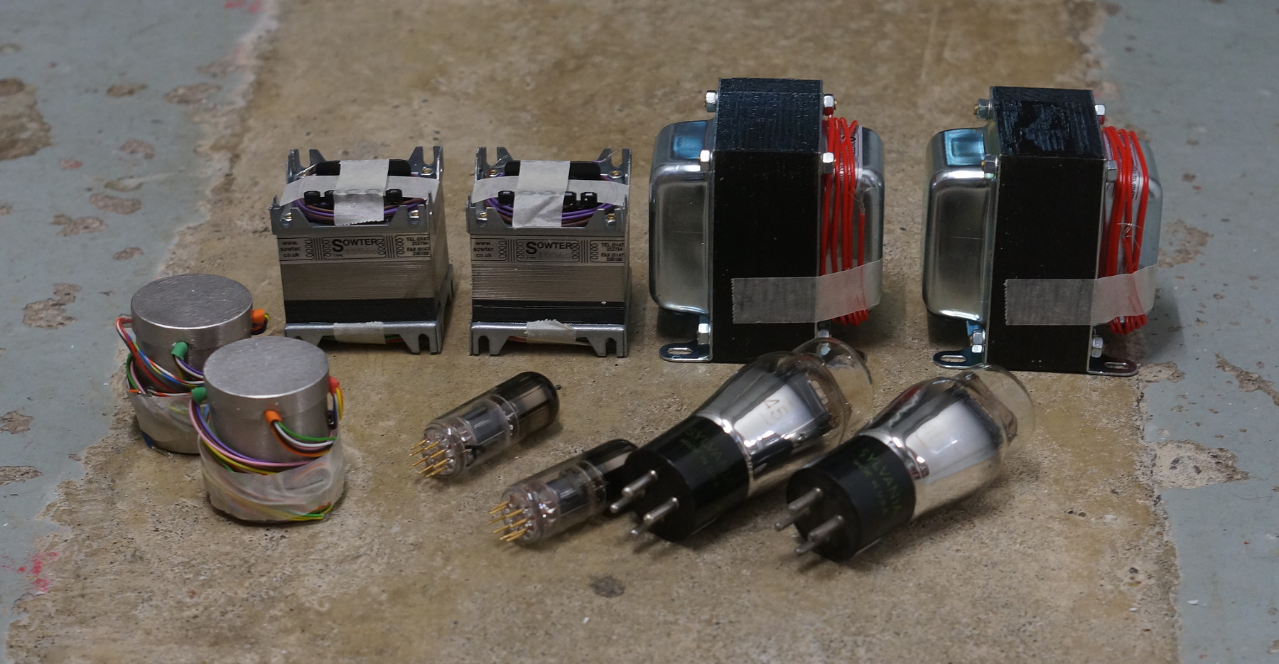

Hey mbrennwa - did you ever finish this amplifier?
I believe I see a pair of chokes and two pairs of transformers in your pic, how is the second pair of transformers used?
I have a 45 parafeed speaker amplifier that uses Sowter 8983 OPT, the 45 are loaded by a CCS rather than a choke however, stages are RC coupled. I am considering picking up a pair of 8985 chokes to replace the CCS loads and direct-coupling the stages, very little in the original circuit would need to change actually.
Also, I'm curious what turns ratio you used on your 10K headphone transformers. Do they have multiple taps or single? Thank you :)
