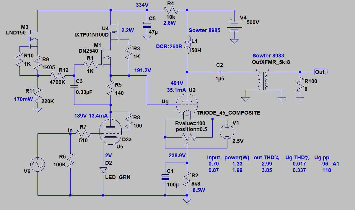

45 amp build direct coupled

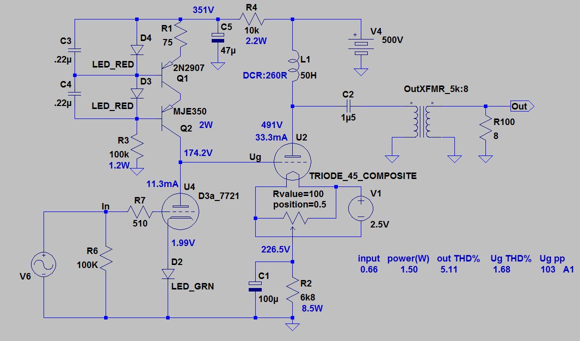

faithintruth,
1. Your schematic in post # 14 still has the current source transistor Emitter connected to the input tube plate. That is incorrect for a PNP transistor.
See the schematic in post #20 for the correct connection of the PNP transistor Collector to the input tube plate.

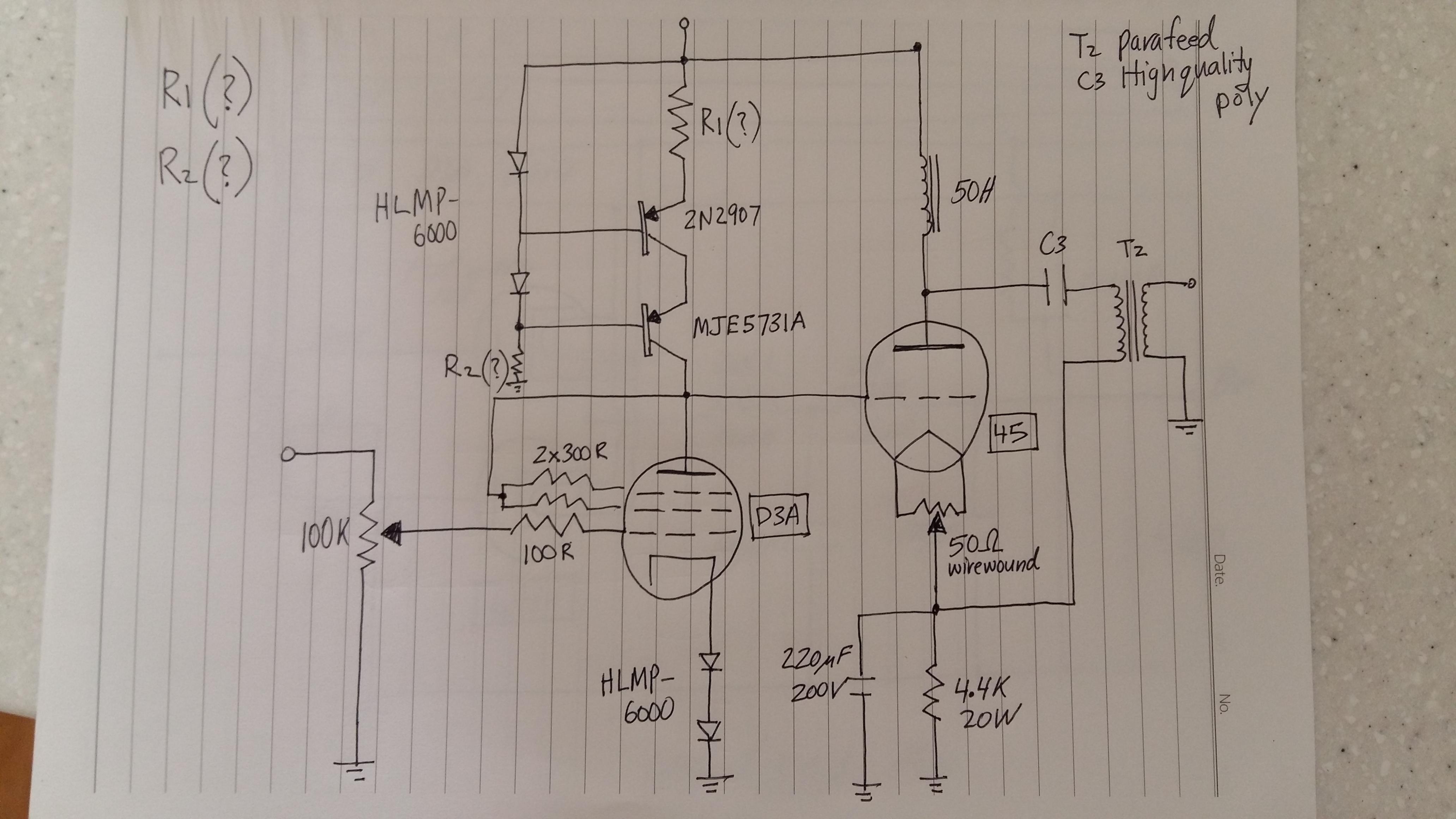

Any help with values would be cool.
IMHO, the amp's schematic is good (if you want to use C4S....for me cascode CCS is better), but 4k4 cathode resistor value is wrong.
See 45's datasheet, if you want maximize power output, the targeted operating point is:
- maximum 275V anode-cathode voltage;
- 34...36mA;
- about 50...56V bias.
The first stage's (D3a) anode voltage is about 170..175V (anode current is about 10-11mA).
175V+56V= 231V
231V/36mA= 6417 Ohm
B+ is about 231V+275V+(36mA*OPT_DCR), for example 231+275+7= 513V
Target: 500V.
Sample schematic attached.
Any help with values would be cool. I tried to digest "Testing power supplies"....
Ok, looking at the 45 curves I'd try biasing the 45 at 250V (anode-to-cathode) and 35 mA or so. That's a grid-to-cathode voltage of -50 V. The 35 mA bias current through the 45 gives 154 V across your 4.4 kΩ cathode resistor. So about 155 V at the cathode. Assuming a 1 kΩ DC resistance of the 50 H choke load, there's 35 V across the choke.
Adding up the voltages across the cathode resistor (155 V), the tube (250 V anode-to-cathode), and the choke (35 V), you end up at a B+ about 440 V. Your 300-ish B+ voltage would be too low for your 45 set up with a 4.4 kΩ cathode resistor.
But do you really need this value of cathode resistor? You can look at this resistor as a way to move the grid potential of the 45 up/down relative to the plate of the D3a. You need to adjust this such that the 45 cathode is 50V higher than the 45 grid, and hence the D3a plate. In other words, the cathode resistor value needs to jive with the biasing of the D3a.
I tried to figure our your biasing point of the D3a, but was not sure about the LED bias. The voltage drop of the two HLMP-6000 LED is about 2 x 1.6V, so you'd have the D3a biased at a -3.2 V grid voltage. Looking at the D3a triode curves, that seems a bit too much!?
Where / how do you want the D3a biased?

Hi Ian - I'm unfamiliar with the D3A. I'm not committed to it and chose it after a friend suggested it's use. The original design of this circuit called for a medium mu twin triode 5965. As for biasing I have never used LED's.
euro21....wow....getting warmer I think.Thanks for running the numbers. I will continue to study the latest schematic. 6.8k is better on the 45. Do you like the MJE350 better? For 45 aimimg for 34mA-36mA for sure. No clue about which plate load choke to get. The Magnequest is $$$
euro21..Which program are you using...will it re-calculate on the fly? 5.1%THD at full output? Is this a pretty expected amount?
