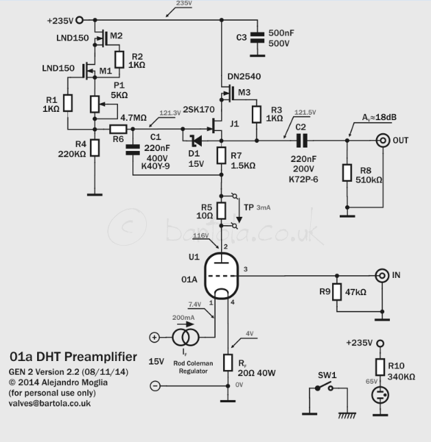

yes, the gyrator should provide a firm DC reference for the CCS, which itself is actually now a mu-follower. There are more than one way of creating this gyrator. For DC coupling, going from a simple cascoded CCS (as you draw in post #59) to using a gyrator reference is a very nice improvement. If you measure the DC on the plate for the cascoded CCS circuit vs. gyrator circuit, you will find the gyrator is far more stable. I don't need to tell you how useful a firm DC reference on the grid of your 45 tube will be.
The way Ale Moglia builds a gyrator is to use another CCS (the smaller LND150) on top of a resistor load. Simple yet effective. Fluctuations in B+ don't change the DC reference in this circuit, which is lovely if you are doing DC coupling. The only downside to Ale's gyrator is that you might get a drift if the LND150 gets warm (ie. you place the LND150 too close to the heat sink of the upper DN2540 or STP3NK60ZFP, etc). I have experienced this then had to change my layout... 😉
You can also entertain the idea of using the lower 'FET as a mu-follower.

I just read Ale Moglias description of his "gyrator" design again. And again. And again. And... there is light at the other end of the tunnel!
Here's my way of looking at the circuit (just in case I'll forget how it works I can come back here). The section made up from M1+M2+R1+R2+P1 is a small cascode CCS. The current out of this CCS flows through R4 to GND, so R4 forms a constant DC voltage reference (ignoring any thermal drift). This constant voltage is applied to the gate of J1 via R6 and sets the DC voltage the source of J1. D1 is a protection diode that doesn't do much during normal operation of the circuit, so I'll just ignore it for now.
The capacitor C1 does not feed back any DC to the gate of J1, so the DC voltage at the output of the whole circuit (i.e., the DC voltage at the source of J1) is controlled only by the voltage across R4. M3 decouples J1 from the raw B+ and drops most of the raw B+ voltage.
If the load (=tube) varies at AC and the impedance of C1 is small compared to R4, the voltage at the source of J1 is fed back to its gate; the J1 gate voltage is not controlled by the DC reference (R4) anymore. This means that J1+C1+R7+M3+R3 now form a cascode CCS.
In other words:
(A) At DC (when the impedance of C1 is larger than R6), the circuit controls the voltage on top of R7 to a fixed value (set by R4/P1).
(B) At AC (when the impedance of C1 is less than R6), the circuit works as a cascode CCS that sets the current through the tube to a fixed value (set by R7).
Please let me know if something is not right... anyways, applying all this to the 45 direct coupled amp, the first feature (A) is nice because it allows setting the voltage on top of R7 and thus provides some control over the voltage at the plate of the driver tube, i.e., the bias voltage of the 45 power tube. The second feature (B) is nice because the fixed current through the driver tube ("infinite load impedance") optimizes the linearity of the driver stage. (I know that you tried to explain this to me before, but it took me a while to understand -- most likely because the "gyrator" term is wired to something else in my brain).
You’re right. The circuit is a hybrid mu-follower. Perhaps the confusion is that we usually call it “gyrator” due to the equivalent inductor-like response of the CCS load. As R7 is “bootstrapped” in AC provides a high impedance load to the triode which gets the most linear response out of the stage.
The low-impedance output is achieved when the output is taken from the mu node. The most important thing for me is that: it sounds really good as is very neutral and doesn’t add any unwanted harmonics by the driver.
Also you can degenerate the cathode bias resistor without compromising much the stage gain and get even better linearity. This is good when driving large volts like in your case. Recently I posted some examples of very nice triodes (6e5p, 6e6p, 6j49p-dr, 6j52p and others) which perform brilliantly at 200Vpp. These are good examples to drive a 45 like in your case.
Ale

The protection zener (or back to back zeners, depending on the circuit) are there to protect the gate during turn-on and turn-off. Otherwise I think you now understand why this circuit is especially attractive for 'classic' direct coupled designs.
M3 dissipates the most energy, and is capable of dropping a LOT of volts, depending on the current, so long as the heat sink is big enough. I hook up the input/driver stage directly to the B+, with no RC dropping network. Its just not needed imho.
Check out mouser part nr. 532-529902B25G for an Aavid thermalloy part that I find quite decent. Aavid provides thermal resistance values for their parts, which is very useful for calculations.
In other words:
Well, almost. What's the preferred method to set the operating point of the driver tube? In my previous schematic with the simple cascode CCS, the idea was to set the (DC) current by the CCS, and the grid-to-cathode voltage fixed by the battery bias. If I use the "Ale Moglia load" to set the plate voltage, the fixed battery bias will force the DC current according to the tube characteristics (whatever they are). Would you leave this, or is it better to do the typical autobias with a resistor instead of the battery to allow some bias compensation if/when the tube characteristics drift away during aging? If not bypassed, the resistor would provide some local feedback reducing the gain a little bit and improving the linearity (as mentioned above by Ale). A bypass capacitor would remove the bias resistor from the AC, but would be in the audio signal path. I just seem to like battery bias for no good reason (except that it worked really well in another amp I built recently).
