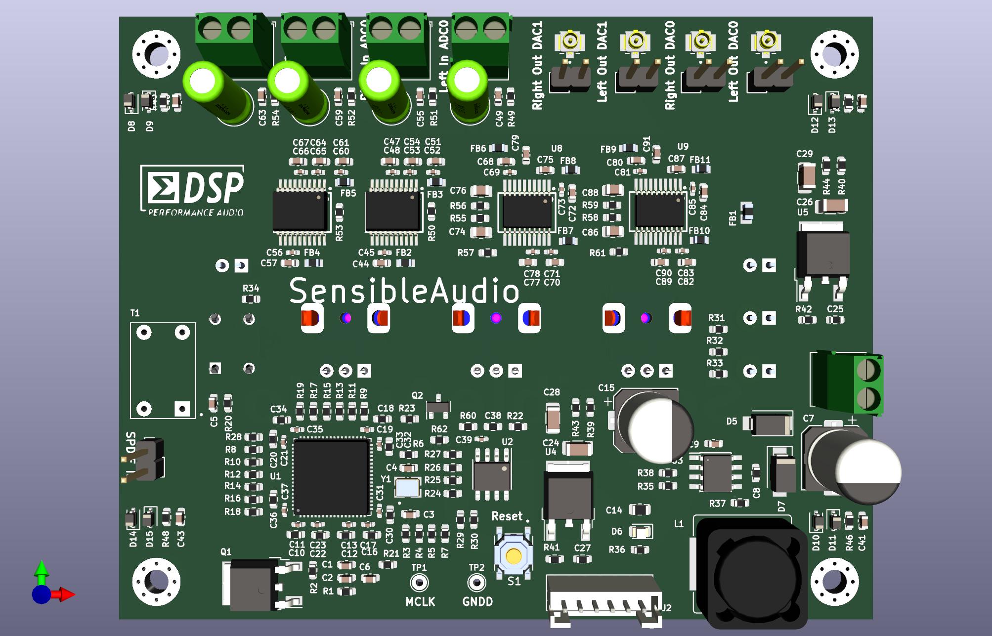

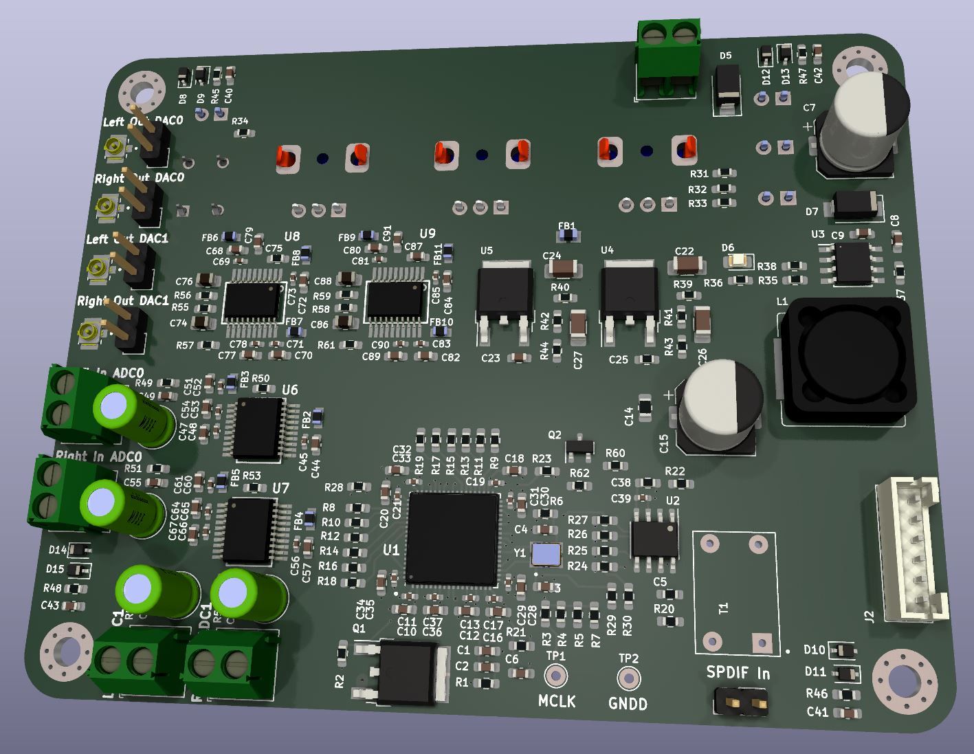

Getting there .... schematics sort of finished. Found a few mistakes, but need further review.
Placement done according to schematics v0.9
Routing 10% done
Was able to reduce size to 100 x 80 mm
Routing 10% done

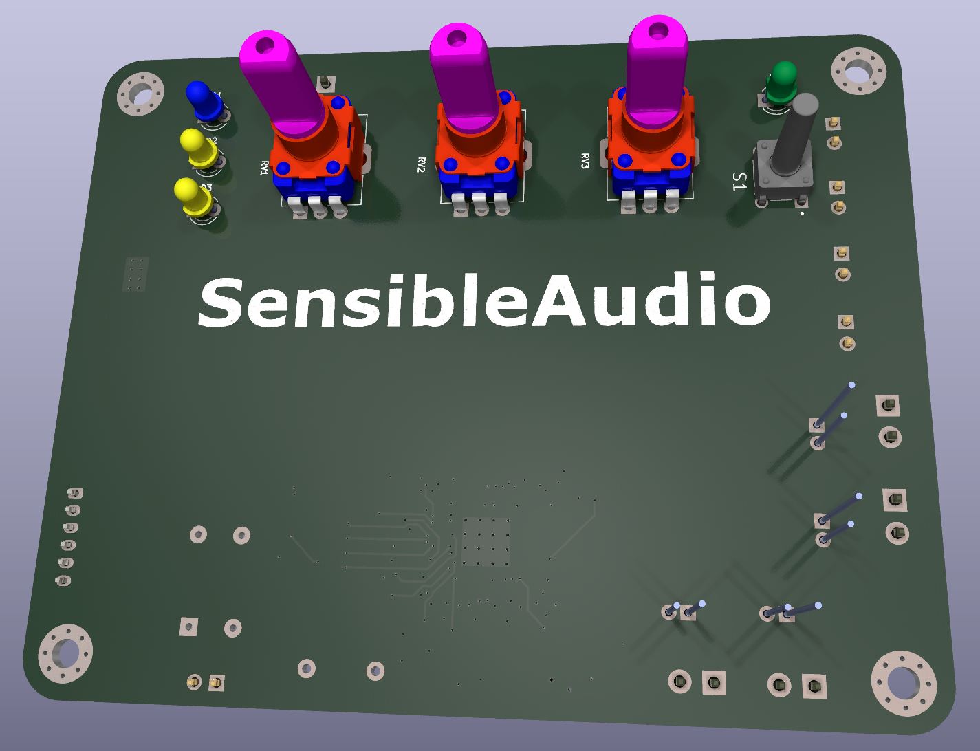

Was almost finished with the layout ... but my placement was not very good for separating GNDA and GNDD.
Unrouted it all and did a new placement with all analog stuff to one side. The ADCs and DACs are made so one side is analog and the other is digital, so having a split down through is easy to implement.
Let's see how the routing works out on second attempt.
Note: Again I'm really happy with KiCad 6.0, can't what it should be missing.

In an earlier post you mention resistors on the mclk lines to reduce ringing, I think it more of a case of considering them as transmission lines and the resistors are used to damp reflections from the ends of the line, I'm planning on a single resistor as close to source as possible and then fan out from there with even length lines.
Your way ahead of me on your board, I'm still on the PCM chips and part done the power section.

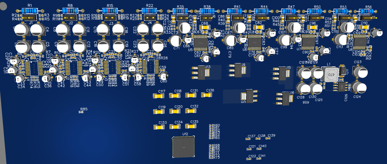

4 differential inputs with anti aliasing and CMRR filters, 8 pseudo balanced out, 48V (phantom power protected).
Looks Good SubSoniks
Lot's of electrolytic caps. Is that really necessary?
I'm planning on only using 10uF 0603 X5R + 100 nF X7R 0402 for all decoupling. Need to make an estimate of the total impedance vs freq to get a feel for where the max peaks are situated in frequency, to make sure it is not coinciding with any of the switching frequencies.
One thing to consider I think is the longevity of the caps. Chip caps would last "forever", cheaper el caps .... long but not forever
Is the Caps in input e.g. C11, C12 two caps in bipolar config?
Don't know if you get good bipolar caps as smd, but there are some good choices leaded, e.g. Muse, or Nichicon VP series ... uses less space on the board
What ADCs are you using?
DAC looks like PCM5102A 😉

Yes, PCM5102 for the DACs and PCM1802 ADCs.
Starting at the inputs, all C0G/NP0 filter caps for in the analogue path except for Panasonic FC 47uF in bipolar config (block 48V in and the 2.5 bias from the ADC), the FC caps are also used for the DAC outputs and the switching regulator.
I have used 10uF Nichicon (not low ESR) electrolytics combined with a small X7Rs for the ADC and DAC bypass, originally had all ceramics but after some checking it seemed to make sense to go with a combination, theory goes? that the the higher ESR would help damp potential resonances and also swamp the piezo effect of the smaller MLCC, I haven't gone so far as to calc the resonances and for this build will take my chances I think, hoping that the Nichicons will damp them down, hopefully...
The switcher I nabbed from your BOM 🙂
Rail voltages are: 12V main supply > Switcher - 6.7V > 3 x 5V (1 x 5VA, 1x5VD, 1x5V aux) > 3VA, 3VD and maybe a second 5VD I/O for the DSP.
Regs are LDL1117 ST, MLCC friendly using the recommended X7R values. I went with 1206 size as it looks like the larger package size have a more stable capacitance over a range of voltages.

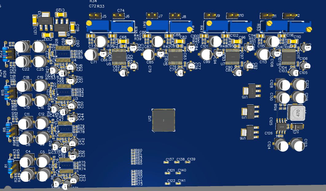

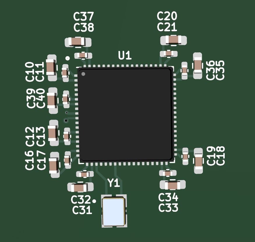

I think I'm also going to go with this new layout scheme to reduce the I2S track lengths.
Regs in the top right are the 5VA for the ADCs, the second drops the 5VA to 3.3VA for the analogue supply side of the DACs.

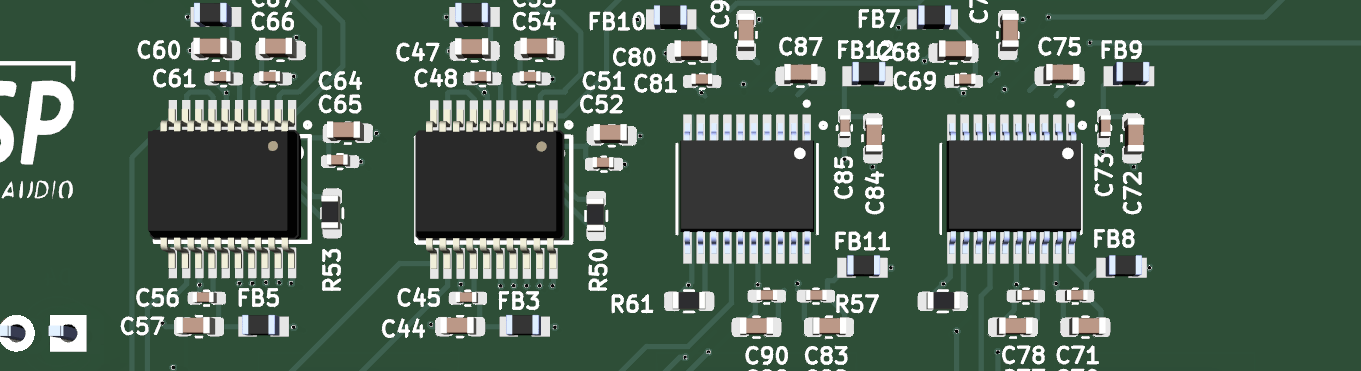

Maybe it's my eyes deceiving me but your PCM1802 footprints looks quite narrow (compared to the PCM5102).
The casing on JLCPCB is the SSOP (DB) | 20 ..... I'll check my own board ... might be me
PCM5102A uses TSSOP (PW) | 20

Phew, well spotted, I have used the wrong footprint, mistake due to easyeda library not having the part in the program but is available in the jlcpcb pcb manufacture library (but no footprint in the parts library) so had copied another as a place holder and forgotten to double check it.Maybe it's my eyes deceiving me but your PCM1802 footprints looks quite narrow (compared to the PCM5102).

I have been assured by JLCPCB chat that they will populate it though.
Another large session to fix as no space for the bigger footprint🤣 but at least you spotted it👍🙂

Only the mclk re lengths, I plan to place one damping resistor as close to the DSP as possible and fan out with equal length lines to the PCM1802's, may not be necessary but is a technique used for high speed clocking on DRAM chips etc. No mclk for the 5102's and agree that the timing re the analogue outputs is a non issue.

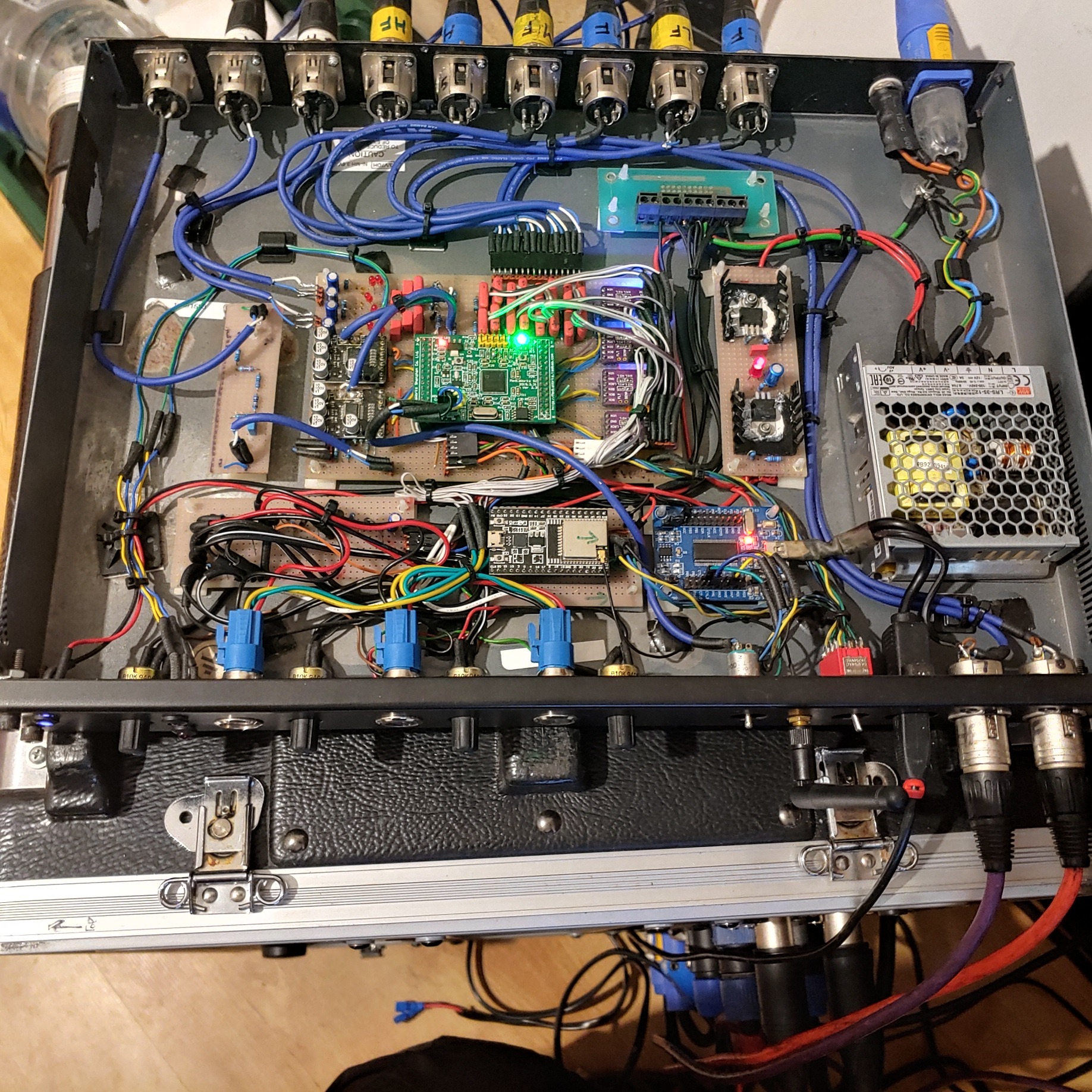

My current DSP:
So you have the programmer always connected and always on?

USBi is powered by USB cable, SPI to DSP, does not matter whether I power up DSP before or after connecting USB cable from PC to USBI. So long as the same SS schematic is in the DSP and loaded on the PC then just link/ compile and can plug/unplug freely and will just work.So you have the programmer always connected and always on?
