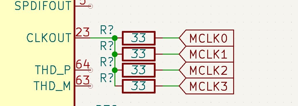

Looking at clock fanout:
As there will be 2 x ADC and 2 x DAC we'll need 4 clock lines.
ADAU1452 is able to provide 53 mA at 3.3V on all logical pins including CLKOUT.
The clock frequency will be either 12.288 or 24.576 MHz.
On the EVAL board, and on all other schematics I've seen all logic pins have been connected through 33 ohm resistors, I guess to slow the edges a bit, 33R in combination with the capacitance of track to GND plane + input capacitance of receiving chip.
Track cap will only be a few pF, and so will the input on the receiving chip .... let's say 5-10 pF total giving a RC Fc = 500 MHz - 1 GHz
https://chemandy.com/calculators/rectangular-capacitor-calculator.htm
Makes sense, and can probably reduce some ringing on the clock signal
Question is whether the ADAU1452, can drive the 4 chips directly or we need to insert a buffer?
Inserting a buffer or a number of these will introduce a short delay .... not sure this will have an effect, but the ADCs and DACs will have a clock which is something like 5-10 nS "behind" .....
PCM5102A only draws 10 uA on the inputs, at 3.3V this is an impedance of 330k, probably the same for PCM1802 .......
I would think it is safe to drive these 4 clock lines directly ..... any thoughts?

4 chips load is not difficult for ADAU1452 if the board traces are not so long and limited in the same board.
The resistive load will not be a matter, but inductive and capacitive loads should be considered.
If you want to have headers for external ADC/DAC boards, I recommend adding a driving buffer and resistors near the DSP MCLK output.

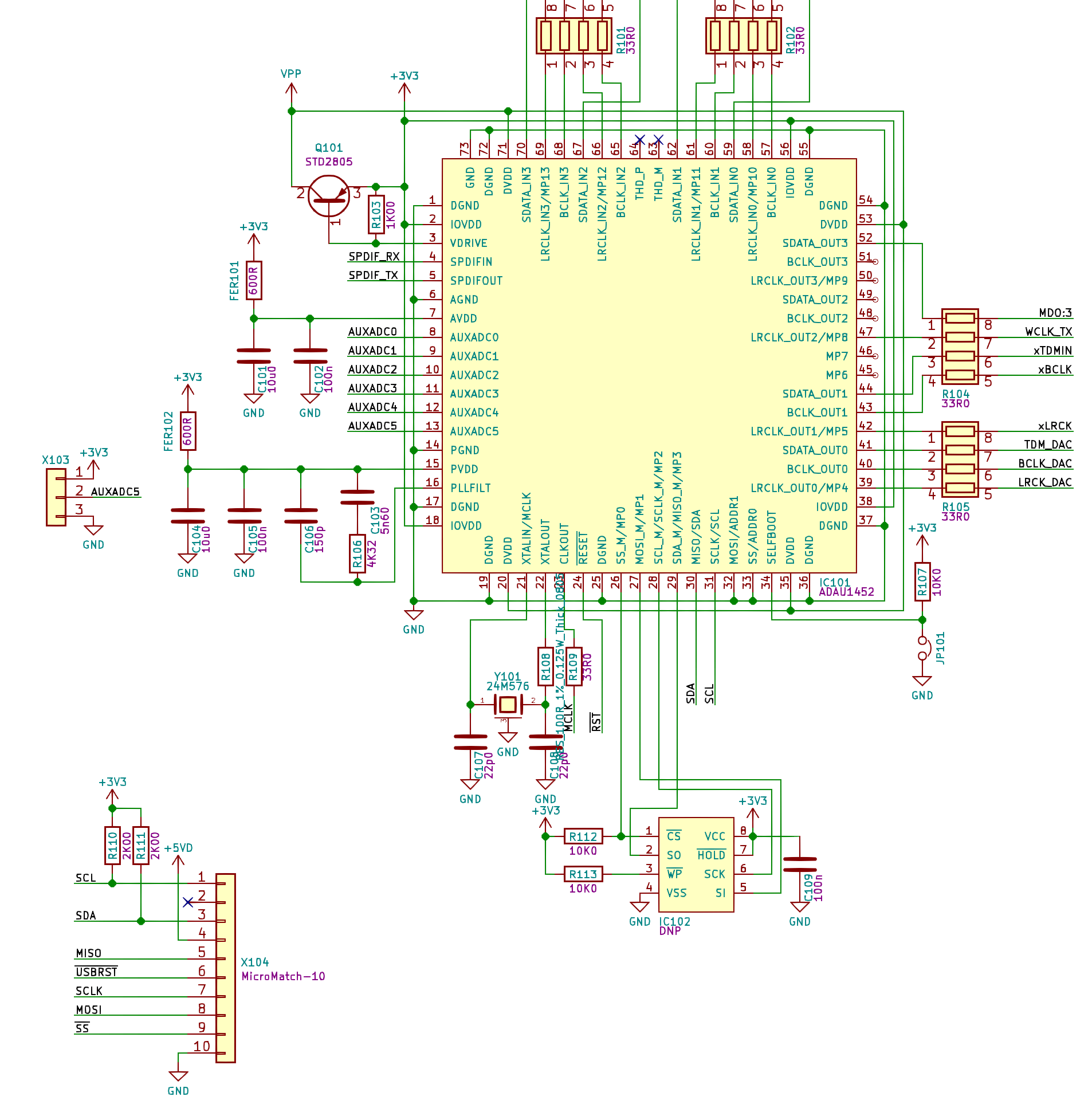

Hi Baldin-San,
It is difficult to choose I2C or SPI. So, today I went to Akihabara to buy some I2C EEPROMS (24LC256, 24LC1025)
I'll try to modify the MusicWorks1466 daughter board switch to the I2C mode. Some trials will lead me to the conclusion(Hope so...)
Not totally sure about FSYNC on PCM1802 ... in slave mode I can't see it needs to be connected ...
You need to connect FSYNC to HIGH. It works as a gate switch of BCLK.

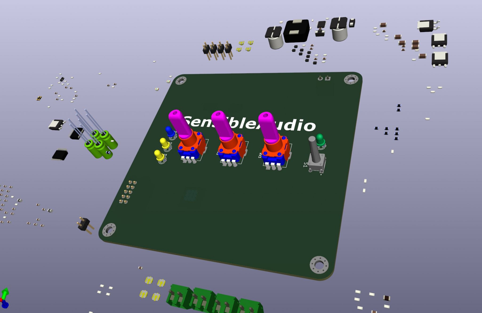

Have been working on the schematic and defining all the components in KiCad.
Really happy I did the jump to KiCad. It has all the features I need, and is relatively easy to use, and not so different from other tools. I'm getting the hang of it I think 🙂 :up:
Have not found any good alternatives to STD2805 for the low voltage drive (LDO) on JLCPCB ... any suggestions? Need to have high Hfe. .... can of course be had on Mouser
Settled on SIP for both programming interface and EEPROM.
Slowly starting the PCB layout ... placing components for plate amp use ...
Happy to hear any comments on schematics, and especially if I have made any mistakes ... thanks in advance 🙂

Have been thinking and reading a bit more about decoupling caps.
Plan was to use 10uF X5R 0603 || 100uF X7R 0603
The pcb will be 4 layer, and I'll dedicate the 2 inner layers to Vcc and GND. Unfortunately the inner layers are divided by a 1 mm thick core for the 1.6 mm pcb, and therefore not close enough to act as a large cap. If you pay you can of course have it 😉 ..... So placement of the caps becomes important.
So consider using 10uF X5R 0603 || 100uF X7R 0402 .... and hoping I will not have to do any hand soldering of the 0402s 😉 ....... on the other hand, when using the assembly service, there is no good reason not to go for the smaller casing reducing the induction in track length, and the parasitic inductance of the component itself
