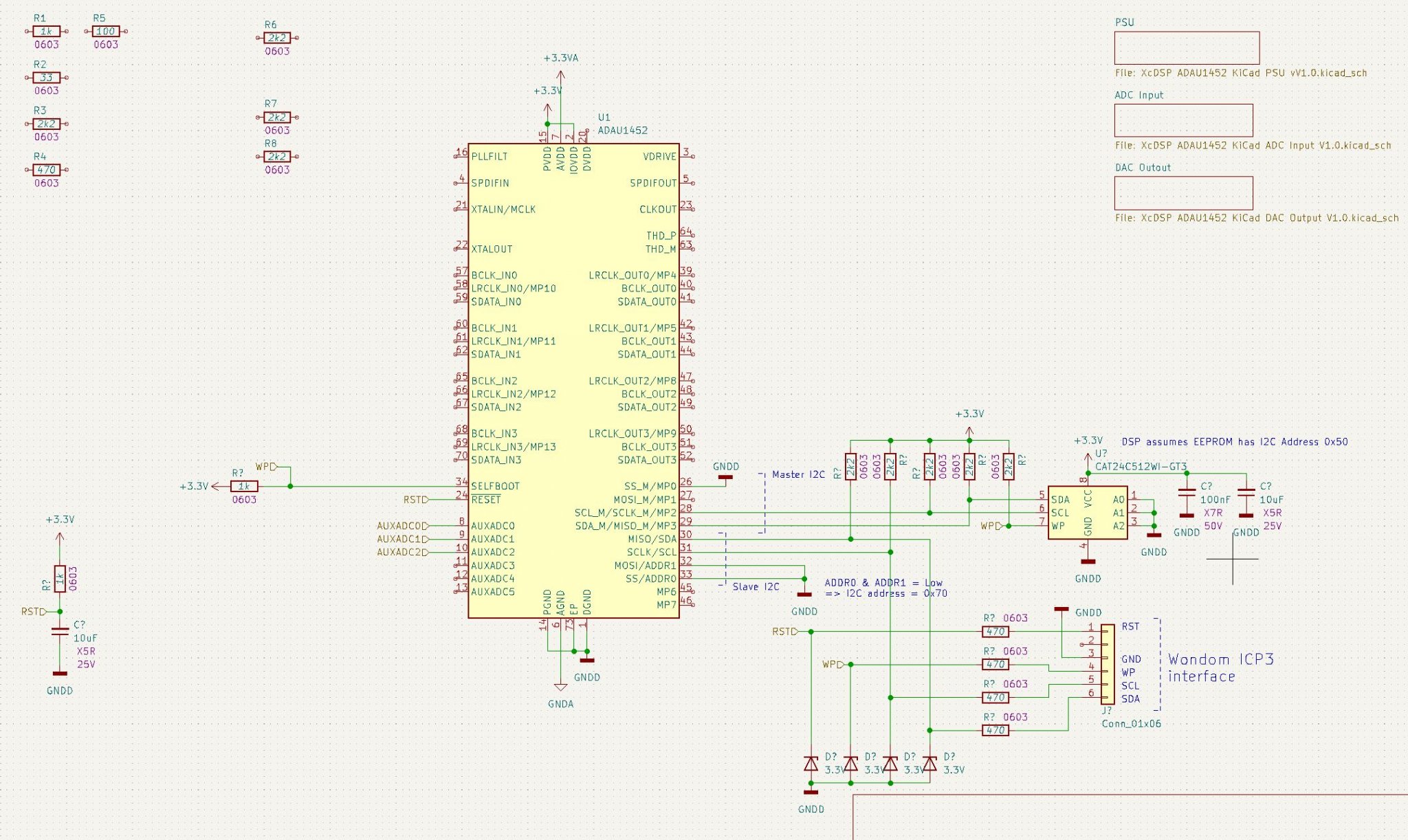

Have decided to start using KiCAD. Seems to go ok, but a steep learning curve going from Altium/Protel.
Have started looking into the programming side of things.
For my ADAU1701 builds I have been using the Wondom ICP3 programmer, which is an I2C programmer. It uses a Cypress CY7C68013A-56PVXC, think very similar to the one in USBi, so I guess the SPI lines could also be made available, but it's not routed to a connector. There are som extra holes in the pcb, which might be for exactly that, but no markings to be found.
On the other hand I also like the smaller connector used with fewer lines than USBi, but it gives a bit of headache trying to figure out how you can connect this to ADAU1452.
Reading a lot on the net and in the manual, I have come to the following ... see schematics.
On ADI Engineer Zone I found information that SELFBOOT needs to be pulled low when programming the EEPROM through the DSP.
https://ez.analog.com/dsp/sigmadsp/f/q-a/65986/adau1452---selfboot-i2c-eeprom
There is a WP port on the ICP3 which I hope and guess pulls the WP pin on the EEPROM low when programming. I'm thinking that this can also be used to pull SELFBOOT low at the same time?!
Anyone tried to use I2C in stead of SPI for ADAU1452??
PS. Just saw that SS_M should be pulled down via a 10k resistor, and not directly to GND. ... have corrected this

My board is configured to use SPI for both Cypress to DSP and DSP to EEProm which is x10 the bandwidth of I2C.
For WP pin on ADAU EEProm - connect IOVDD via 10K resistor and leave it at that.
For selfboot, I have fitted a switch, IOVDD for self boot and GND for writing through to EEPROM, I reset by power cycling the whole unit at the AC mains in.
For programming the DSP I'm using this board with the firmware in this thread:
https://www.diyaudio.com/community/...-using-cypress-cy7c68013a-board.269111/page-3
So far it has been 100% reliable. there are schematics on the web for this board and I intend to incorporate it onto my new DSP board.

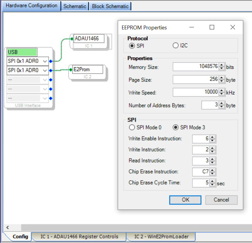

My SPI steings in SS are:

Hi SubSoniks
If you put WP to IOVDD via 10k I think it will bee seen as High, meaning Write Protected?
Or?
Or?

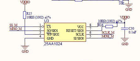

But that is also a SPI EEPROM, and here it seems WP is active low (the line above WP), so different from I2C EEPROMS

Core board uses same EEPROM and can be configured using I2C from USBi or SPI.But that is also a SPI EEPROM, and here it seems WP is active low (the line above WP), so different from I2C EEPROMS
Note that the SS loads into DSP, not directly into the EEPROM, the DSP connects to the EEPROM. You can have SPI USBi and I2C EEPROM
Core board is configured as SPI EEPROM and can be configured as SPI or i2C USBi
Sure I seen you can mix SPI and I2C using either or on the 2 SPI/I2C busses on ADAU.
I'm sure I'll have the least problems using SPI, as I have not really seen anyone using I2C .... need to consider this.
