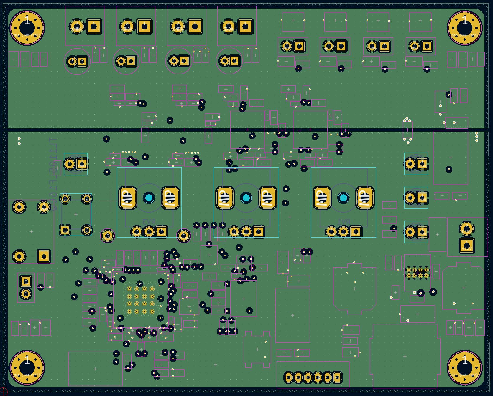

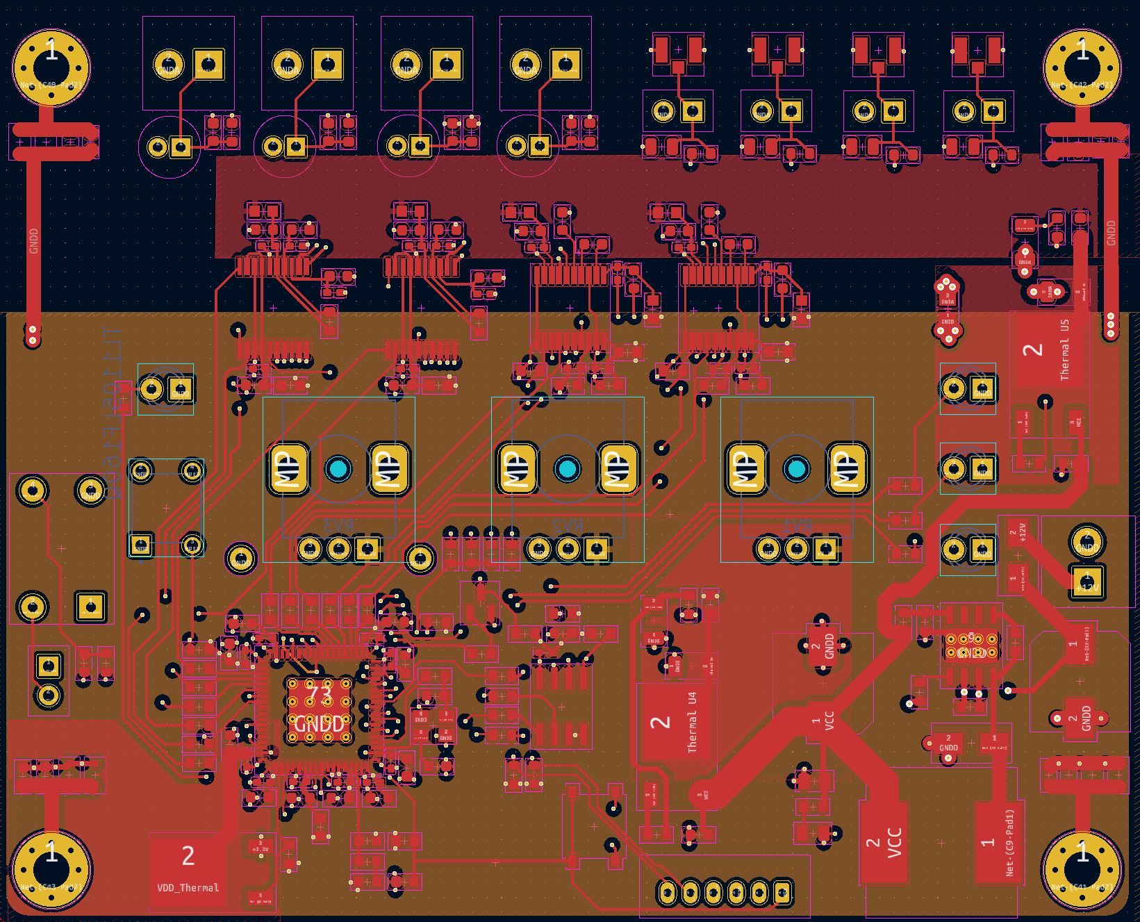

A bit of PCB insight:
Almost unbroken GND layer and Power planes
Top part of PCB is Analog GND and Power, digital below.
GNDD and GNDA divided by a ferrite bead
Quite satisfied with this result

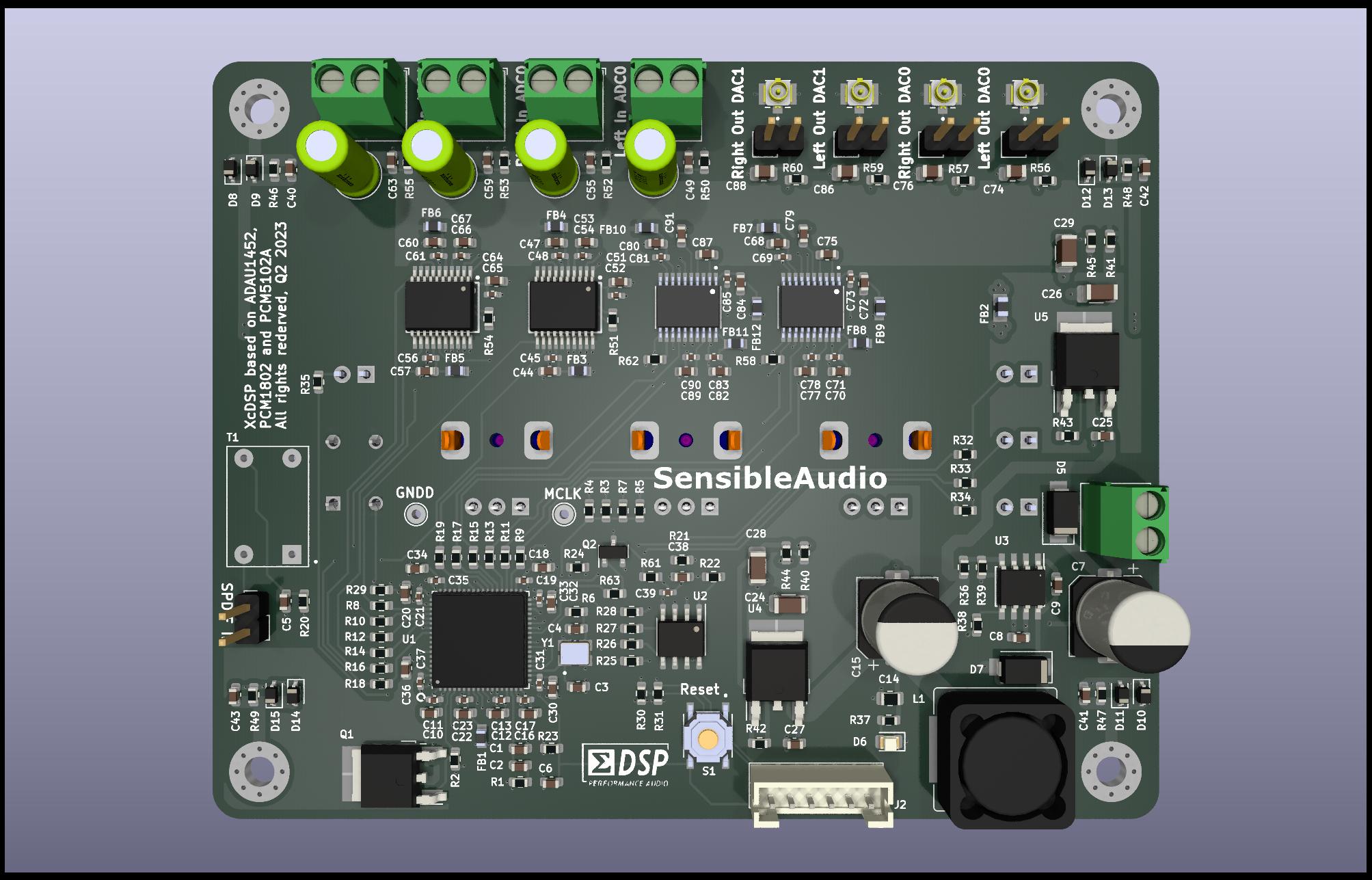

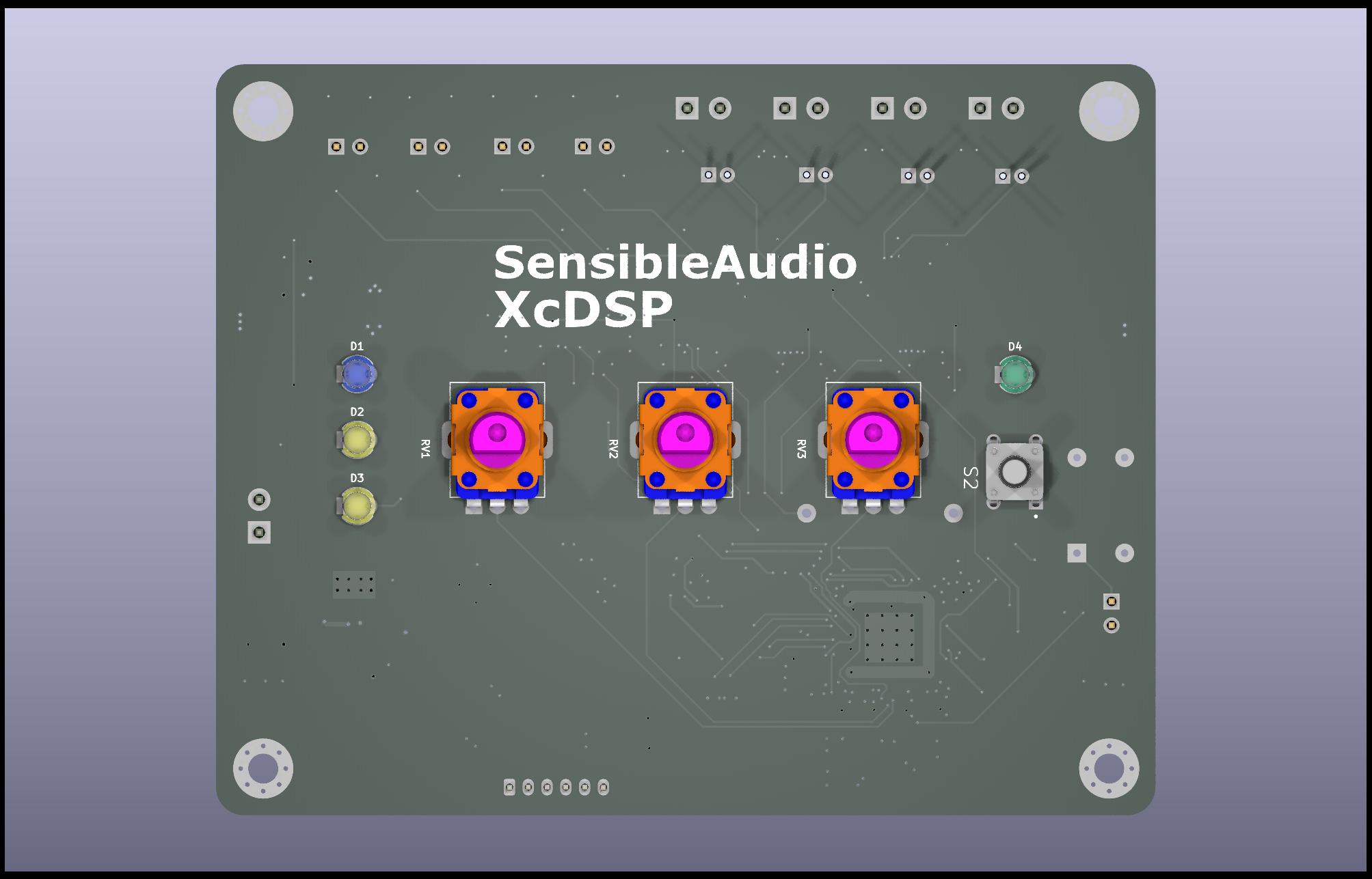

PCB sent of for production. Cost ca. 150 usd for 2 populated PCBs (few components will need to be hand soldered) ... so hope it works 😉

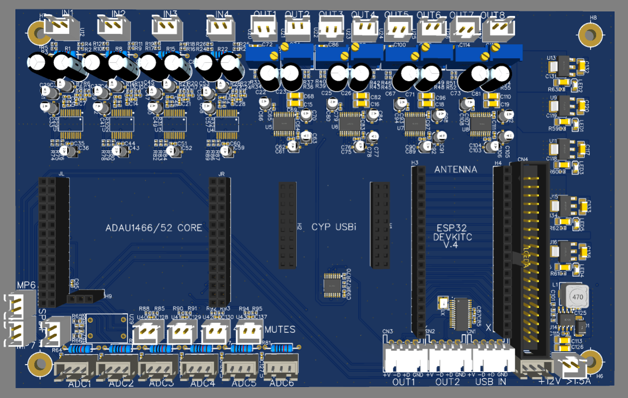

Fingers crossed for you, I'm doing some final checks on my board now. I've decided to go with my existing ADAU1466 core boards, partly because the ADAU1466 'was' not in stock and all my SS files are for the ADAU1466, would take another load of work to redo them. Also if I've messed up, the cost would be higher, I have space on the PCB to modify for a version 2 and build everything onto the one PCB, will use this build to test all the Cypress, USB hub, Multiplex SPI switch, ESP32 interface plus DAC's and ADC's. If all working they will still be put to good use.
This is being built as a 4 x differential inputs +SPDIF (padded down and transformer isolated to accept AES/EBU input, 8 x impedance balanced outputs. USB hub for connecting Cypress and ESP32 and a multiplexer to switch the SPI control between the Cypress and the ESP32, plugging in a USB cable should auto switch to Cypress as SPI control.
With minor mods, this board can be configured to:
Inputs = 8x SE analogue in + 2 x SPDIF (10 channels in) OR 4 x differential inputs + SPDIF (current config)
Outputs = 4 x full differential outputs (@4VRMS) OR 8 (@2VRMS) impedance balanced (just don't connect '-' and becomes SE)
Edit, just to add that the I/O caps are bipolar 50V for 48V phantom power protection.
4 layer board, 5V analogue, 3.3V analogue, 3.3V digital, 5V digital for DSP and 5V auxiliary for ESP32 and Cypress all fed of the same switcher but using a 5.7V rail for LDO regs to reduce temperatures.
Ground plane is unbroken except for through hole components.

For anybody thinking of using EASYEDA for a board of this complexity, it has become like surfing treacle, approx 15 seconds to add one just VIA 🙁
What do you mean ..... KiCad is running slow??
Don´t think EasyCad is made for this complex tasks ...
KiCad is running really well for me ... fast and really competent .... so if it takes 15 sec for a via I think something is wrong in your setup/installation!

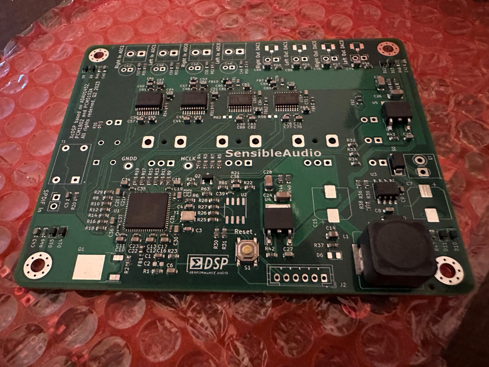

Got the PCBs back and have started testing.

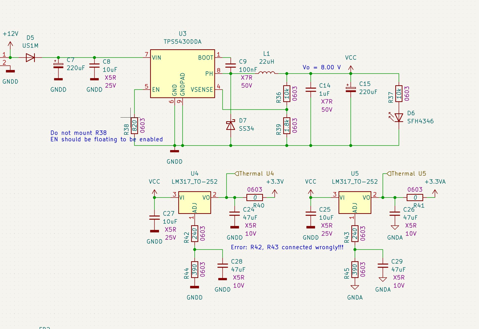

I'm glad I had put in 2 0R resistors between regulators and the circuit, so I can make sure the voltage is ok before connecting it to the DSP circuit! Good practice 😉
A review more would have been in order, but of course I had not looked too much at the LM317 circuits, as how could this be wrong .... well guess again ... take a look ... result is 7 V instead of 3.3 😱
Well not so difficult to fix, but come on.
Also for some reason had ties the Enable on the switcher to GND, making it not start. Removing it, and it started and worked as expected 😉👍
