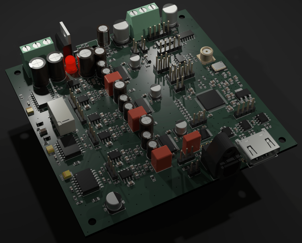

I'm also working on an ADAU1452 board, with 3 stereo DACs output. I'm using PGA chips for volume control (with an Attiny45).
Power supply board is separate, input via HDMI connector (LVDS receivers/transmitters) or TOSLINK. I'll run it at 24/96.
Layout is mostly done, I still need to change a few of the connectors throughout the PCB. I also put a latching relay so I can have a separate output for headphones (with EQ from DSP). Size is 100mm x 100mm, 4layers.
Hopefully I'm building it in a few months.

ADC is separate but I can sync them.
I'm using CS4398, good enough for my needs.
Ground plane is split, on ADC PCB as well. I'll see how ADC behaves and if everything's fine I'll keep it the same for this board. ADC PCB is on its way already.

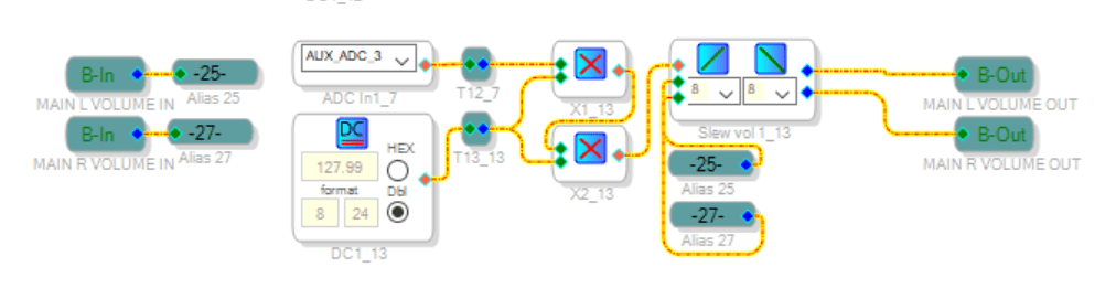

Volume control can be done in the ADAU using the onboard ADC and routed as you please, IIRC a 10K resistor, a 2K linear pot and a capacitor.View attachment 1137076

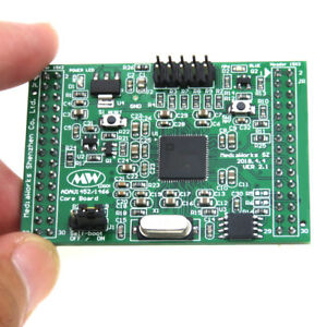

I haven't gone down the PC route as mainly interested in the adau for live sound out and about. An adau14 system can be cobbled together with core board, pcm5102a / pcm1802 modules and a cypress programmer, 8x8ch for under $100, upto 20,000 taps capable.

But back to hardware DSPs, just about when I tuned out of that market segment the ADAU1492 was just becoming available. I recall that it is heads and shoulders above the ADAU1701, so I am surprised that there have not been a slew of products using it now, and cheap enough to be affordable. Are there any?
You can get this kind of modules on ebay, for around 50$.
