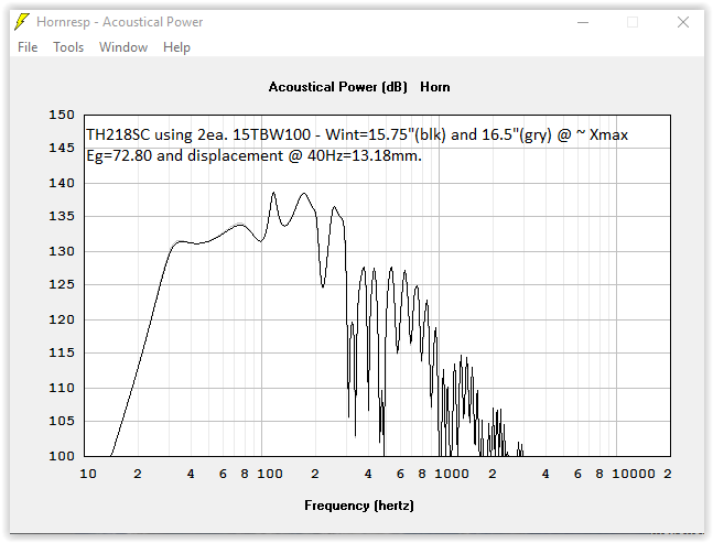

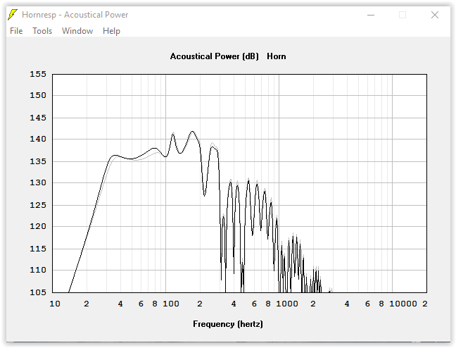

Here is the version w/ the reduced L45, and associated changes. This would be what I'd go w/ if I were to build this kind of double TH for the 18TBW100. Within the range of TRY_3 (Post #518) and this one the simulation seems to be quite stable.
There are still a lot of little things to be worked out, like the bracing, and possible suggestion for filling around the driver/throat, but this is pretty much it. I think it goes without sayin, that the suggested 3/4" plywood is a little on the light side, 1" Baltic birch would be better (and heavier...); maybe top and bottom from 1", and the rest from 3/4"?
This looks pretty cool! I'm looking for a ~40hz TH around 8-12 cubes gross for the pair of 15TBW100 I've already got. Should I go off and sim this with a 16.5" internal width?
Hi turbodawg,
Like this....
Awesome, will take a look at it when I get home! Thanks!!!!

One Question: is it possible to reduce the internal Height to 535mm?
Reducing W_int of TH218SC
Hi USRFobiwan,
Post #546: "...is it possible to reduce the internal Height to 535mm?"
I would think so. Here is a listing of W_int v. compression ratio:
22.5625"[573.1mm] = 2.5
21.0625"[535.0mm] = 2.68
18.5"[46.99mm] = 3.05
You'll loose a little of low end extension, and Hornresp does not reflect compression related losses.
P.S.: Always check my math...

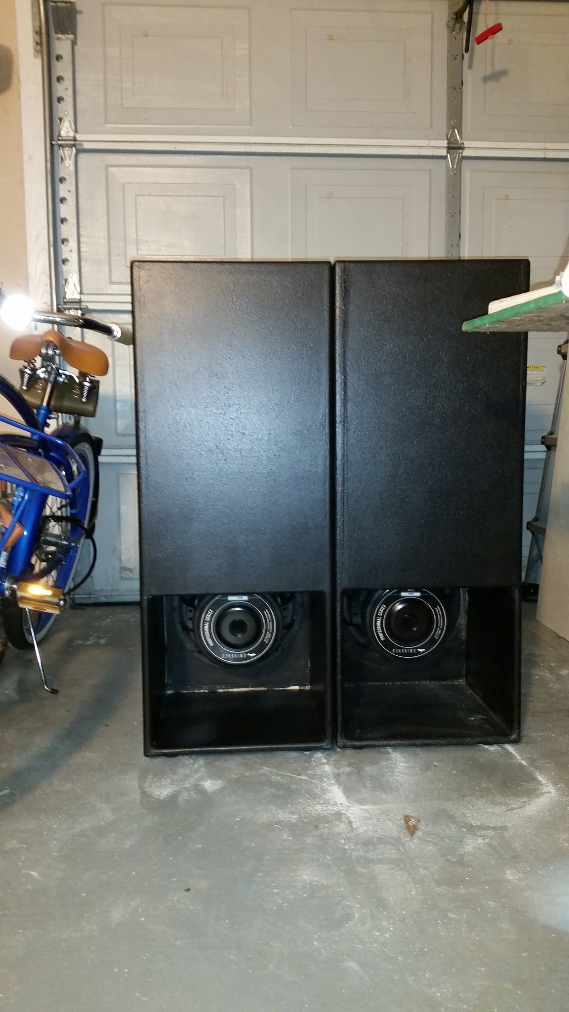

Here's my build:
PAL12 Build - Album on Imgur
Used an Eminence LAB12C, and it sounds great! Managed by a Behringer DCX2496 and powered by an iNuke 3000 bridged 4 ohm mono. When I build the second, and run it unbridged mono since the iNuke will do 2 ohms, but it's not a huge fan of 2ohm loads.

Behold: The Beatsie Boys
Here's my finished pair. I'm a DJ, and these are paired with a set of powered tops, controlled by a Behringer DCX2496, and powered by a Behringer iNuke 3000 configured as 4 ohm mono. I have a 32 Hz high pass 48db BW filter, and a 110 Hz 18db BW low pass, sending the rest up to the tops. It sounds great, but the 3" polyurethane wheels rattle when the bass hits, so I have a pair of bungee cords to wrap around them when playing. I had a naming contest on Facebook, and so far "The Beatsie Boys" are in the lead.
One cool part about these subs is with them paired together configured as L-C-R, they are the perfect height to serve as my DJ console! Not sure my laptop HD will be pleased with all the shaking though.
