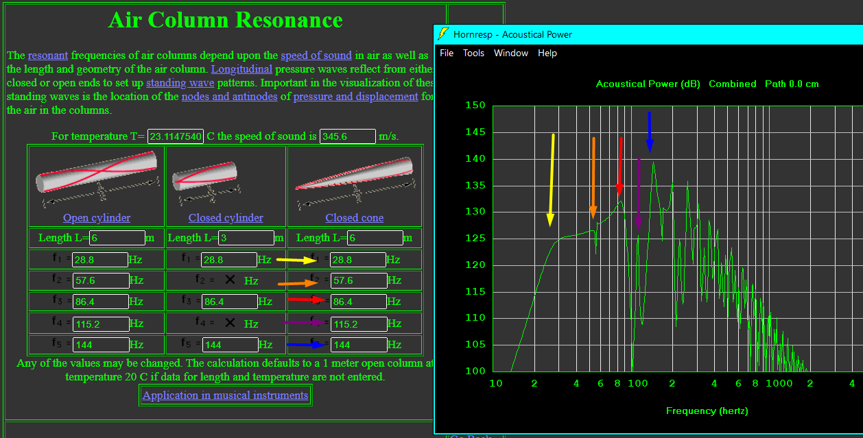

What about the usable bandwidth and intensity of the 1/4 wave resonances that pollute the top of the ‘band pass’ affect making the name or typing ‘bp6s‘ over and over almost pointless ?
why does the tapered shape make such a clean/smooth easy to manage bandwidth and the expanding path shape leaves you with a very abbreviated bandwith and intense 1/4 wave resonances up top that are hard to deal with?
I wouldn't BUILD an enclosure with a dip in the LISTENING response like that.

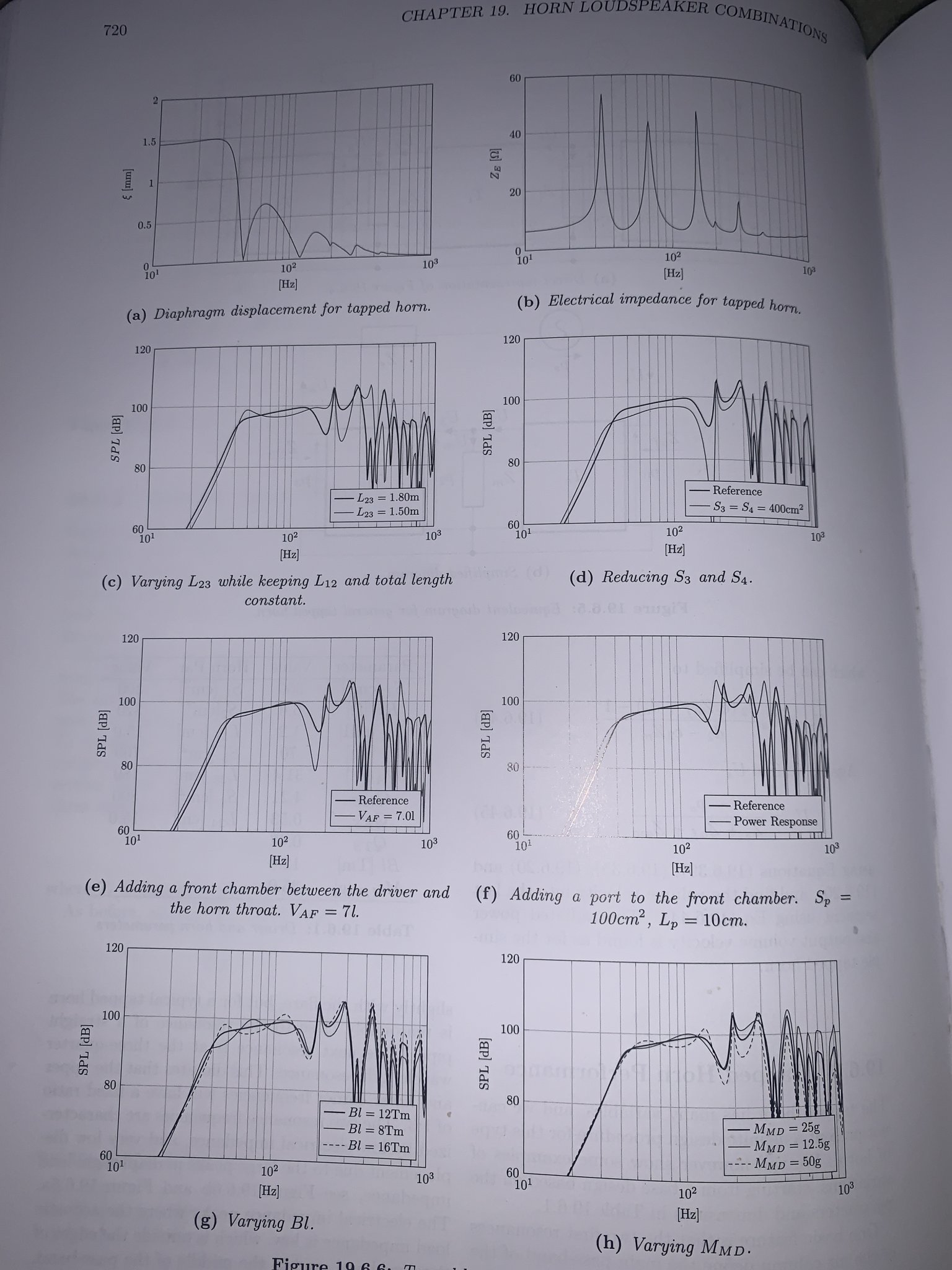

Here’s some really good info from Bjorn Kolbreks book on horns, etc (interesting how Bl boogers up the shape of the response at various freqs)
goofy Voight Pipe with driver offset position canceling out the 57.6 hz resonaceI wouldn't BUILD an enclosure with a dip in the LISTENING response like that.
Where are the aeronautical engineers???
I thought it was referring to a variety of TS parameters and/or electrical/mass/motorforce values and how they reacted to changing shapes and rearranged resonators bits and pieces?
