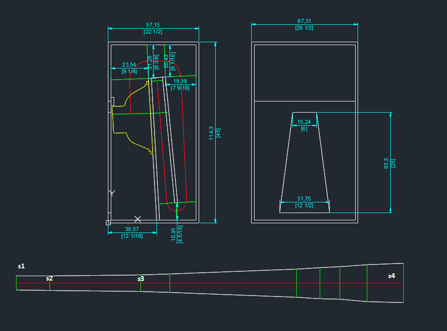

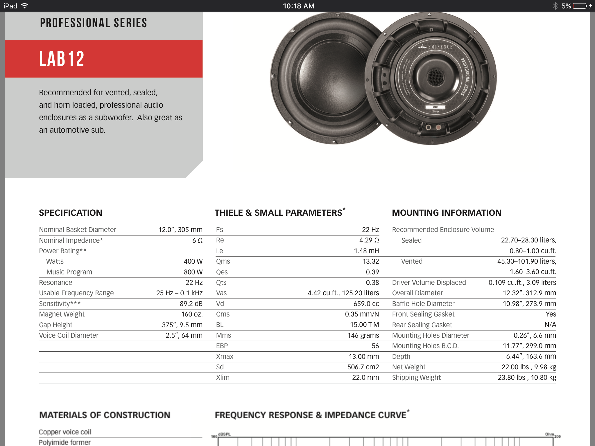

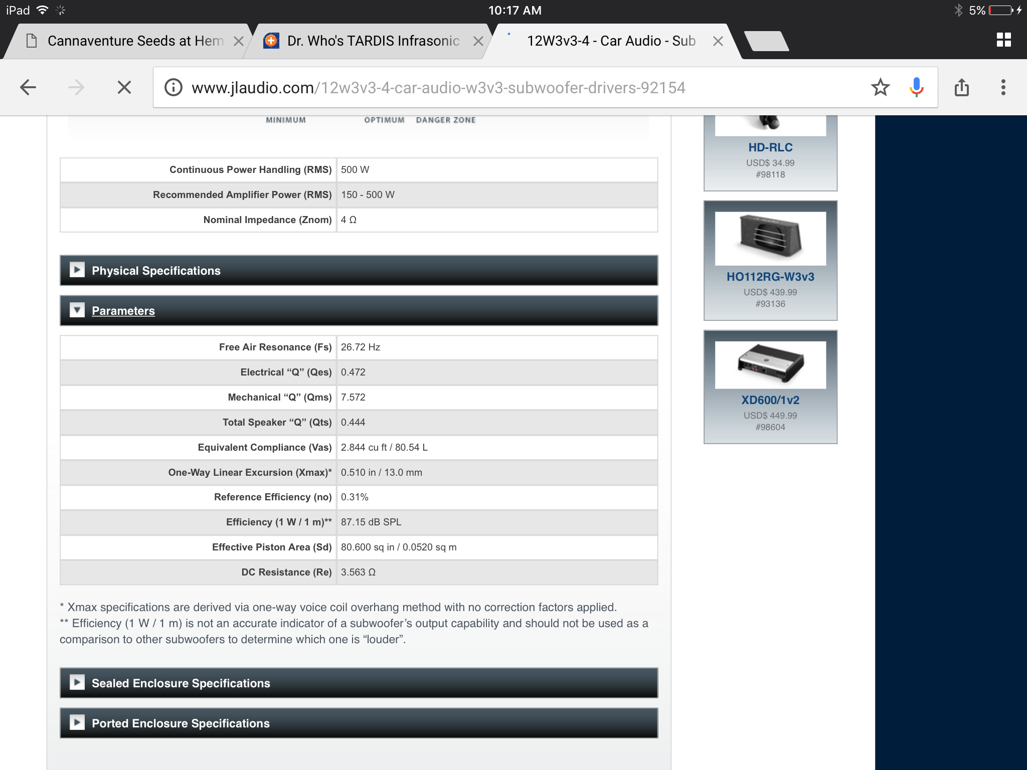

Looking to build a PAL12 and have a JL 12w3v3-4 sitting around. Some of the T/S parameters seem similar to the Lab12, while some are pretty different. I know this is a hard question for some to answer, but will this driver perform adequately?
B&C 12TBX100
Came across this thread. Since I have 2 B&C 12TBX100 laying around NOT making noise, just give it a shot. This design seems very friendly for various drivers. They are cheaper than the LAB12!! handling 1000 watts (on paper, not in this horn).
I plotted it with power at the xmax of this driver, which turned out to be 750 Watt. Picture 1.

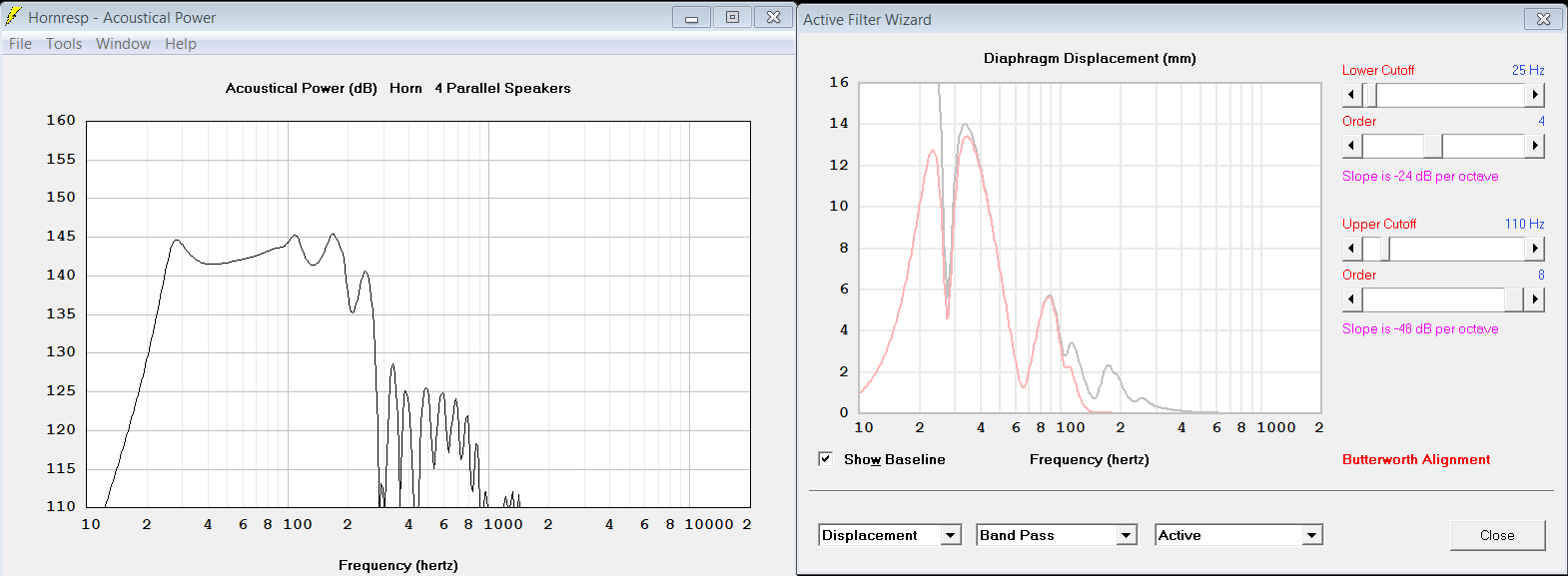

Also designed this fold type with the B&C 18SW115, a bit higher, deeper but of course much wider (175% or so). Easy at 25 Hz. Added a pic of the SPL with 675 watt (per driver), placed IN CORNER. Picture 2.

My version with the B&C 18SW115 is 102 x 88 x 54 cm. Not a monster but, yes, it is bigger. You would need at least 2 to party in small clubs, 4 to have them running relaxed for hours keeping all ears of your audience in good shape. These boxes can produce serious SPL levels, the B&C is supposed to be able to handle 2 - 3 kW each. The graph was 4 TH's @ 675 watt each.
