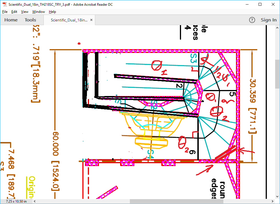

In my drawing of the Keystone enclosure the flare angle changes from 2.24° (1st section/down) to 3.43° (2nd section/up) to 6.33° (3rd section/top) finally 1° coming back down to the driver, and beyond. Obviously, the Keystone mouth (exit) has something to do w/ all that.

Wat if we make the design a bit deeper, 120cm or so. Maybe we can reduce width a bit this way. Also what if we turn around the First section, so going oposite direction. What if we close the front and exit to the top side. Large keystone exit

The large Keystone exit (Post #523) on the large box surface, or greater box depth are complete redesigns; also remember, Art arrived at the Keystone shape and size through a long series of tests, and so far nobody has reported any results of trying to rescale these dimensions (might well work, but...).
This box/driver combination likes the big mouth, so I'm going to keep that. Changing just S5 does not look like a positive change, but it will give a bump at the bottom of the passband while loosing in the middle. One change that improves the response through the upper passband is to shift the driver closer to the mouth. The big change comes from increasing L34 while using the Wizard to automatically decrease L45, it flattens things, and the filtered response improves nicely too. The resulting changes in L12 and L23 don't make much difference. So, I might give that a try. But, it takes quite a bit of time to move the whole horn path (which is required).

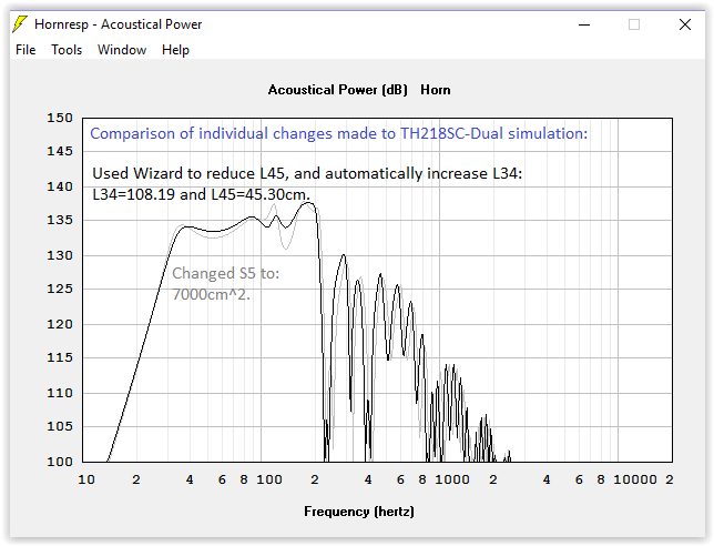

The improvements in Post #526 look too good to be true, so I went over the figures again, and sure enough the internal width I used in a spreadsheet to calculate the areas was wrong resulting in a bigger box. Sorry about that, but the direction of change seems to be correct, so back to the drawing board if I can stay awake.

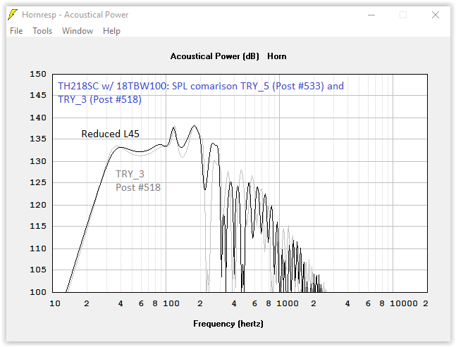

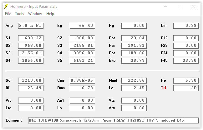

Hi Y'all,
Here is the version w/ the reduced L45, and associated changes. This would be what I'd go w/ if I were to build this kind of double TH for the 18TBW100. Within the range of TRY_3 (Post #518) and this one the simulation seems to be quite stable.
There are still a lot of little things to be worked out, like the bracing, and possible suggestion for filling around the driver/throat, but this is pretty much it. I think it goes without sayin, that the suggested 3/4" plywood is a little on the light side, 1" Baltic birch would be better (and heavier...); maybe top and bottom from 1", and the rest from 3/4"?

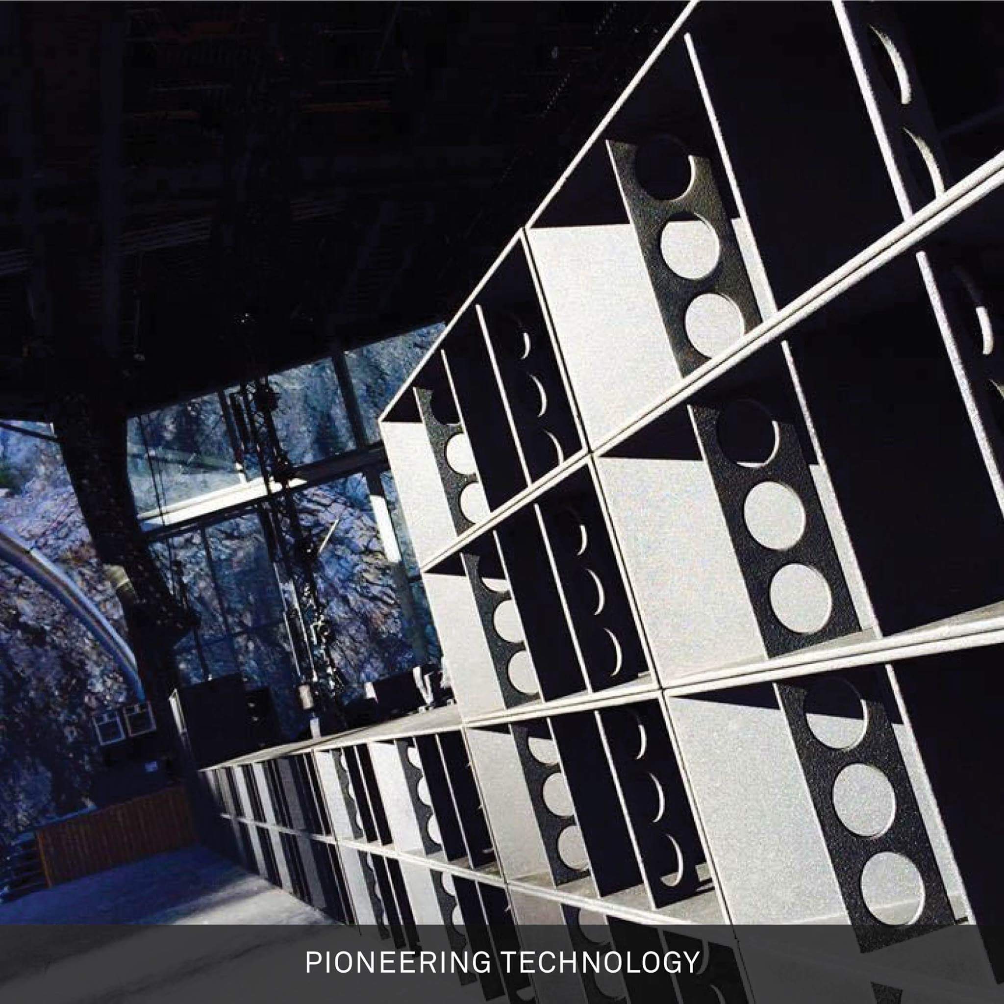

The most brutal bass I've felt was a 8-stack cluster of funktion1 218 cabs (tho it was a total of 24 over the whole stage but I pretty much put up camp in front of that stack all festival 🙂
Would a similar clustered TH stack behave in a similar manner when clustered many together? The f1 cabs are rather poor sounding to my ears when in small stacks but this was absolutely beautiful. I've got the impression that many THs clustered gets quite a bump down low while this is the natural environment for the FLH stack.
Included the image from the festivalrig, when you got out in the middle-row of subs it was like there was no sub at all compared to infront of the stacks
Its nothing at all like the F1 F218. It is a FLH design like all other short path horns, the added photo looks more like the F221 but i can be wrong. It is just one bend design, the same like turbosound TSW etc. Some have reversed drivers inside but the design is pretty standard. If you want to compare the TH218SC to others. the closest is something like the (yes them again) DSL TH221. Although I do not know the internals of that beast.

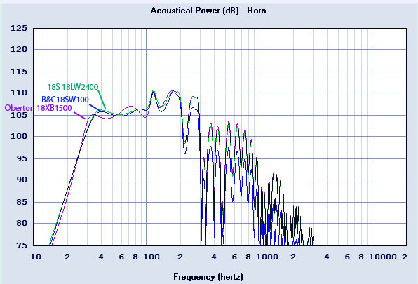

Thanks Oliver, I am going to sim a couple of other drivers in it to see how well it keeps up. I will post the sims here.

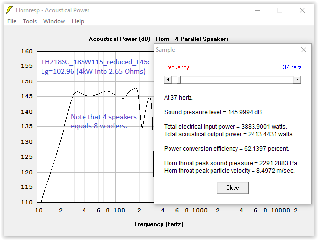

I'll attach a simulation and SPL graph for a cluster of 4 boxes (8x 18" woofer), this will give you an idea. I used the B&C 18SW115 for this simulation, and a nominal power of 2kW into each driver. The efficiency is quite nice. 🙂

Wow that efficiency numbers are very impressive! Not seen that high numbers ever before in a stack.
Will a total of 16k nominal result in a continuous 3k9?
