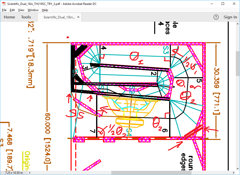

TH218SC_TRY_1
Hi Y'all,
Here is where I'm currently at with my attempt at a tapped horn drawing w/ cone correction. This could use one more run-through, and additional braces, but the sketch is already cluttered enough. It's a large box. 🙂
Hi Y'all,
Hi Y'all,

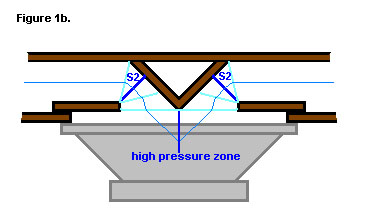

Cone correction provides for a reduction of the compressible air volume in the throat giving you more "control".
It's so good to get some actual information from a person who has built and measured one of these boxes, there has to be a reason why Tom Danley build this into his TH115.
There might be more than one reason, but one is pretty straightforward - given the folding he used in the TH115 (and TH118), it was possible to include cone compensation and INCREASE the path length and volume of the horn flare at the same time. Because the horn's path is basically perpendicular to that section in the horn, the "cone compensation" ends up extending the horn's path and increasing its volume.
That's not the case for the layout of your own. If you include cone compensation as suggested in your layout, you'll be decreasing the volume of the horn, albeit not by much.
I did some actual experiments with varying cone compensation and also inserting a restriction @ S2 some time back for my POC3 design. See the following threads:
http://www.diyaudio.com/forums/subwoofers/276742-cone-compensation-test-case.html
http://www.diyaudio.com/forums/subwoofers/277035-s2-restriction-test-case.html
The main takeaways from the experiments for me was that HornResp can successfully sim the impact of cone compensation (or the lack thereof) by adjusting the value for Vtc and that you can lose SPL if you over-compensate.

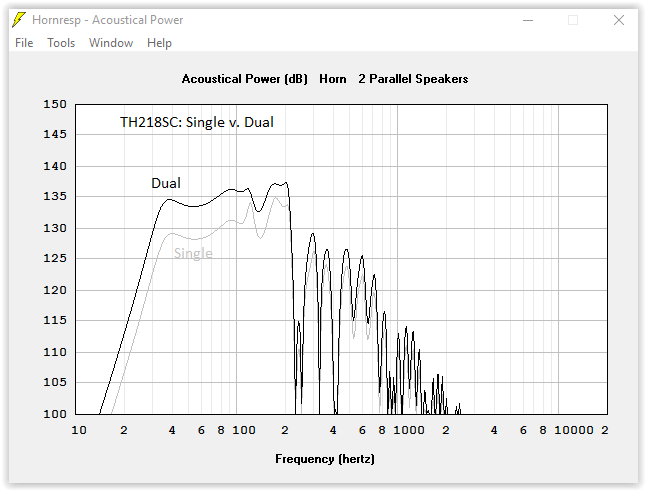

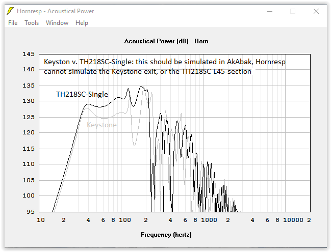

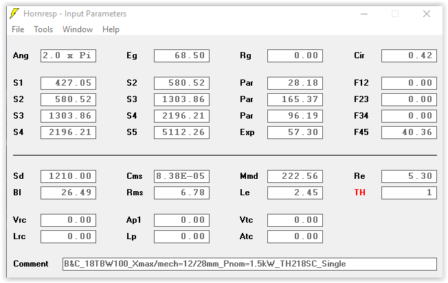

Here is the TH218SC w/ cone correction and USRFobiwan's suggested corner from Post #501. Similar to the Keystone the Hornresp simulations will not be exact. I'm attaching the first sketch w/ some explanations as to the chosen size of the cone correction. A number of boards were doubled up for strength, and to reinforce (and seal) corners. The driver location was choosen to allow a 21" driver at the same S4 location, if only a 18" driver is under consideration the driver can be move closer to S5 for a slightly longer L2--4, and a little shorter L45.
The comparisons are based on the B&C 18TBW100.
Looks like it is not quite clear which benefits can be ascribe to "cone correction", but there seem to be some.

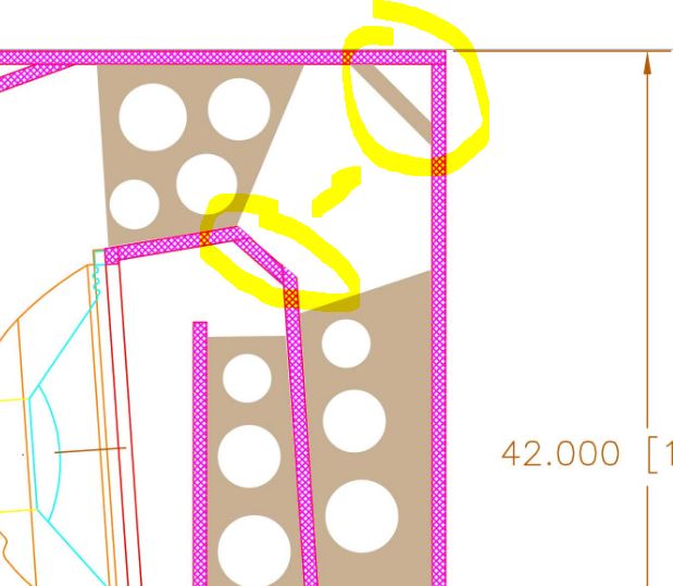

Here's some questions and suggestions...
1. I'm not sure of the benefit of having such a wide flare at the horn's mouth for a 100 Hz and below TH. Certainly it seems to be absent from Danley's TH designs, so I suggest perhaps comparing it to an alignment that does not incorporate such a wide flare. With that in mind, here's my suggestions for modifications..
2. Remove the flare as I've indicated in the diagram, extend the internal panels as indicated in the diagram, and adjust the angle of the driver's baffle and the internal panels above it to smooth out the expansion from S1 to S3. Note: this also allows the driver to be moved closer to S1, but also allows the opportunity to have a long S1-S2 to experiment with the use of damping to flatten the horn's response just above its passband - see link below:
http://www.diyaudio.com/forums/subwoofers/296731-ooh-looky-th-does-42hz-500hz-3db.html
3. Make sure all sample points are orthogonal to the center line along the horn as indicated. This should produce slightly more accurate results from the HornResp sim IMO.
4. Experiment with setting the expansion angle at the back of the horn to either the first one used at S2 or the second used at S4, to see which gives the better result. Changing it from the former to the latter will increase the horn's efficiency, but the resonance frequency will move upwards as well. Of course, your horn's layout does allow you to move S3 to the back of the horn, so you can select do do that too 🙂
5. Change the corner braces to simple 45-degree ones. Much easier to implement in practice, and the change in response will likely be negligible.
Hi Brian,
You are fast. 🙂
Here is part of my rational: I was trying to get close to original Keystone flare for most of the horn path, and t.hen add an extension.
In my drawing of the Keystone enclosure the flare angle changes from 2.24° (1st section/down) to 3.43° (2nd section/up) to 6.33° (3rd section/top) finally 1° coming back down to the driver, and beyond. Obviously, the Keystone mouth (exit) has something to do w/ all that.
Anyway, in my drawing I'm going from 2.5° to 4° to 10° back to 4° (driver baffle) to the big mouth/extension angles. If I use less than 10° for the section between S3 and 6 the area @ 6 does not correspond to the flare (all this started w/ a given exterior dimension).
The big mouth seems to improve the output in the upper passband with only minor loss at the low end. This is something I might try to address in the next revision, but, if I increase the path length I'll have to reduce the individual section flare angles to make the horn fit the given dimensions (as you well know, it's kind of a Chinese puzzle...). Obviously, I could keep the general mouth frontal area, and reduce the depth without loosing to much...?
Thanks for thinking through this, all good comments.
You are fast. 🙂
