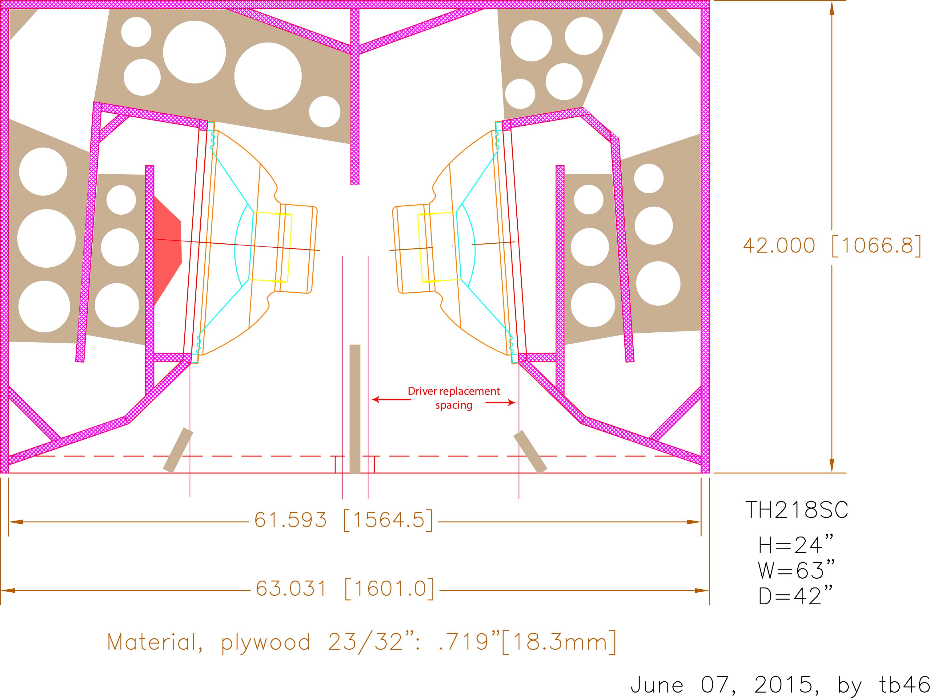

I'm done w/ the basic drawing update, but have not had time to do anything else. I decided against reducing the depth, so it will stay @ D=31.875". So the box will be 42x24x31-7/8". It would theoretically be possible to reduce the cross-sectional areas of the horn, and save a little depth, etc. but everytime you reduce the box size you loose some SPL (or low end extension) so I think this is it. I start adding individual board locations/dimensions, hopefully I'll post these later, or tomorrow.

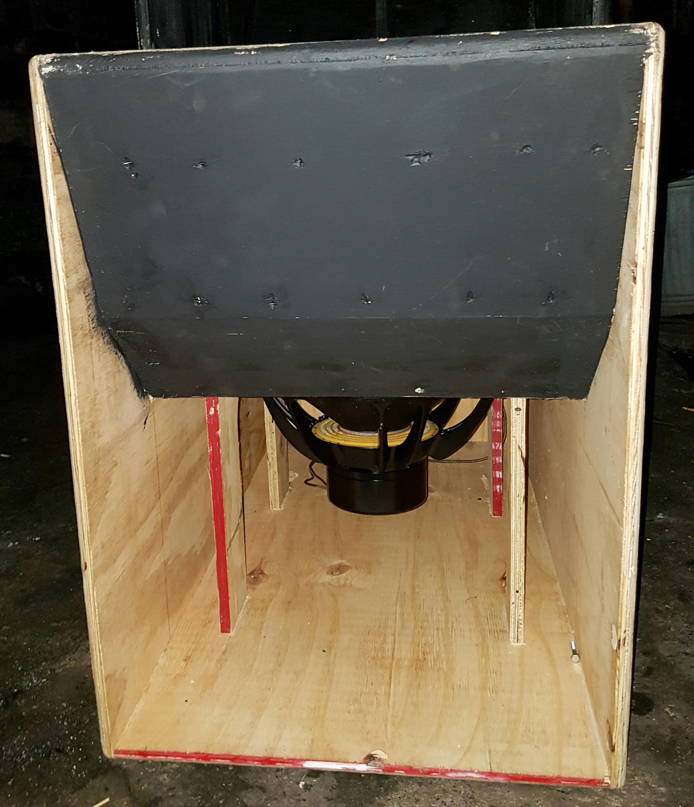

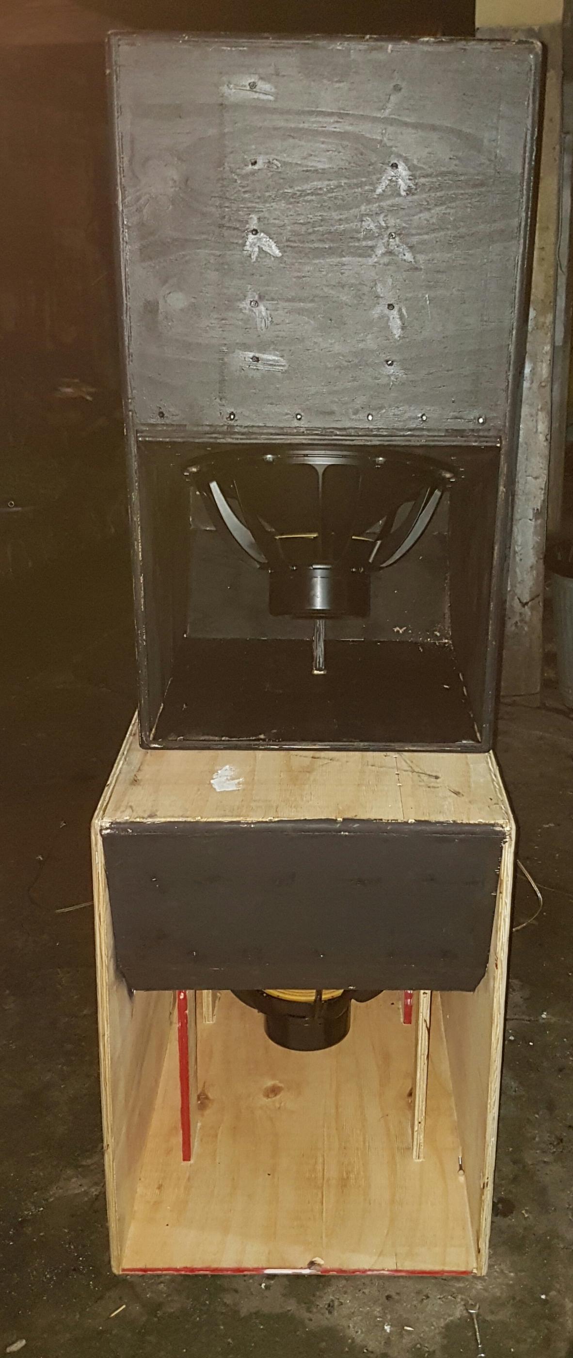

It's been a while but I'm back. I built a cab and did a quick subjective test and compared it with a Th18. We need to agree a name for this cab. It's a beast. I suggest TH18SC ? - for Scientific. Or SC118. Are you OK with that? I'm trying to attach a pic but I'm having some issues.

I tried to attach 2 pics. Let's see if this works.
We used the 18SW115-8 driven by and FP14000. In our quick test, the TH18SC appeared to sound almost the same as the TH18 until the deep bass comes. We played 'One Dance' by Drake and then in the chorus you suddenly hear a low bass note come from nowhere and just rumble the house. It was strange as I had listened to that song so many times and never knew it had those low notes. You get a glimpse of it in the TH18 but the TH18SC just brings it out. I will do some more comparisons later and try to plot the response.

Hi Scientific,
Thanks for the pictures, and the first review.
Looks like you can use them vented in two different positions as planed (out front and out the bottom)? Maybe someday you can try the box w/ the blue (cyan) squashed Keystone mouth as shown in the drawing, you may get even a little more lows.
Nice to see some wood with the drawings.

Awesome! Can we do something about the middle divider. Does it need to be like this or can I extend it to the start of the drivers and continue with bracing.
Do rods like the spl guys in car audio.
Hi USRFobiwan,
Post #495: "...Can we do something about the middle divider...."
Yes, most certainly. You need support in the middle/mouth section of the box, and this sketch just takes two TH18SC, and connects them together. A number of removable braces in this section, and a 2x2 brace around the perimeter of the mouth would be a good start, and-as BP1Fanatic suggests in Post #497-1"Dia. wood dowels can be inserted, and made removable.
I have been working on a very similar box w/ a maximum dimension of 60" so that the wood cuts fit better on 5'x5' plywood (I know it's bad practice to design to the plywood edge, so maybe I can find another 1/2" somewhere?). That one will also have the option of cone compensation as has been talked about in numerous threads. One thing I thougt about is to add a removable center section, so that two boxes can be screwed together, or a bottom can be added to each individual box. T-nuts and 1/4" flat head allen bolts on 6" center to hold the mess together? I'm not sure how this would play w/ the forces at work when going full power into one of these modern drivers though. Might take a while to get all this worked out...

Hi USRFobiwan,
Yes, that looks like a good first try, corner blocking/bracing of some kind will definitely help, but, we don't want to loose too much volume. Maybe those vertical mouth braces can be made removable by gluing battens to the top and bottom boards, and using those to attach the braces? A 2x2 edge around the mouth could be used to attach a metal grill for further stiffening? Are you shooting for the 21" or the 18" version?
