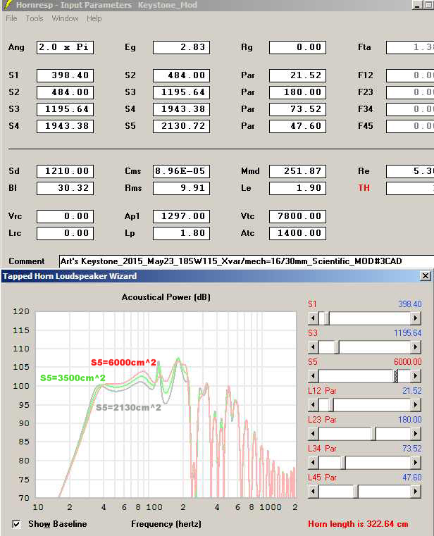

Hi Scientific,
Post #443: "...the effect of continuing the expansion at the proper horn flare rate until S5 is practically the whole width/height of the cabinet?..."
In Post #416 you can find the drawings, and Hornresp export files for the Keystone refold MOD#3. Part of that are three different mouth configurations: S5=2130.72 / S5=2535.09 / S5=2791.71.
Just as an example I'm attaching a Hornresp TH Wizard window showing a comparison between S5=2130, S5=3500 and S5=6000cm^2. The new capture and display feature in the Wizard now allows us to display three curves. A cool feature. As you can see the gain in the upper passband is accompanied by a loss at the low end.
Great post. Thanks. I spent some time making sure I understood it and discussed it with my team.
The output with S5=6000 is preferred as it has some gain in the 70-80Hz area which will help the kick in live performances while there is no significant loss around 40 Hz. At 30 Hz it would be about 5 db less than the original box with S5 2130 cm^2. We could use some equalization for that.
However the maximum S5 with the current dimensions would be 4437 cm, unless if we decide to increase the height of the cab from 37.87" (809.6) to 42" (1077.66). The sim would be between the red and the green on your chart. But for us every db counts. What we need to know now is how best to expand S5 to 6000 while keeping the flare rate reasonable and keeping the height within 42". See attachments. Now all this is without keystone exit.

I still have a liking for your shortened version of the cab with the Keystone exit so I guess at the end of the day we will have to build two different cabs and do comparisons.

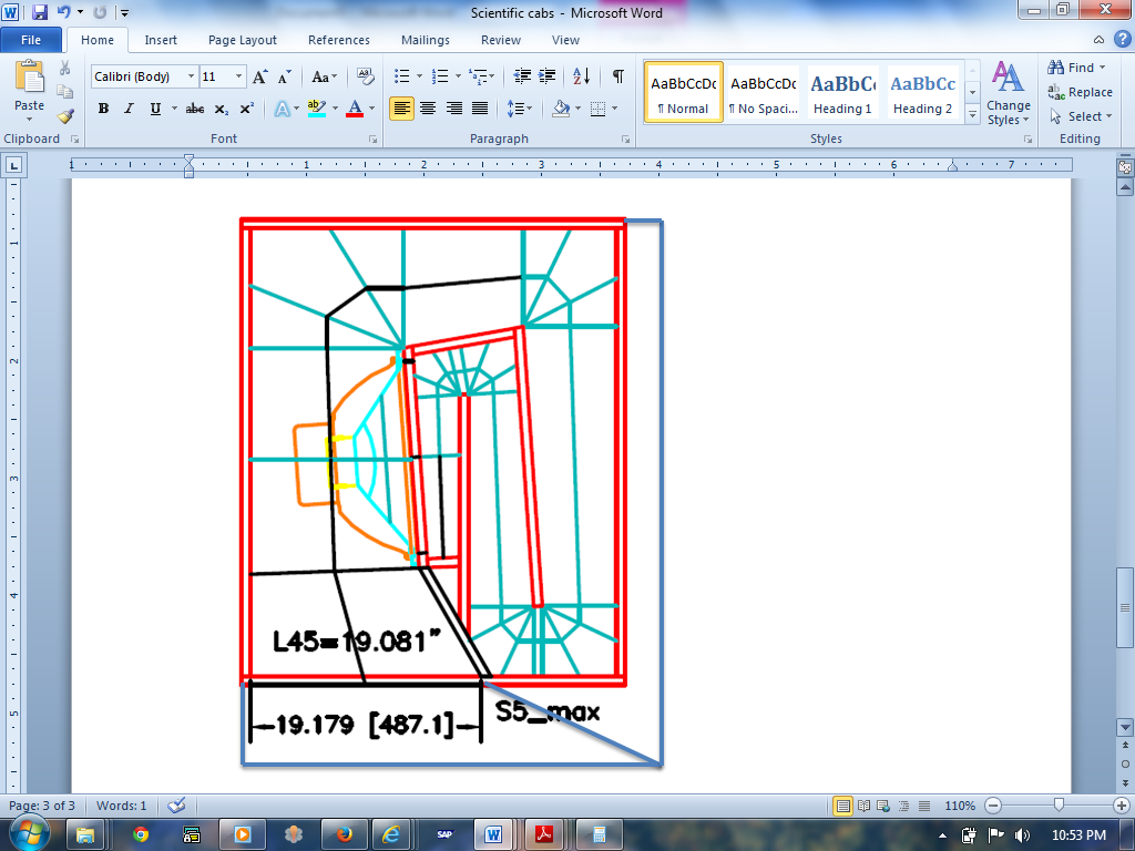

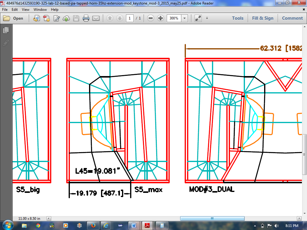

Hi Scientific,
Post #447: "...we need to know now is how best to expand S5 to 6000 while keeping the flare rate reasonable and keeping the height within 42". See attachments. Now all this is without keystone exit."
I'll attach an expansion of MOD#3 to a height of 42", this allows to cary the mouth all the way across the "bottom" of the cabinet, and results in a 4430cm^2 S5 (mouth). The expansion is only downward, so the rest stays the same. This should still allow you to experiment w/ the Keystone exit on the "front" face.
I'm also attaching the Hornresp file export. The additonal L45 provides you with so much additional output (maybe a little much @ the upper end) that I would call it a good compromise.
I'm a little pressed for time right now, but if you decide on a specific version let me know, and I'll add all the additional dimensions.

Oliver, I was trying to do the simulation using Hornresp and your txt file parameters but ran into some issues when inputting L data. I am most likely doing something wrong as it is not accepting the lengths. Anyway we are interested in the last June 1 version with the mouth 4430cm^2, so when you get a chance, add the dimensions for us. That would be much appreciated.
From the looks of it, it does not appear that there is enough baffle board space for a 21 so I guess our options with this one would be limited to an 18.

I'm done w/ the basic drawing update, but have not had time to do anything else. I decided against reducing the depth, so it will stay @ D=31.875". So the box will be 42x24x31-7/8". It would theoretically be possible to reduce the cross-sectional areas of the horn, and save a little depth, etc. but everytime you reduce the box size you loose some SPL (or low end extension) so I think this is it. I start adding individual board locations/dimensions, hopefully I'll post these later, or tomorrow.
