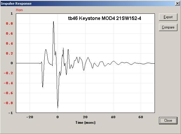

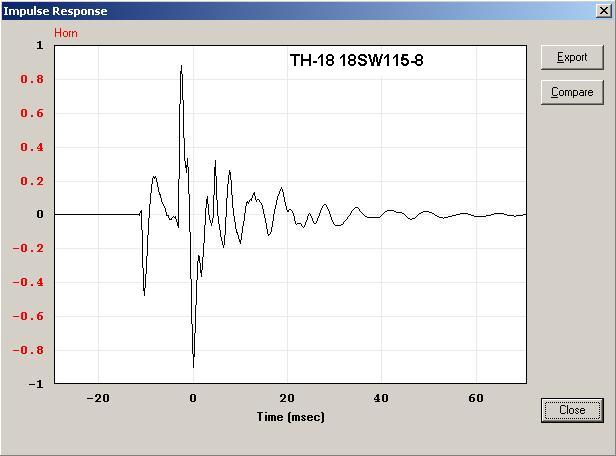

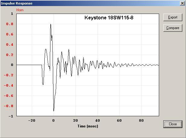

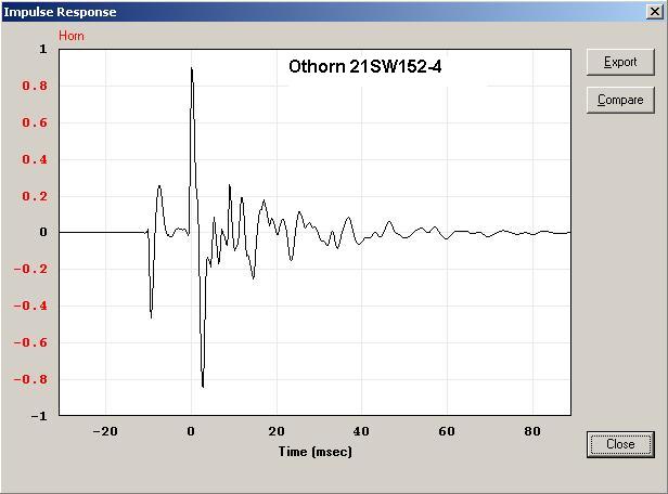

How much worth does the HR Impulse Response screen have when designing subs? Am I understanding correctly that is should look like a smooth sine wave, up & down, the closer to 1/-1, the better? What does the peak signify if it happens at 0 vs the dip happening at 0?
I've attached HR screen shots showing the Impulse Response of the PAL12 & MOD4, along with some known builds (i.e. Othorn, Keystone & SS15) below. Are the first plots more favorable and the latter plots less favorable?

Hi Y'all,
I don't think the raw Hornresp impulse response is representative of the in-system performance of a TH. Looking @ the response after applying HP and LP filters seems more appropriate to me.

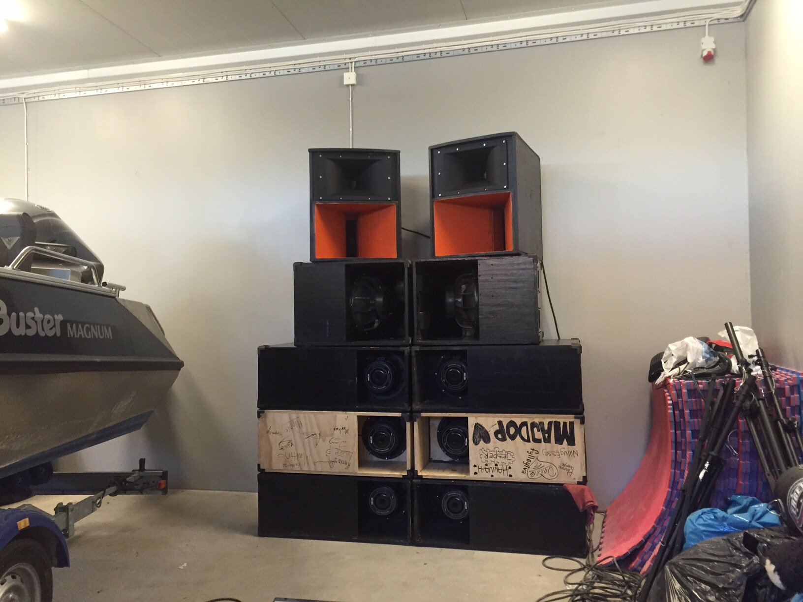

I have made 6 pal12 with the labdriver, and it sounded great. But when I heard the 4 LABhorns in a cluster, I just had to build them. Sure, complicated build, heavy as fu*k but sounds awesome, goes really low and high output.
Nothing wrong with the pal12, supernice for dj use, pretty small and light. But for bigger DnB, dubstepgigs the pal12 just won't do
