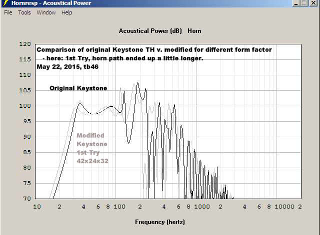

Just thought I post the 1st Try @ a modified form factor Keystone for Scientific. The path is still a bit long, and the depth is a bit more than 32", which is bad for wood usage, so I hope to find the time tomorrow to give it another try.

Oliver, That's interesting. I want to see how this unfolds, i.e. how it is fine tuned as others contribute to the design.

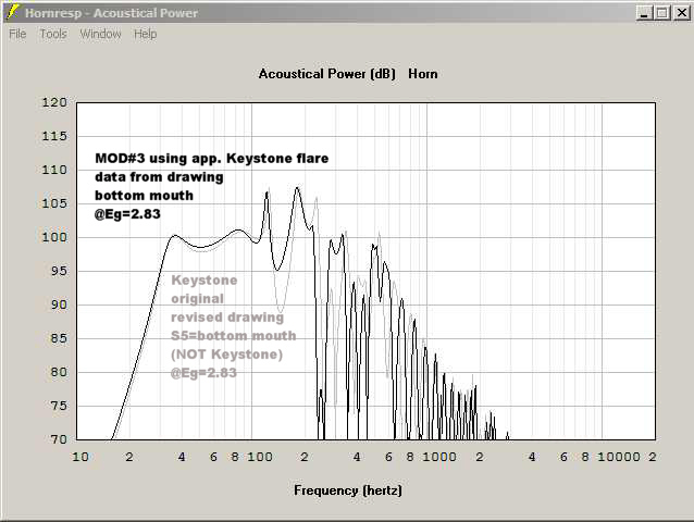

Here is a better refold of Art's Keystone than the one in Post #404, still trying to be able to provide the choice of a modified Keystone exit as well as the bottom mouth for Scientific's Carneval truck. The Keystone mouth cannot be properly simulated in Hornresp, but the bottom mouth can. I reduced the overall horn length from the first attempt, but ended up w/ a bit more internal volume, not necessarily a bad thing.
I'm attaching simulations for the bottom exit/mouth that Scientific referred to for: the latest greatest redraw of the Keystone Original, the refolded version MOD#3, MOD#3 with a bigger mouth, and MOD#3 with a maximized mouth. For fun I also mirrored the drawing to show a possible (huge) DUAL TH.

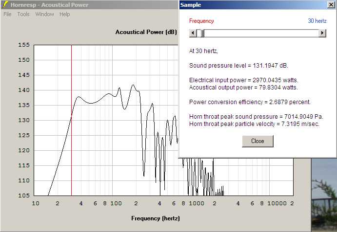

I am always amazed at how high a sensitivity DSL gets with their cabinets. I am still working on my horn but the best I can get with my monster is 100-101db. It is 101db at 30hz though. Anyways.....

That DUAL @ Eg=104 2pi would just be loud. At 42Hz Hornresp has the power conversion efficiency @ 54.25%.

Something looks... strange there. If there is constant expansion between S1 and S4, then shouldn't the three internal panels starting with the driver's baffle be at right angles to each other, a result of panel 2 being at the same angle to the adjacent external panel as panels 1 and 3?
