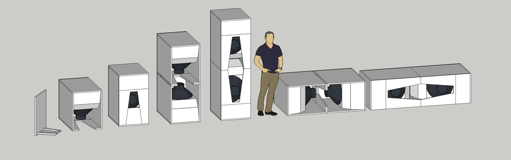

so here is a 3d pic
also a link to an anymation.
the anymation is rather big.

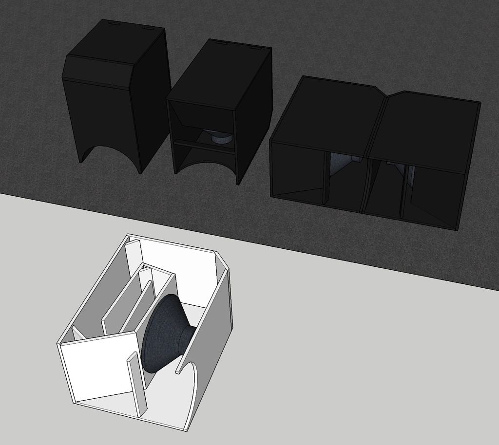

Hey guys,
I've read through the thread and there seems to be some really nice ideas bouncing around. I modded TB46's MOD#4 a bit.
Added a round cut on the front side, so that it could be used standing up as a Keystone (though the mouth is all the way down (which I guess could be modified) or used as TB46 suggested in his design.
v2
Keystone SC MkII - with 2 modes of operation and infinite setup possibilities 😀

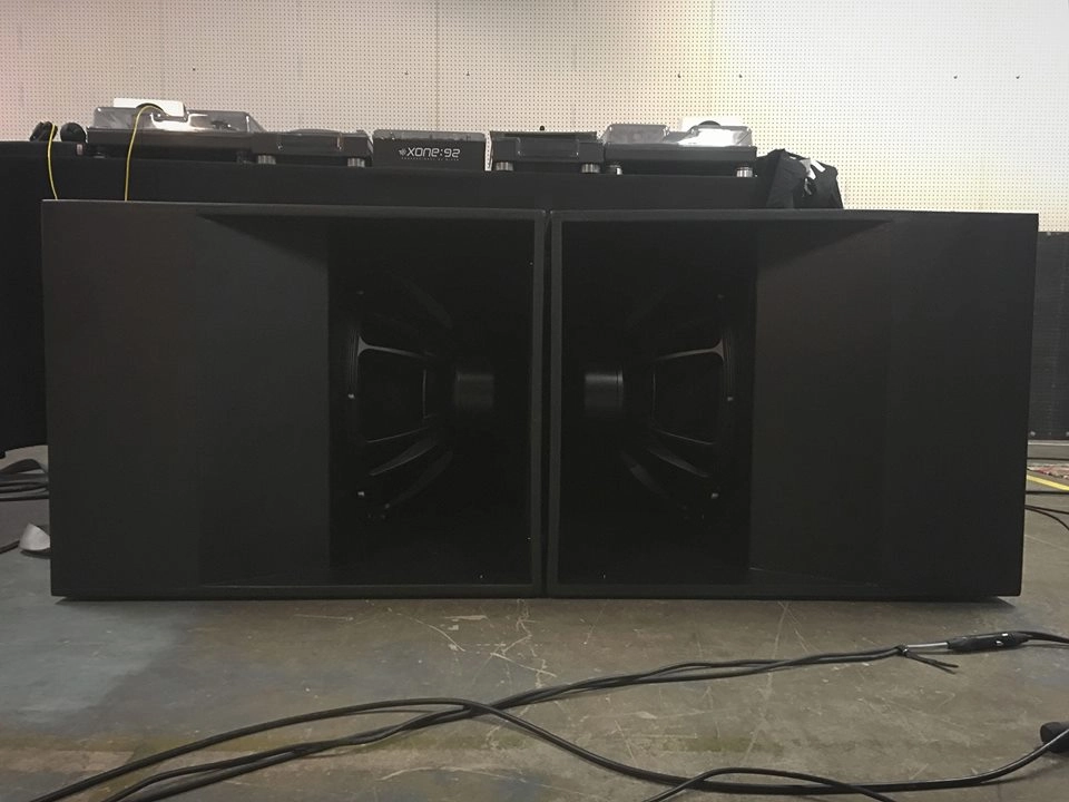

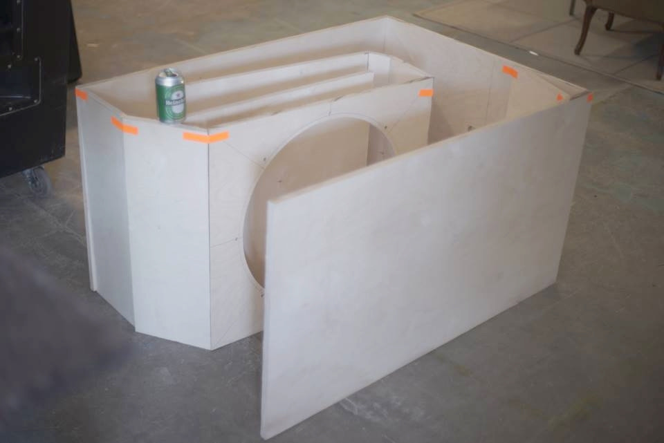

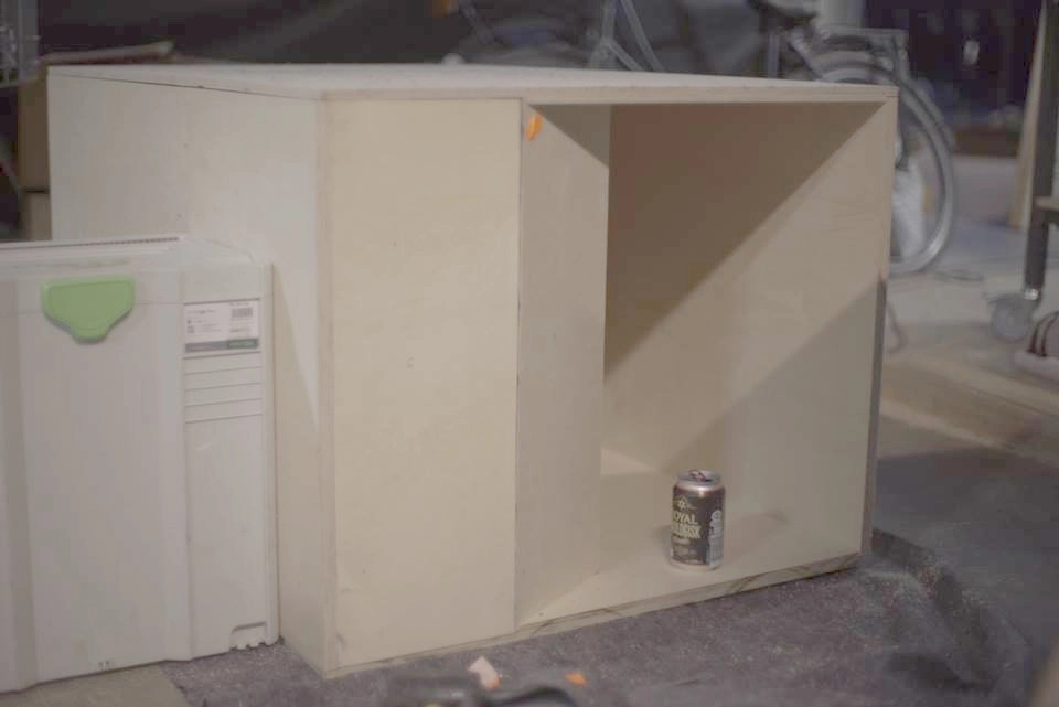

Hey guys!
After some time, I managed to make a pair of single Keystones SCmk3.
They house a B&C 21SW152 4ohm each. and sound pretty nice 🙂
I haven't been able to do outdoor measurements yet, but the indoor measurements looks pretty nice.
It's a pretty long horn tho... had to delay my unity horns 15ms to get them to play in phase 🙂
I'm taking them for a spin in the open later this month and will provide some data.
v2
v2
v2
FAQ | Danley Sound Labs | Danley Sound Labs, Inc.
"The Tapped Horn is not like a normal folded horn. The effective path length is not the path length of the horn. It is somewhere between the direct path from the drivers to the exit (on one side of the driver(s)) and the path all the way through the horn on the other side of the driver(s). The path length varies with frequency. How you integrate it into your system depends also on the phase response of the full range loudspeakers used-type of crossover filters and slopes used. Depending on the crossover freq and delay used, sometimes it is best to flip the polarity of the tapped horn in order to get the best response. This will need to be either measured or tested to be sure what is best. Here is a simple test to get close. Choose whatever crossover freq you want and put that frequency – ( use a sine wave) into the system-driving both the Tapped horn and the full range loudspeaker. Increase the delay time on the full range loudspeaker until you get a null and adjust so you get the maximum null. If you don’t get a null-but rather something that sounds like a bump, try reversing the polarity and adjust again. When you have the delay time in the deepest part of the null-invert the polarity on the sub and you will be done. The lower freq the Tapped horn goes, the longer the delay time will generally be. But in the range of 3-20ms would be typical-but it could be longer or shorter depending on the particular setup."
It doesn't have a keystone style mouth as per say. I'm pretty happy with how it sounds.
There is bracing just behind the driver and I'm planing on making an extra one. The subs were walking a bit, but after I put some rubber feet it stabilised.
I'm taking them out for a spin at a friends wedding next week where I'll run them strapped to each orher as in the picture.
As to the phase, I used SMAART to phase align. I think it's easy to get confused with the sine method as you may be 1 period away since the sin wave is periodic 🙂
I'll send measurements and pictures soon 🙂
