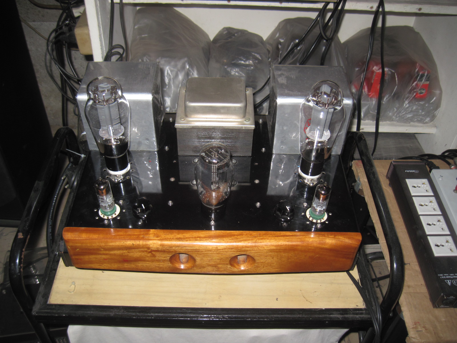

Some years ago I built a 300B for my friend with C3g.
Both of these look similar to the TSE design.
