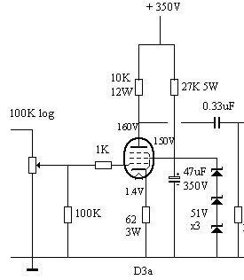

Does the d3a do better wired as a pentode or triode? Would there be much difference in this application?
The operating points are on the schematic: Ep = 144V; Eg = -1V; Ip = 10mA; gain = 46
Were the Ep and Ip same for 6N23P also? If not, what were they?

Not as designed, if you remove the electrolytic you can use a string of vr tubes, (or a single vr tube) however note that they will be much noisier than a bypassed string of zeners, and you can't bypass them with anything more than about 0.047uF before you run the risk of creating a relaxation oscillator. I suspect you are better off with the zeners on several counts.
Apart from removing the electrolytic, is there anything else I should consider? I might try it both ways. The schematic looks fun.
In diag 2 you are shunting approx 7.4mA through the zener string + g2. You will need a lot more current fot the vr tube. From memory, around 20mA should suffice, plus say 2.5mA for g2 , making 22.5mA total. Therefore the shunt resistor should be around 8k9 Let's take the standard value 8k2 for a combined current flow of 24.4mA.
A neat trick is wire the bottem leg of the vr tube to top of the cathode resistor instead of ground, reducing its value and increasing gain. In this case the current flowing through it would be approx 20mA plate current plus 24.4mA vr tube plus g2 = 44.4mA total. For a cathode voltage of 1.4V a replacement cathode resistor of approx 32R would be required.
Could I take that further and replace the resistor with a LED of suitable voltage? I realize it might be a problem if I do this with the vr tube connected above the led.
The HLMP6000 which I use for LED biasing will give a cathode voltage of 1.6V with a maximum continuous current capacity of 50mA. Running 44mA through it may be too close to Imax for comfort, in which case connecting the lower leg of the vr tube to earth may be more prudent.
Moreover, when using LED biasing there would probably be no real benefit conferred by connecting the vr tube to cathode.

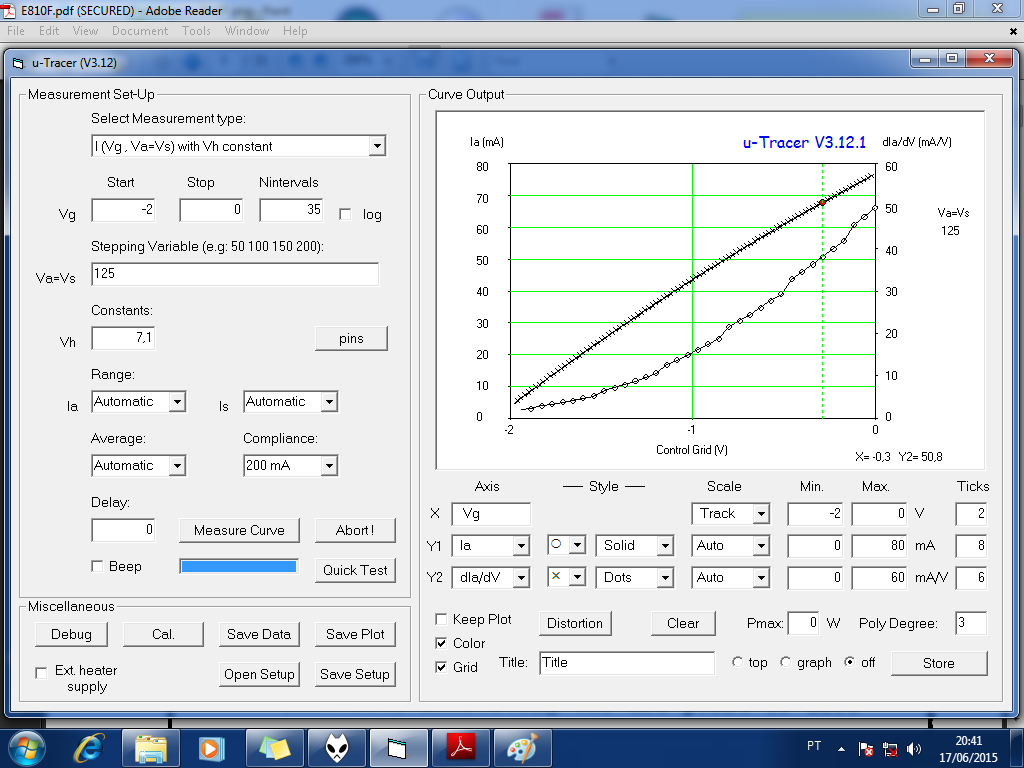

I have an Ronald Dekker's µTracer and I measured the SQ Philips E810F transconductance: more than 60mA/V at 50mA/125V 😱😱😱 but of course I use with far less current (1,5V bias from battery and 125V on anode; I need to measure to check the resulting transconductance in that bias point).

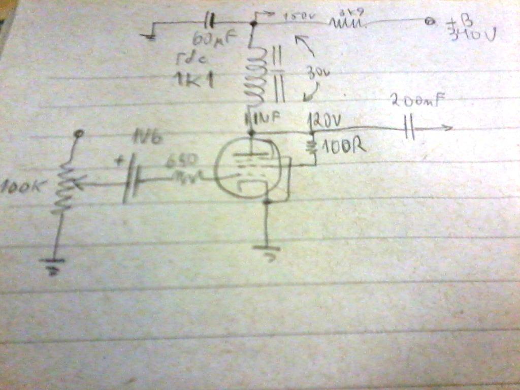

I built it "on the fly", so I need to draw the schematic😀.Thank you for the suggestion. If you have a schematic I'd love to see it!
Soon I have the time to make the schema and post here.🙂 I will measure all working voltages.

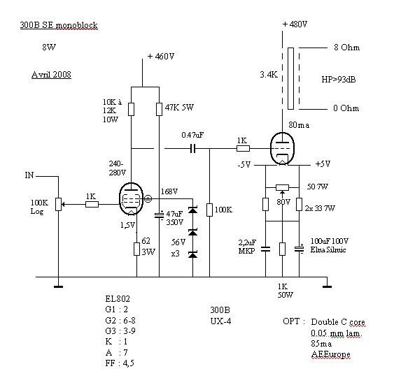

Here's my SE 2A3 amp using the E180F. One nice point about the E180F, besides the fact that it is excellent sounding, is that it is cheap to buy. I bought a dozen and got several pairs that matched for plate current at the operating point. Note the choke is by Electra-Print and the voltage on the cathode of the E180F is just over 1V. I had previously used a 6N23P-EV in the same amp although with LED bias. Replacing the 6N23P was a major step forward in reducing "glare" and increasing transparency.

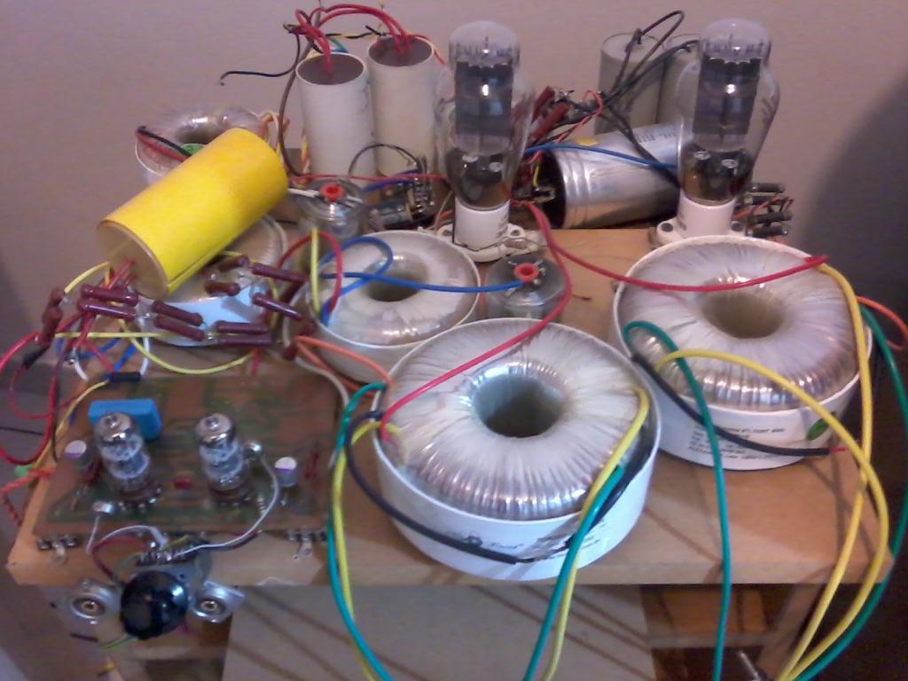

I take an foto from my hand drawing notes (schematics) for not awaiting eternally to make an KICAD draw schema... 😀 NF is the ferrite bead. The battery furnishes 1,6V bias and the 3k9 supply dropper is for both channels.
And one photo from my ugly abused prototype 😱😱😀
My µTracer measurements from E810F oscillated this time (need more stoppers😡 ...), but even so I published here to show the outrageous high transconductance for a 300mA/6V3 heater tube! (ex.: 17mA/V with 7mA!)
I know several JFETs witch don't have such gm at that current levels.

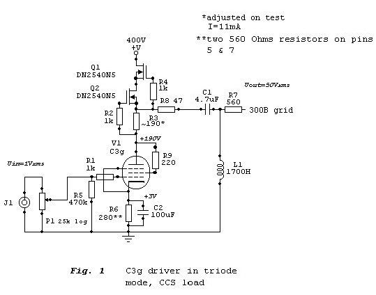

i am surprised nobody uses sic fets
low ciss, low id types exist. all rated 1200v
should be better than 2nf si fets, and faster😕

And these types will help uses with high rp tubes, thanks the low capacitance😎. More tubes in the candidate list!i am surprised nobody uses sic fets
