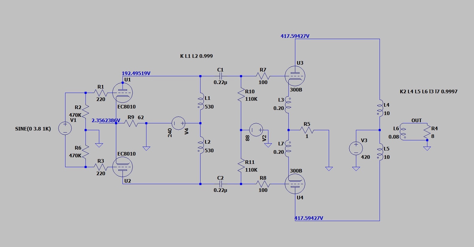

I'm trying yet again to find a single stage driver for a 300b. I've been through using DHTs like 26 and 10Y with a step-up on the input, in my case an op-amp. But I'd like an easier solution. Latest attempt is a 6N1P with both sections in parallel totalling 16mA and a Hammond 126B wired as a plate choke. It's not as disappointing as I imagined - decent but not a keeper. I like an EL33 in triode as a driver with other output tubes, but a mu of 20 isn't enough for a 300b. I'm assuming that a mu of 30 is a starting point. And triode operation not pentode.

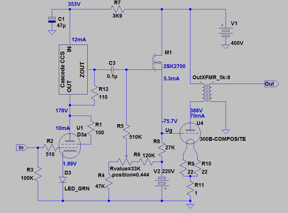

My recommendation would be a D3A or E810F in triode connection.
Indeed - the data for the D3A suggests 24mA current which should be pretty good. The E810F can take 20mA current so good too. What holds me up about these choices is that I don't have a scope and with the high transconductance I'm likely to run into oscillation problems.

D3a or E280F as VAS.
I tried E810F too, but its H3 groving rapidly (more than previous ones) at large swing.

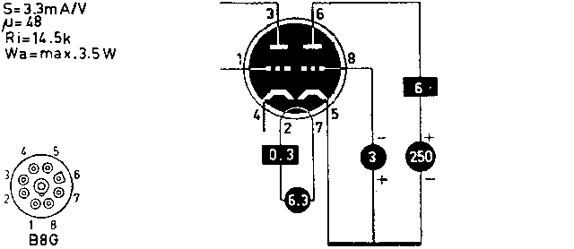

Very linear in triode; mu 40; Rp ~ 2k, and better grid voltage "room" than D3a, E810F.

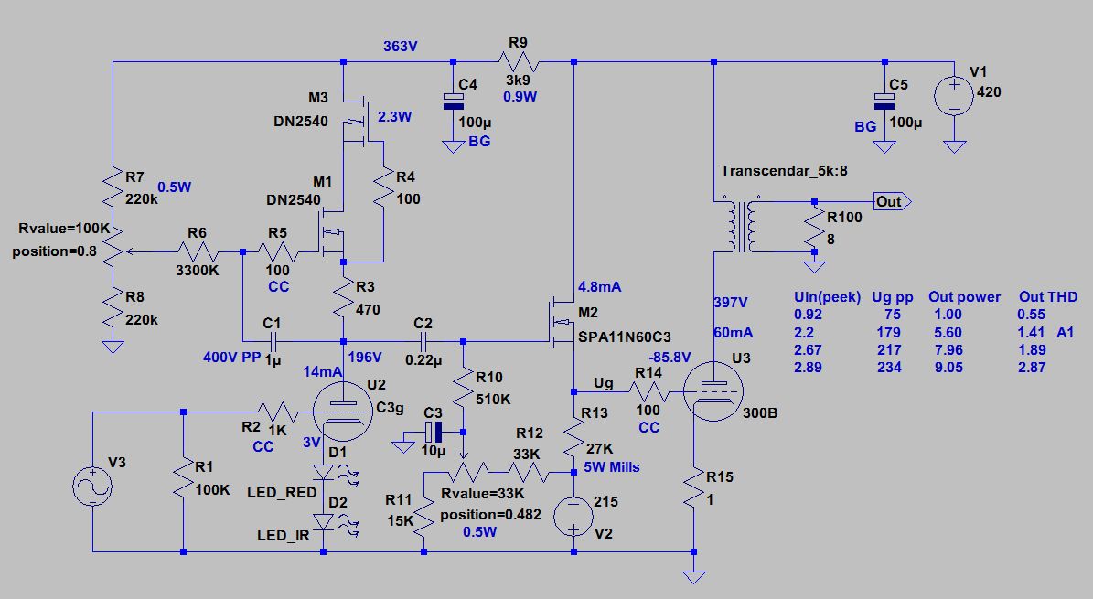

I also have some C3g, and built a phono (C3g, C3g, D3a as CF) with its.
On
