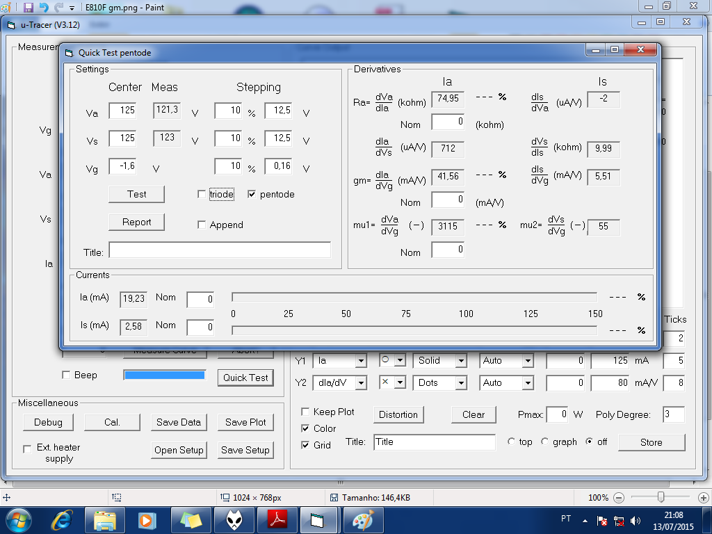

My µTracer measurements from E810F oscillated this time (need more stoppers😡 ...), but even so I published here to show the outrageous high transconductance for a 300mA/6V3 heater tube! (ex.: 17mA/V with 7mA!)
I know several JFETs witch don't have such gm at that current levels.
I have some E180F, E280F, 6CL6, 12BY7A, EF184, 6FQ7 and some others types. If someone has interest in some bias/curves measurements from these, I'll be happy to measure (and if tube oscillates, I tame the oscillations and I advise to caution against oscillations).
Since µTracer oscillated with E810F, I re-do my measurements. In pentode mode the crazy E810F don't oscillate, so I can estimate the parameters from here. 41mA/V with 19mA anode is crazy for a small tube...
