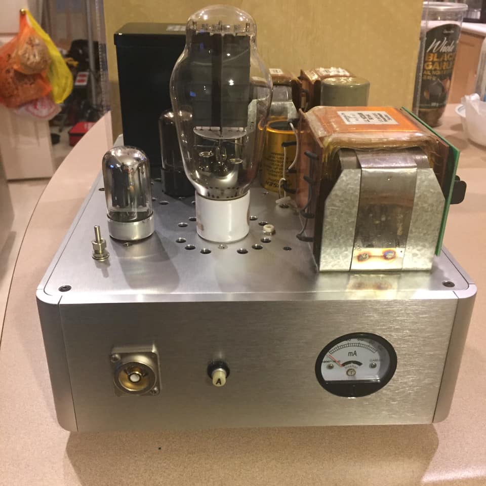

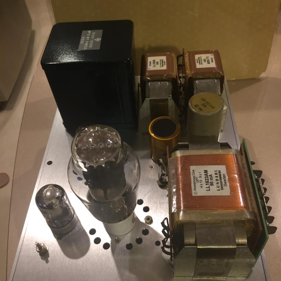

Hello,
Last year i made SE 300B amplifier. I tried in driver, EC8010, C3G in triode, C3M i
The best result to THD and bandwidth is the EC 8010. I worked with This tube forSPUD AMP.
In driver, this tube have microphonic effect it's not the case of C3G.
The amplifier factor of C3M in triode it's not enough.
I worked with C3G.
Eric
