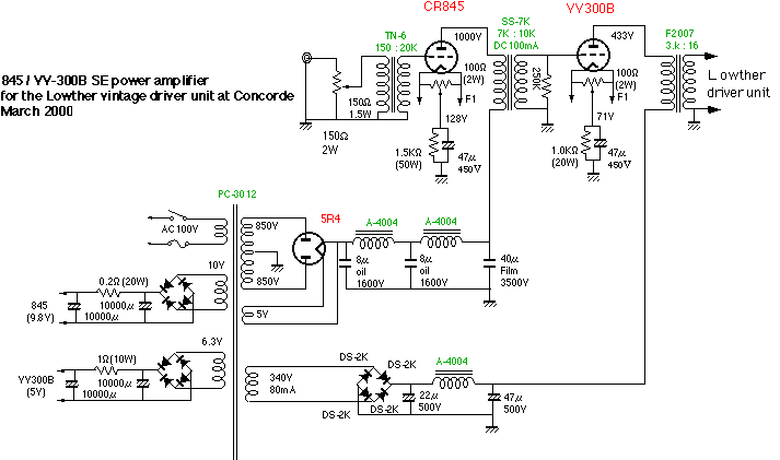

Quoting Sakuma san himself :Sakuma-san would have a good laugh about this whimpy driver tube!
"The most important goal is not 'Power', but 'Energy' and 'Frame of tone'."
and
"To get the best sound from a tube, even if the proper match is 5K, we will try 7K. And we try these "mismatched" values with input transformers and other parts."
Schematic of his 300B SE from 845/300B SE power amplifier for Lowther driver units.
Yes, thats true for those who have heard and UNDERSTOOD the difference.
A 5842 driver tube will never give that authority, regardless of what current you run it.
Its just too tiny tube to drive something with authority.
The result isn't energetic sound but something that sounds far away some roadblocks.
