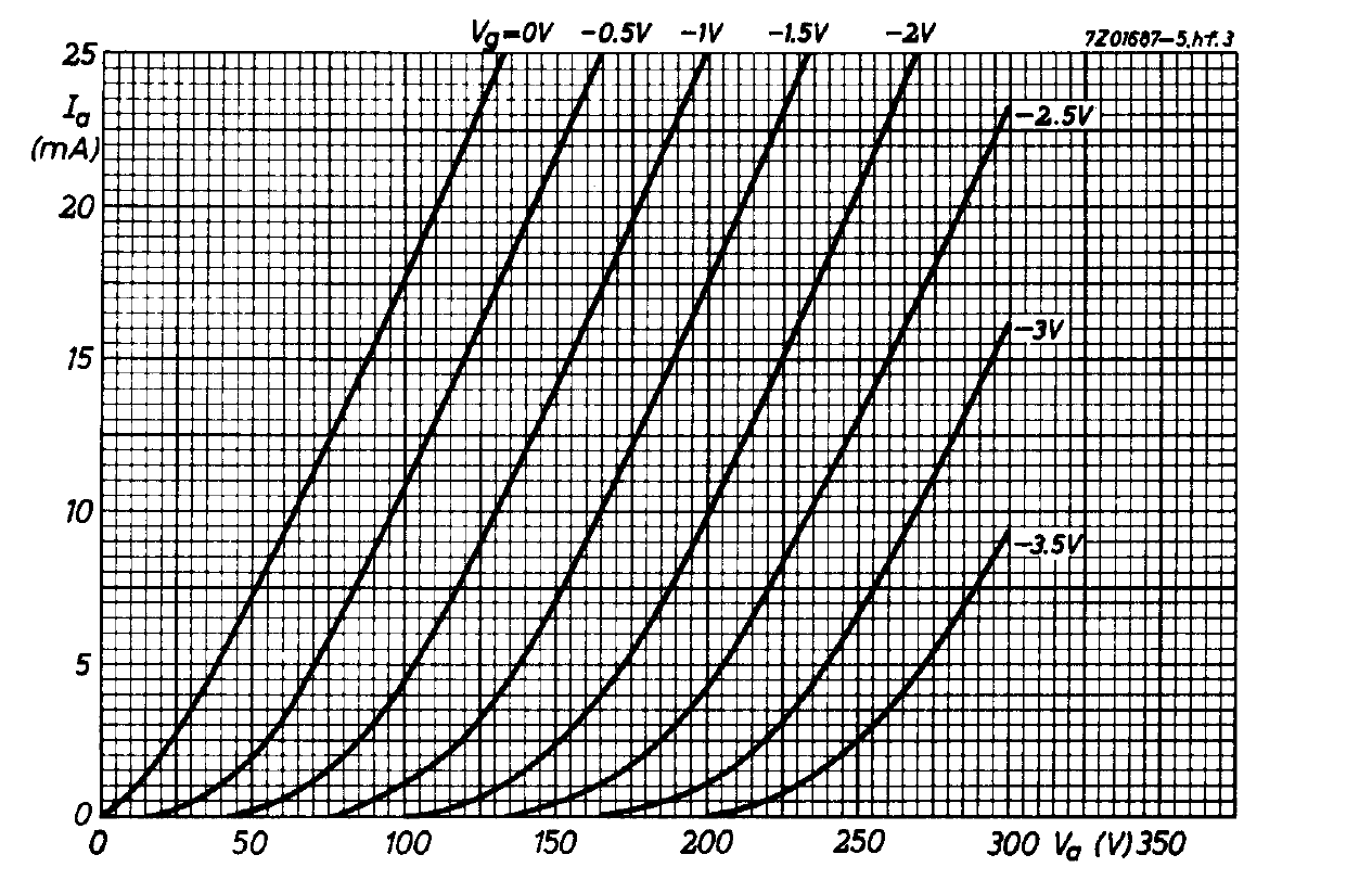

E86C/EC86 is nice. EF184 is so cheap you ought to try that one as well, one of the best tubes ever made from a technical standpoint. (i don’t care about scalpers 100M+ where made)
E80L in triode CCS loaded could be quite nice/ i think the EL3n is quite similar to that one. but these don’t get you the gain you want i think.
E86C/EC86 is nice. EF184 is so cheap you ought to try that one as well, one of the best tubes ever made from a technical standpoint. E80L in triode CCS loaded could be quite nice/ i think the EL3n is quite similar to that one. but these don’t get you the gain you want i think.
I've tried E80L and it's nice for a 9 pin tube. EL3n is I think very similar to EL33 and that's a good sound, a little better. EL41 is similar in rimlok. E86C is one I don't know.
Its pretty nice.
Mu of about 68 14mAV and nice low impedance.
You need some serious stoppers though, it was made as a HF tube for grounded grid up to 800MC
