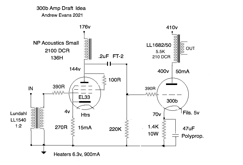

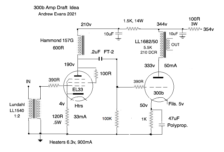

Well, this is the closest I've come so far to a 300b amp I want to listen to.
Plenty of current through the driver tube, at least.

Nice. I would swap the Hammond for LL1668. Much better quality in winding.
But so far, an excellent design.
Look for 300B data sheet for working points. 300B needs much more voltage to work good, more current, too.
I meant the topology.
I don't mean the exact working points for tubes. That could be changed easily.
Yes, of course. The 300b needs more HT voltage as you say. I just got it up and working with my existing PSU. This can be changed. I can swap in a more sophisticated input transformer - I have a Lundahl LL1554. I will also swap in an amorphous core NP Acoustics plate choke, which will mean the EL33 will have 15mA current through it. The LL1682 OPT sounds very nice with a 300b, so that stays. Sounds better than a LL1664 which I also have. Only gapped for 50mA current, though, hence the HT needs to go up.
But at least I have it working now and sounding in the general ballpark, which is promising.
I hadn't thought about using 2a3 outputs because of the 50mA limitation on the OPT, but maybe that could be tried with my LL1664/70mA

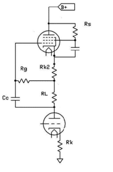

I don't even find it technically correct in the case of the TSE amp. I have not tried the C3M, D3A or any of the European high GM tubes, since they were not generally available in the USA 15 years ago when I designed the original TSE, which is a well received HiFi amp....and yes during the torture testing phase of the design, I played my guitar through it.
For many triodes including the 5842/WE417A used in the TSE, the distortion into a high impedance load like a CCS feeding the plate, buffered with a mosfet follower into the output tube grid is extremely low, and mostly 2H. I measured numbers in the 0.15 to 0.5% with WE tubes at the grid of the 300B when driven to 5 watts of power at the output of the amp. Raytheon 5842's are a bit higher in THD.
I have also seen some 12AX7's produce extremely low THD into a similar load but there are many different things called "12AX7" and not all are created equal.

Here's a draft idea of a revised 300b circuit. The LL1682 has a 50mA gap so that limits the dissipation.

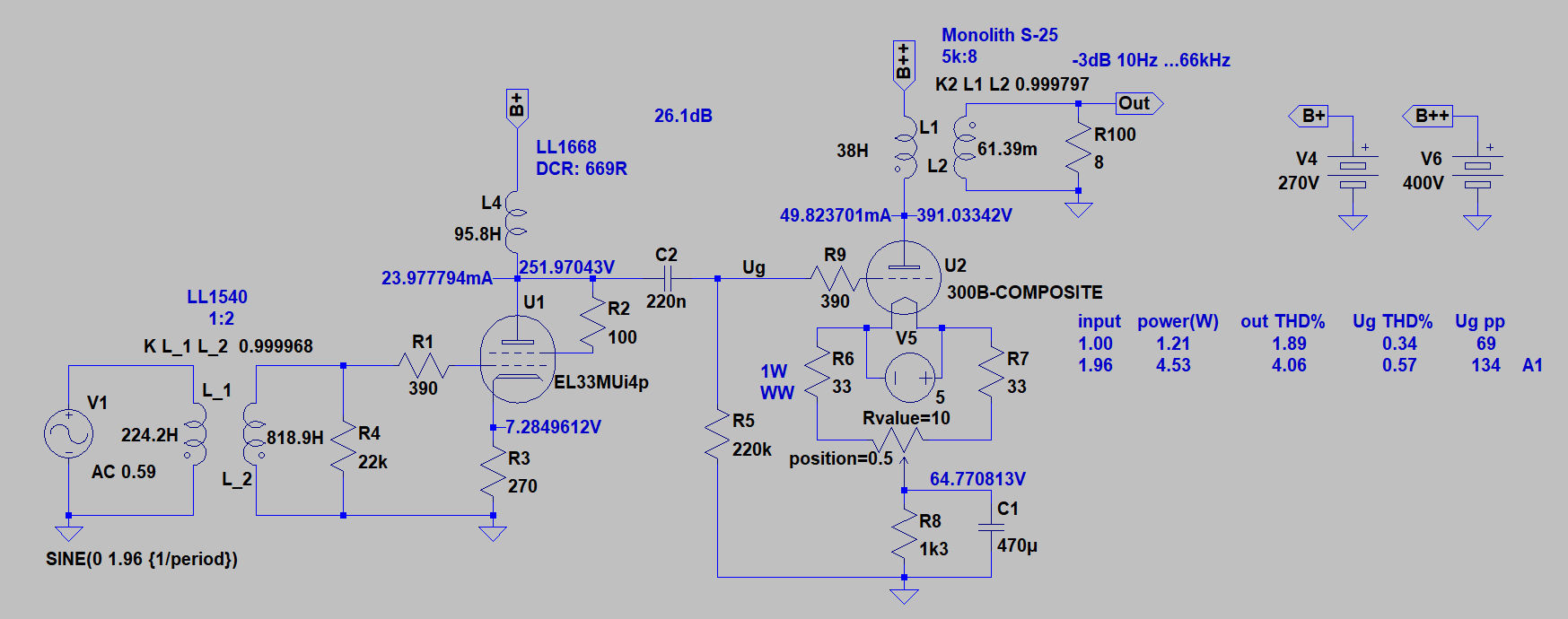

Not the best operating point for 300B ... nor EL33.
If you use 300B with this low current (50mA), try to elevate anode-cathode voltage up to 400V, so B++ at about 470V.
The EL33 distortion is lower at about 240-250V, 22-25mA operating point.

Not the best operating point for 300B ... nor EL33. If you use 300B with this low current (50mA), try to elevate anode-cathode voltage up to 400V, so B++ at about 470V. The EL33 distortion is lower at about 240-250V, 22-25mA operating point.
Thanks for the suggestions. I don't need the a-k voltage to go that high in my system, so I'll run it a bit lower.
The EL33 distortion may well be lower at 22-25mA and I'd prefer that also. Again here, I'm having to compromise because my smaller NP amorphous core plate choke is gapped for 15mA. I have one other really good plate choke, a big NP Acoustics amorphous core, 40mA gap and 180H. I have 5 amplifiers at the moment so will have to decide which one it goes into.
