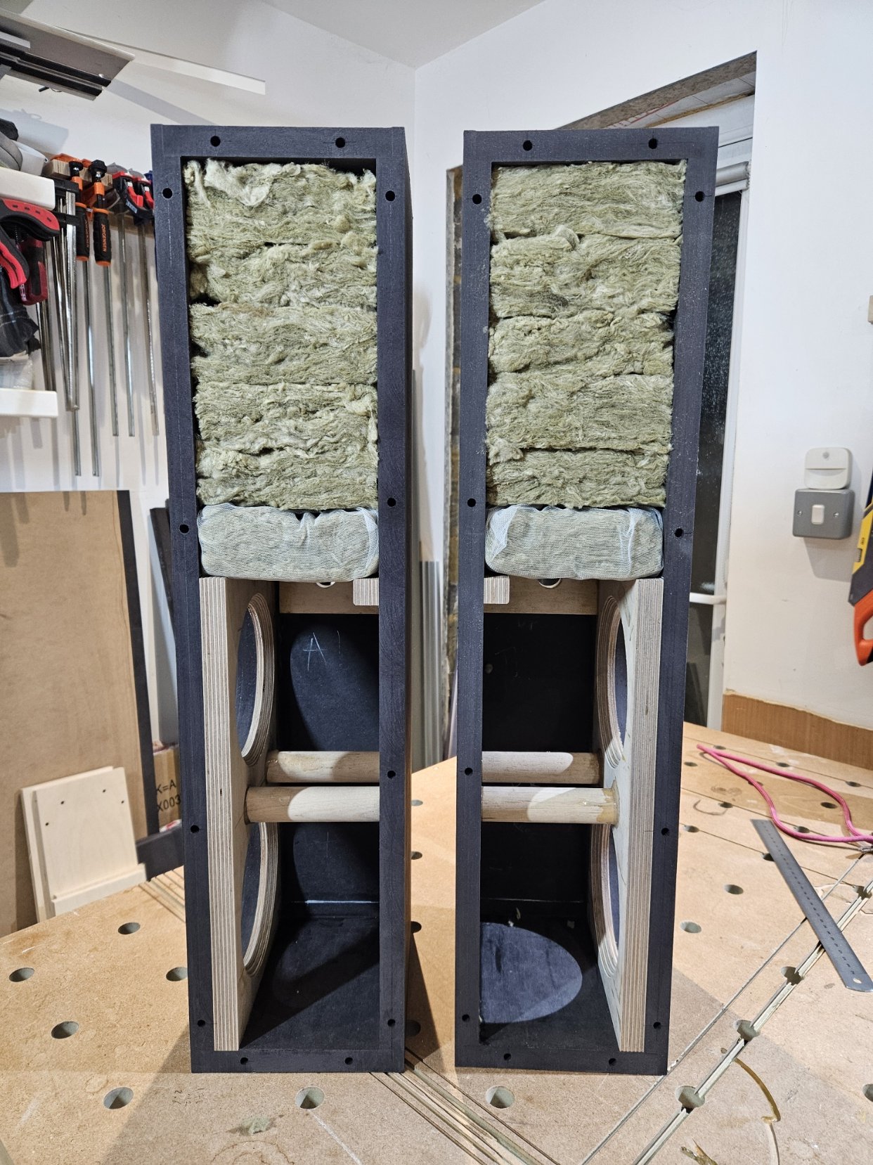

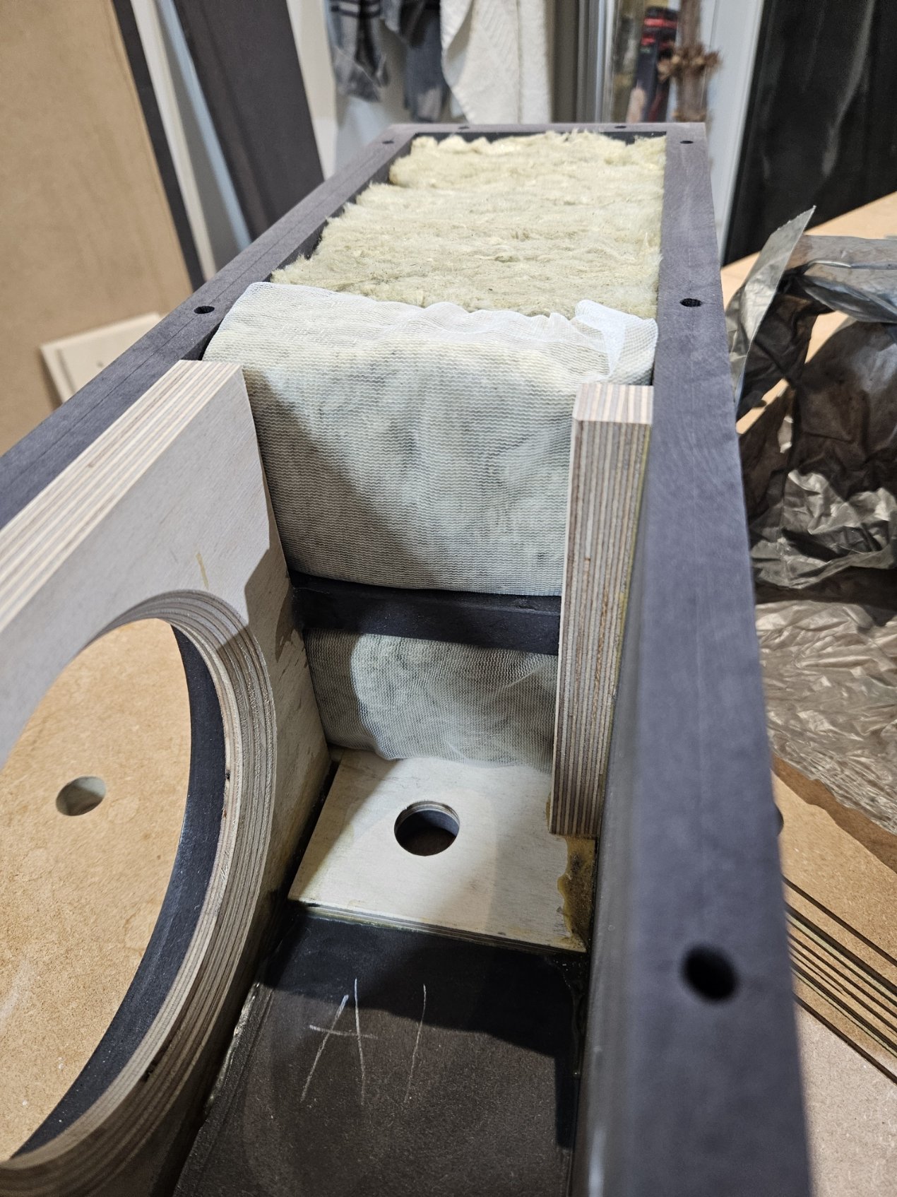

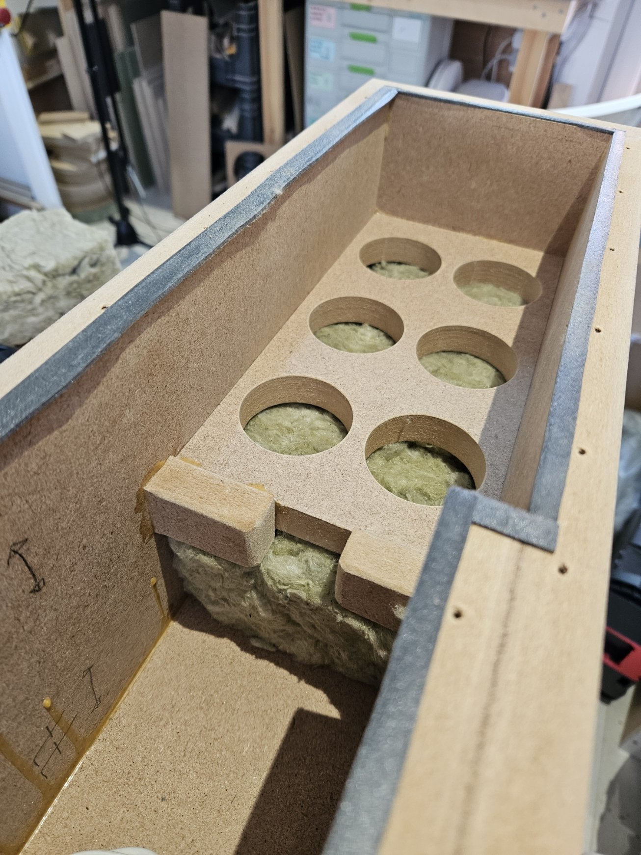

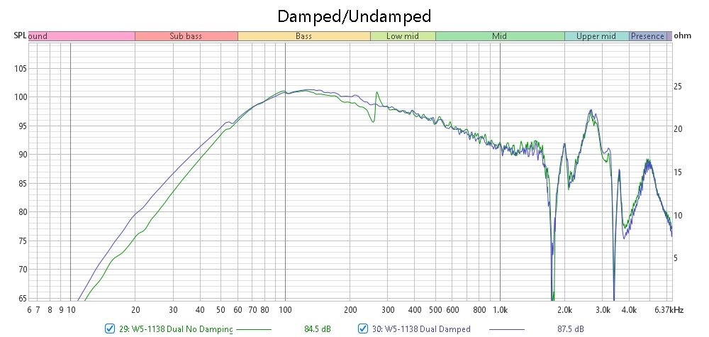

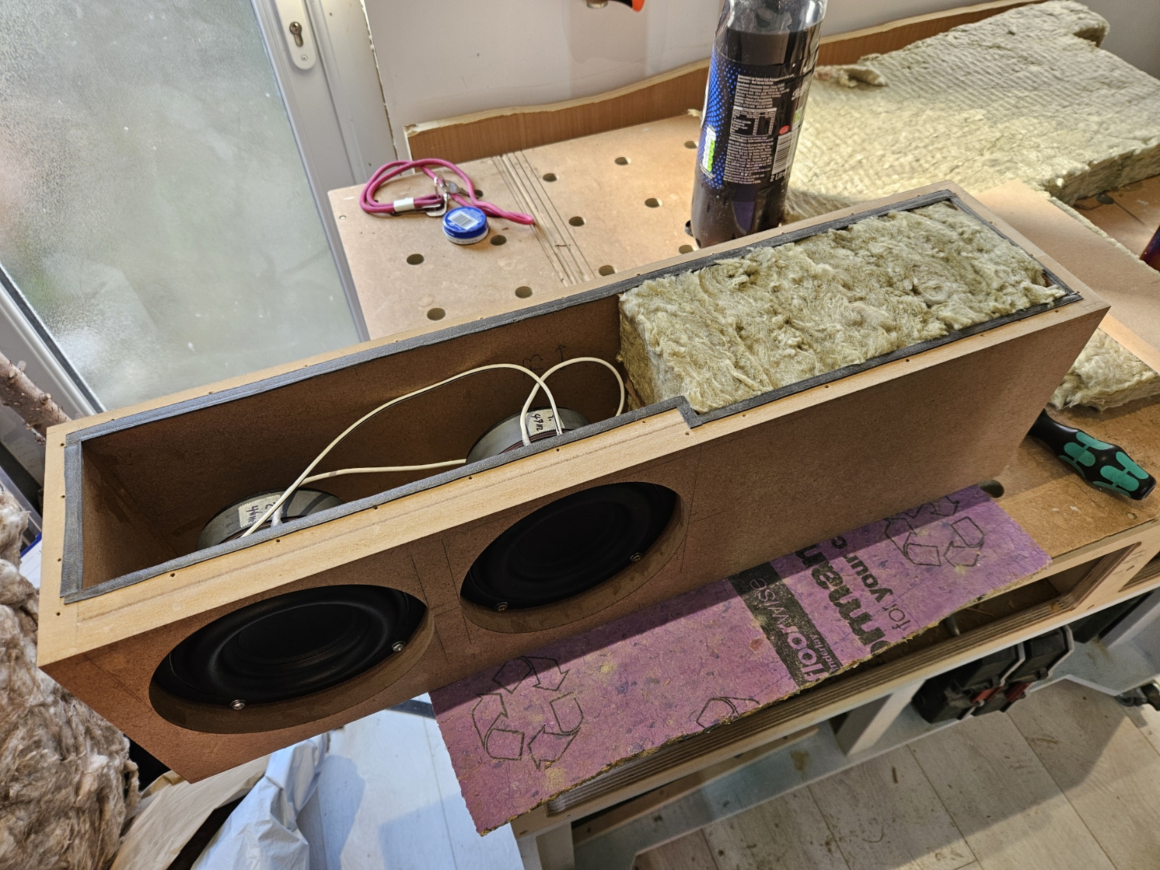

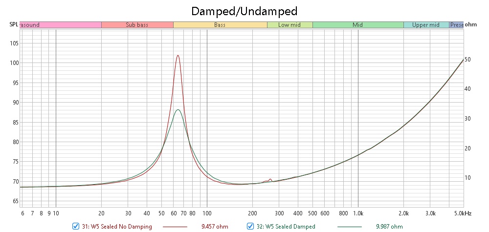

Cabinet damping:
Slabs of 50mm rockwool stacked to about 250mm in length.
System Q went from 0.77 to 0.64
Standing wave seems to be irradicated.
The dip at 55hz is a function of my perfectly square workshop...

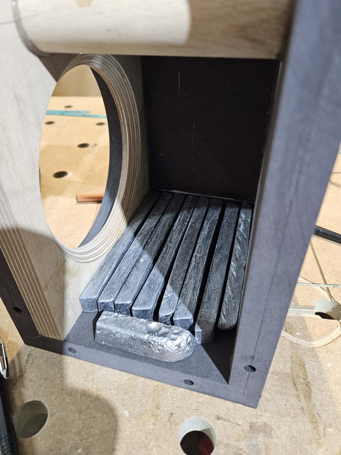

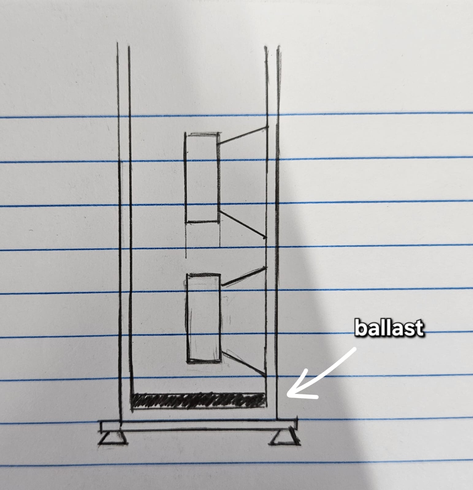

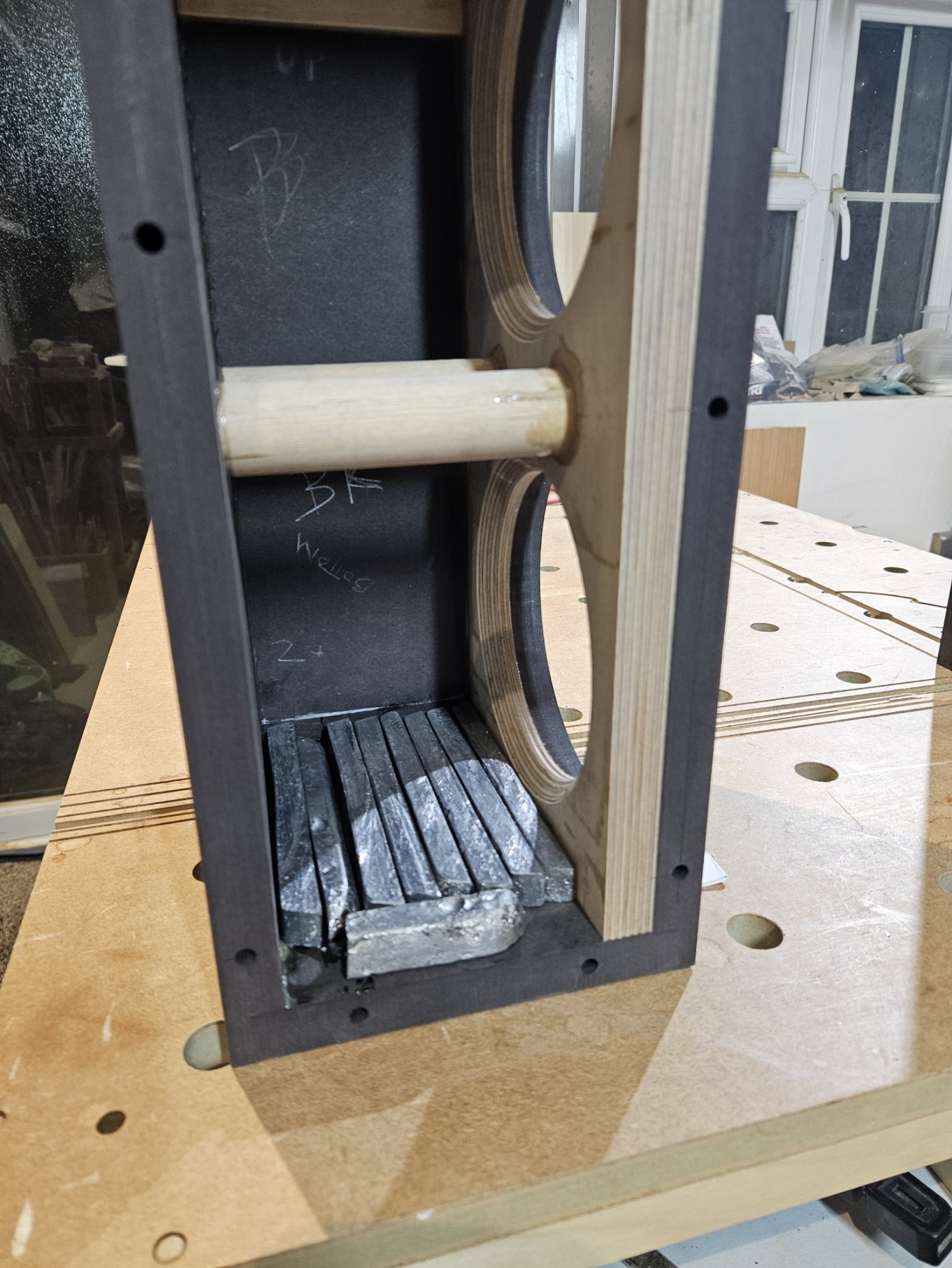

Recoil and Mass
This system isn't designed for SPL; it will hit 80db once in a blue moon or with an accidental slip of the volume control. However, I did notice some driver/cabinet recoil when real voltage was applied.Possible Solutions:
- Dual opposed woofers – No, the cabinet is too slim.
- Offset dual opposed woofers – No, looks ugly.
- Mitigation: Add mass – Nice to me you Chandler Bing - BING!
Cabinet Mass:
The test cabinet is made from standard MDF, which weighs approximately 5.3 kg, but I’m making the final cabinets from Finsa Fibracolour, increasing the weight to 6.9 kg. That should help a little.Ballast Mass:
This ties into my anti-tipping solution - adding a 20mm (≈2.5 kg) layer of very heavy ballast at the bottom of the cabinet. This will lower the center of gravity and, with modest outriggers, should create a fairly toddler-resistant structure.What to Use as Ballast?
Some options I am considering:- Resin and steel shot – Expensive.
- Resin and lead shot – Even more expensive.
- Flat steel bar bonded with resin – As expensive as lead.
Any suggestions?
These two elements aren't a complete solution, but they should help mitigate the issue.
A few weight plates of suitable dimensions from Decathlon or Ebay? Secured with resin or adhesive.
https://www.decathlon.co.uk/p/secon...sc-weight-2-kg-28-mm-very-good/_/R-p-348894-B
@wolf_teeth @AlmaAtaKZ
Thanks guys! This is such a weird problem to have...
Gym weights all come in the wrong dimensions so would have to be hacked up and secured in epoxy.
Steel shot is actually hard to get hold of in a small enough pellet size and is quite expensive. Lead shot is even more expensive.
Reclaimed lead might be the cheapest as sellers on ebay seem to melt it down in to ingots and then I could epoxy it in place.
It seems there is a Hoffmans iron law on ballast. Cheap, heavy or convenient. Pick two.

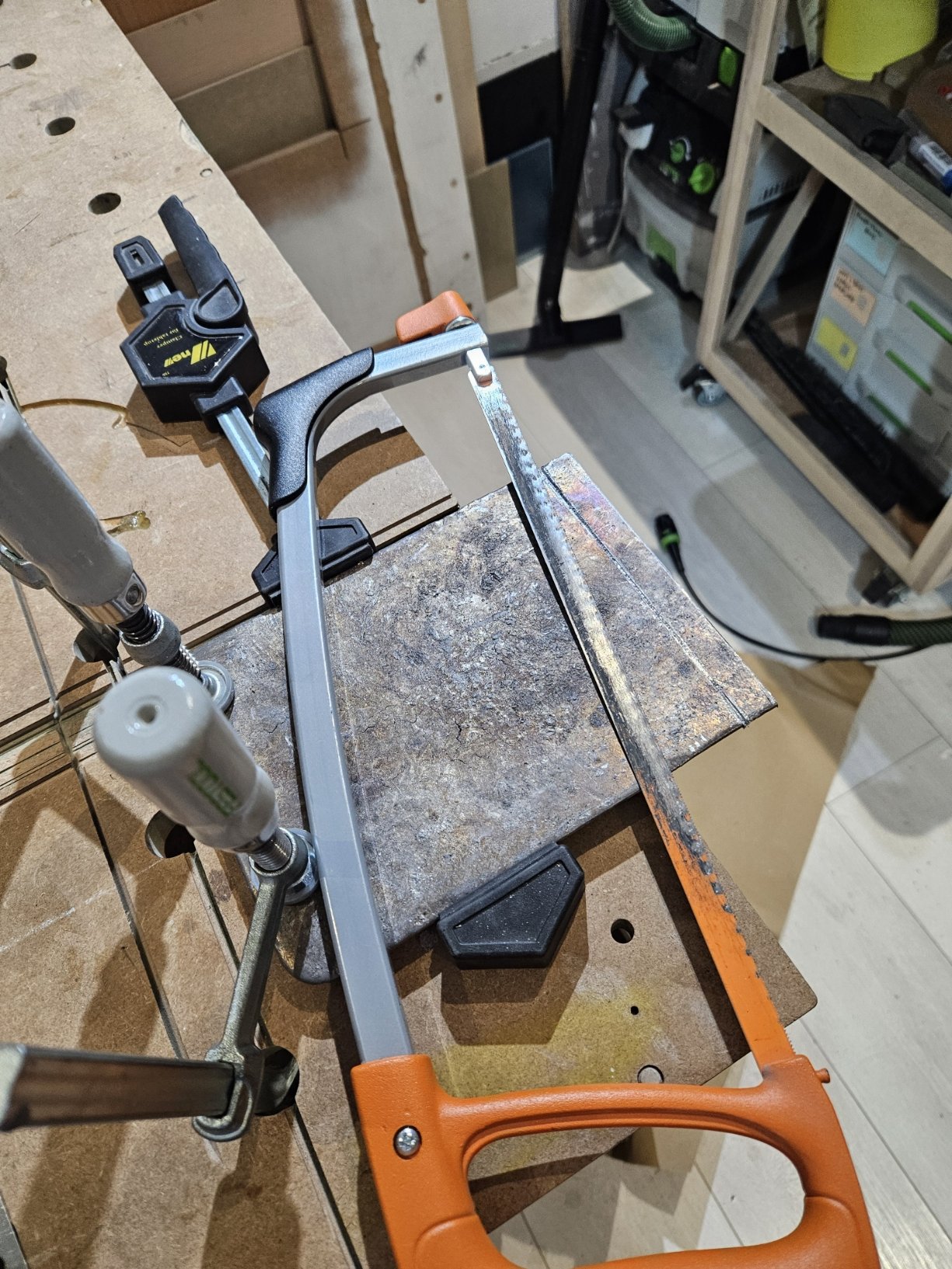

I think I have solved it...
Just ordered a 245x145x18mm slab of lead. Sawn in half, screwed and epoxied in place this will fit perfectly.
Maths says this should way about 7kg but the seller claims 5kg so we will see. Decent solution for £20.

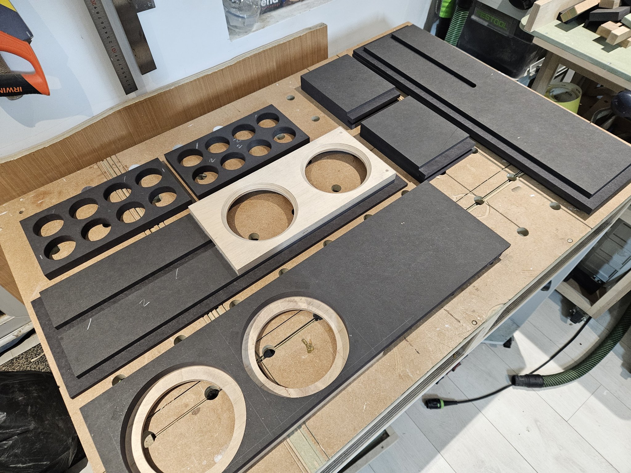

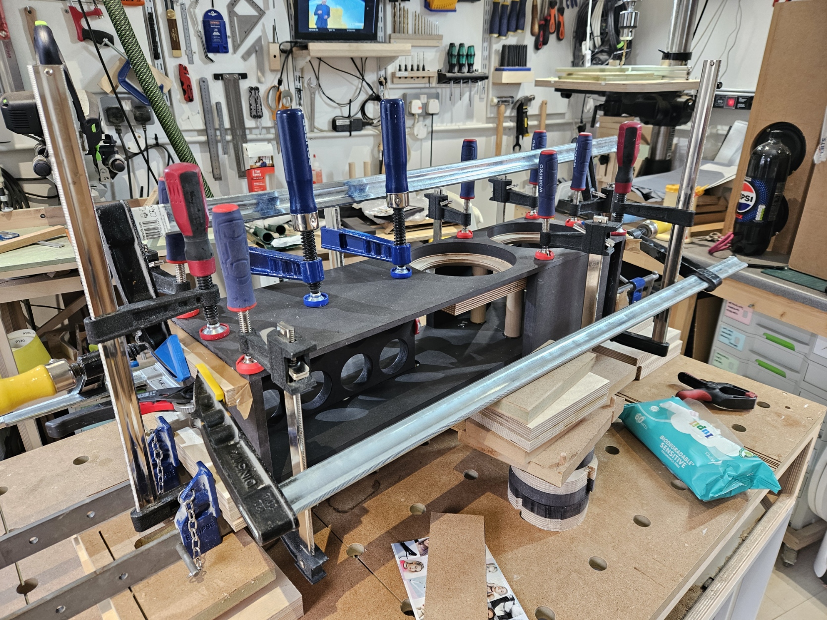

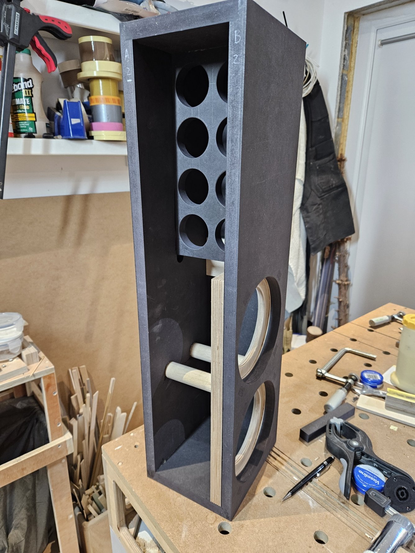

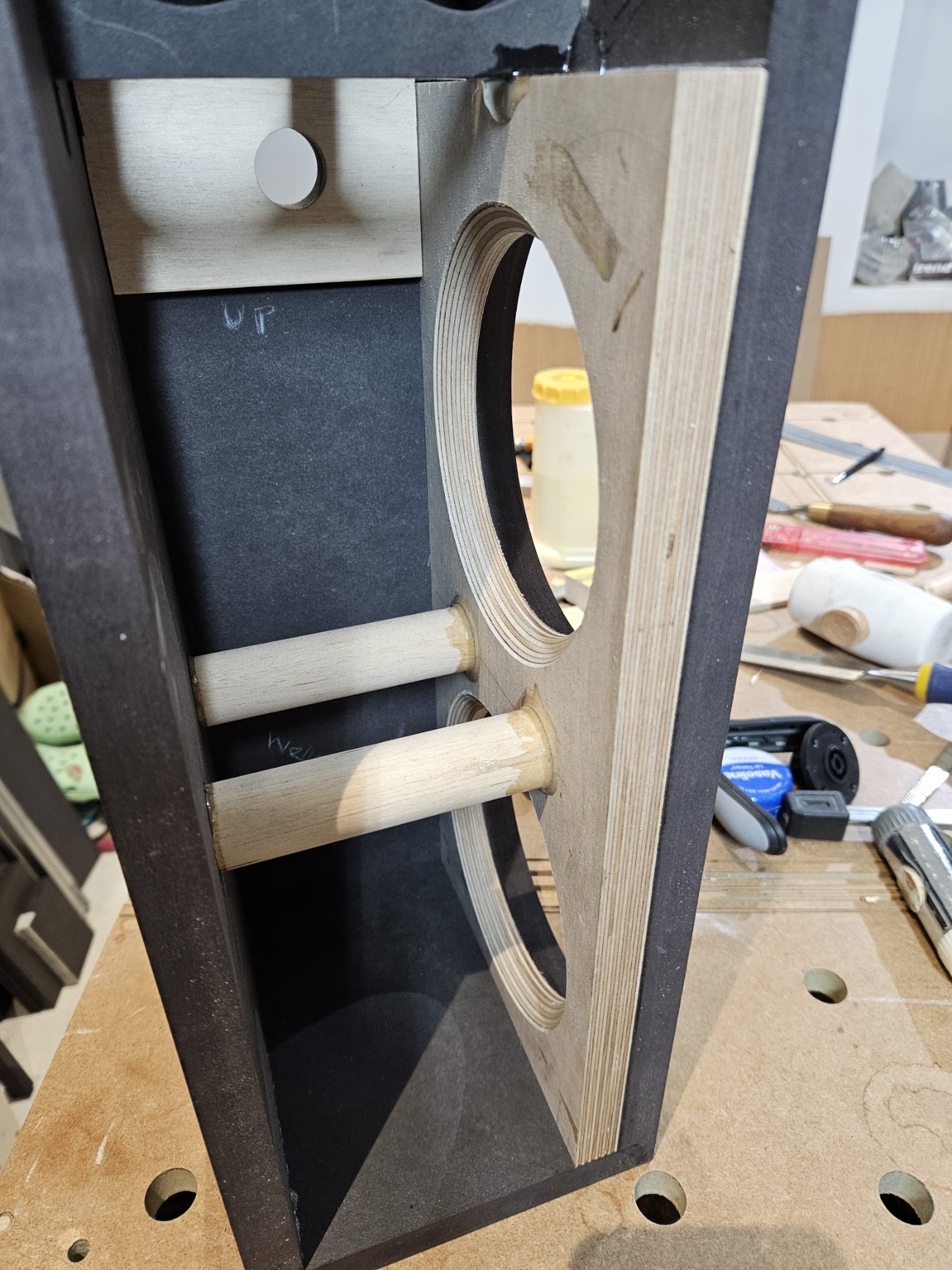

Photo Dump Update
Notes:
Notes:
- Use a low-tooth-count hacksaw blade for lead slabs - I learned that after almost finishing with a 24T blade. Ninny-muggins mistake.
- Black MDF laughs at dust collection.
- Glue-ups are never not stressful.

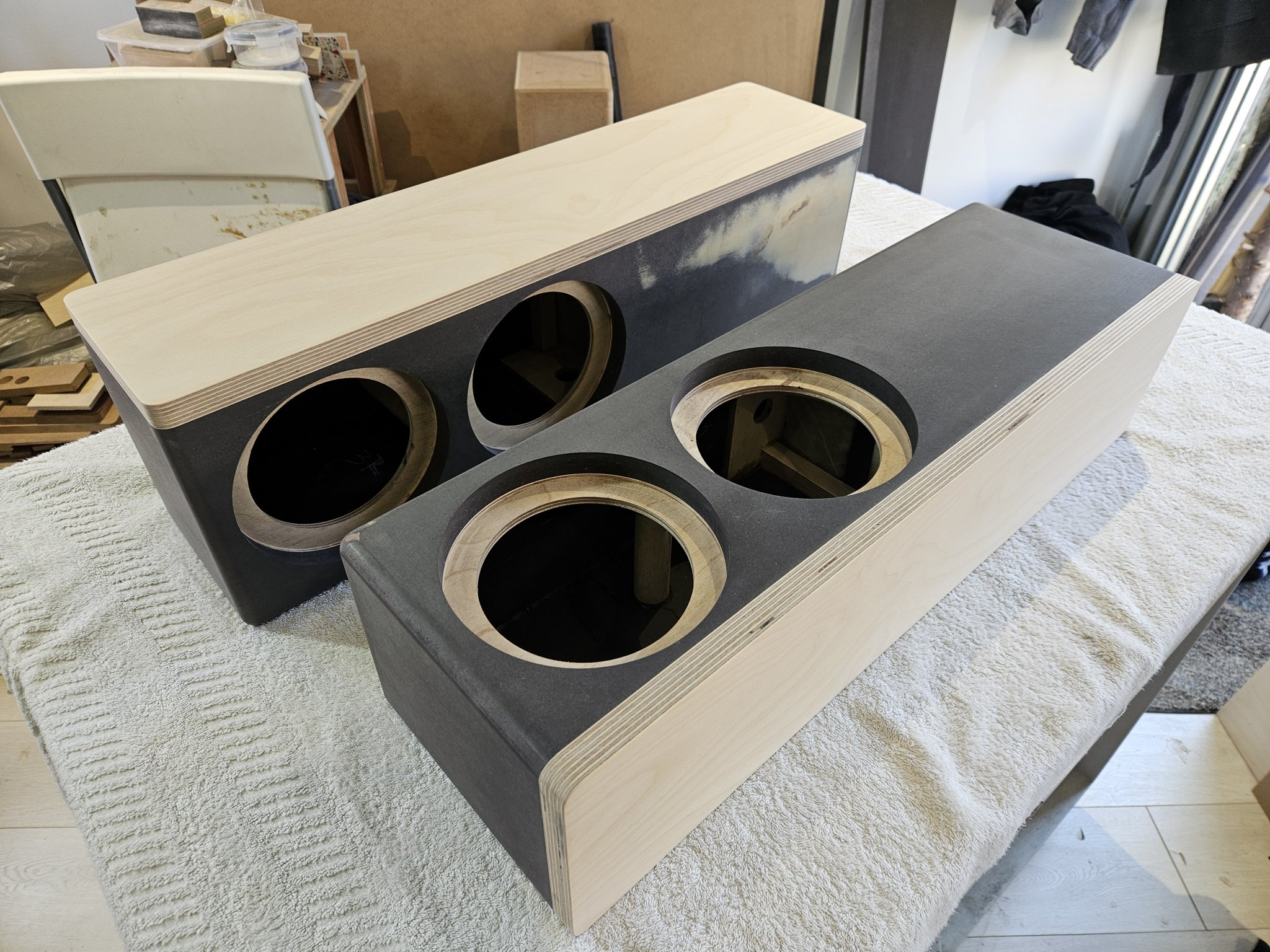

Great build and documentation!Photo Dump Update

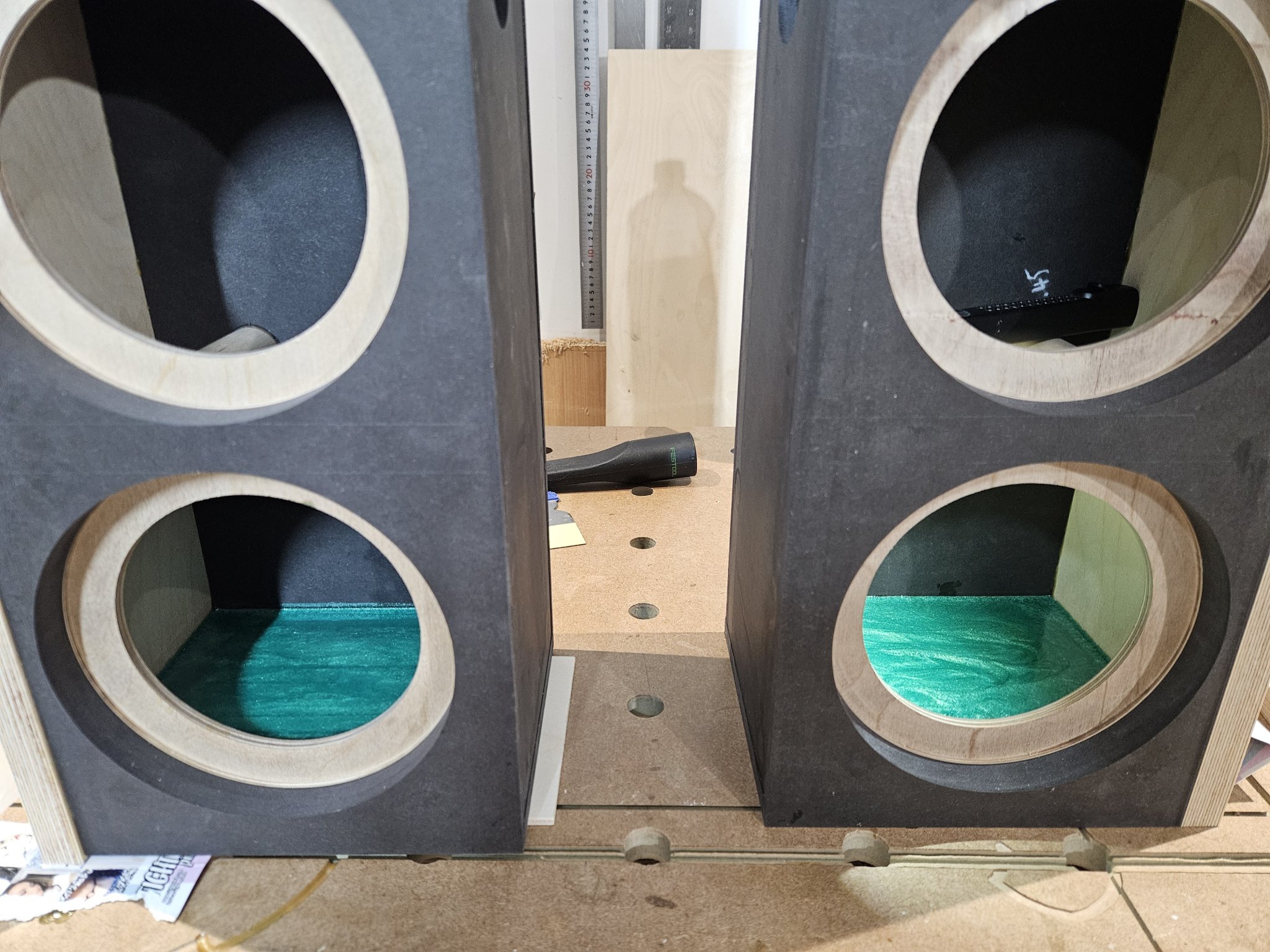

Lead covered by 2mm thick layer of epoxy. I added some mica as a little treasure treat for when I open the box in years to come.
Sanded and Ready for Paint & Varnish
A quick note for anyone working with Valchromat/Fibracolour - this stuff produces incredibly fine dust that gets everywhere...
One of the biggest challenges (which I forgot about) is how much faster it abrades compared to birch ply. You can see where I had to fill in a concave area after over-sanding without realizing it.
Another issue is contamination when using it alongside other materials. The black dust easily embeds itself in lighter woods, like birch, and can be difficult to remove. Just like last time, I had to sand and shape the birch and Fibracolour separately, making sure to finish the birch last to eliminate any traces of black dust.
It’s definitely something to keep in mind when working with this stuff.

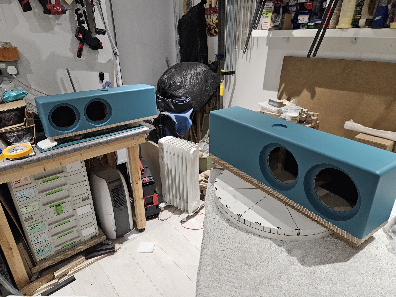

A bit of late night painting. The lazy susan I made for taking polar measurements is a god send...
