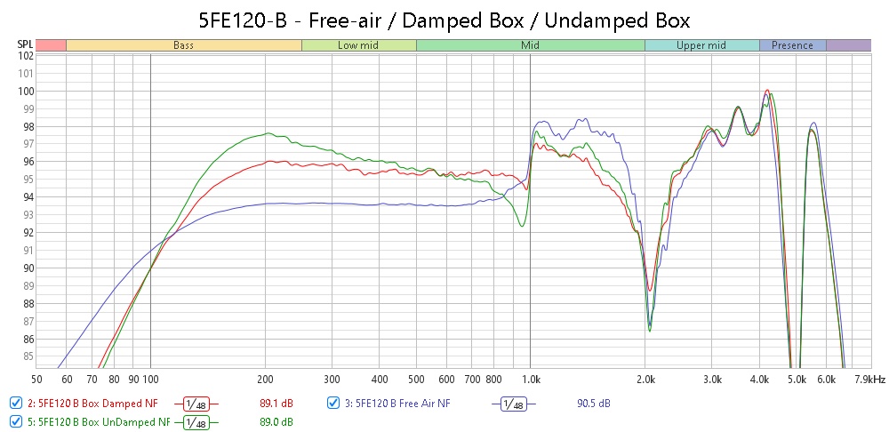

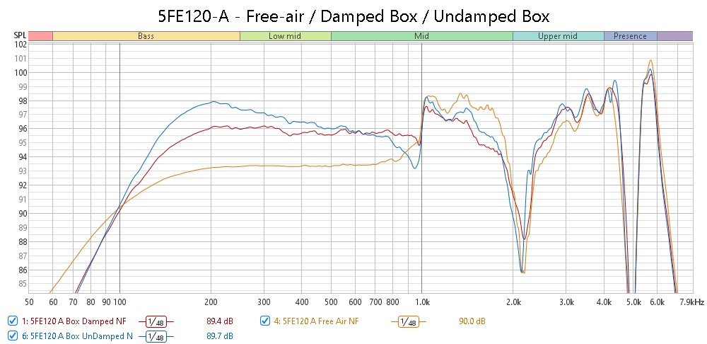

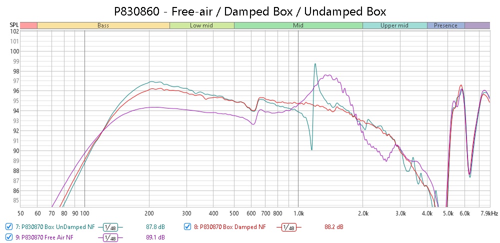

Maybe something to consider. Maybe I am wrong.What’s odd is that with a 121mm cubed box, I expected the primary standing wave to be around 1.4 kHz, but I’m not seeing any evidence of that. Instead, these lower frequency smears are dominant. If anyone has a theory on what might be going on there, I’m all ears.
Your box is heavily stuffed. What we are achieving with stuffing closed boxes? We get apparently bigger volume due to lovered speed of sound. As you wrote Q fell from 0.90 to 0.74, what is not small step. So, as box is apparently biger, first standing wave is lower.
Try to model the box which dimensions giving Q=0.74 without any stuffing and calculate standing wave resonance. Could be close to your measured resonance.
