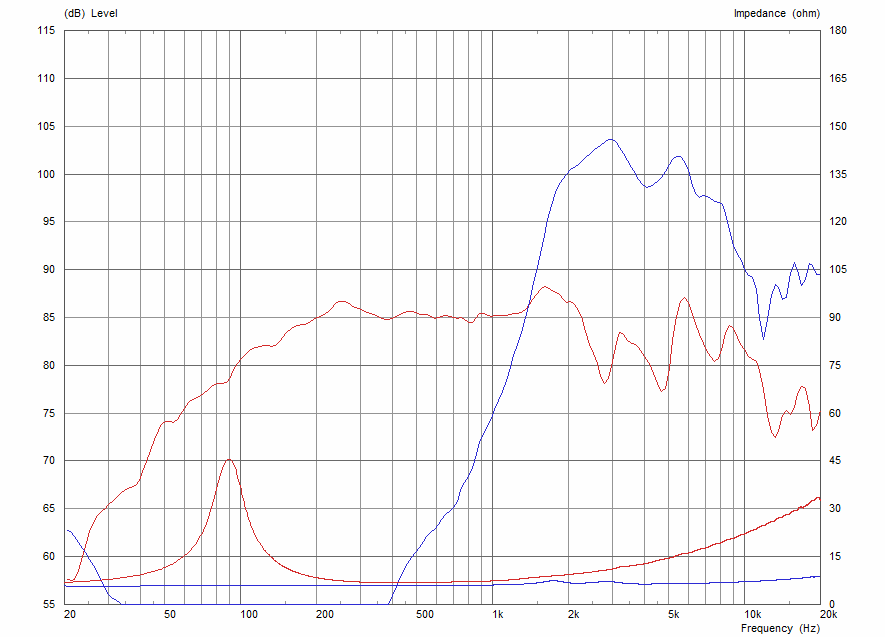

Maybe something to consider. Maybe I am wrong.What’s odd is that with a 121mm cubed box, I expected the primary standing wave to be around 1.4 kHz, but I’m not seeing any evidence of that. Instead, these lower frequency smears are dominant. If anyone has a theory on what might be going on there, I’m all ears.
Your box is heavily stuffed. What we are achieving with stuffing closed boxes? We get apparently bigger volume due to lovered speed of sound. As you wrote Q fell from 0.90 to 0.74, what is not small step. So, as box is apparently biger, first standing wave is lower.
Try to model the box which dimensions giving Q=0.74 without any stuffing and calculate standing wave resonance. Could be close to your measured resonance.

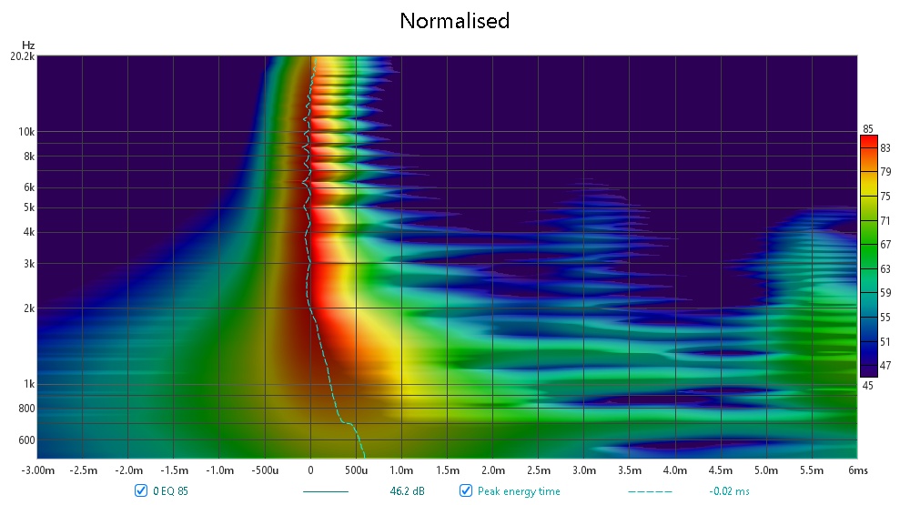

I had to get to the bottom of the cube crisis. Or is it a driver crisis? Crisis of confidence? Either way, I ran some tests.
I measured the Faital Pro 5FE120 (Drivers A and B) and used a Peerless P830870 as a control and 3D-printed an adapter that let it fit in the same box (adorable). All three were measured in:
Turns out the oddity around 1kHz in the 5FE120 made the box resonance tough to spot. It was there all along, just buried in the chaos. What are the chances that the 5FE120 response throws a fit right on top of the resoannce? The P830870 makes it easier to see - the resonance shows up around 1.2kHz and is completely killed by damping.
As @danibosn rightly pointed out, the resonance shifts lower when the 5FE120 is in the box. My guess is the big magnet and general driver bulk change the physics.

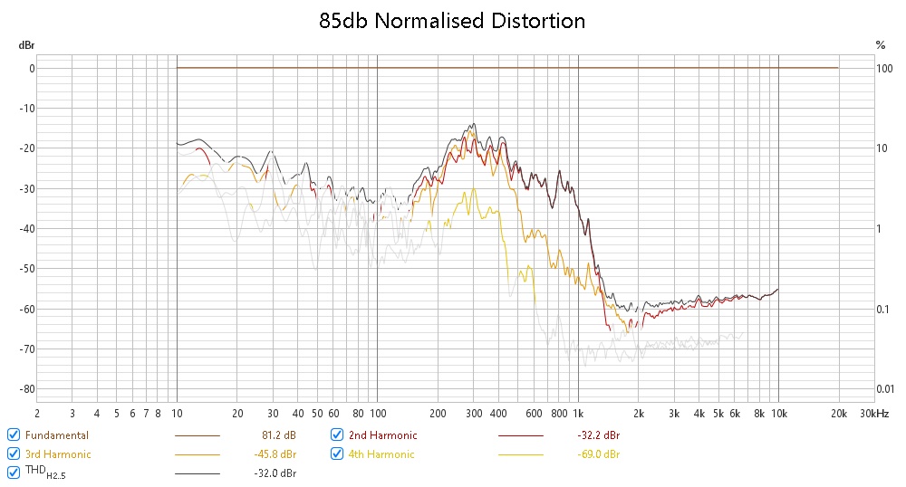

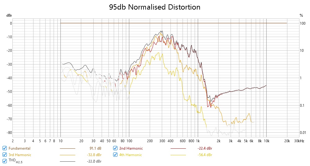

I did a couple more distortion tests on the 5FE120 alone in the cube at 80cm.
One where the SPL peaks at 85dB and another at 95dB.

From what I remember for distortion for the 5fe120 that looks right. I have a Clio pocket and it simply provides THD, 2nd and 3rd distortion measurements which is handy for a sanity check.
Printing the holder for the Peerless driver was a great idea to help you see what was really going on.
