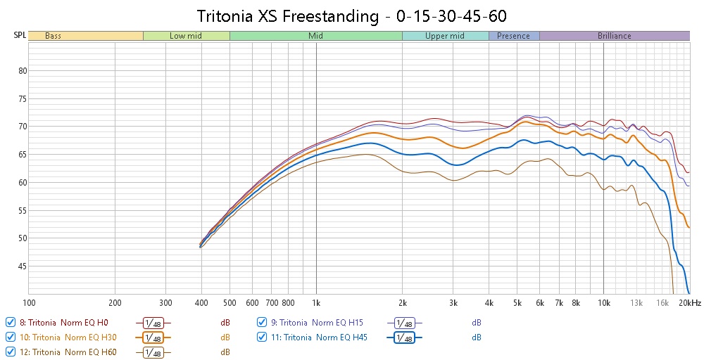

Still had my default smoothing on from the sub measurements. Here are the important ones unsmoothed. Gated at 2.5ms.

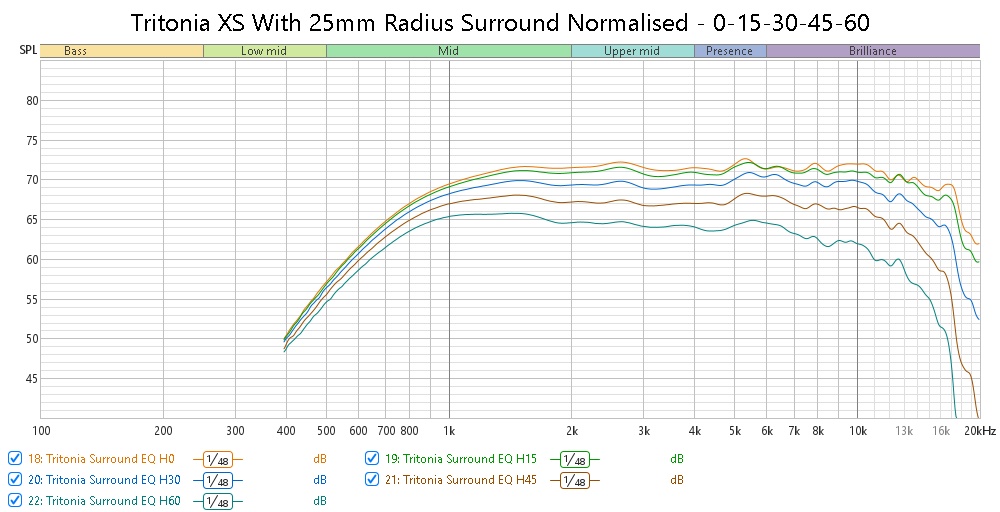

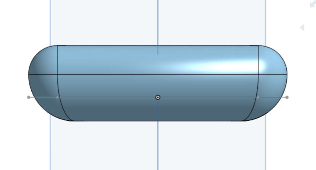

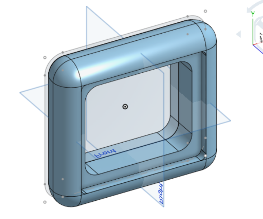

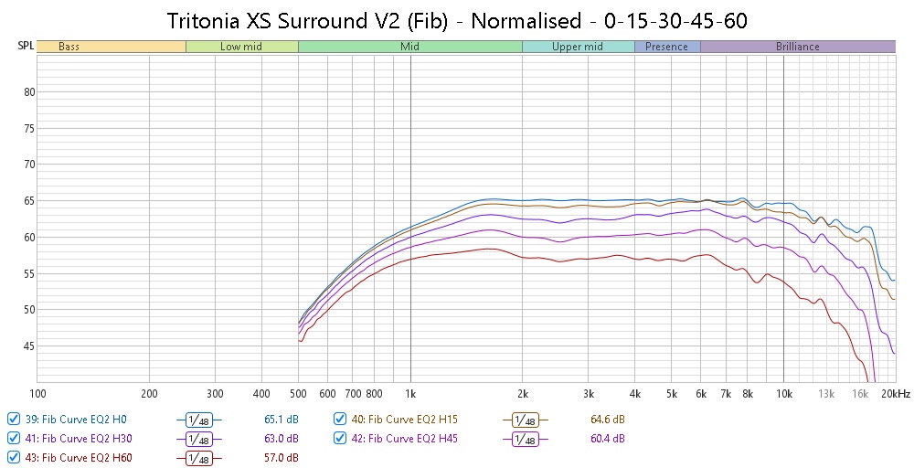

Encouraged by the measurements of the roundover surround I added to the Tritonia XS, I’m now trying to adapt that performance into a version that fits my printer bed (180×180 mm). Ideally, I’d like to print it all in one piece.
The Tritonia XS is 140 mm wide, which gives me 20 mm to work with on each side. I experimented with a 20 mm roundover followed by a larger curve that wraps toward the back. To shape the transition, I (somewhat naively and superstitiously) used the Fibonacci sequence to grow from 20 mm to 32.3 mm.
New profile (printable in one piece):
Comparison: 25 mm radius roundover surround:
There’s very little between them in terms of performance - but is it enough to justify the effort?
Can this be fully resolved, or have I officially lost the plot?
Would love to hear from others who have dabbled in this 🙂

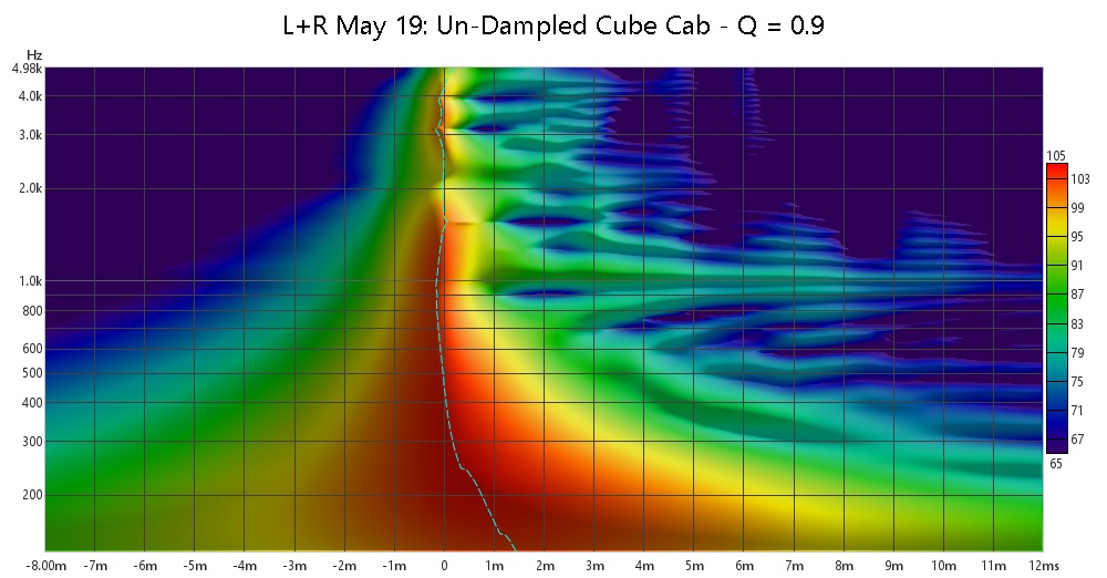

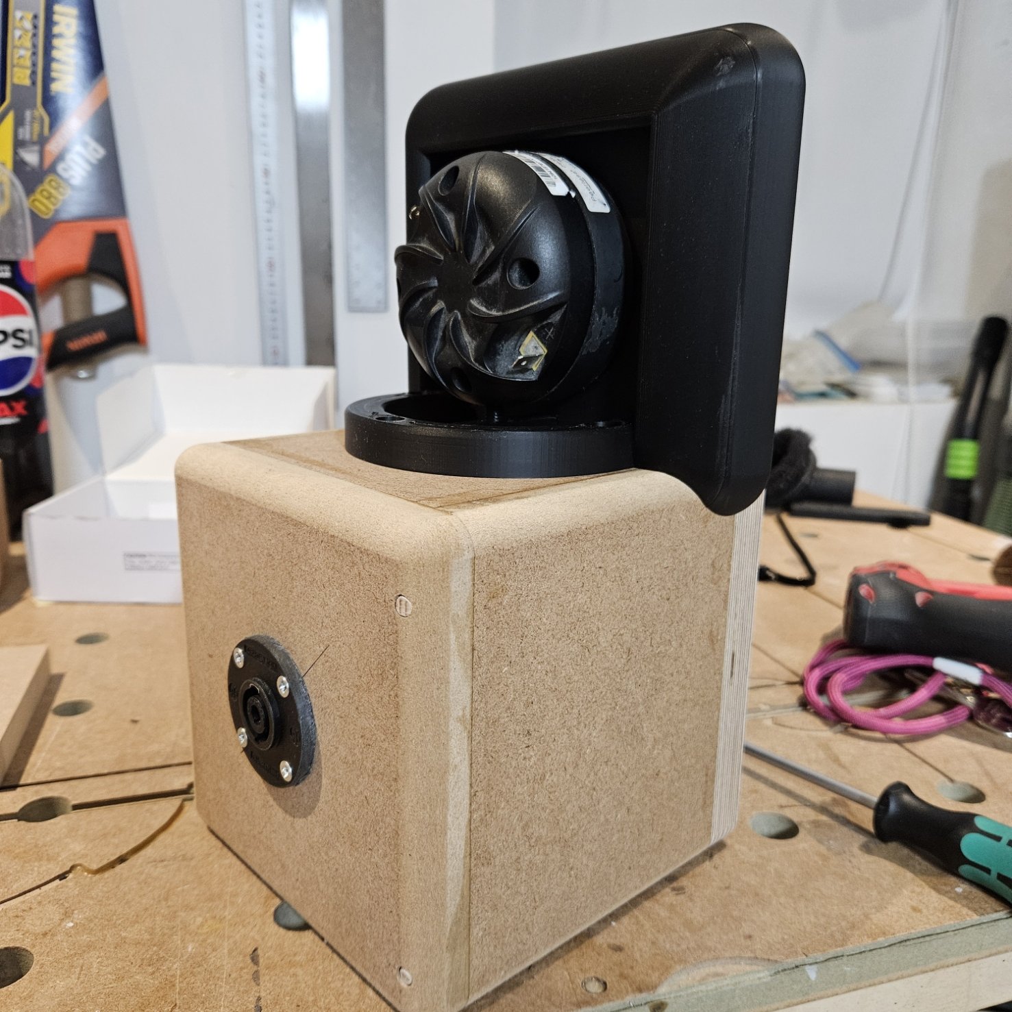

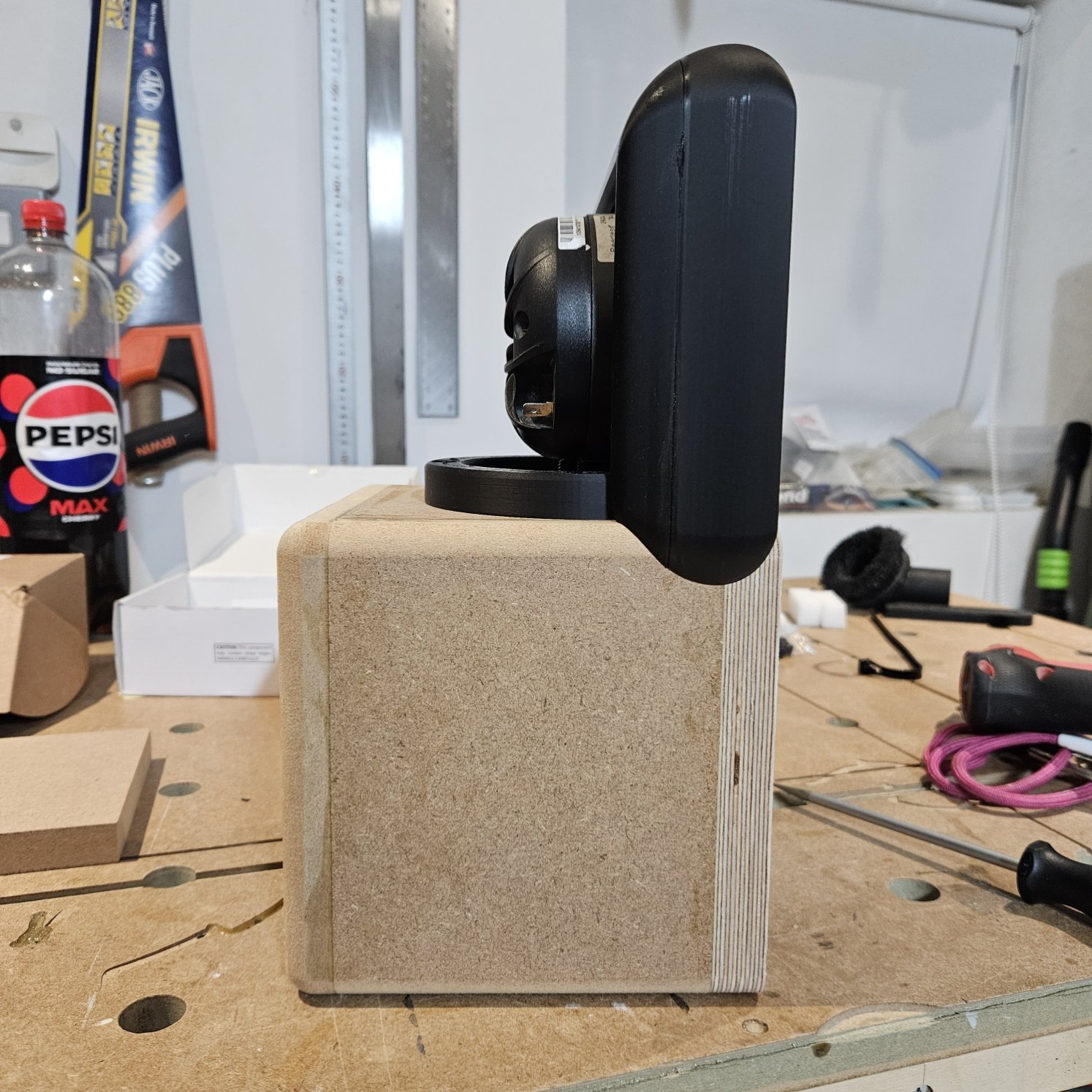

Cheap Experiments, Cube Resonances, and 3D Printed Threads

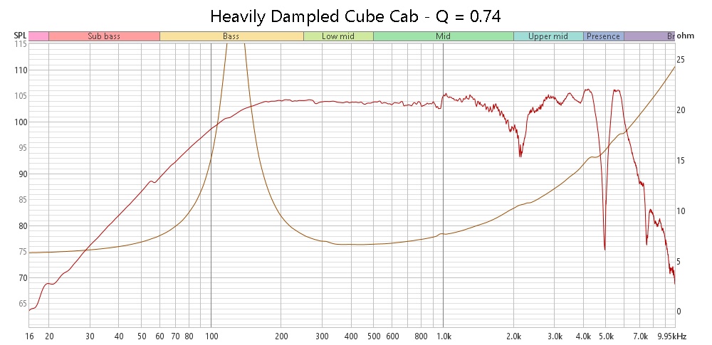

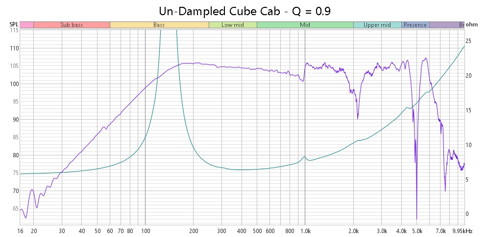

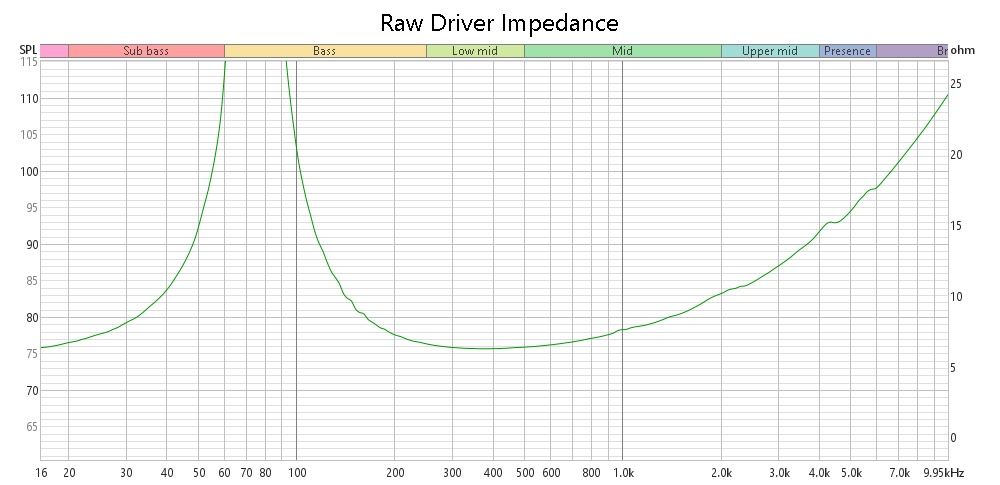

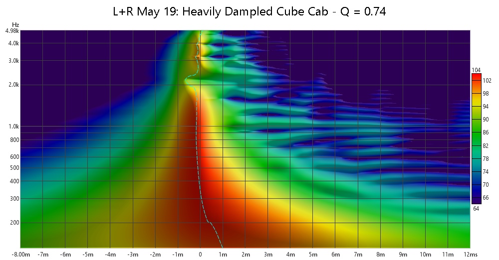

Bit of a mixed bag today - part pleased, part forehead-slappingly annoying.
I plumped for the Faital 5FE120 as a cheap experiment to play with. To keep things compact, I decided to crop the back of the slim tower design and ended up with a small 2L (1.5L net) sealed enclosure. That pushed the system Q up to 0.90, but I figured with decent damping (I used Rockwool) I could pull that down toward 0.7. I managed 0.74 in the end, which is close enough.
What I didn’t quite plan for was the resonance issue around 930 Hz and 1 kHz. Despite the stuffing, I’ve got lingering energy visible in both the frequency response and the impedance sweep - neither of which are present in the raw driver measurements. The damping definitely helped, but it didn’t eliminate it entirely.
I mean, I knew I would get a super strong standing wave because of the cube but this is nuts.
Is it the driver or is it the box?
vs.
Nothing shows on the datasheet and I'm struggling to find measurements that are detailed enough elsewhere.
What’s odd is that with a 121mm cubed box, I expected the primary standing wave to be around 1.4 kHz, but I’m not seeing any evidence of that. Instead, these lower frequency smears are dominant. If anyone has a theory on what might be going on there, I’m all ears.

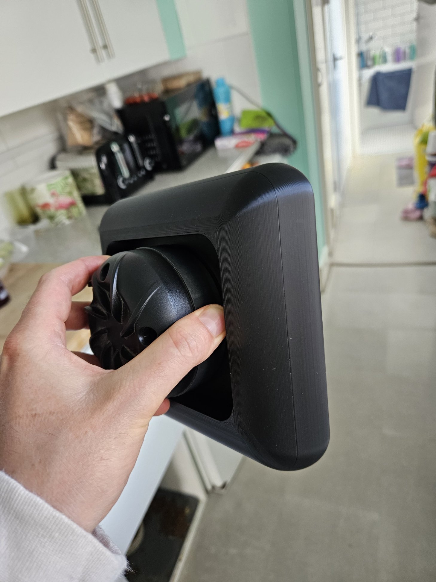

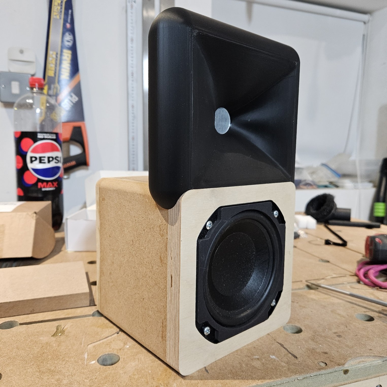

On a brighter note, the horn/baffle transition is coming along nicely, and I should be able to get some farfield measurements tomorrow. Also - and this might be obvious to everyone else - I just discovered you can 3D print threads. I added one to the base frame of the horn support, which now screws up snug against the compression driver body to take strain off the horn’s face. Just a prototype for now, but I think I’ll need to add some gussets or a vertical brace to keep everything rigid.
Anyway, I really like how it's beginning to look, it vaguely reminds me of the Vivid Audio Kaya speakers. Prototype took around 15 hours of printing and I think the nozzle came loose towards the end.
PS. Excuse my "damples". It's been a long day.
This is FAQ # 682
A:
“The first step in looking at any speaker system, is to take nearfield measurements of the individual driver outputs. This tells you what the driver is doing and removes almost all of the room acoustics effects and some of the cabinet affects. Doing anything else first is a waste of time”
Reference: Jack Hidley ; who's probably forgotten more things that I know.
DIY 101: Take the driver out, put your mic up as close as possible the cone/dome e.g. < radius / 2; and re-measure.
Reactions: grahamgraham
I have used the 5FE100 and 5FE120 in the past, and I will use them again because of their cost performance and ability to handle some power
I am puzzled by your box result, but there is no arguing with the impedance blip at 1KHz. Did you chamfer the driver mounting hole at the rear?
Maybe some more running in would help or a different microphone position will show it in a lessened way
I have attached a screenshot of what I measured some time ago with the driver in a small cabinet 8 by 11 inch. 12dB/octave full range, and approx 2.5mS and gated 12dB/octave.
In my case I think the breakup was the hardest bit to push down as much as possible whilst still trying to get 2.5-3KHz out of the driver to hand over to a small 19mm tweeter, in your case this should be a non issue as I assume you are handing over to your HF driver by 2kHz or below.

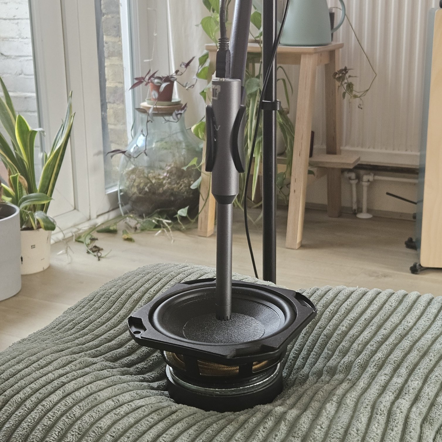

Something resonating at ~1k, if box is smaller than that it's no internal resonance but something else. The whole box could be it, not the walls resonating but the whole object. It could possibly excite the table it sits on for example. Maybe the waveguide rings symphatetically with the box, or something like that. Blip on impedance plot could still be seen even though sound wasn't coming from inside the box, the woofer is a microphone while you do impedance sweep, and any external sound source is recorded and shows as blip.
You can test this stuff quite fast, just using the impedance measurement and see what happens to the blip at 1kHz:
  • remove the waveguide
  • change how the box is coupled to table, or any fixture yo have it sit on
  • measure driver free air
Perhaps it's something else, simple debugging like this should help to find it.

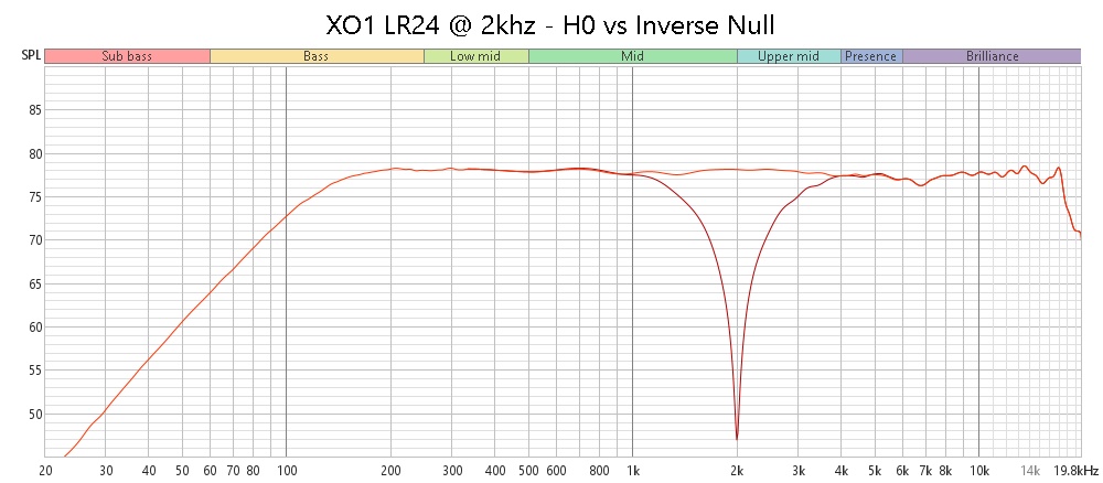

VituixCAD Woe, 5FE120 Handshake Issues and Confusion³

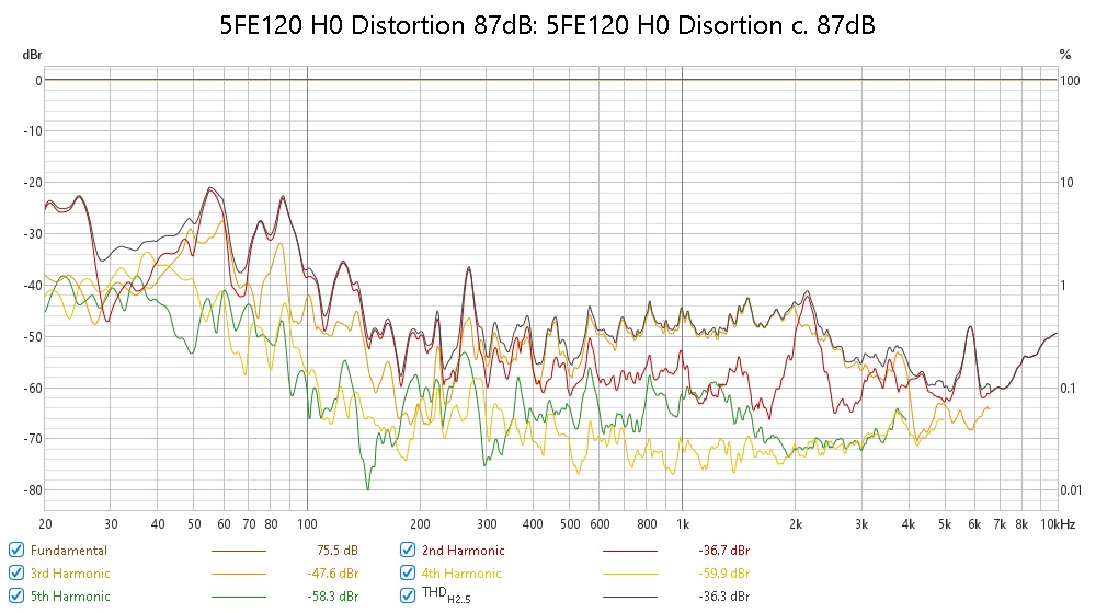

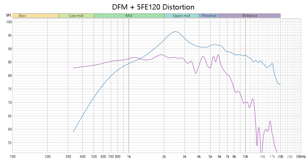

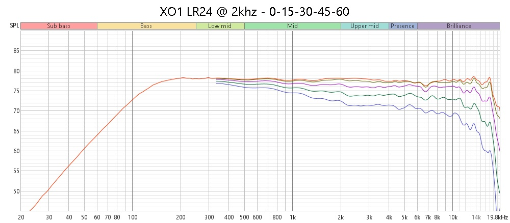

Tried
to cram this into my lunch break while working from home. First time using VituixCAD for a real project (I usually rely on X-Sim 3D). Spent a good hour chasing my tail before realising you have to set your DSP system in the config. That one caught me out.
Anyway, on to the results.

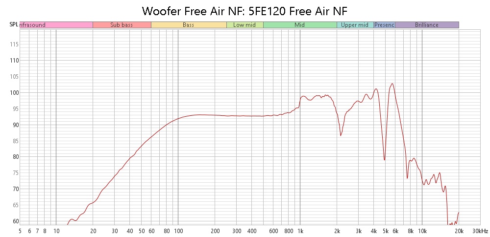

The nearfield measurement confirms a blip around 1 kHz, so I’m not imagining things. Still, I can't explain why this enclosure shows zero standing waves in the expected regions. The spectrogram is clear, but the behaviour doesn't align with what I expected from this box shape. The distortion of the 5FE120 correlates with the mesurements that @stv very kindly linked above. A 2khz spike et al...
This is all still using the prototype horn and cabinet, so it's more academic than anything at this stage.

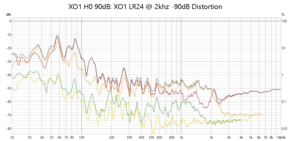

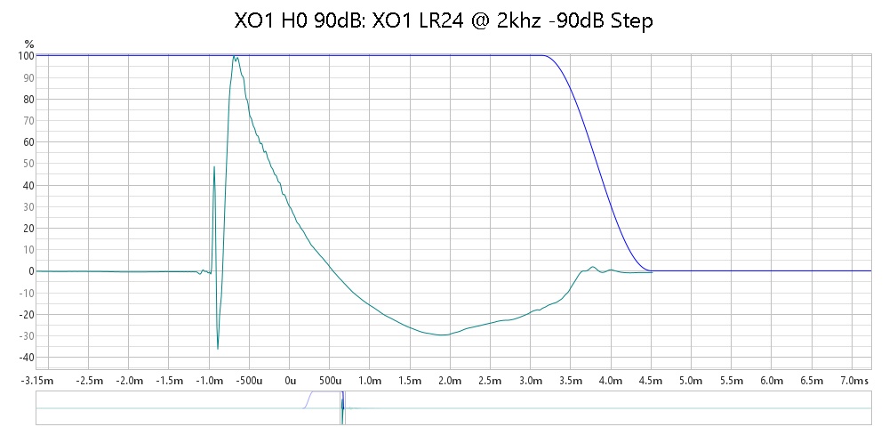

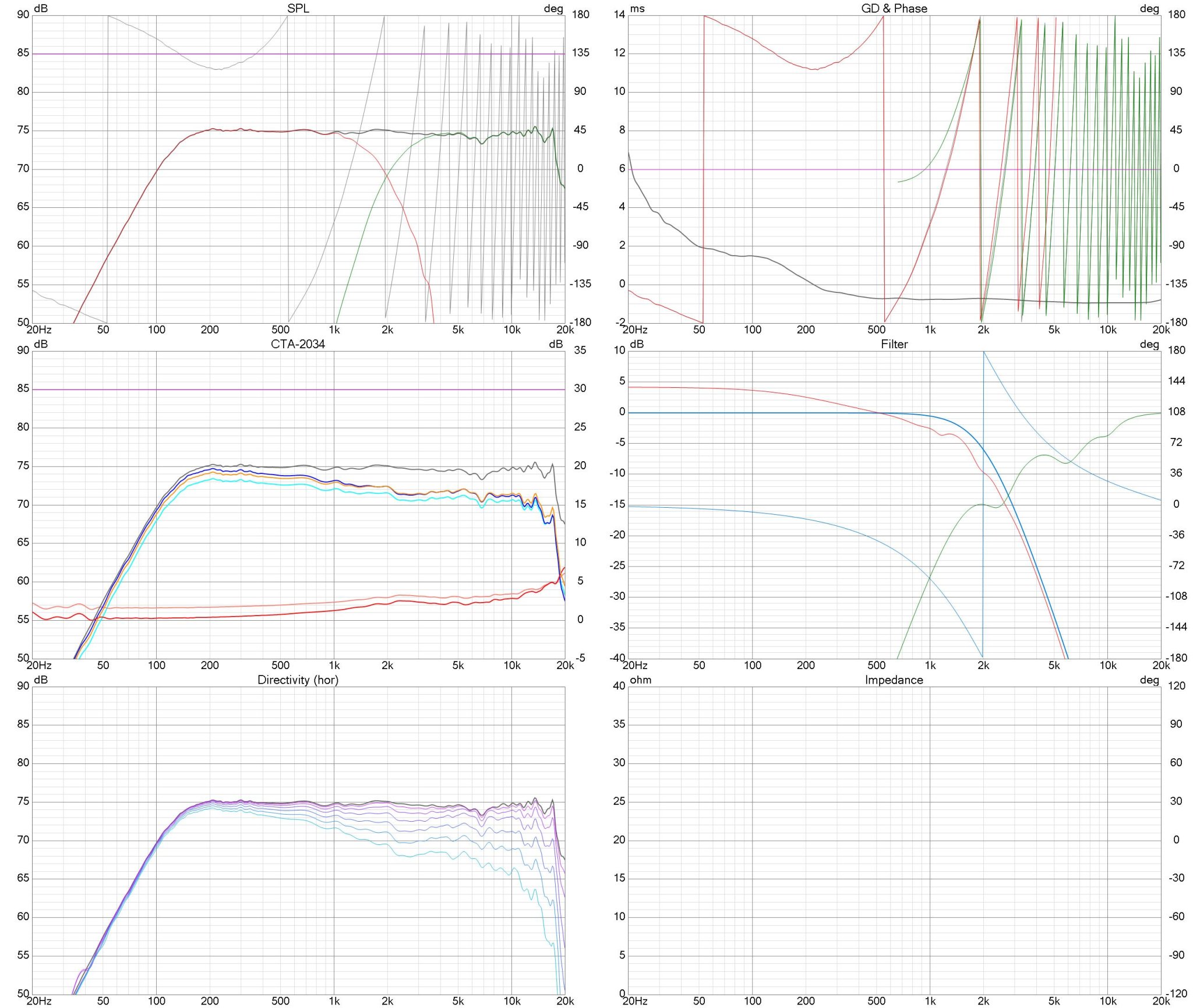

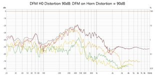

Crossover is set to LR24 at 2 kHz, and it's very obvious where the 5FE120 hands off to the compression driver. I’m beginning to question whether this driver is the right fit. Maybe I’m just being reactive, but it's got me thinking.

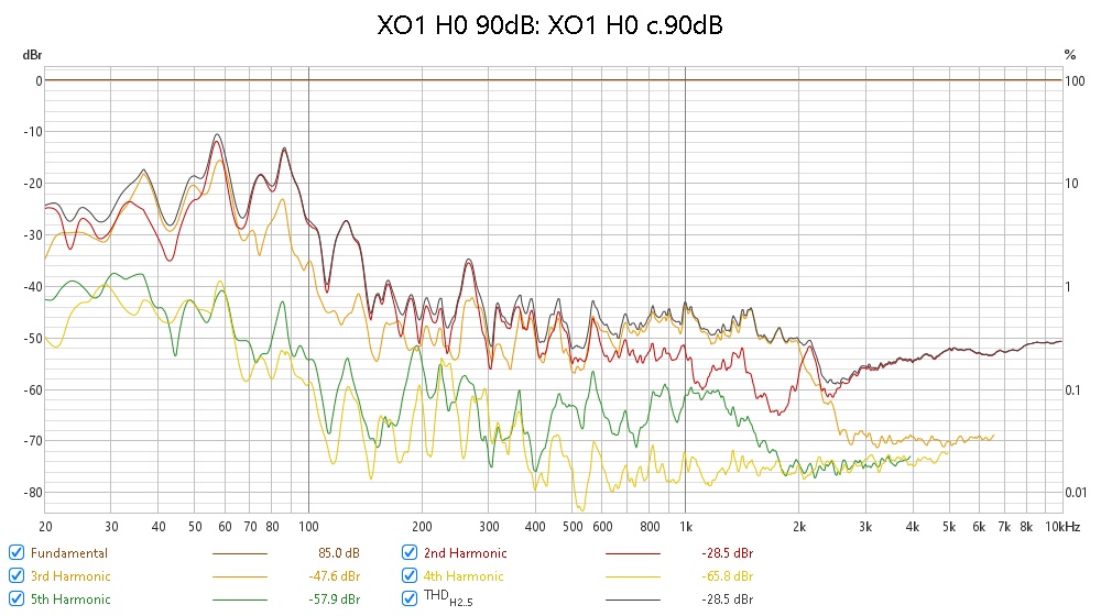

Much better horizontal polars than I expected though – very happy with those. No downward slope in H0 yet, might do that to taste when listening.

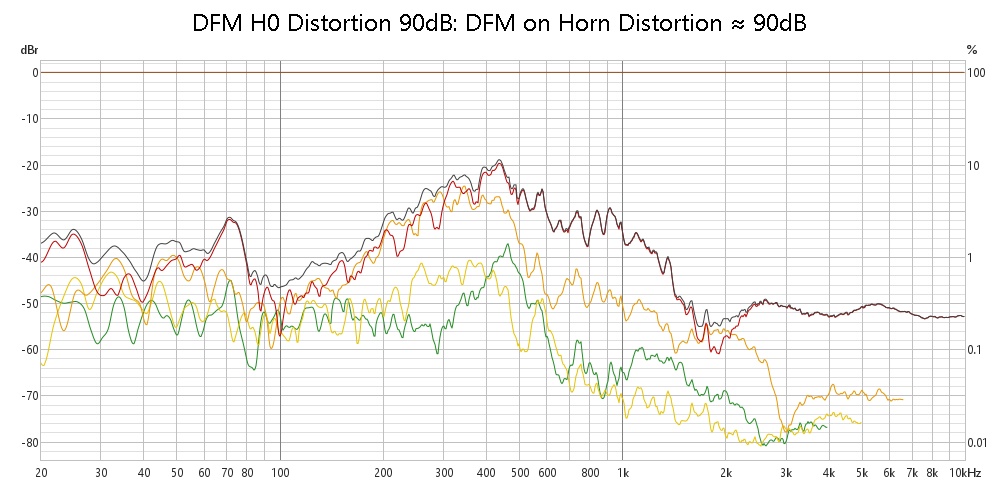

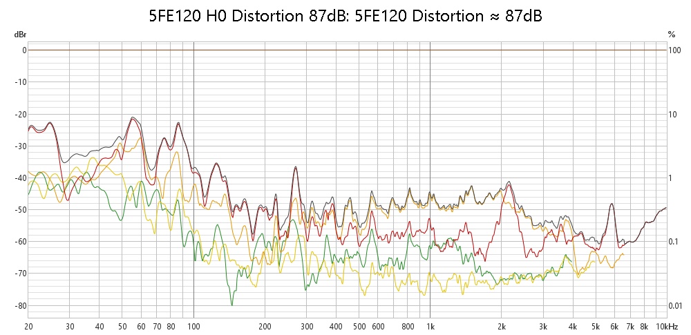

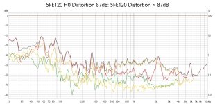

I'm not massively happy with the distortion performance of the Faital Pro 5FE120, but it does excel in one area: directivity. In my particular setup, its dispersion closely matches the horn (but could be better below 2k)
The core issue I’m wrestling with is a balancing act that pivots around SD.
  • If SD is too large, I can’t physically fit the driver on the baffle.
  • If SD is too small, the directivity narrows too late (around 1-2 kHz), leading to a mismatch with the horn’s dispersion and a less cohesive polar response.
