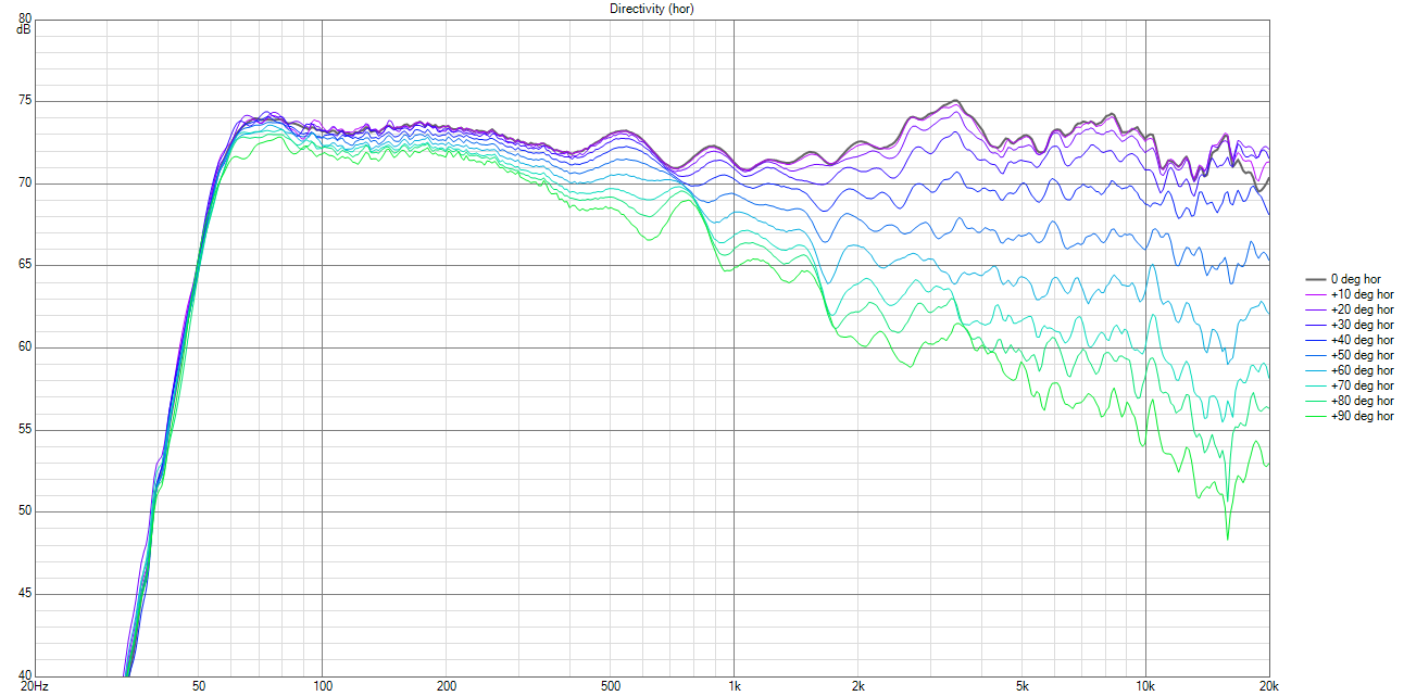

About directivity, it is measured in a large anechoic chamber, so accuracy below 500Hz is way better than amateurs can do.
Most 6" coaxials have more directivity. Sica 5.5 might be very good, as well KEF Q100/150 drivers.
Here another (merged) measurement of similar G2 https://www.audiosciencereview.com/forum/index.php?threads/genelec-g2-8020-measurements.18076/

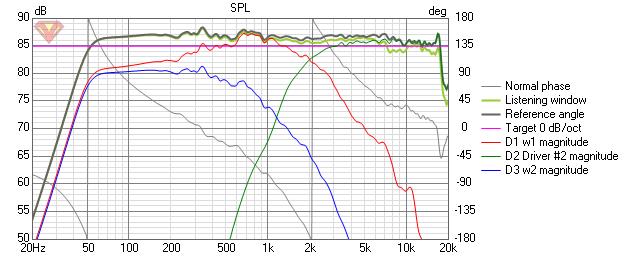

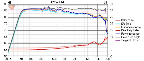

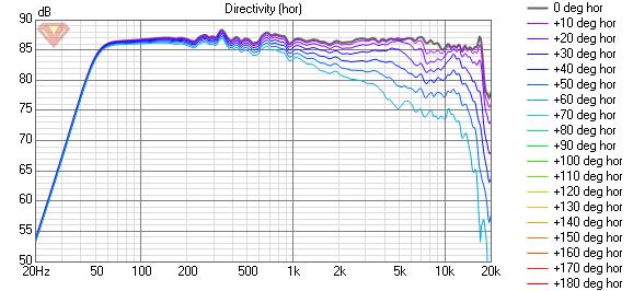

Curiosity got the better of me so I simmed 2x SB12NRX25 + the Peerless CD and cheap horn. I made a traced response from the datasheet, merged it with my hornresp sim and applied the floorstanding speaker baffle to each woofer. I used the test measurements for the horn in post 19. This is my first attempt at a 2.5 way sim.
A second order crossover at 2k-ish. The directivity isn't as awful as I'd thought but there is 'waistbanding' at 1000hz.

Thanks for this, I think I need to some of my own tests on the 4020 and see what happens in normalisation. I suspect that the results won't be too dissimilar to directivity simulation above.

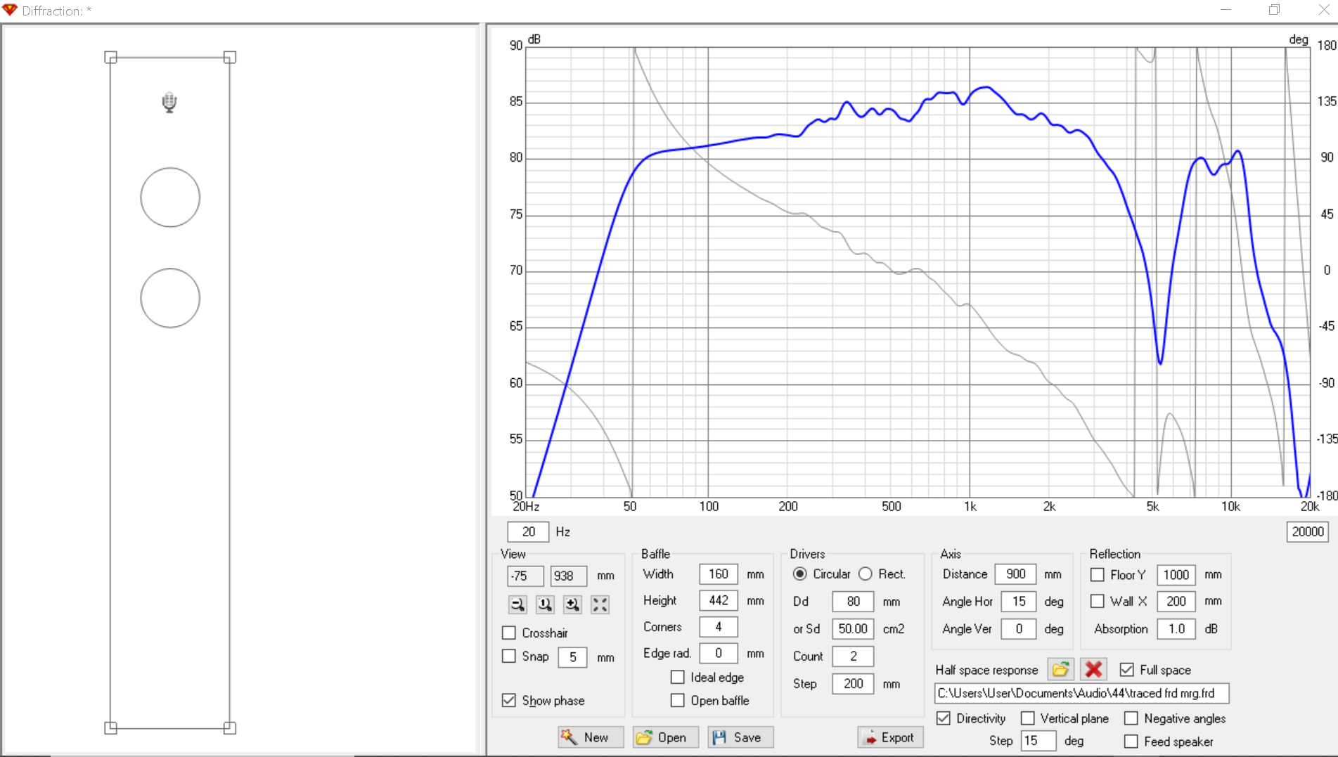

You could increase width at the rear side (trapezoid shape). This keeps visual appearence narrow, but adds volume.I am aiming for a floorstander around 160mm wide, depth not so much as issue but 180mm max.

A tower that is 160x180mm and say 900mm high is a pole... You must construct some kind of legs to keep it standing!
You will be in trouble trying to find driver units that can be used in such a narrow baffle, remember that it has walls with some thickness
Are you sure about dimensions?

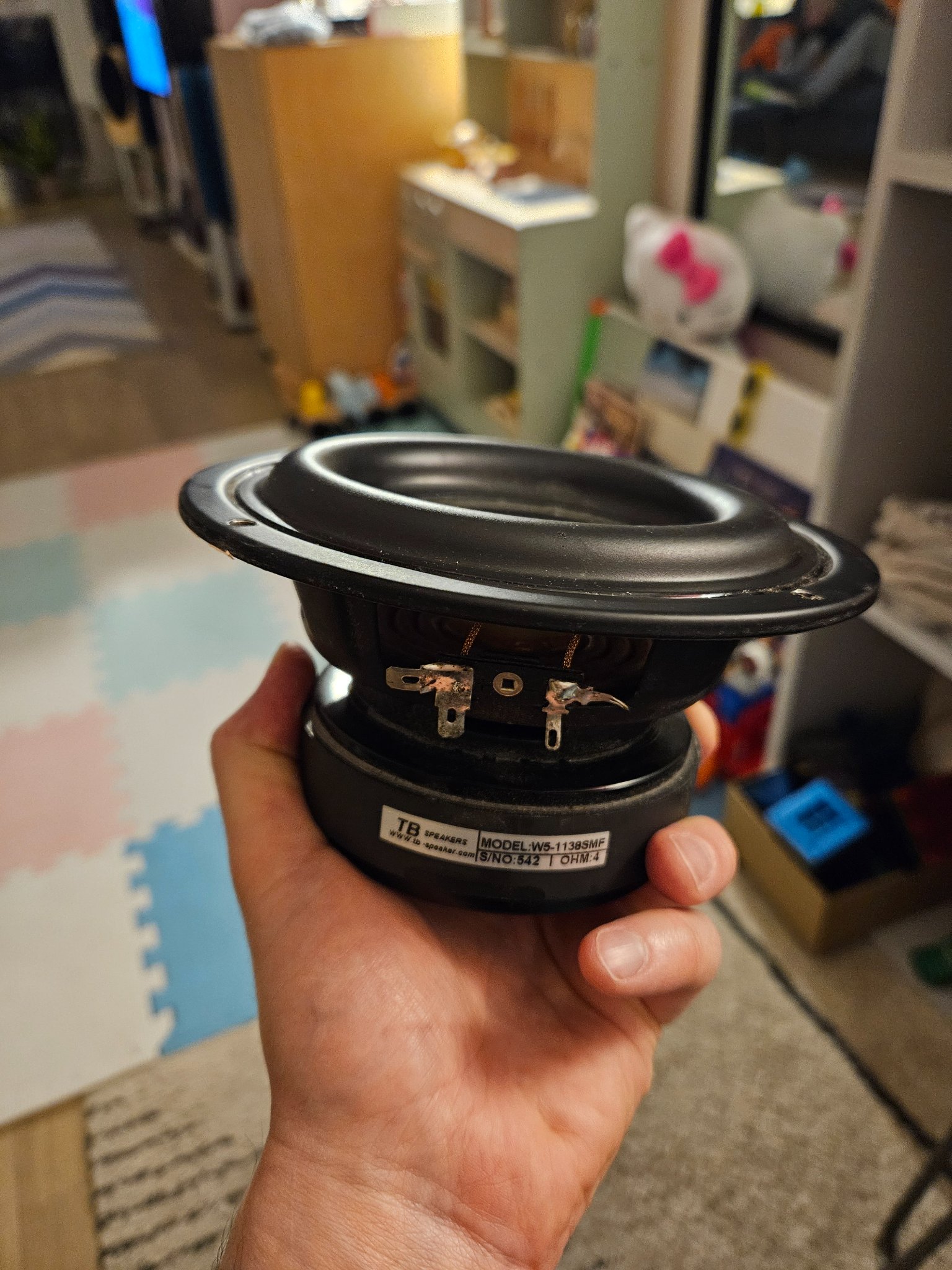

I wouldn't worry taking the 1138 to 250 at all, as I've used the 1139 to 600 before, and most recently to 400Hz. It should be fine.
However, don't limit it with a sealed box. I know EQ and DSP are the rage, but a vented of PR box will allow the extension required. The 1139 does well vented in 14 ltrs tuned to about 45, and the 1138 should be able to do 40Hz in 7 ltrs with a pair of 5.25" PRs. It needs to breathe for bass.

@wolf_teeth well, I just remembered I have one. I can do some tests, not quite sure how to measure distortion at 250 without room interference but ill get it in a box and see.

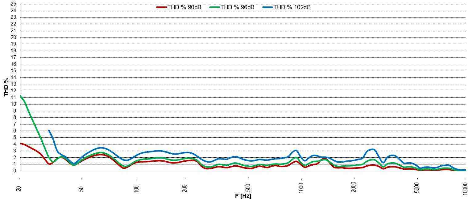

Here's some W5-1138 measurements, including distortion (YMMV): https://www.dibirama.it/home-page/s...rs-w5-1138smf-sub-woofer-5-4-ohm-80-wmax.html
You should compare measurements to others by same tester https://www.dibirama.it/archivio-altoparlanti.html
ScanSpeak 30W runs at 1,5%, so that must be masking with noise floor
