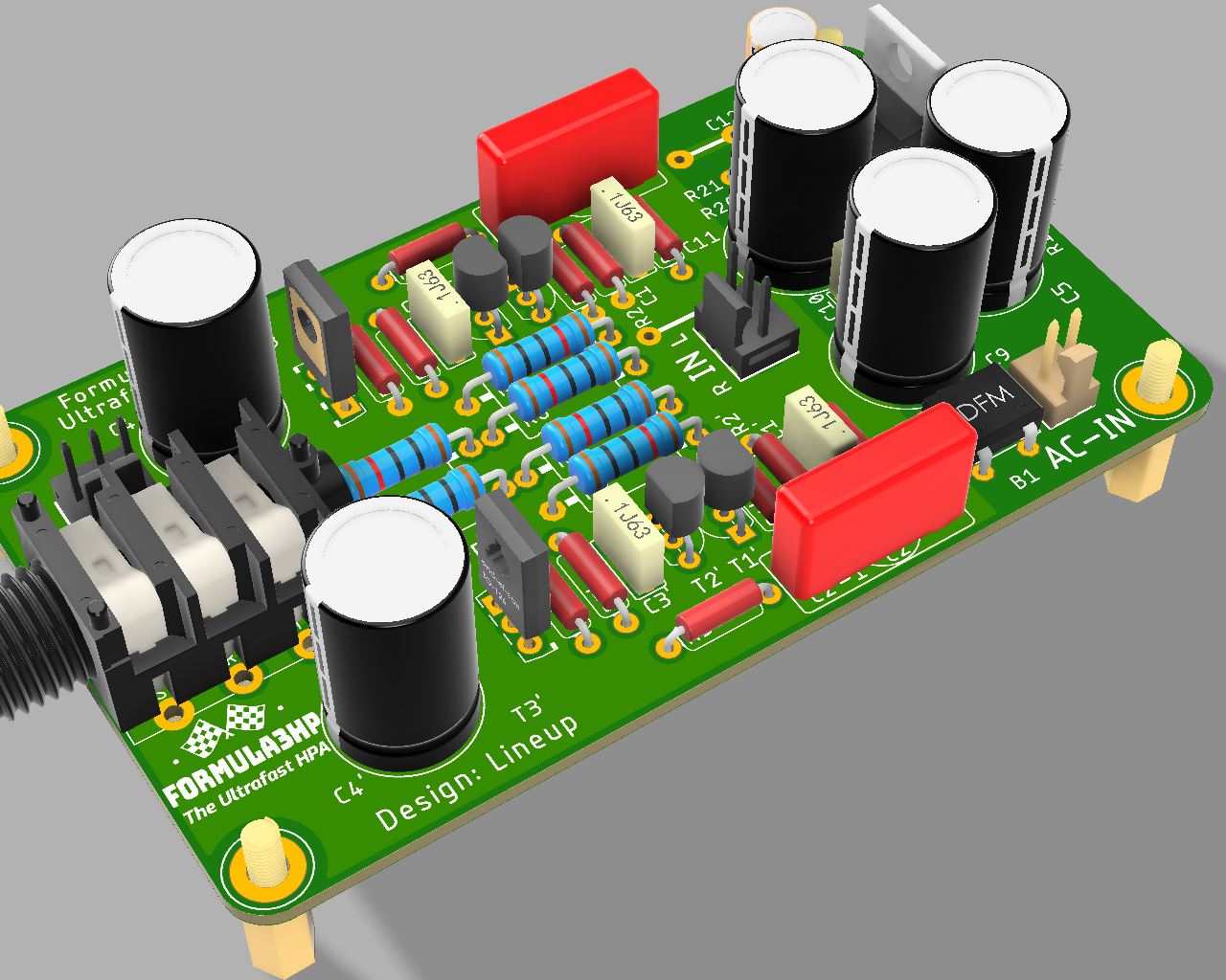

Great to see this made into one of your PCBs Prasi. And interesting to see an AC input rather than DC-DC regulation. I'd be interested to see if it makes a difference using linear power rather than an SMPS.

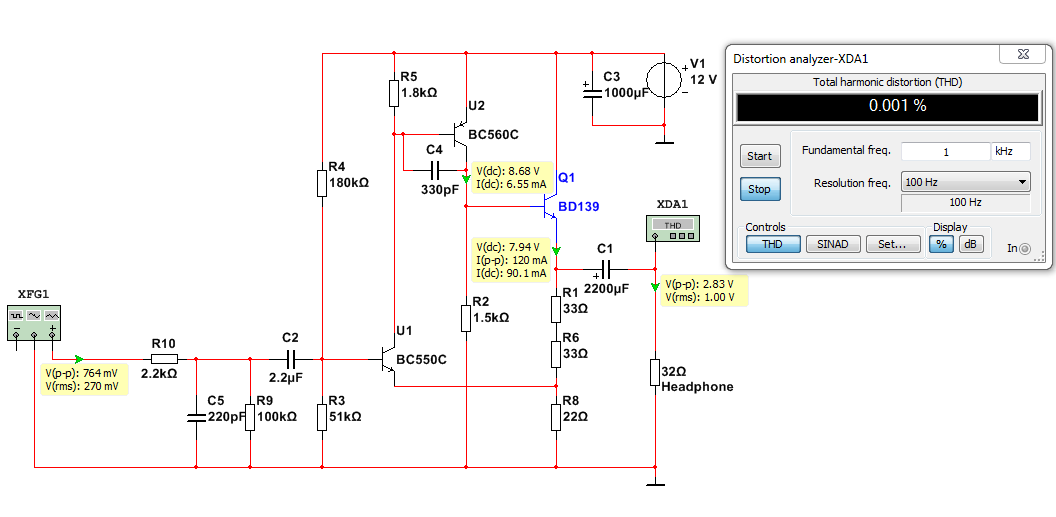

About the input capacitor = 22uF electrolytic
That cap was only used by me because sometimes my simulator measure correct only when is a high capacitance.
In reality I would recommend a film cap of value 2.2uF
That is quite alright for the input.
Those that can find a polyester or MKT of size 4.7uF can use this.
But as said, 2.2uF film cap will do perfectly.
This shows that cap:

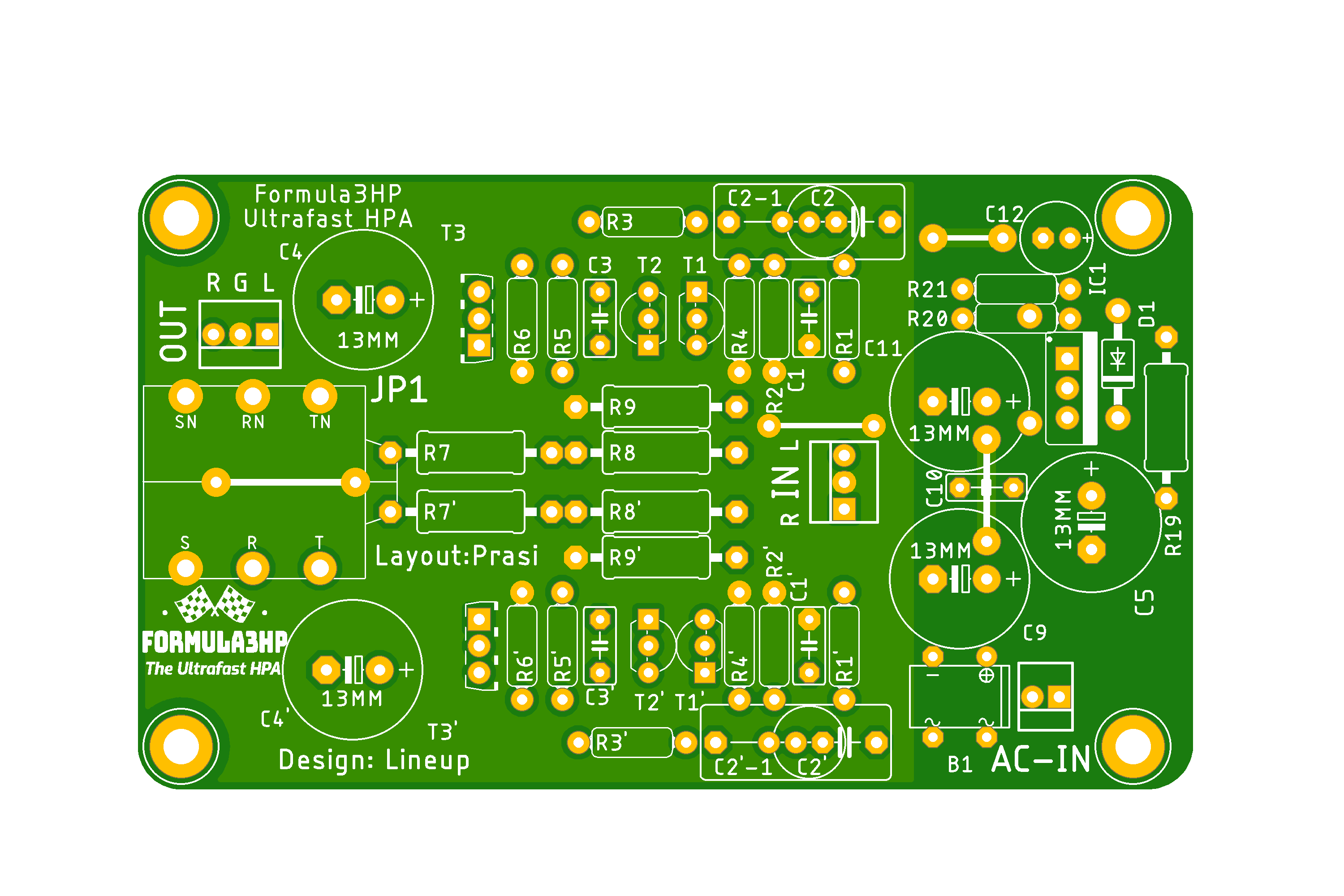

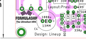

Finally happy with this version.
here 2.5mm, 5mm,7.5mm,10mm, 15mm pitch caps be fitted for C2, also small heatsink 274-1AB can be fitted for BD139. LM317 can go on bottom plate if required. In psu, RC/ CRC optional..

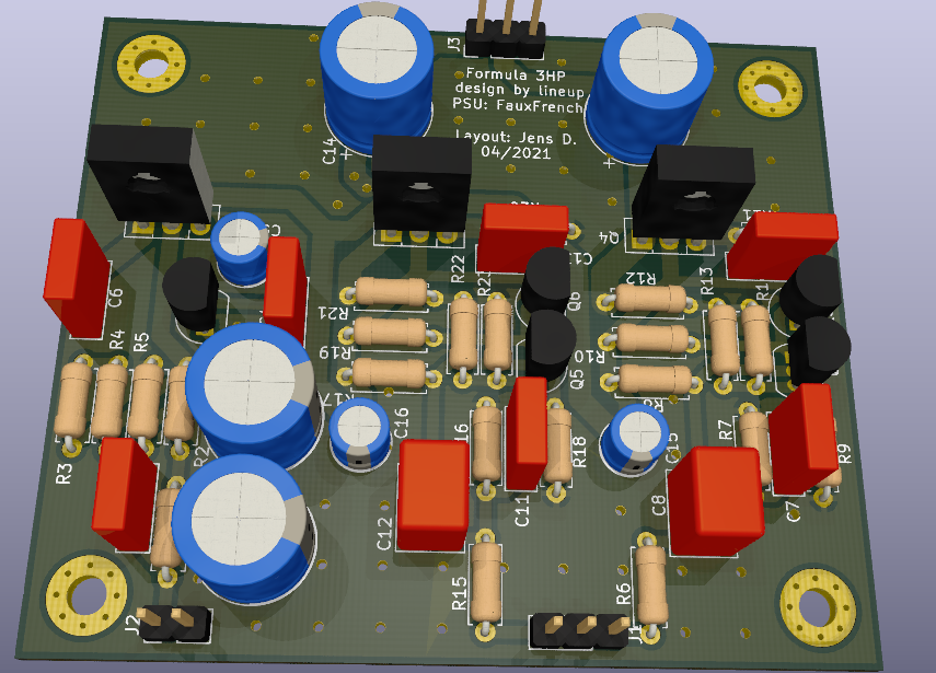

@prasi and @joensd
Your beatiful work makes me happy.
It is fantastic 🙂

Thank you and Namaste!Thanks joe, your pcb is looks nice. All the best for your build.
Namaste to sweden too!Your beatiful work makes me happy.

Circuit can be adapted for 9V, but probably not 5V.
But if you are using 9V battery - there is a big problem: Circuit draws 100 mA.
That would empty battery quickly.
Best is to use 12VDC with a LM317 regulator.
For 9V regulator we need to change some components values.

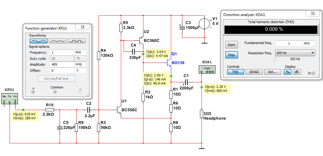

Here is one version for 5V.
It should work eventhough the dist is a litter higher.
THD 0.009% instead of 0.001%
It is possible someone could tweak this 5V version further.
But the distortion is still very small for this version.
The gain is here x3. The original has x4.
