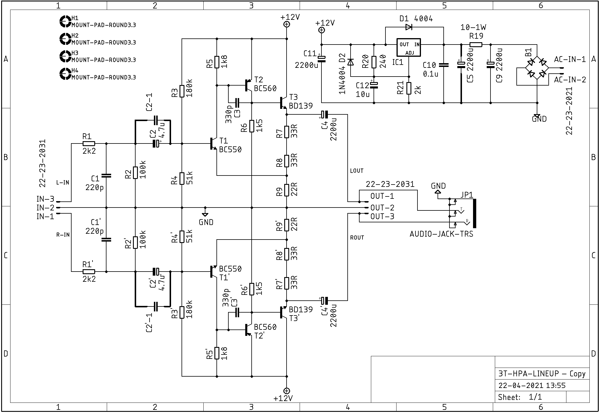

In some schematic the output coupling cap is 1000uF and others in 2200uF. Which one is recomended? And BC550-560 as B or C type? Thank you.
Transistors are BC550C and BC560C. Because C-type has higher gain.Hello!
I was asked about BC547 / BC557.
Both of those can be used = BC547B and BC557B.
Original circuit had 1000uF. And this will work.
If you have 2200uF you should use this.
I now recommend 2200uF for 32 Ohms headphones.

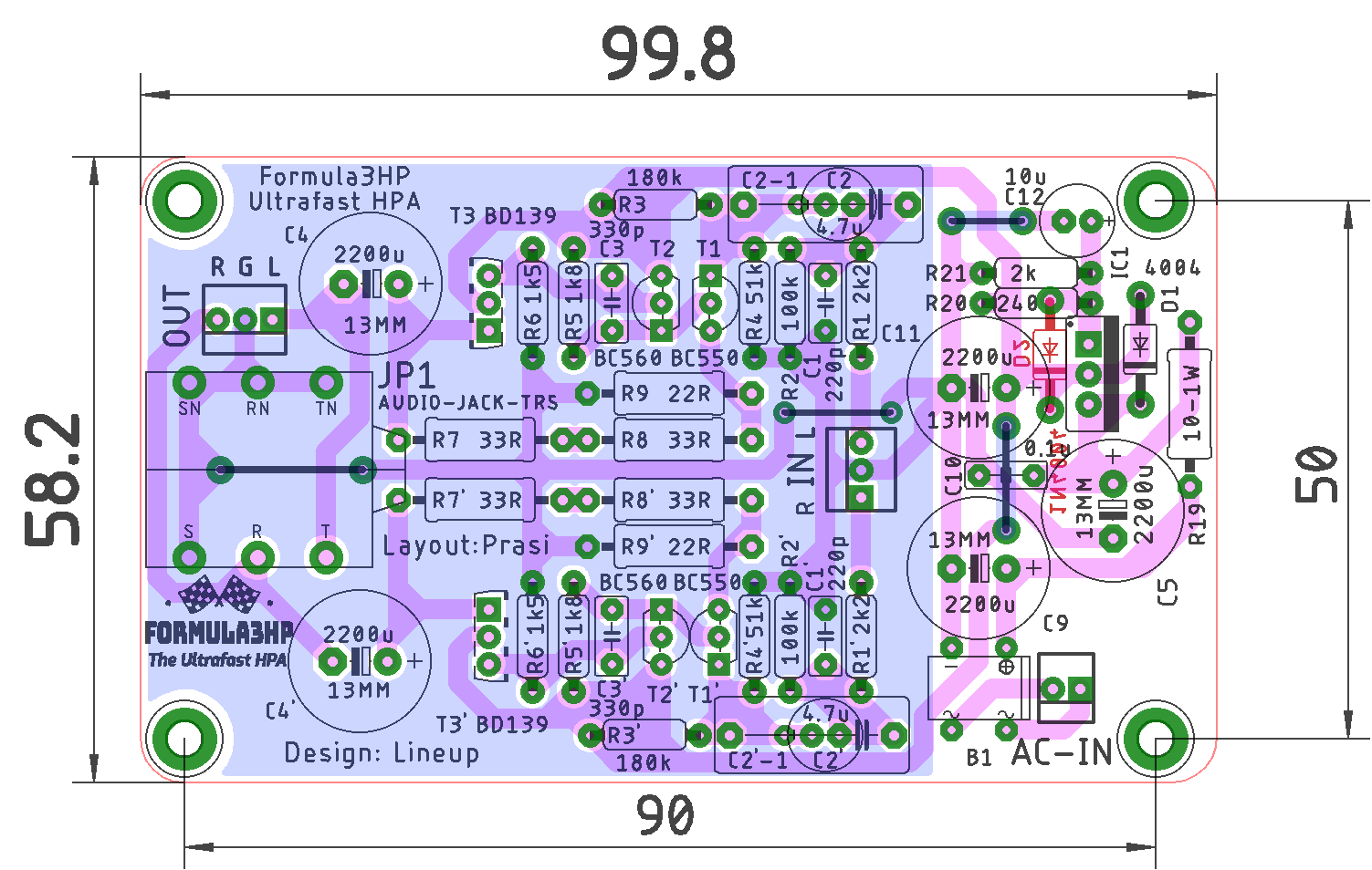

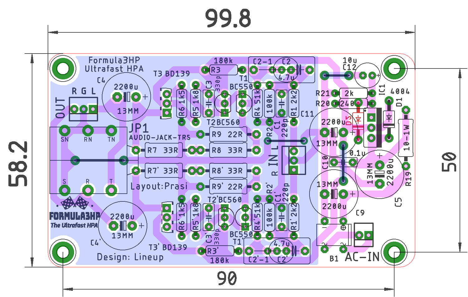

Here are gerbers and pdf files. Untested but should work very well.

Hi Prasi.
I notice your BC550/560 transistors appear to be laid out as BCE, whereas mine were from OnSemi (Fairchild) and are CBE on the datasheet.
Are you using a particular brand with BCE leg configuration?

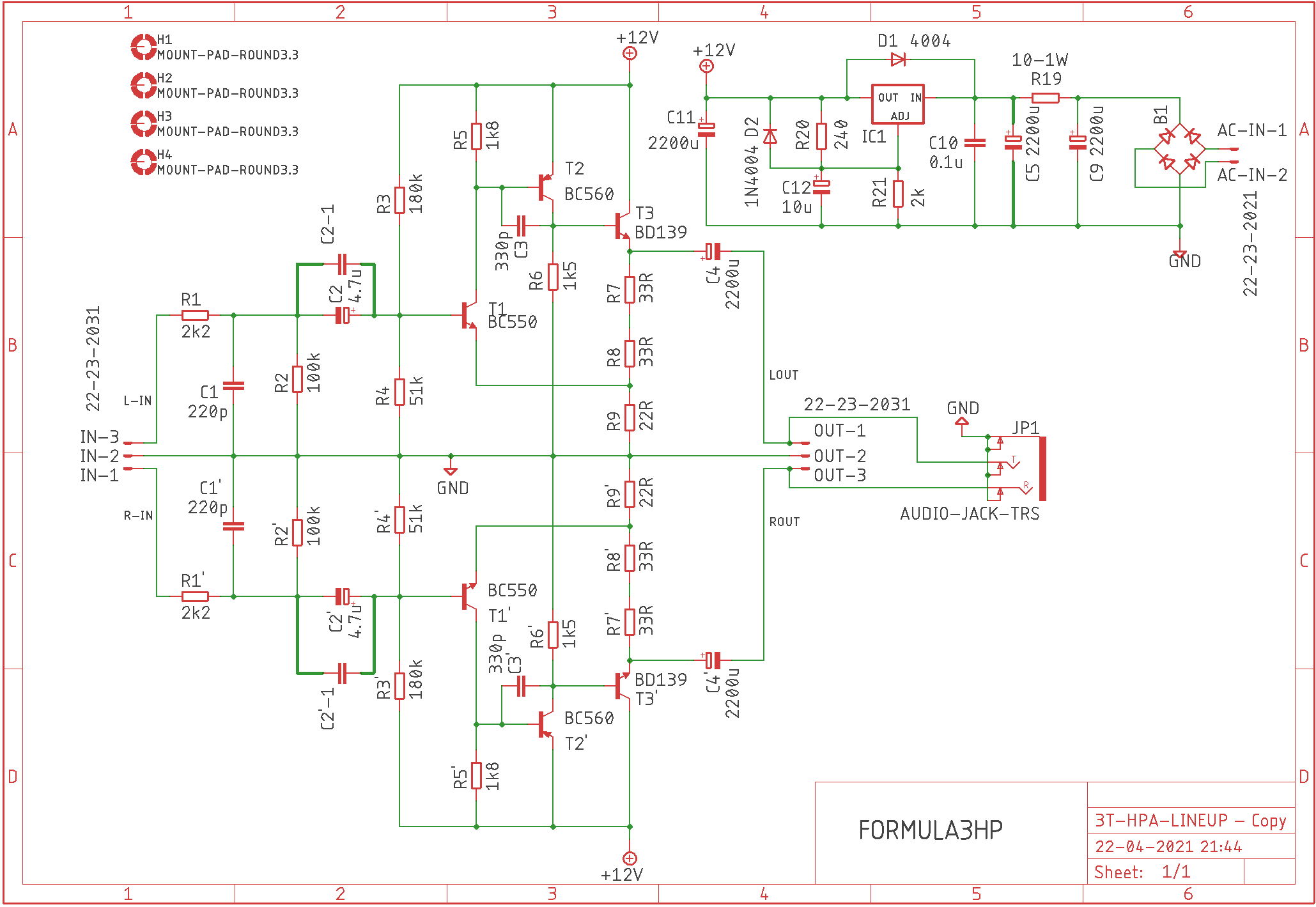

OMG😱
You saved me from a major fiasco. Thanks avtech🙂
I request moderators to delete post #150.
here are correct files.

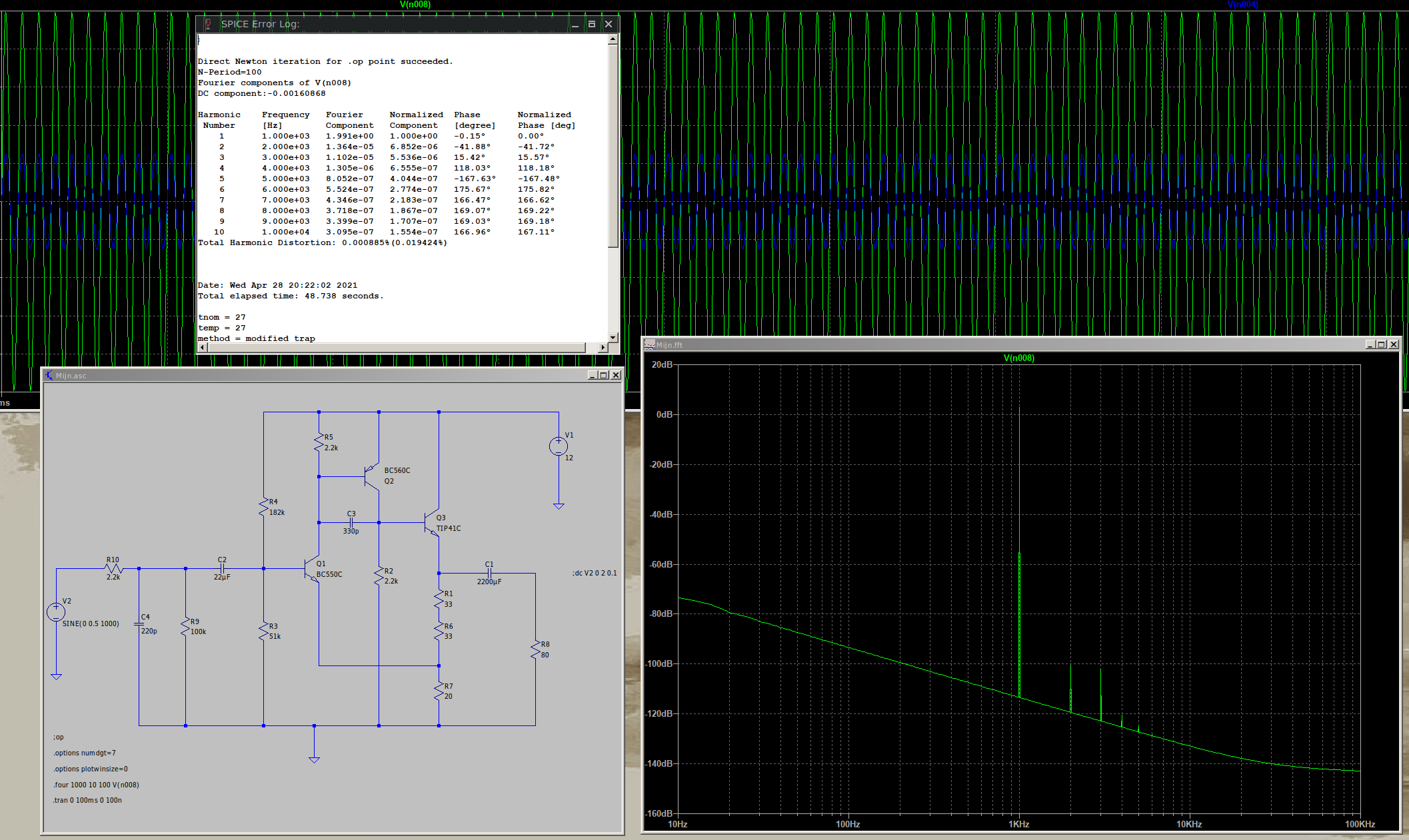

I changed the values according to the components that I have laying around. And experimented a bit with LTSpice.
How does it look? Please be gentle, I do not have much expericience with LTSpice.
B.t.w. the circuit seems to be pretty tolerant of value changes.

Thank you prasi! Is this free for any one to use? I am thinking of placing an order from some online PCB maker.
hello hanair,
yes those are free , anyone can use for their personal build.
I would suggest JLCPCB because they are cheap and with low shipping costs

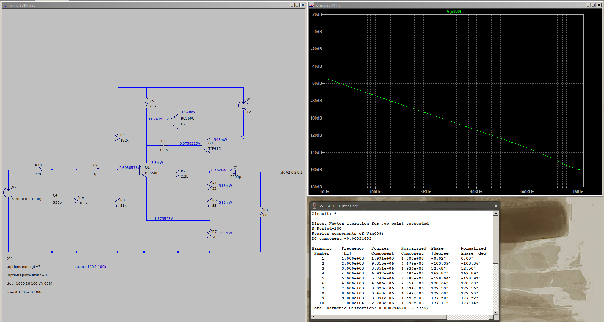

Looks to operate ok, but make sure you check the current values of each transistor to make sure they are within spec.
If you give the mouse over a transistor, it should show you the value in the bottom corner of the screen. You can also right click on wires and add datapoints that show voltages of the node. These can also be edited to show current or power instead.
Yeah, post your results.If interested I can post the results.
