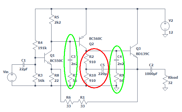

Very nice amp, @lineup! Congratulations!
Two easy ways of bringing the distortion further down:
Red - bootstrap the load of the 2nd BJT.
Green - replace the Miller capacitor around the 2nd BJT with a different compensation (trim the resistors in the two RC networks for best square wave response).

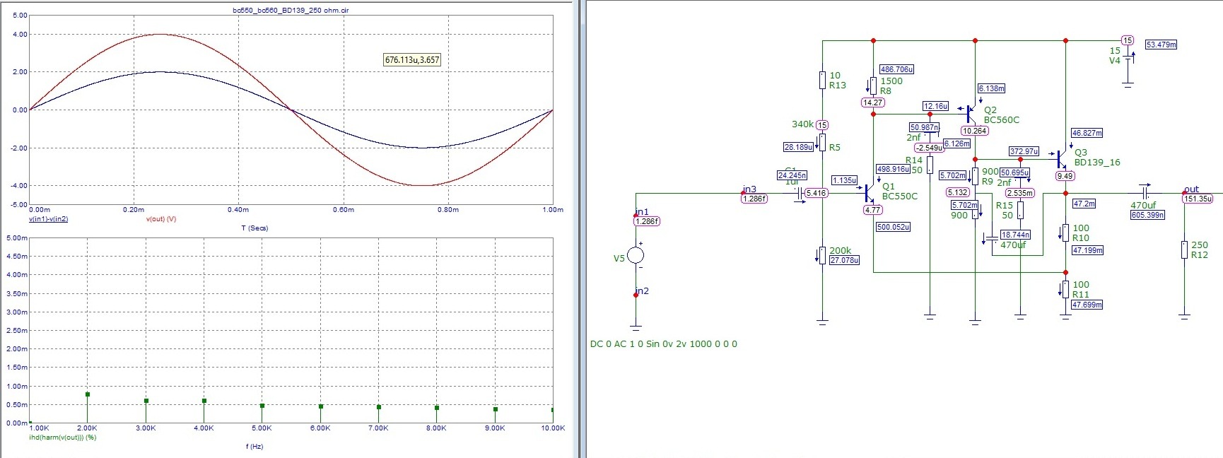

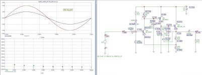

Here we go.
The result is quite alright. Distortion is only 0.002%. This is a very clean sound.
LM7815 is good enough and easier to use than LM317.
Transformer should be a small 15VAC. Because the circuit does not draw much current.
Adjustment is to set the output of BD139 at 9.00 Volt. As seen in the schematic.
All resistors are 0.6Watt. This is because of the fairy low current in output.
I will be waiting for some pictures of your amplifier when is done.

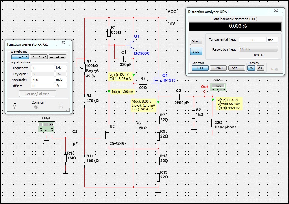

At first I made an amplifier with BD139 as output device.
But then I made this amp with IRF510 as output.

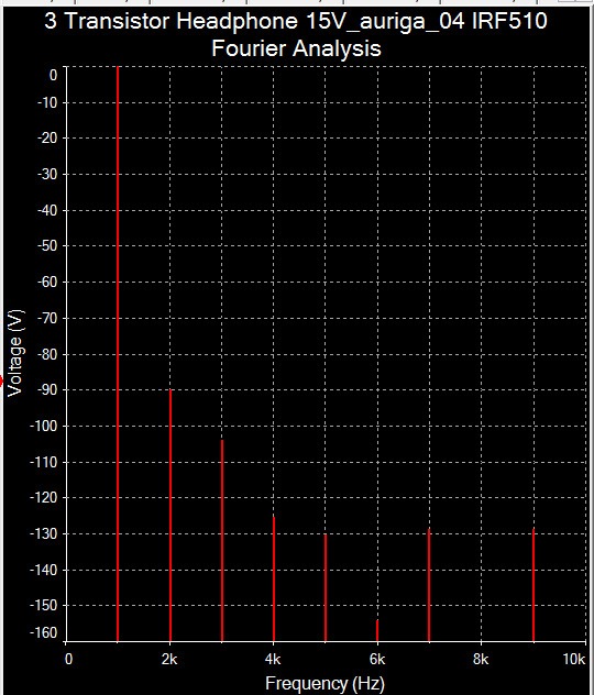

This circuit has a tiny bit more distortion, but the distortion is mainly 2nd harmonic. See image.
Which make me think this circuit will 'sing' better.
You should adjust with the potentiometer to get 8.00V at the output.
If this is not possible you may need to change R4.
There are four resistors in output. All 22 Ohm.
They all can be 1/2Watt or 0.6Watt.
I have used BC560C for U1. But this can be any PNP Small Signal transistor. For example 2N5401 or other.
