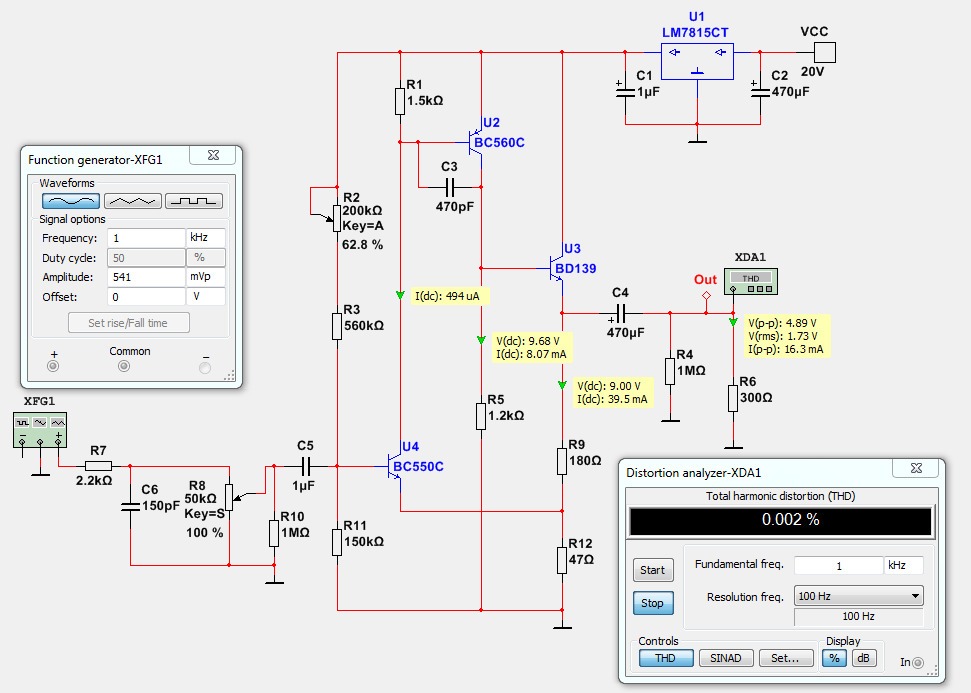

3 Transistor HP Amplifier with low dist
Here we go.
The result is quite alright. Distortion is only 0.002%. This is a very clean sound.
LM7815 is good enough and easier to use than LM317.
Transformer should be a small 15VAC. Because the circuit does not draw much current.
Adjustment is to set the output of BD139 at 9.00 Volt. As seen in the schematic.
All resistors are 0.6Watt. This is because of the fairy low current in output.
I will be waiting for some pictures of your amplifier when is done.
The 7815 source will over impose it's mediocre sonic signature and noise over the class A amp and all will be for nothing with dynamic signal.
That 1 uF capacitor on it's output will not help a lot with dynamic program like music. But sure, will measure perfectly with a static amplitude sin wave.
A plain rectification stage, plus heavy filtration, would be cleaner IMHO.

Soooo mine is up and running too.... But havin a hum, coming from the Salas L-Adapter..... Think it´s my fault, since the L adapter is controlled via a ardiuno, whose PSU is a Meanwell IRM-10-5, sitting next to the toroid.....
The sound is fantastic 😀
Ok was not the PSU.... Was the onboard sound card... Since I use the Sharkoon Gaming Dac Pro it is dead silent....
If it is a ground loop, then you should be working with the ground connections.
Hard to say without knowwing how your gear is. 🙂
The rule is that you should not have several GND connections to any point.
Star ground is a way to acheive this.
