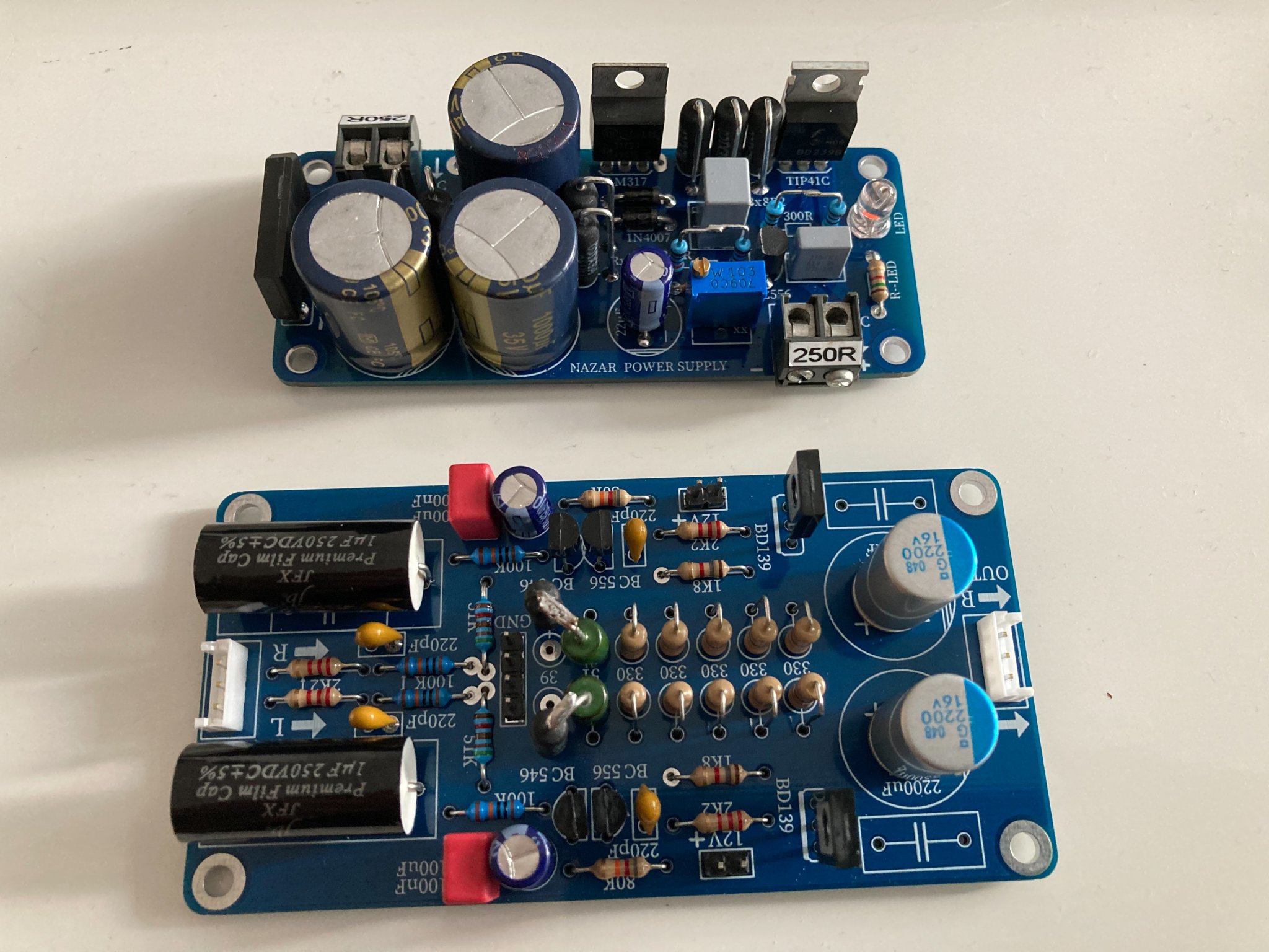

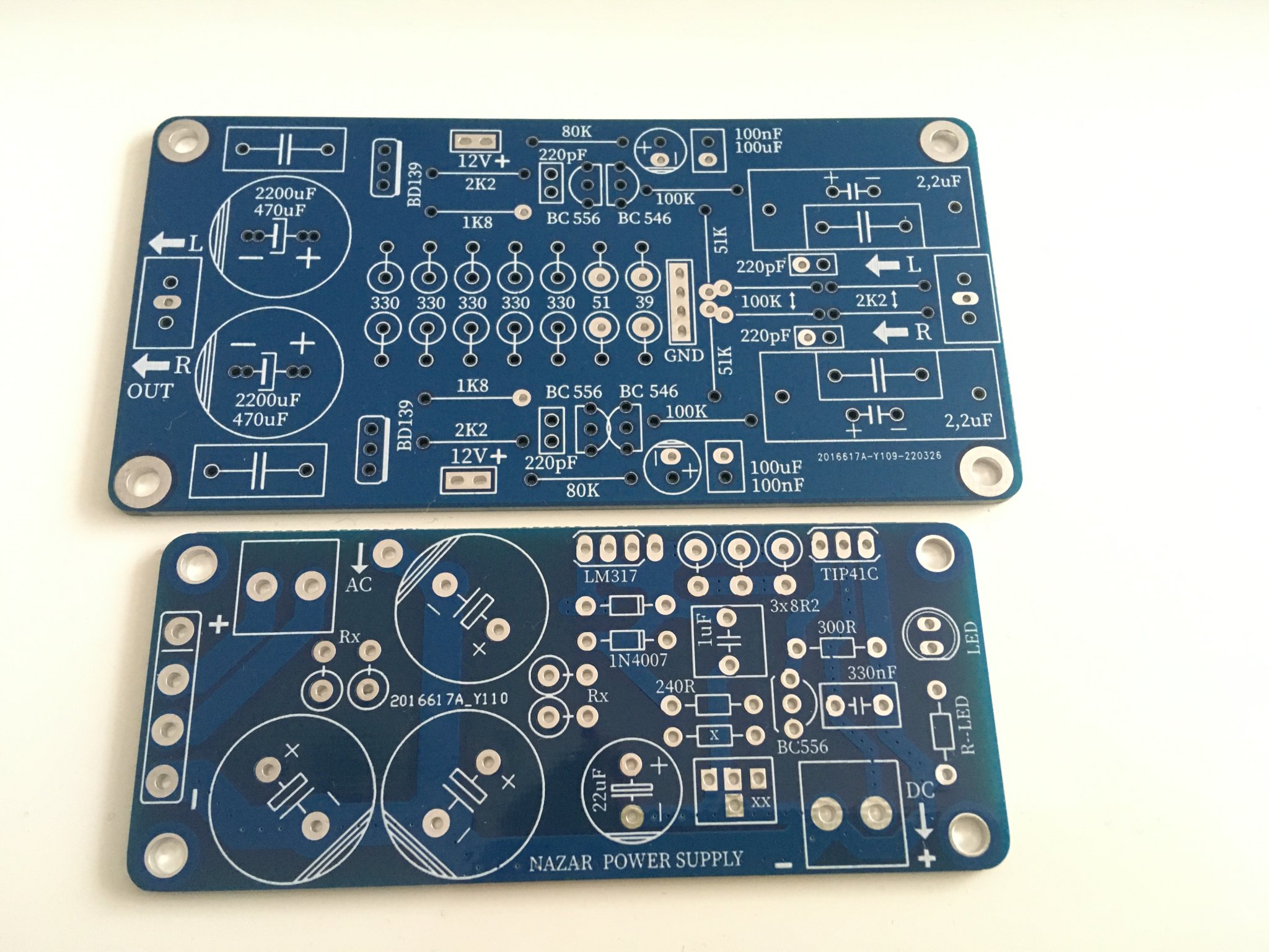

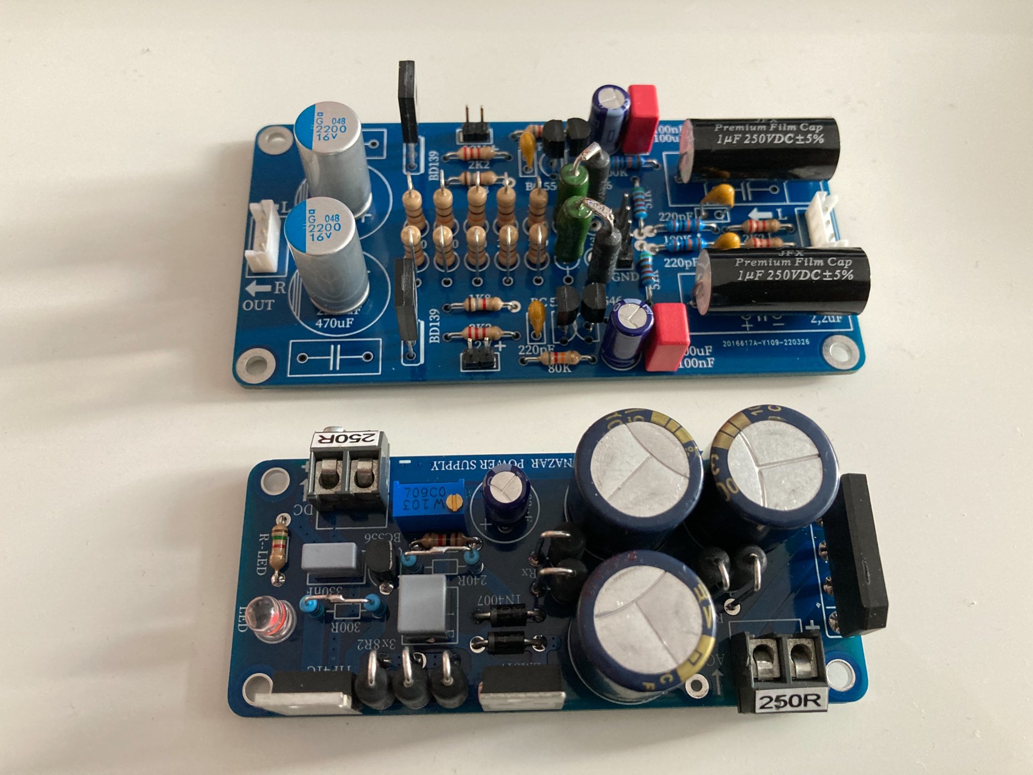

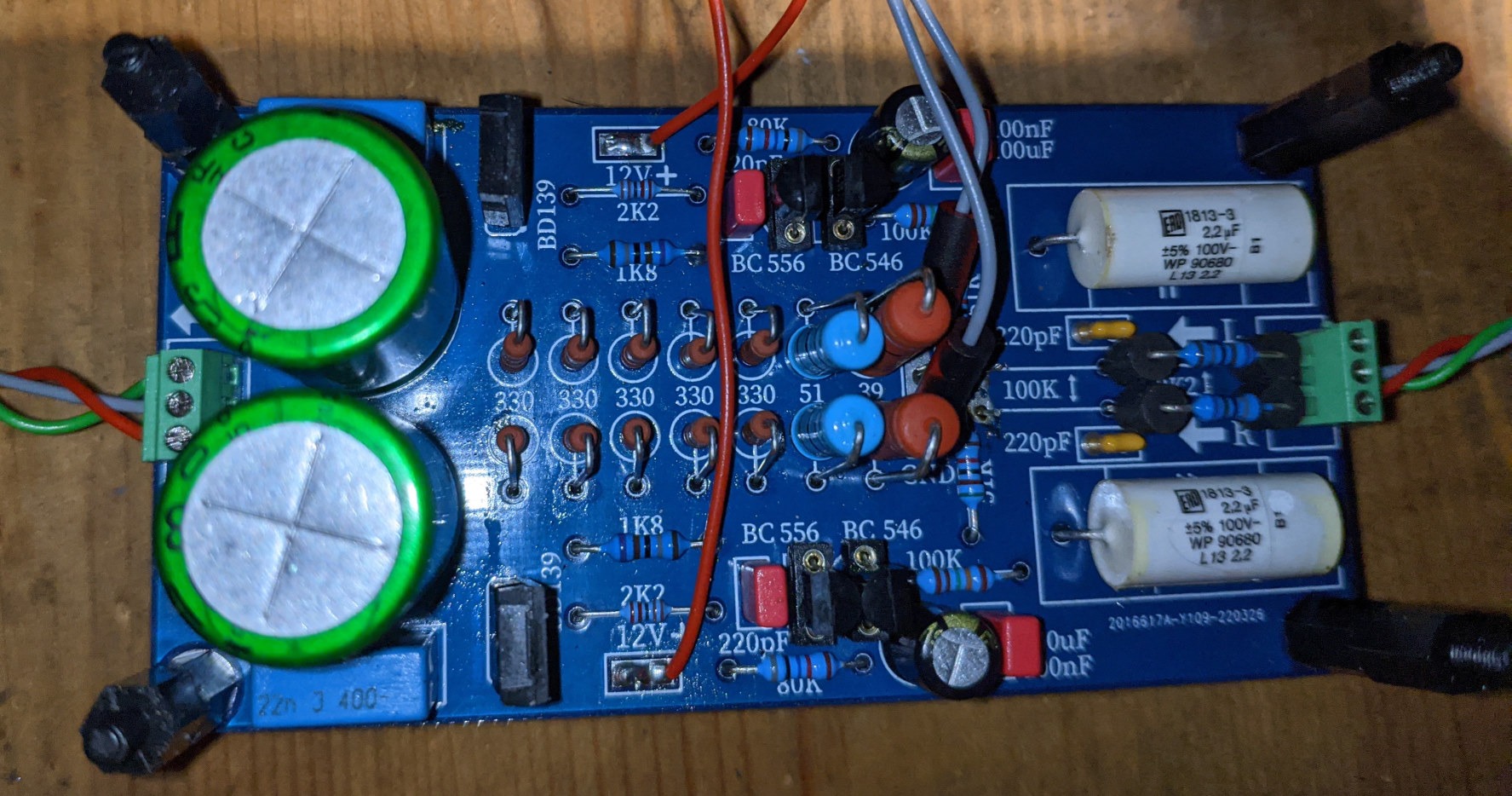

I finished assembling the components. Everything works very well. Thanks knauf1919 for pcb and lineup for sharing the project.
In the near future I will make a case worthy of this amplifier.

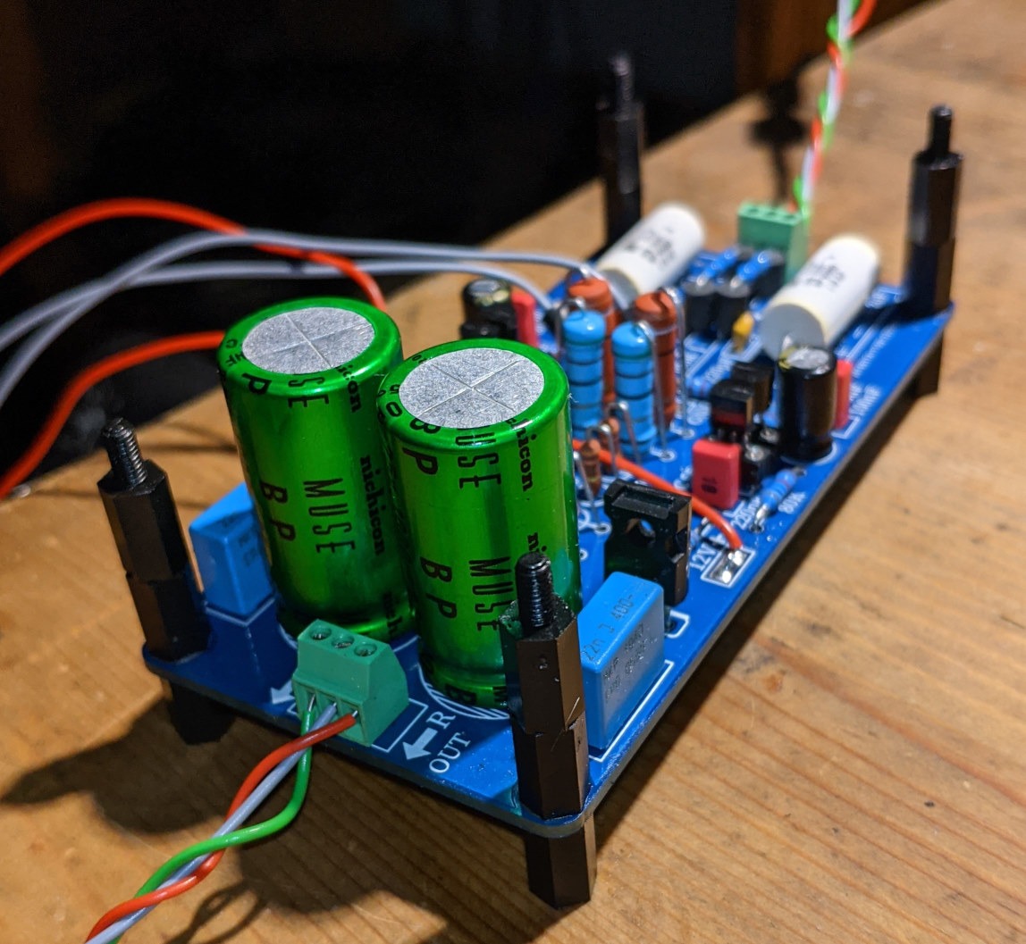

The best headphone amplifier. Glory to the one who designed it.

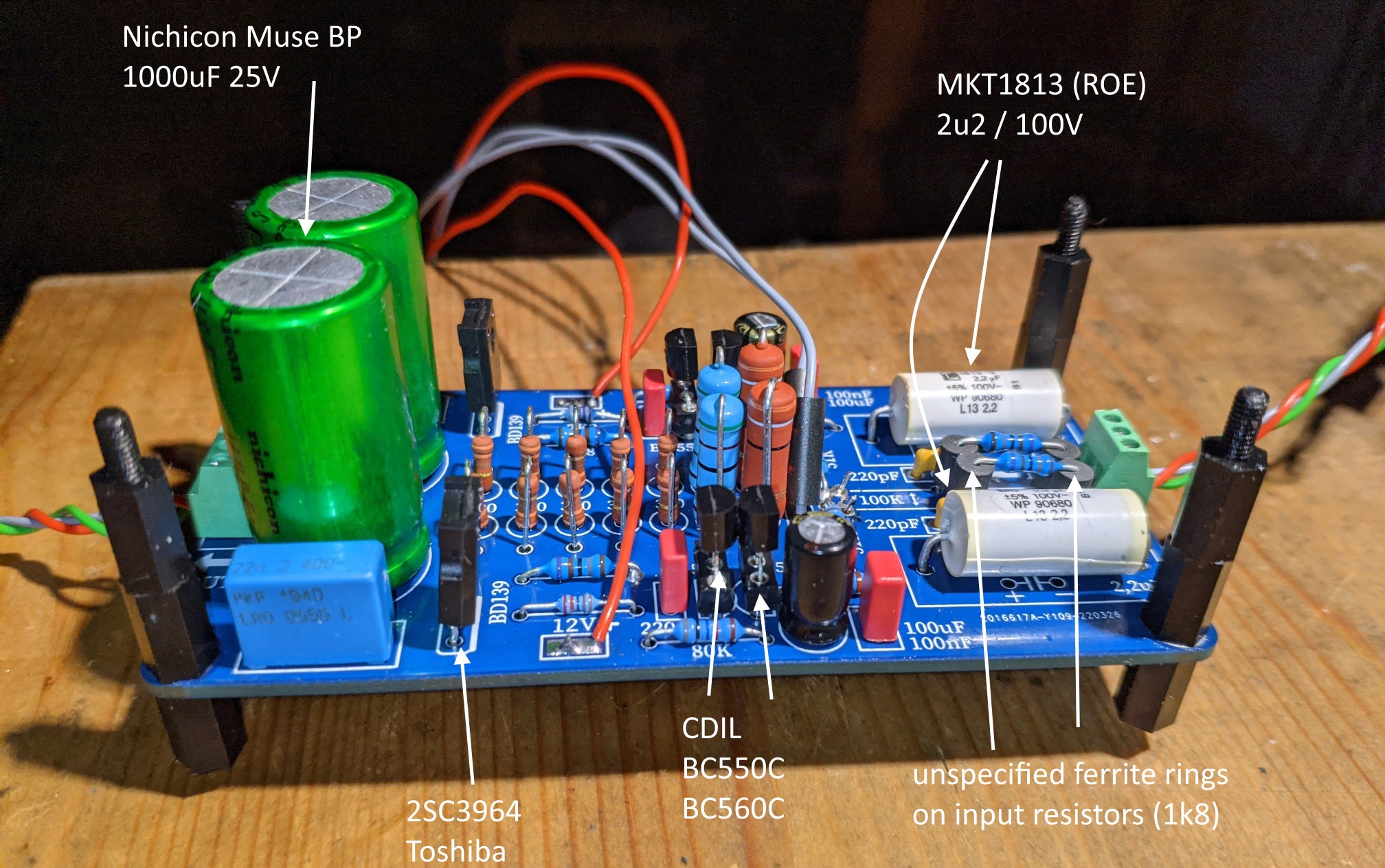

Love it. Thank you lineup and Knauf1919!
Edit: yes, BP output caps not needed... I had them laying around, not fitting any other application I have.

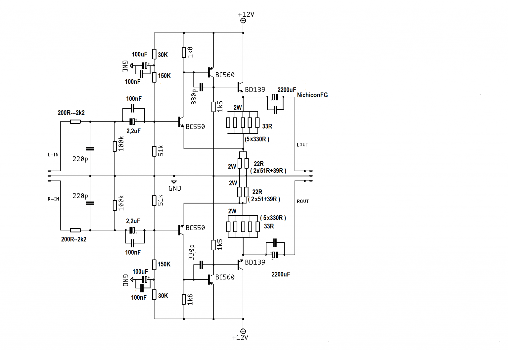

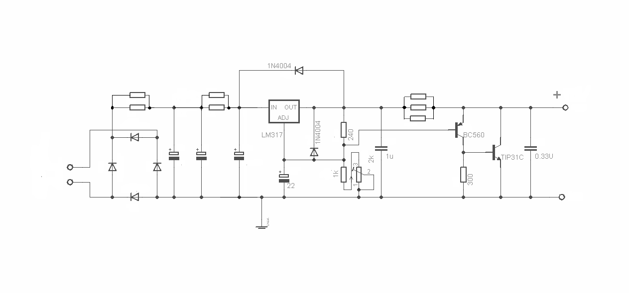

Which circuit did you use finally? Could you please post the final schematics of the BJT version including the regulator section? I want to build it!
a couple of questions. . .
With the 5v version, is there enough headroom for 5x gain, if line level output? If not, the 12v is fine.
Is there a preamp schematic available, perhaps with a TO92, such as BC337 or 2n2222, instead of the BD139?
Hi Marin Cornel! I look forward to seeing your DIY case!In the near future I will make a case worthy of this amplifier.

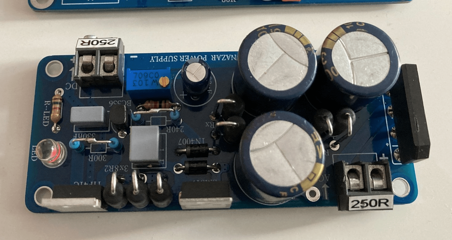

May I ask why you have labeled your input and output terminals on PS board as "250R"?
Cheers!
Hello,Hi Marin Cornel! I look forward to seeing your DIY case!
Cheers!
This is how they were marked with 250R. I don't know where I got them from. It certainly meant something in the set-up for which they were intended. I didn't remove that mark.
Hey Lineup, what is the point of C6? Removing it doesn't seem to do anything in the sim...This is a new, revised Version.
It has slightly better data and shows also LM317T for the 12V supply.
I think it should work with 32 Ohm and 250 Ohm, too.
Probably needs a change for 300 and 600 Ohms headphones.
See this postI know I am rather late to the party but I would like to suggest a small improvement to this design. As it stands, its PSRR is quite poor simply because the first stage is biased directly from the supply. Any noise on the supply is fed straight to the input and care is needed with the PCB layout to ensure output stage signal currents do not induce voltages onto the supply feeding the bias resistors.
To fix this I would suggest using a decoupled potential divider for generating the required bias voltage and then feeding this to the base of the first transistor via a suitable value resistor.
Cheers
ian
Can I have recommended version for 20k load and for 50k load, either with 6x gain and 12vdc supply?Here is the recommended version for 250ohm - 300ohm - 600ohm. . .
Oh man, I've ever so much need of that!
I have so much amplifier projects that can't match up phone/pc/tablet commonplace sources, and therefore 3 transistor singleton-input single-rail preamplifier is hot on my wish list.
The other alternative is buy a better source, build another amplifier, repeat; but, unfortunately, that typical method doesn't result in fully-practical music outcome.
