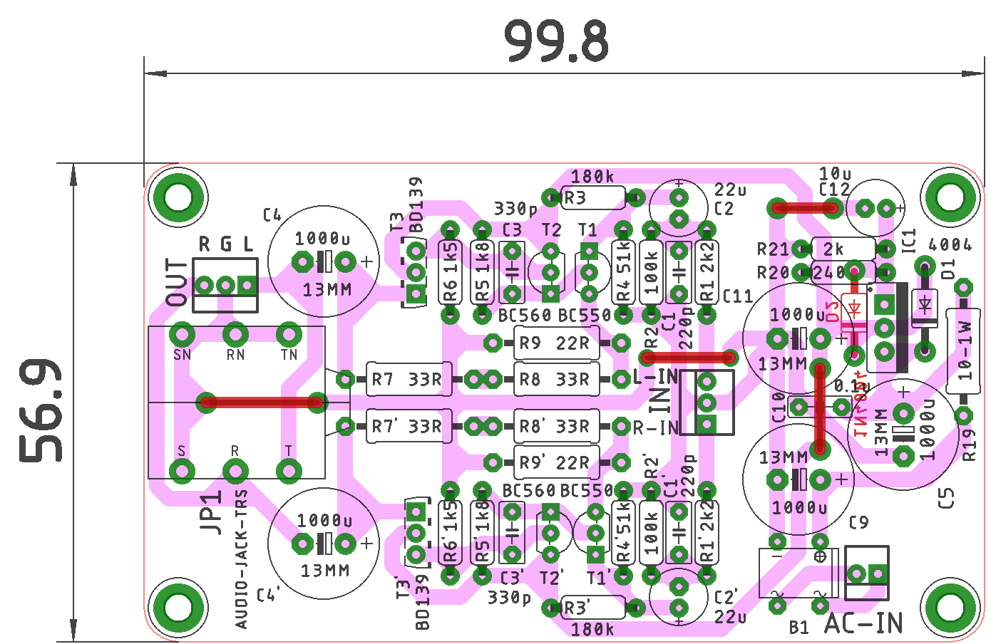

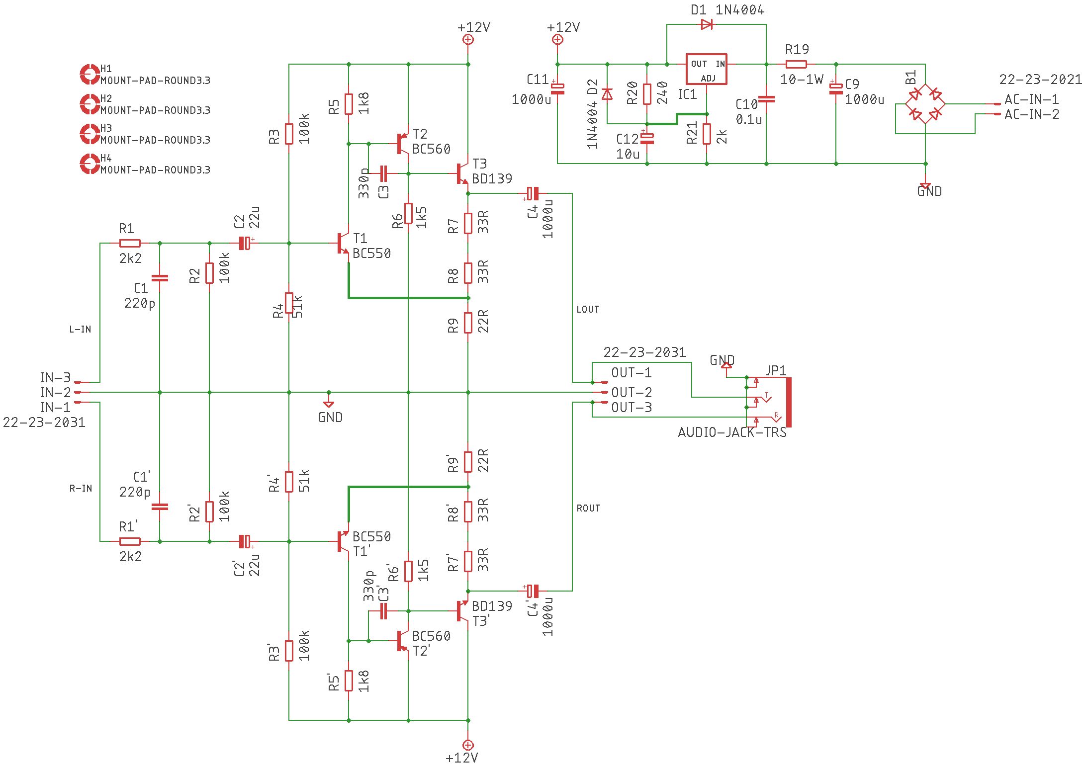

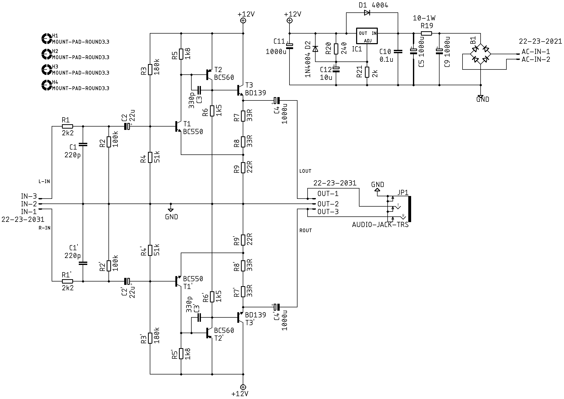

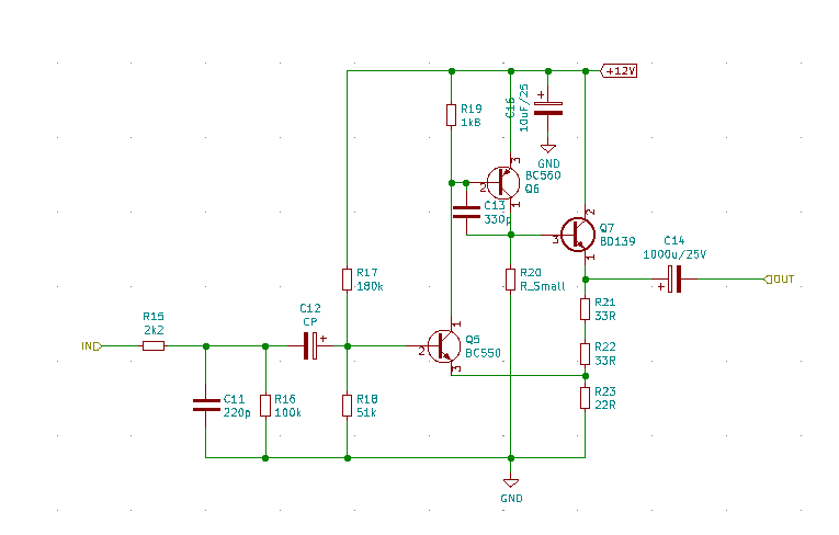

That´s an LM317 or similar you´re using, right?
Did you forget the wire from between R20&C12 to the ADJ-pin?
Thanks for your beautiful layouts BTW.
They are a joy to study and look at!
Yes, eagle eyes you have...
Thanks BTW...
@prasi
Beautiful schematic.
It also have the correct components as recommended.
But R3 should be 180k
Great to see this made into one of your PCBs Prasi. And interesting to see an AC input rather than DC-DC regulation. I'd be interested to see if it makes a difference using linear power rather than an SMPS.

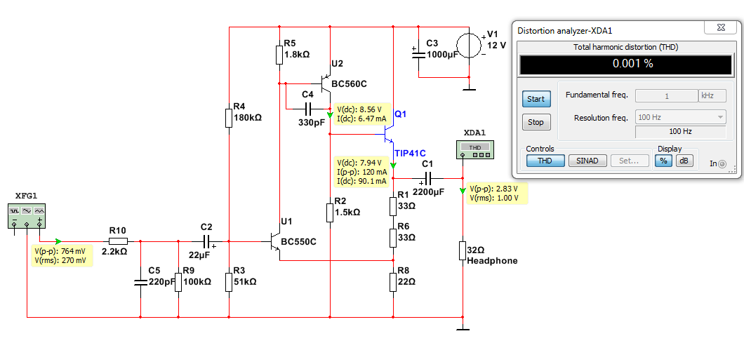

I have a few TIP41C transistors left, a bit too much power but can they replace the BD139 ones if needed?
I think you can use TIP41C.
It will give a little more distortion.
But as there is a feedback the different will not be dramatical.

Thanks Lineup!I think you can use TIP41C.
I did a testrun simulation with TIP41C.
The result is just the same as BD139 = THD 0.001%
See image.
So there is not at all problem using TIP41C.

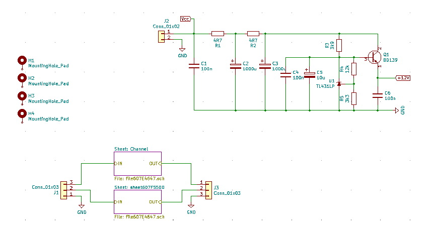

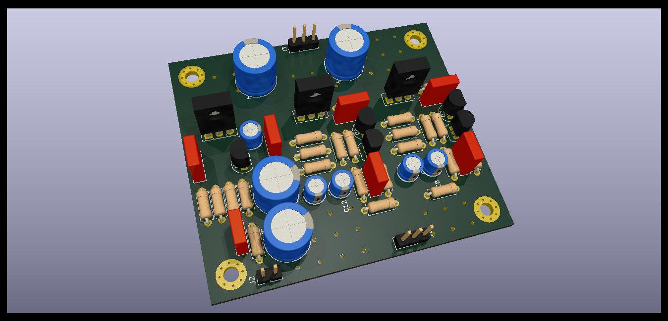

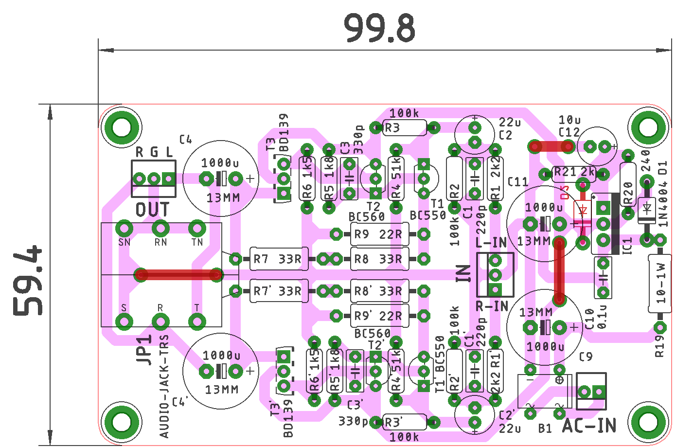

Made a little sunday afternoon layout.
2-layers with brute-force GND on both layers.
RC-filters and TL431+pass transistor cause its just another BD139. (the TL431-circuit is from FauxFrench!)
Probably find me a tiny aluminium stripe and attach the transistors to it. (attach insulated!)
If anybody in germany wants some PCBs we could share. I probably only need 2 PCBs.

My simulation files have the suffix 3QA (3 Transistors, Class A).
Or maybe R9Q3 (9 resistors, 3 Transistors).
I´ll call mine R9Q3-LUFFJD (short for: schematic: lineup, PSU: FauxFrench, Layout: Jens D.).
If anybody wants to use the gerber files: I want to update them later.
There was too big an interruption in the bottom layer ground plane that I got rid of and placed more vias.

The TL431-circuit was suggested by FauxFrench in our amplifier project.Thanks for sharing the a version the FauxFrench's circuit. I think I'll give that one a go too!
We needed a ~+-15V supply for one opamp (from +-42V) and that is what FauxFrench came up with:
TL431 and pass-transistor for negative voltages.
