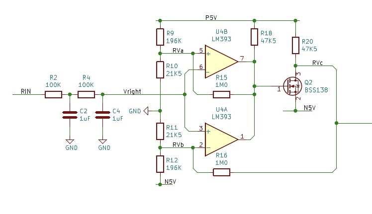

Given the DC protection for headphones ... What is the dangerous value?
Opinions are divided ...
THX.
On headphone SSR DC protections that I have built in the past, I use 500mV lasting longer than about 100mS as the trigger point. I think most headphones can handle 1V DC just fine for a few seconds without damage so 500mV for sub 10Hz wave seemed to be good. It’s adjustable to taste and application of course.
Here is the comparator circuit we used to detect DC offset error:

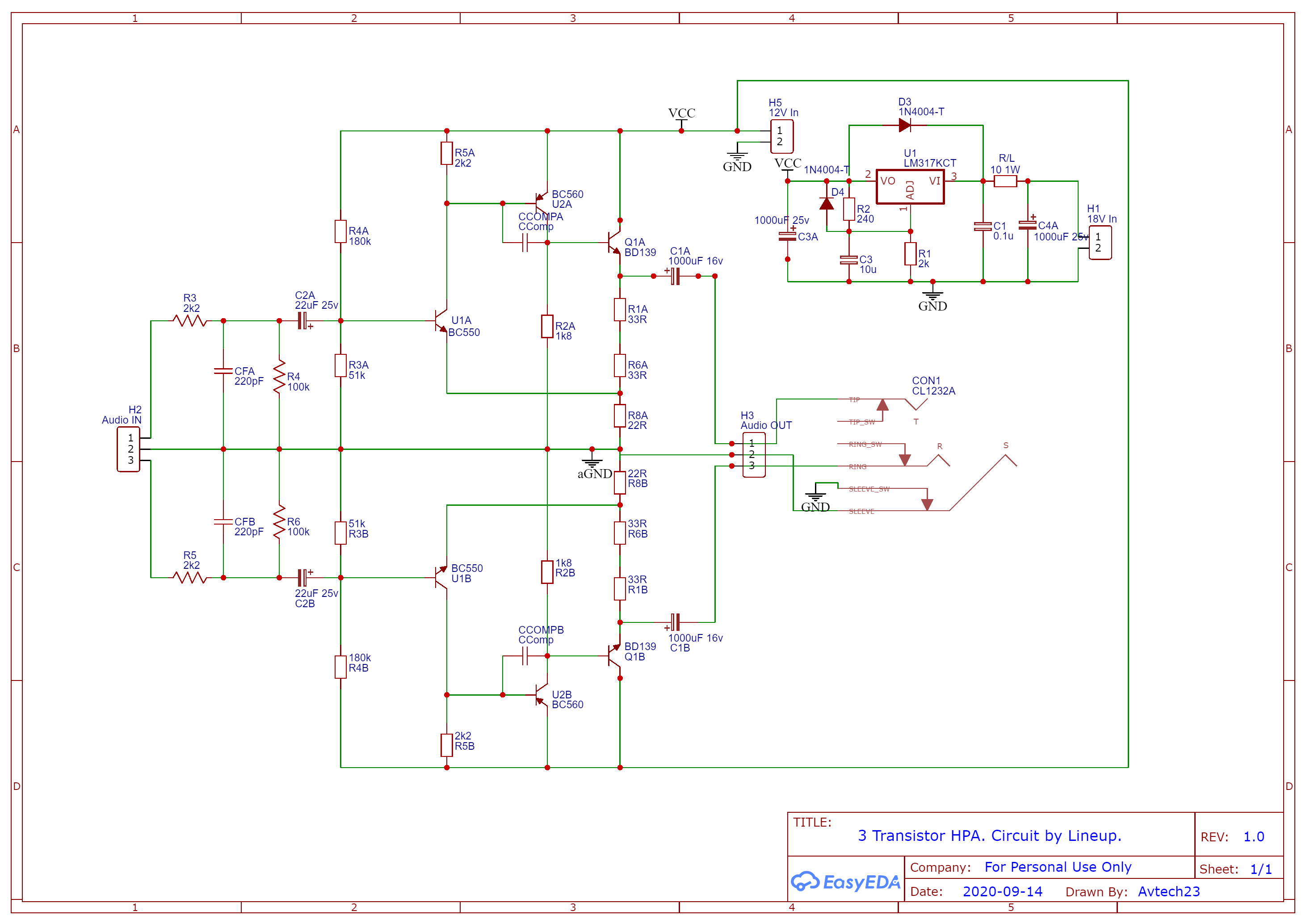

Hi, regarding the amp in the original/first post, does it provide enough gain? Is it possible to connect it directly (without pre-amp) to the DAC output (e.g. https://www.amazon.com/gp/product/B07KN6P9QB) and have enough power? Thanks!
Plenty of gain for me to use a SA9227+PCM5102A DAC or even straight from mobile phone.
The DAC is usually set about 9% volume for comfortable listening levels with 38 ohm headphones, so if anything, the gain could probably be reduced.
The final version that I am using is this one and it sounds very good to me:
attachment.php
Thanks for the circuit Lineup. It was good to play around with it and make a board with your circuit.
I've been using mine for a while now and feel that it outperforms my Hakuin and O2 amps when used with the ATH-M50X. Plenty of power to drive pretty much anything.
The LM317 has proven to be a good match and doesn't seem to induce noise into the amp. I swapped in an LDO, but the measurements and listening did not change.
Good Stuff :up:

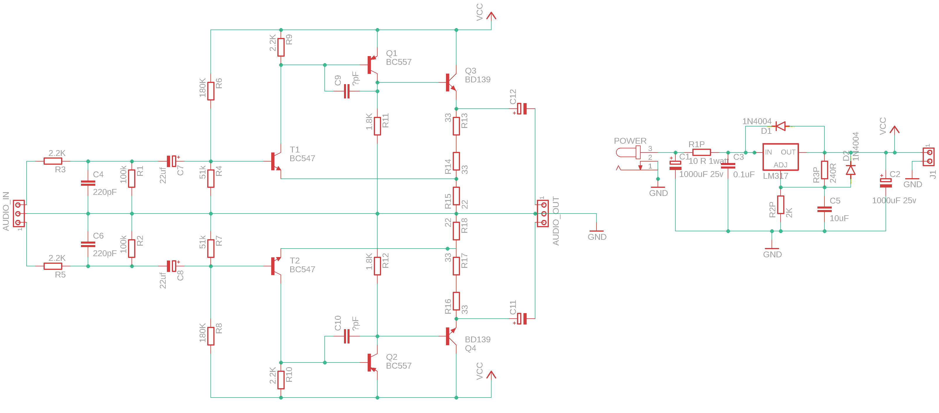

I found BC547 and BC557. Are they good alternative ?
also have drawn schematic according to the schematic posted by avtech23
I am a bit confused about the signal ground and power ground. Is there suppose to be star ground ?
is the schematic correct ? as i have not started to make the pcb layout yet.
The schematic in post #67 is the one that I have been using successfully.
I split the audio GND and the power supply GND and physically connected them at the DC barrel connector. I think it doesn't really make much difference to something that only draws 200mA (I don't expect there would be huge charging pulses to deal with like a power amp, but I may be wrong). I achieved a very low noise amp in the end, so it didn't hurt anything to do it this way.
I tamed oscillations with a minimum 220pF at your C9/C10. I think I went up to around 330pF.
The LM317 is set up for 12v output, but this requires the very minimum of 4v difference between in and out (i.e. 16V in). I powered it with an 18V PSU to ensure a decent margin, but this would work with a 19v laptop charger quite nicely too.

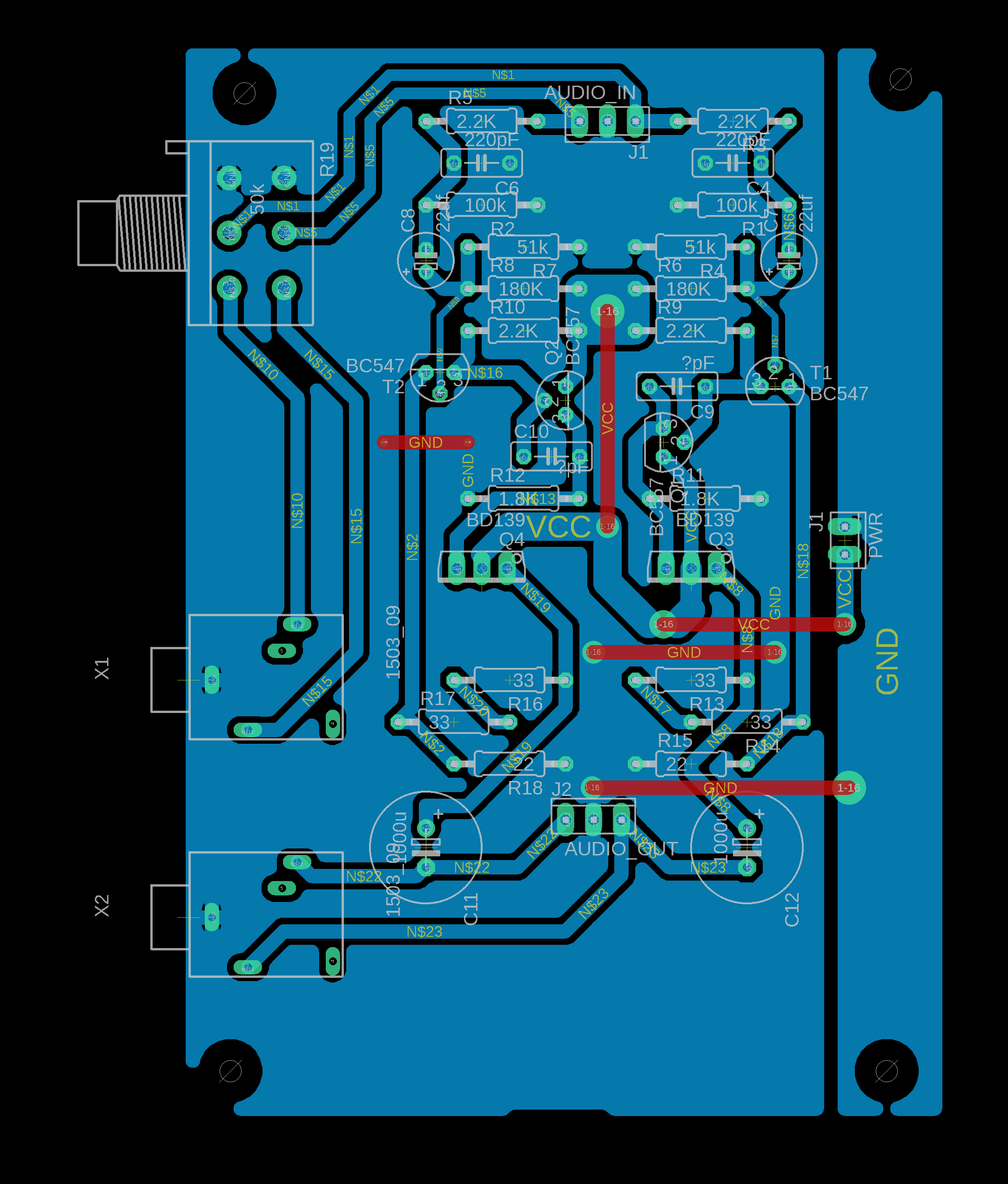

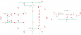

So came up with this PCB layout.
Its single layer with jumpers on top layer / red lines.
Any suggestions improvements would be highly appreciated as I will be using toner transfer method to make PCB.
initially had the power supply on the same pcb but i decided it should be on separate pcb so i can re-use.
the PCB size is 100mm x 70mm.
Also will 1/4 watt resistors do ? or do i need 1watt ones.
When you avtech23 say the circuit outperform other amplifiers, I am not very surprised.
The benefit of this circuit is mainly the short distance from input to output.
For example opamps have a very long way from in to out.
There are many components inside the opamp that the signal must pass.
