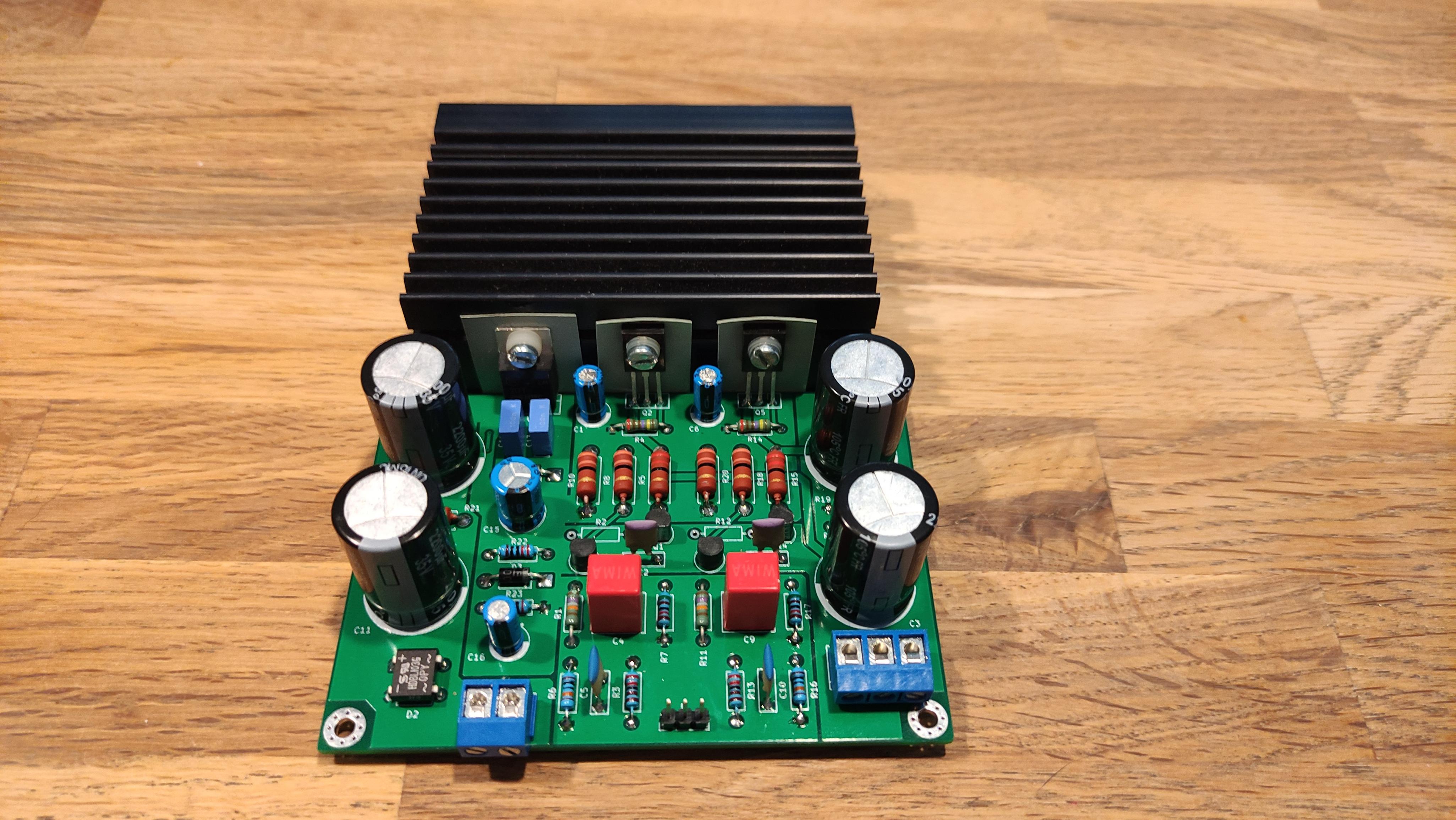

Boards have arrived and are looking great 🙂
Next week I can get the rest of the components.
Almost ready for testing 🙂
Decent heatsink there and looks pretty good. See how you go with the power resistors against the PCB with regard to heat. I spaced mine off the board to keep the PCB temp down.
These are 3W resistors. We will see. If needed I will place them higher. I think we still have some old stock of ceramic spacers for this purpose at work. Would be a nice touch.
Ceramic spacers would look good!
3w shouldn't generate too much heat but let us all know how you get on 🙂

So the board is up and running, works perfectly 🙂
Resistors are not getting that hot by the way. I can easily touch them for 10 seconds.
