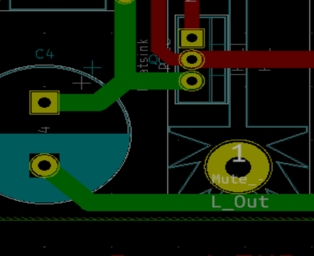

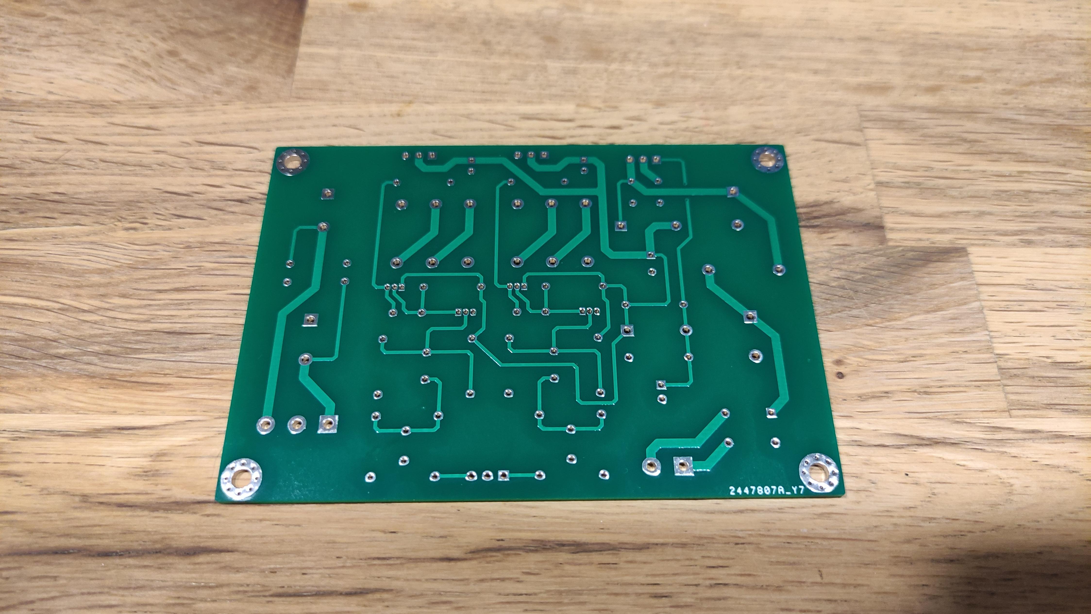

Did a V1.1 of my PCB. Suggestions and criticisms always welcome 🙂
L_out trace is running too close to the heatsink mounting stud.

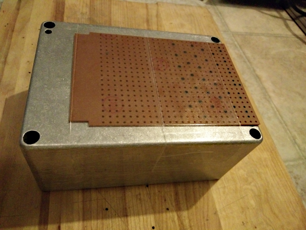

What SW is that? Looks nice for perfboard layouting. (I use Lochmaster which is OK too)

Ah dammit, hopefully it'll be fine since it's on the underside. Will fix for next revision.L_out trace is running too close to the heatsink mounting stud.
It is not a special perfboard software. I use Easy-Eda.

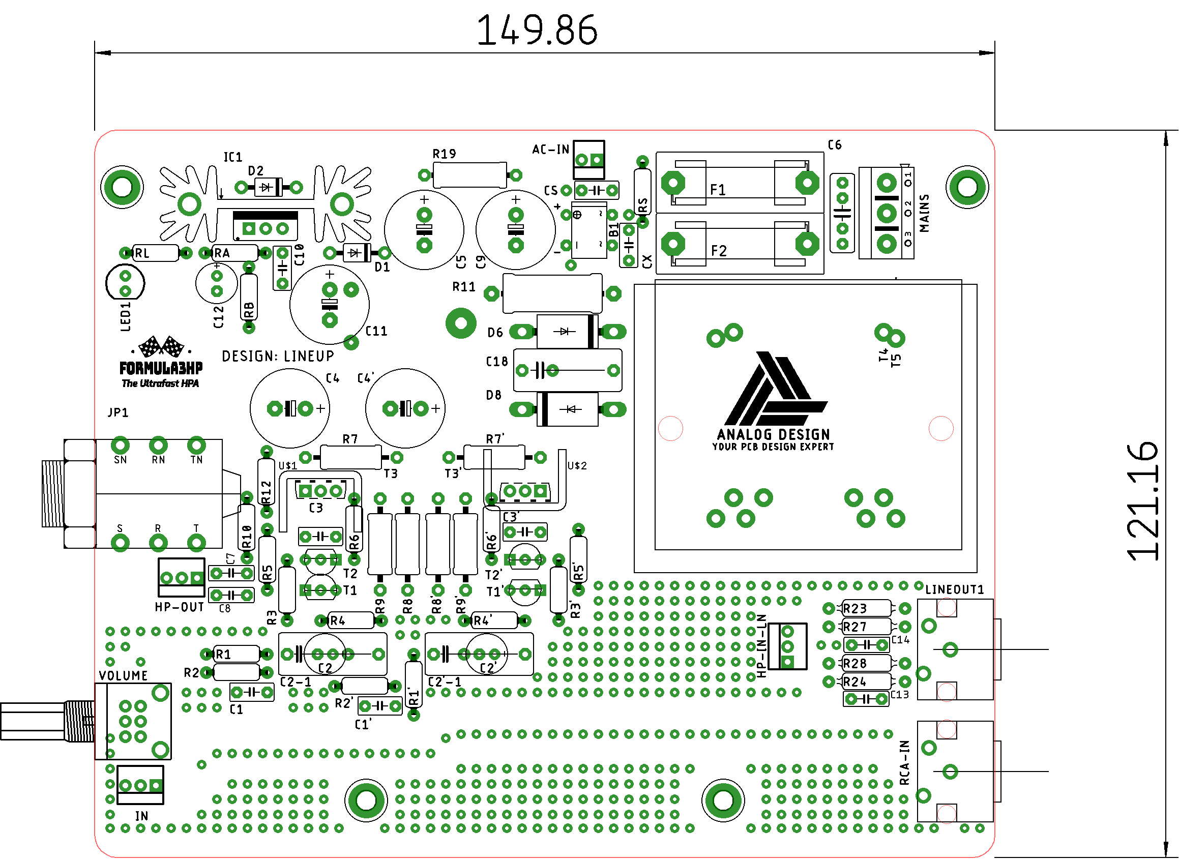

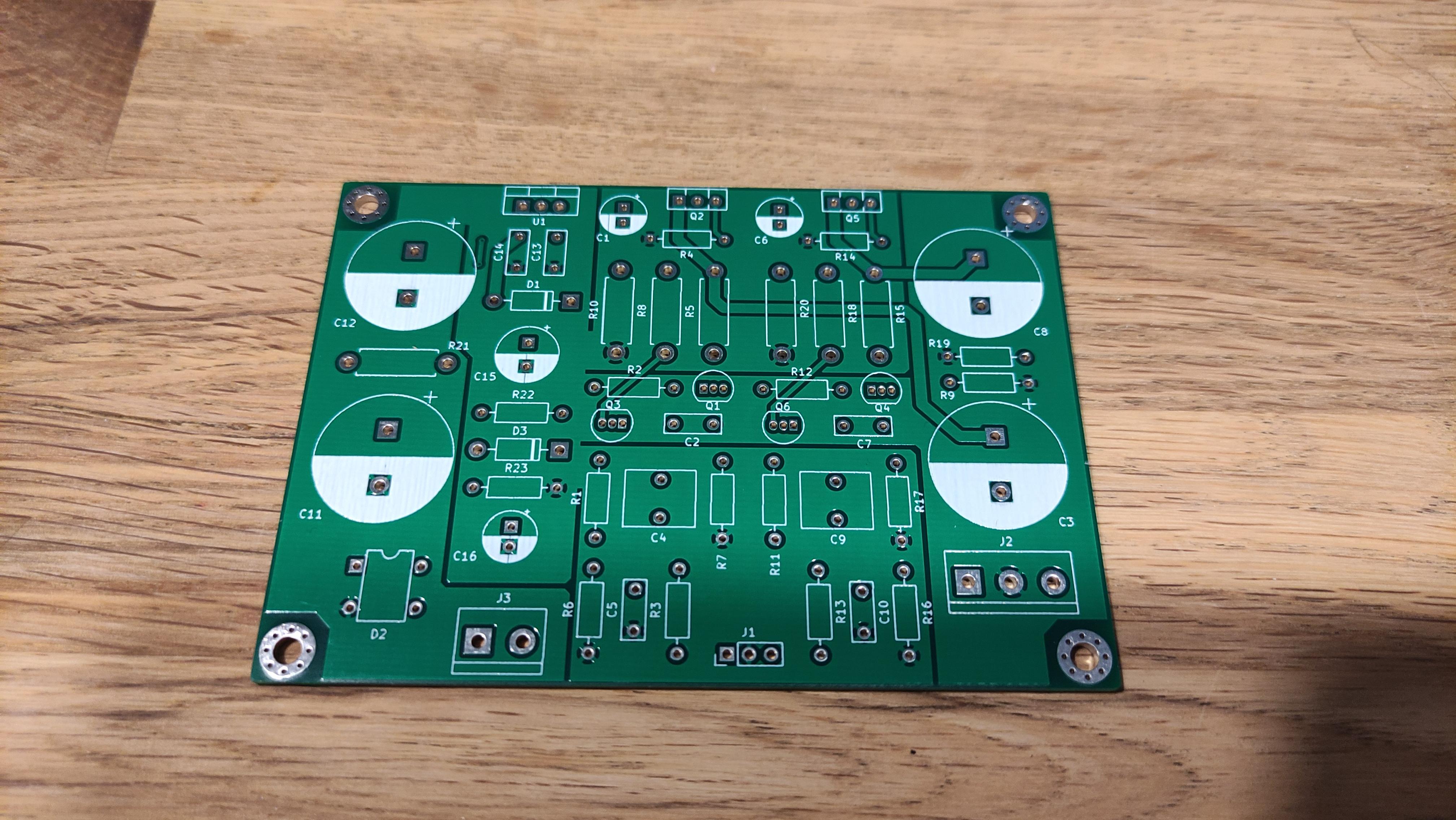

Made a new layout (100mmx70mm) With onboard power supply (CRC and LM317)

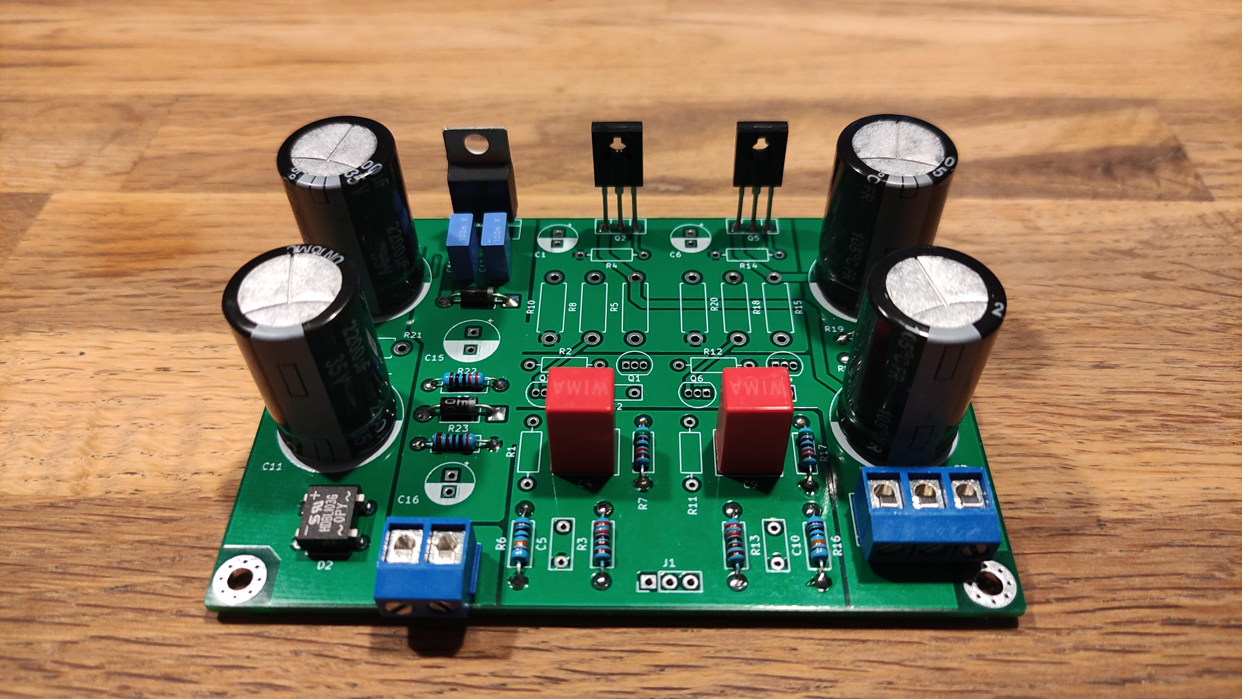

Boards have arrived and are looking great 🙂
Next week I can get the rest of the components.

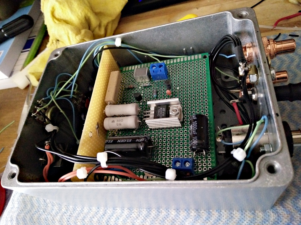

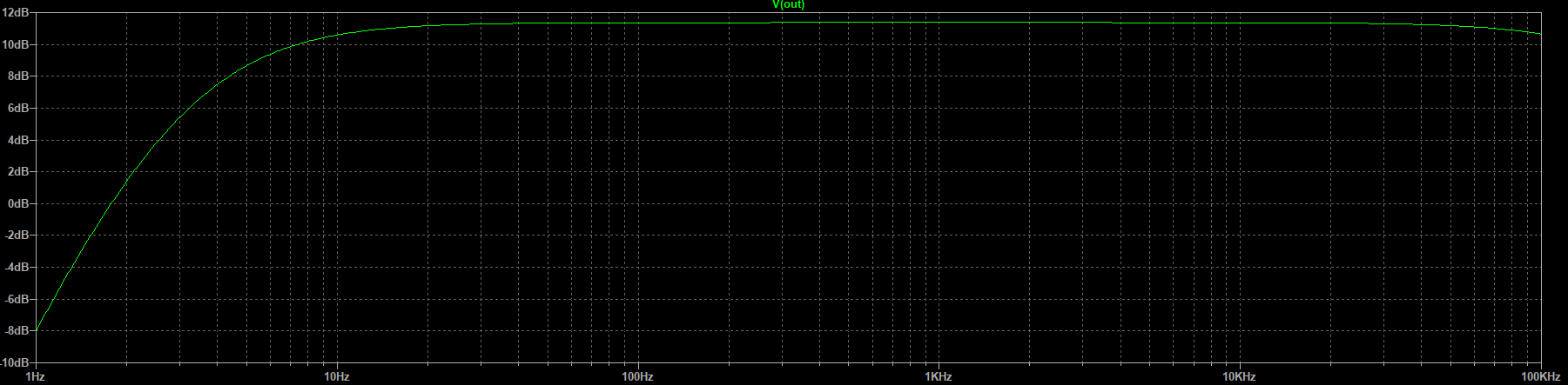

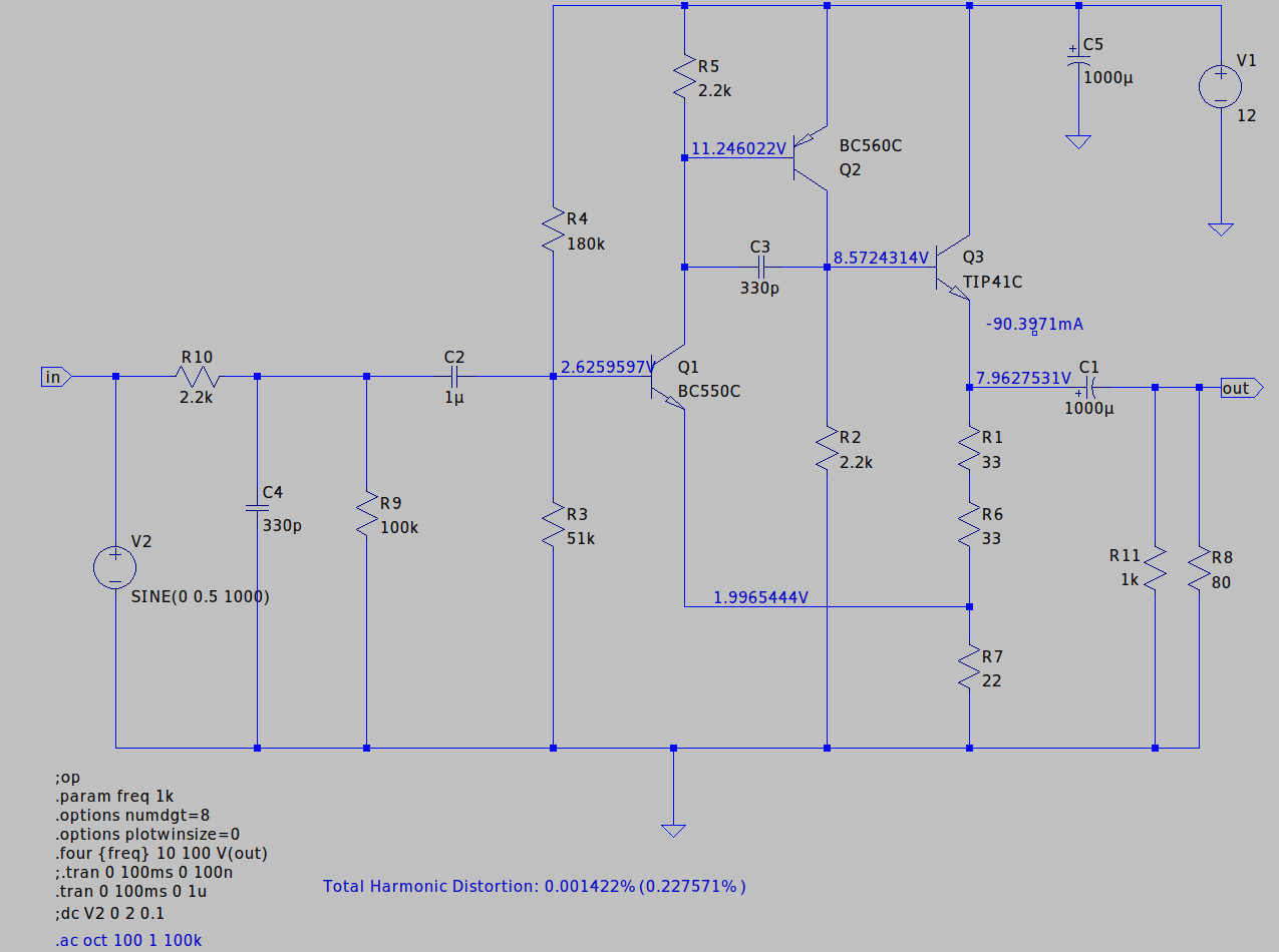

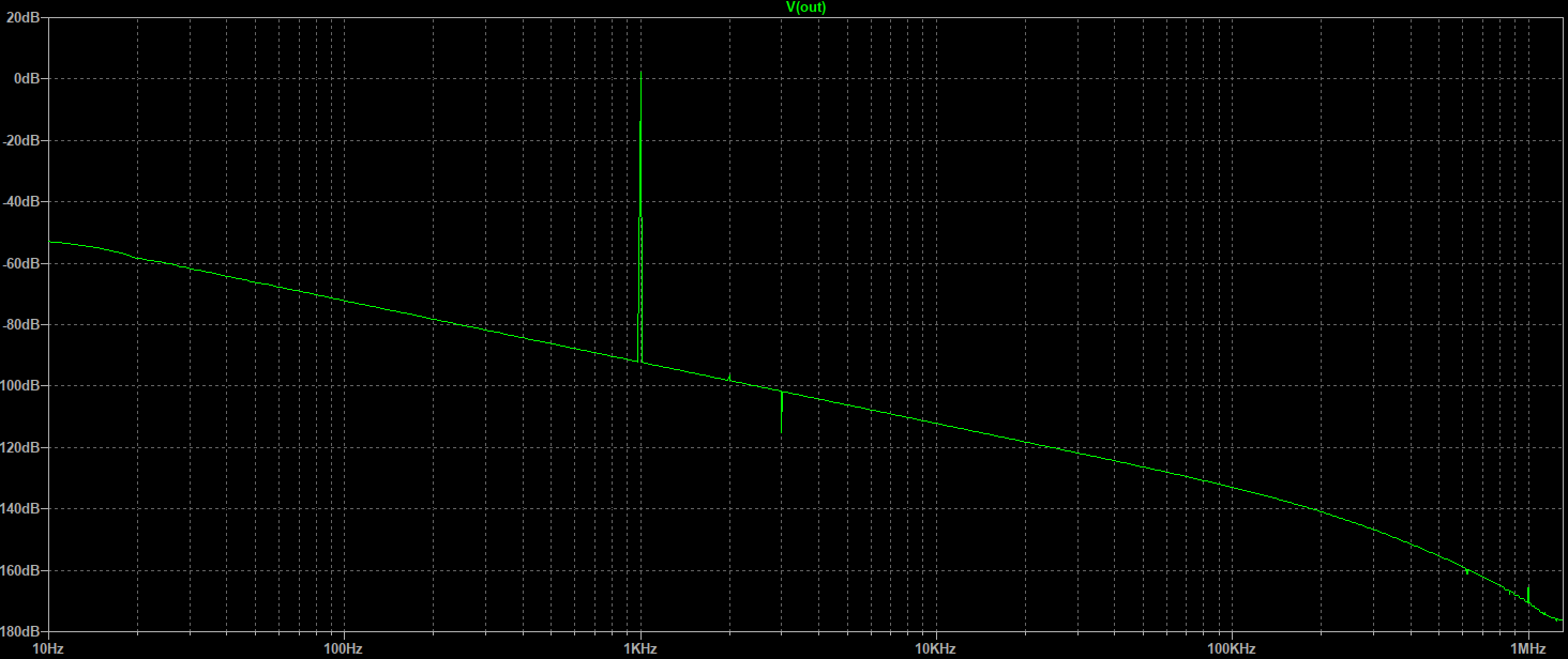

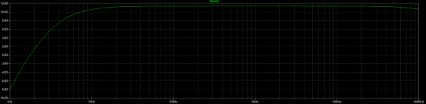

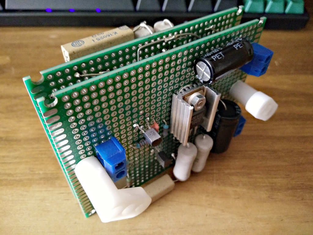

Finally I got time to finish the amplifier. Some values I changed to ones that where available to me after simulating the circuit and I used a TIP41C transistor.
R1, R6 and R7 where originally specified for max 1W but they got way too hot. So I swapped them for matched 5W ones (that is, 5W by the looks of it). The temperature of these resistors are now ok.

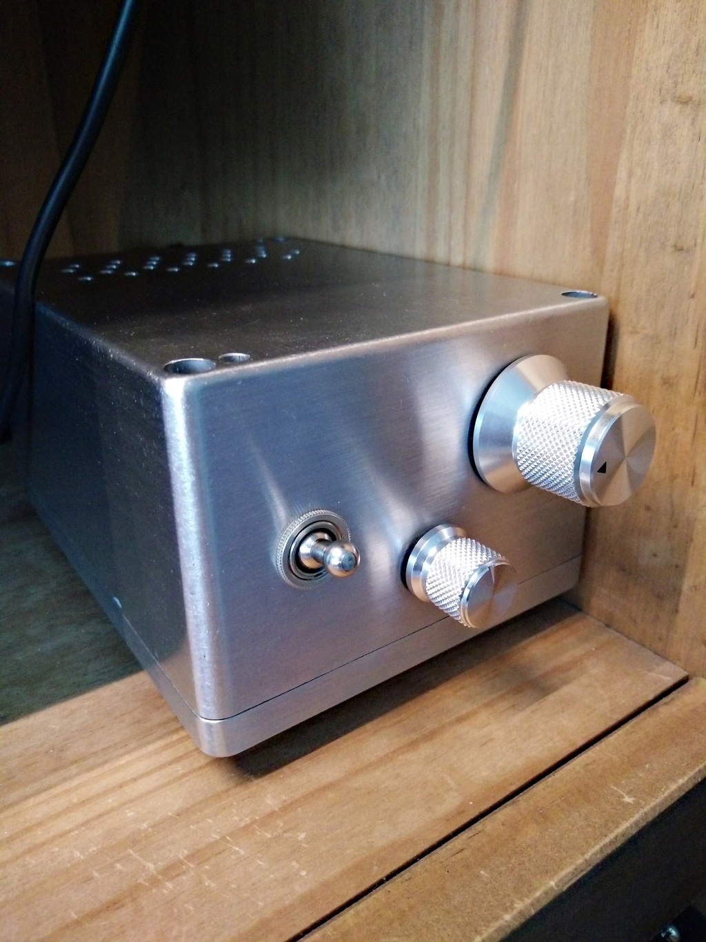

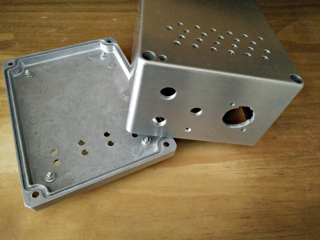

I wanted to use a small enclosure of 10.5 x 14.5 x 7.5cm but I also wanted the two PCBs leaving some space for experimenting if necessary. To fit the PCBs in the enclosure I 'sandwiched' them.
I drilled ventilation holes in the bottom and top of the enclosure using a template made from an old PCB.
I made the input and output at the back of the enclosure. Three reasons for that: I use a correction filter for my Beyerdynamics DT770 Pro 80 ohm headphones, I do not like the looks of the headphone input and there is no space at the front of the enclosure.
The audio carrying cables in the enclosure are made of cat-5 UTP.
There is no led, I prefer not to be distracted but only by the quality of the amplifier as it is sitting in front of me next to my computer screen.
My right ear is slightly worse than the other so I use a balance potmeter at the front to compensate for that. B.t.w. listening to some recordings I suspect I am not the only one...
A switched power supply of 12V is used. No filter necessary, it is silent.
Regarding the quality the only comparison I can make is comparing it to a simple opamp headphone amplifier using a NJM4556 set to class A with some other bells and whistles. I did not expect such a big difference: overall it sounds a lot nicer (listening to lossless files on my computer via an old Music Streamer II USB DAC).

I meant which fabrication house. JLCPCB, PCBWay etc?
Ah sorry. Jlcpcb. 7€ including shipping for 5 boards. Only took 2 weeks for the boards to arrive.
