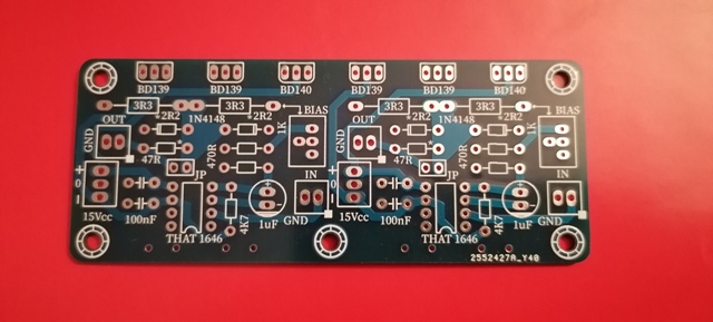

It's a weird shape because it's meant to slide into this case, the cutouts are for the IEC socket and RCA jacks.
Looks good!
I'm having trouble visualising how you are getting the mains power from the IEC to the board - are you going to use flying leads for that instead of mounting an IEC onto the PCB?
Yeah, there's a power switch at the front of the case so I'll be using flying leads to that then short ones to the board, both with fastons. I've also made a layout where it's all flipped around and the switch is instead used to toggle DC power which I think is actually probably better.

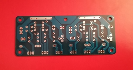

On my PCB it´s easy enough to take 2x standard 0.6W resistor and solder them from cap to GND@ the output connector (botton layer).
Received the pcb today! Looks good, thanks Jens!

I will make some pcb according to Prasi's drawing, if I have time ...
