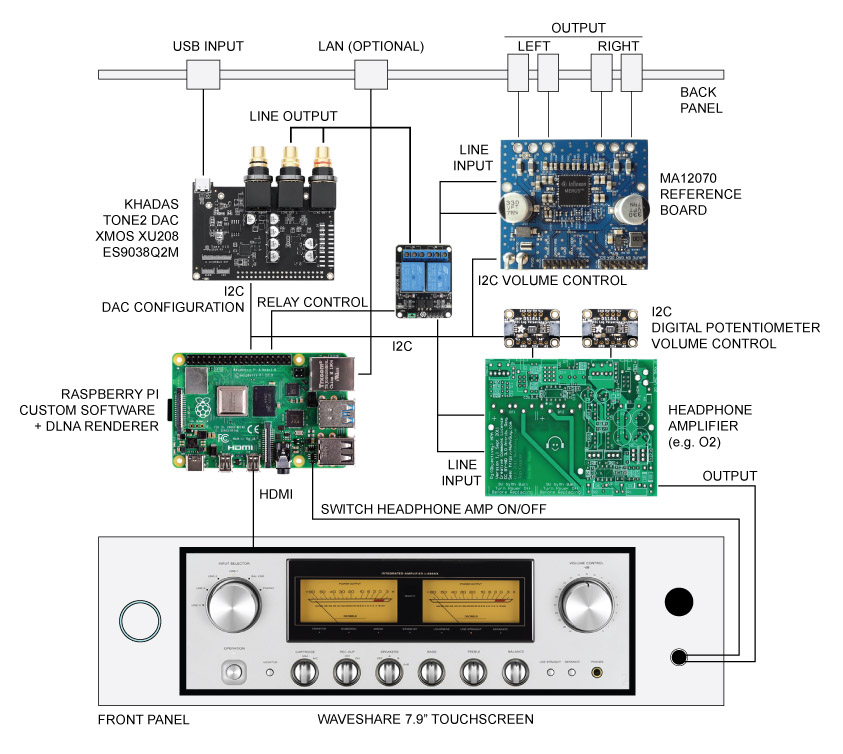

I have posted some details in another thread. Here is just top level design:
https://www.diyaudio.com/forums/attachments/class-d/929113d1615051089-infineon-ma12070-class-amp-jpg
Instead of O2 I'll use the amp from this thread.
The audio signal (USB) will come to that integrated amp from the digital source which is also based on Raspberry Pi:
https://www.diyaudio.com/forums/pc-based/360380-nas-streamer-2.html#post6543671
I'll use the same type of enclosure and display.

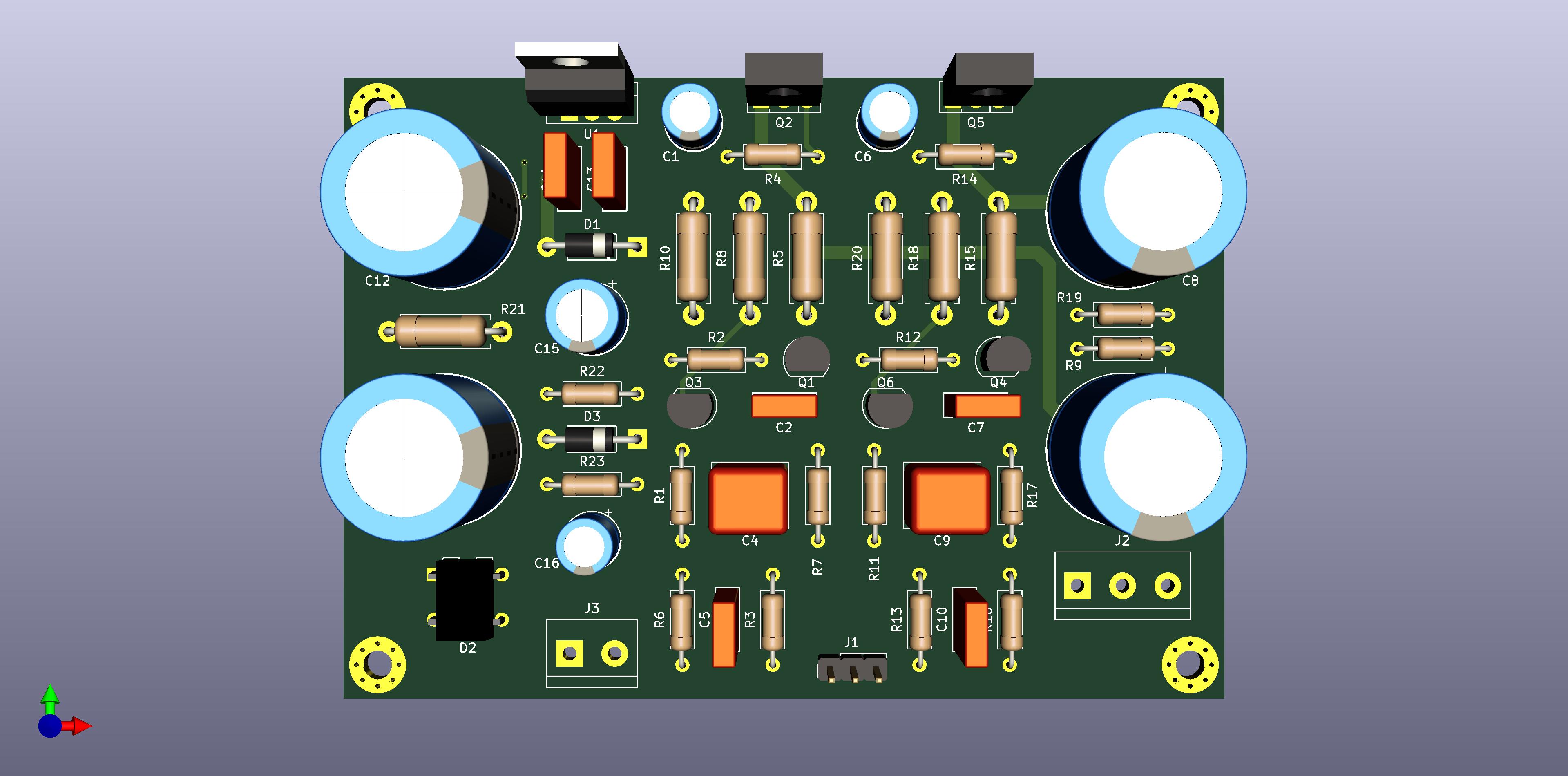

Made a new layout (100mmx70mm) With onboard power supply (CRC and LM317)
Still listening to my breadboard version, sounds great for such a simple and clean design 🙂

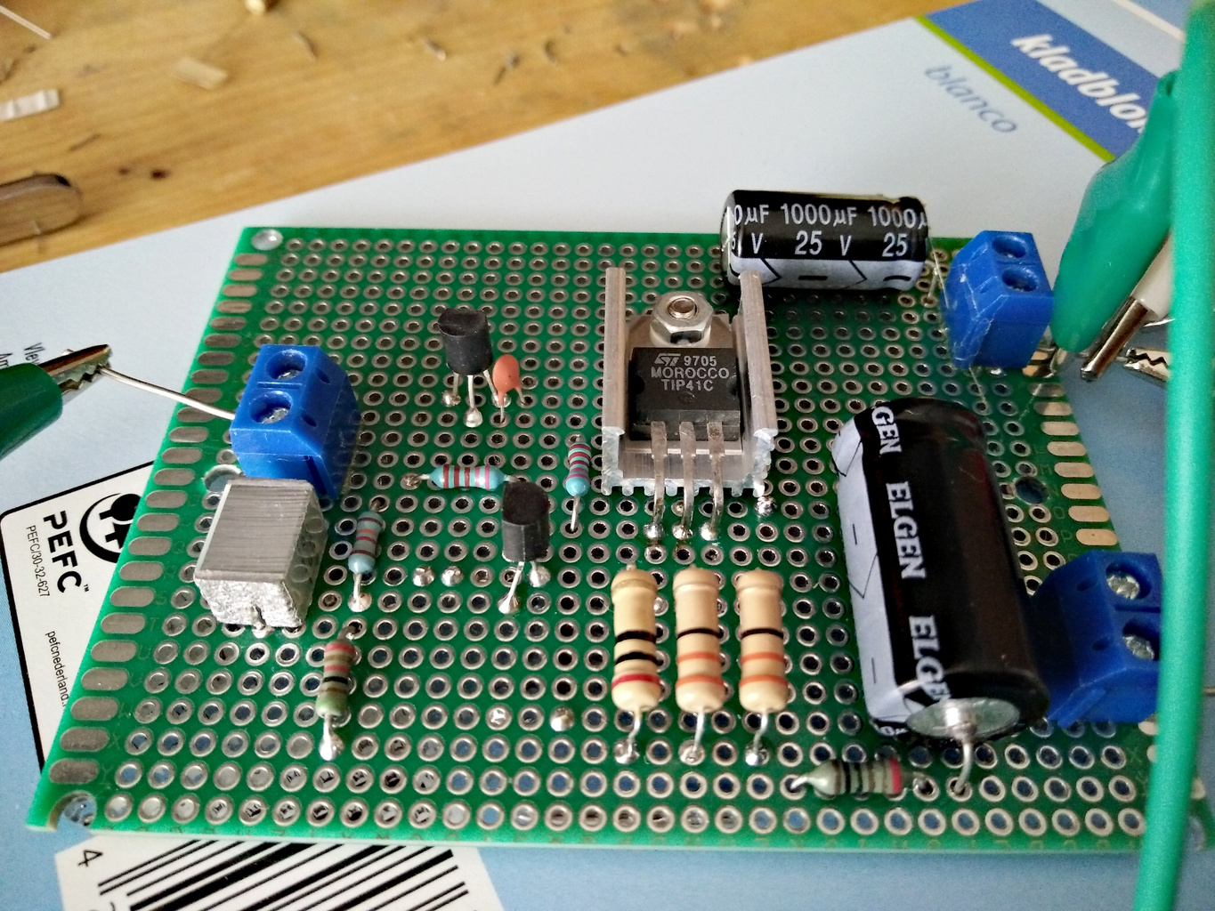

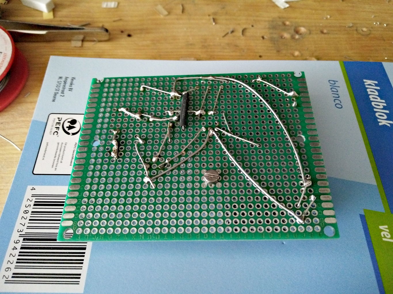

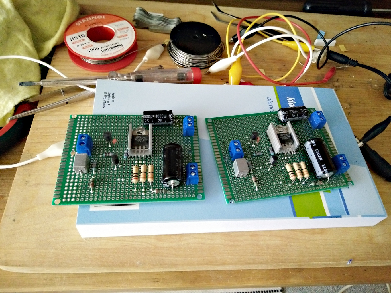

I finally made the amplifier on two perfboards.
Although the frequency range is now limited I like to keep connections on the pcb as short as possible, a bit point to point, with the 330pF capacitor close to the BC560C. I tend to approach this as a HF circuit. However in this case I made the connections not too short to leave some room for adjustments if needed.
The three resistors at the emittor of the TIP41C get hot. I probably have to get used to that as I only made opamp based amplifiers before. I lifted these resistors of the board.
The heatsink for the TIP41C is small but it may help cooling it down. It only gets slightly warm.
I also lifted the heatsink a bit of the perfboard by putting a metal ring between the heatsink and the perfboard.

They are at the limit.
The voltages measure about the same as the simulation.
The 33 ohm ones dissipate 326mW, the 22 ohm resistor dissipates 199mW. That is within the limit of the resistors that I used.
However they become hot to the touch. Measuring the temperature with my finger is as reliable as eyeballing the weather forecast by looking at the clouds I guess. I am not sure they are too hot.
Post #10, 11, 13, 16 and 81 hint at these resistors being warm (hot?) and suggest using 1W.
I am not experienced with these kind of circuits so it occured to me they are too hot to touch.
The 33 ohm resistors should dissipate around 270mW, the 22 ohm a bit less - about 180mW.
1W is within specs, but will run hotter for sure.

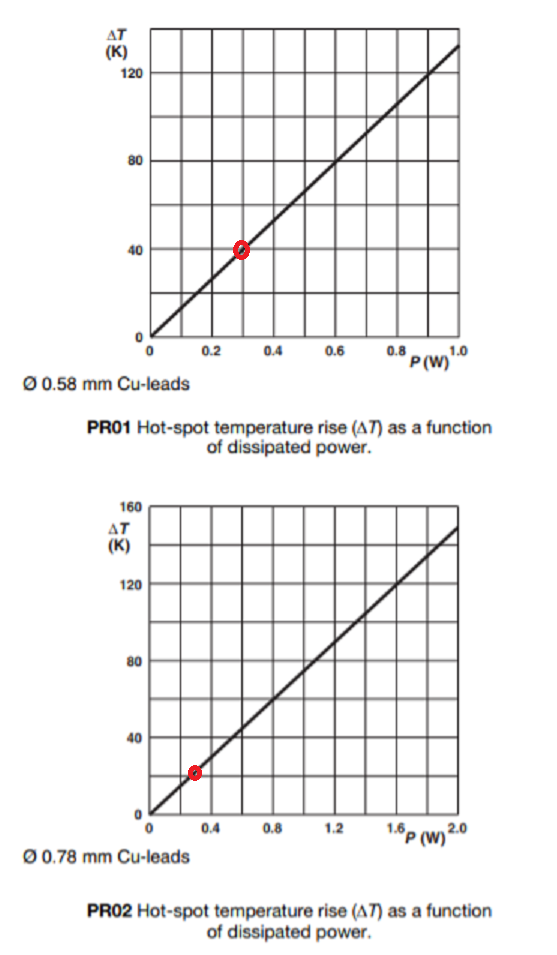

I used the Vishay PR02 series because the 2W resistors heat up almost half as much as the 1W:
attachment.php
Resistors such as these are designed to heat up, and can be run quite hot:
"The maximum permissible hot-spot temperature is 205 °C for PR01, 220 °C for PR02 and 250 °C for PR03".
Although the resistor will be comfortable running at high temperature, it is always good to consider the impact it will have on neighbouring components and the PCB itself when selecting these components. Having a set of resistors running towards 100 degrees, next to electrolytics rated at 85 degrees, for instance, would not promote longevity.
1W will be ok, but keep them off the board, in a vented enclosure and away from anything sensitive to heat (such as electrolytics).

It is just the other way around with the one I built, I can keep my finger on the transistor but not on the resistors. Maybe because I changed the base resistor of the output transistor to 2.2k instead of 1.8k, and I used a TIP41C. However the measurements are not that much different compared to the original if I look at the simulation.
Your heatsinks are more substantial than what I use.
I have a little plate with low Rth between the BD139 and plate (thin foil) and ~0.7W on it;
the resistors get obviously cooled through the PCB at least a little.
I try to use >=1mm tracks whenever I can; and yes, the PCB is pretty warm too.
