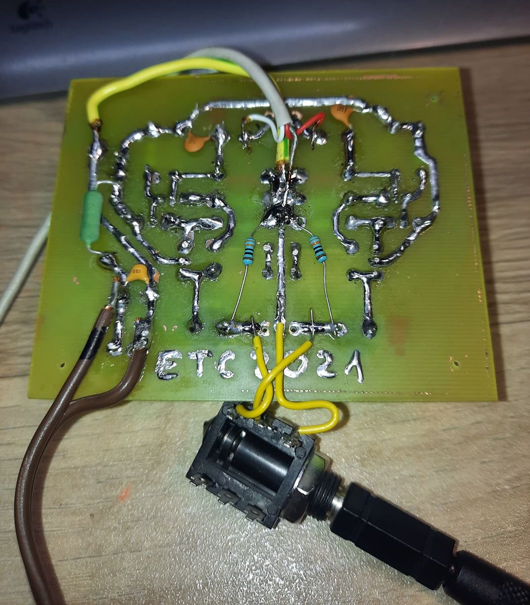

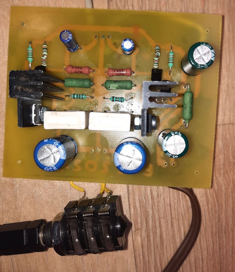

Although I have several headphone amplifiers, I wanted to hear how a simple Class A amplifier sounds like, without anything special, so I made the schematic from the first post. Below you have the changes I've made, to be able to use what I have in the drawers. I hope the author doesn't mind my modifications, I will also post this article on a Romanian forum, including modifications and source link. I don't use simulating nor PCB making software, so the modification I made are just graphically.

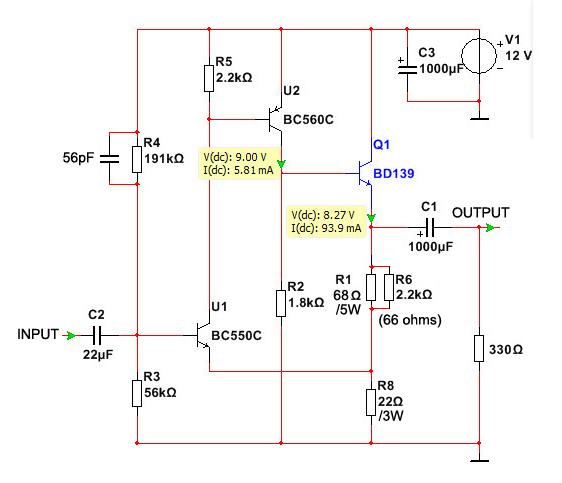

So here's what I've changed:
1. I mounted a 56pF capacitor in the bases of the U1 transistors, otherwise the amp would strongly oscillate on high frequencies. The transistors I use have probably a much higher hFE than the originals used by the author - mine have around 500 - I have enough power even for 300 ohm headphones. It's true that I'm not the type to listen very loud.
2. The resistors in the emitter of BD139 must be higher than 0.6W, so I used some resistors of 3W, respectively 5W, as in the figure.

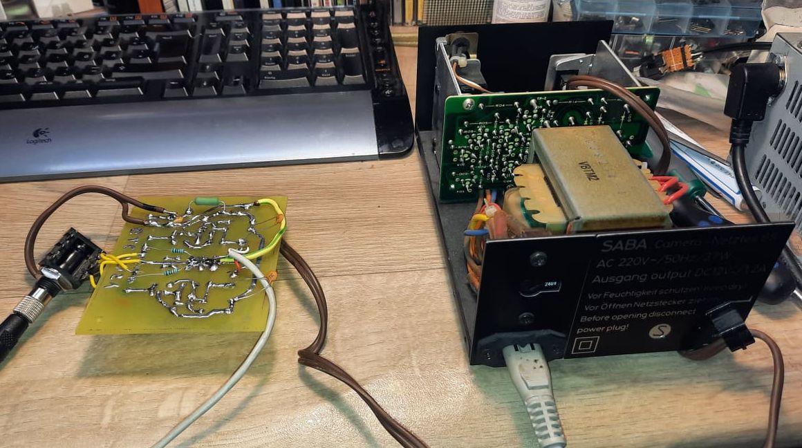

Pay attention to the power supply used, you must have a stabilized and well filtered source. Initially I used a switching power supply, quite good, but I had an annoying hiss, which did not disappear even when placing a ceramic capacitor of 68nF parallel on the last capacitor filter - this is not included in the diagram, but remained in the assembly after we returned to the linear source - a good quality source, originally purchased for the beautiful box. But he earned his right to remain in the original version.

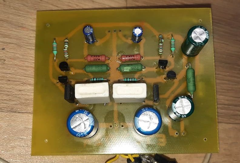

The wiring, as you can see, was done manually, old school, starting from the drawing of @avtech23. Compared to what is posted there, I used a 13.5V source (it was somehow modified by the former owner, probably for some broadcasting station) and the value of the resistance between the two capacitors was lowered to 6.8 ohms to have 12V on the last filter capacitor.
I recommend this amplifier, at least for your curiosity. I don't think you will regret it. Obviously the wiring can be made much more compact than I did - but I wanted to have more room for maneuver, being a test setup.
I did not make measurements, nor do I think it is necessary for such an assembly, far from the peak of performance for sure - although something simple shouldn't necessarily sound bad.
Now I don't have too much time last, because I am going on vacation, but I invite you to build and measure this amplifier and when I return I will present my results. Compared to the values in the diagram, the voltages measured by me, statically, with the shorted input are higher by about 0.35V, probably due to the transistors with higher hFE.

It’s unfortunate that you used the schematic from the first post.
The schematic has been modified through this thread. Have a look at post 152.

Yes, you are right, but it was a quick build, I finished the PCB, up and running in a single day. I'm not native in English, so to read the whole topic takes too long. But now I'm encouraged to learn more about this design, even if I was vers skeptical initially.
Thank you for the pointing, I thing I will also order some PCB's in China, to make a better looking project. But this lately, starting from the first days of September.
Looking to post 152 it seems that the oscillation depends on the transistor batch, in my case there was not a solution placing the capacitor to the 2-nd transistor. But also I used a much smaller value...
Good to see another build of this cool little amp.
Important changes from the original schematic were:
2.2uF capacitor not 22uF for input.
Input filter 2k2 into a parallel 220pF and 100k to ground.
This in particular makes a big difference to prevent roll-off of the upper frequencies.

Especially with the values Avtech23 suggested it is very well possible to use a switching power supply, as I did. Just try a few if possible, not all are equal. If the switching frequency is high enough you won´t hear hiss or other artefacts. In my case it even was not necessary to use filtering.Initially I used a switching power supply, quite good, but I had an annoying hiss
I use a switching power supply I had laying around for a long time, probably salvaged from an old broken device.

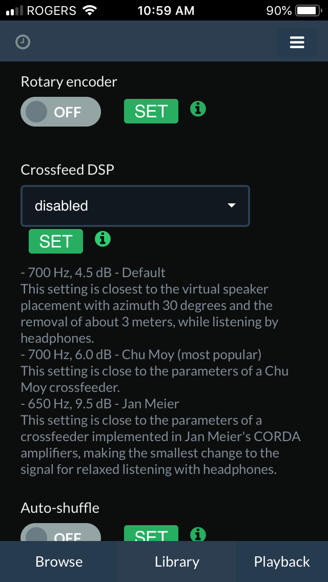

Crossfeed;
Should a crossfeed feature be added to this HA ?
I have the following option via my Moode Audio music server (see pic) but would rather have a switch to enable/disable the crossfeed on the HA itself. Do you guys believe it’s complicated and if not, worth implementing?

It is probably a good idea to implement optional crossfeed in headphone amps.
You could use one of these passive little circuits mentioned in this thread which could easily be done on perfboard:

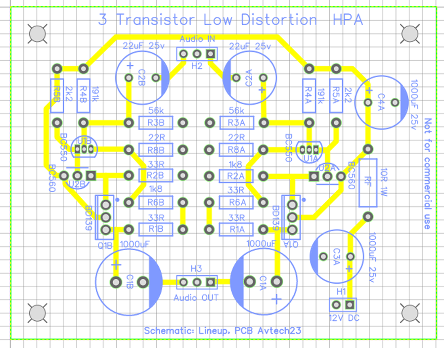

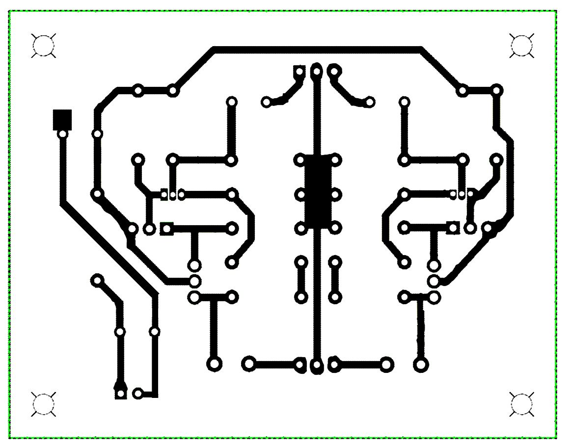

I am planning on using Prasi’s layout from post #152 and will be driving 14 ohm headphones, do I need to make any changes?
Given that an output capacitor of 2200uF is bein GB recommend for 32 ohm headphones, should use a slightly larger value here, say 3300-4700uF?
32 ohm and 2200u gives an fc of 2.2Hz. 14 ohm and 4700u would give 2.4Hz. 3300u gives 3.4Hz.
Would probably need to be careful with turn off thump for 4700u, though 3300u into 38 isn't too bad on my latest one.
I'll try to run the sim this evening and see what it looks like with 14 ohms.
